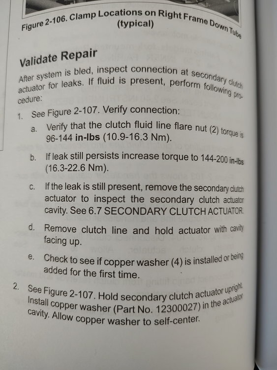

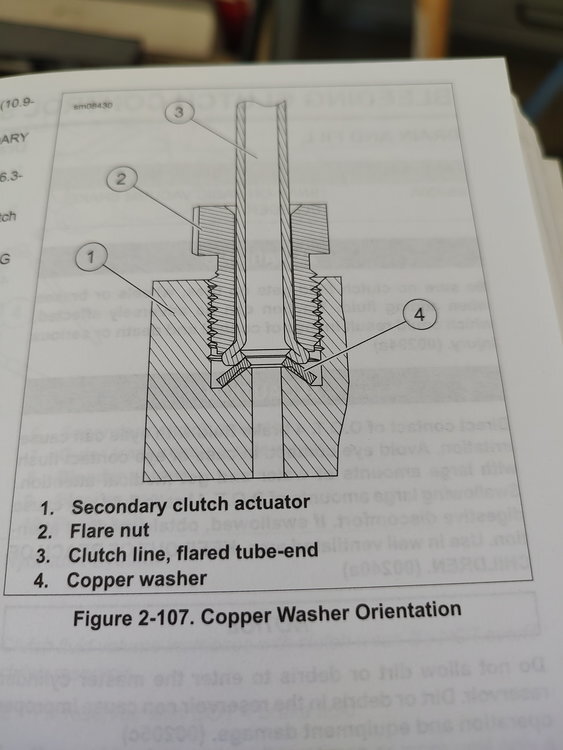

My hydraulic clutch line was frayed at the slave cylinder so I ordered a new on, It leaked at the slave cylinder connection like a sieve. Come to find out there is a crush convex brass washer available on a service bulletin that a fellow member on HDforums told me about. The dealer didn’t know this and wasn’t any help.
if any of you ever have this issue, it exists. Not a O-ring as i thought but a crush brass washer.IMG_0533.jpegIMG_0534.jpeg
