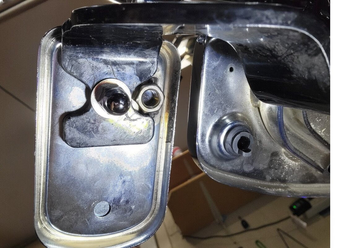

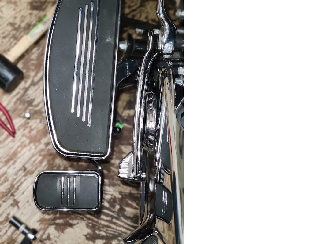

Replaced the parking brake pad with the foot brake pad. Just on the spur of the moment to see if it would work. Had to tack a 3/8" nut under it to keep it straight. Now I have to order a new foot brake pad..lolView attachment 111184View attachment 111185
That turned out nicely. :clapping:
I've always been partial to that style floorboard. Had them on my 2005 RK Custom.

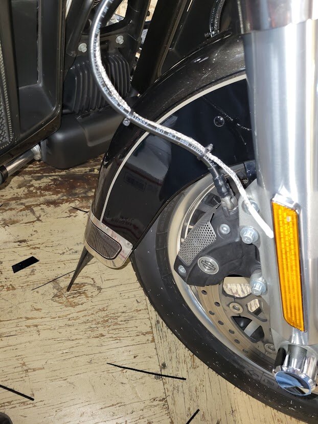

Added the Custom Dynamics front fender light and their front fork LED side lights. Fit and finish are outstanding but I tell you what. They really don't pass the custom harness criteria. First the fender light harness was just a 2 conductor length of wire with 4 posi taps. Not even the grommet needed to pass the wire thru the fender. If I knew that I would have just got the Harley harness. <br> The fork lights look almost stock except for their thickness. And four feet of braided SS over the wire. Plus another 6 feet of extra unneeded wire with the quick disconnect on the end so you can't trim it back. I have their lower fairing insert also and they had way too much extra wire too. Like it's not a wiring mess under the fairing to begin with. <br> The braided SS covering looked terrible ty wrapped over the brake line. I ended up getting black braided split wire loom to help hide it. <br> The lights all look great as you'd expect from CD but they need to clean up their wiring harnesses.
That SS covering is like an arrow pointing at the lights. I wanted it to look like it hasn't been changed.

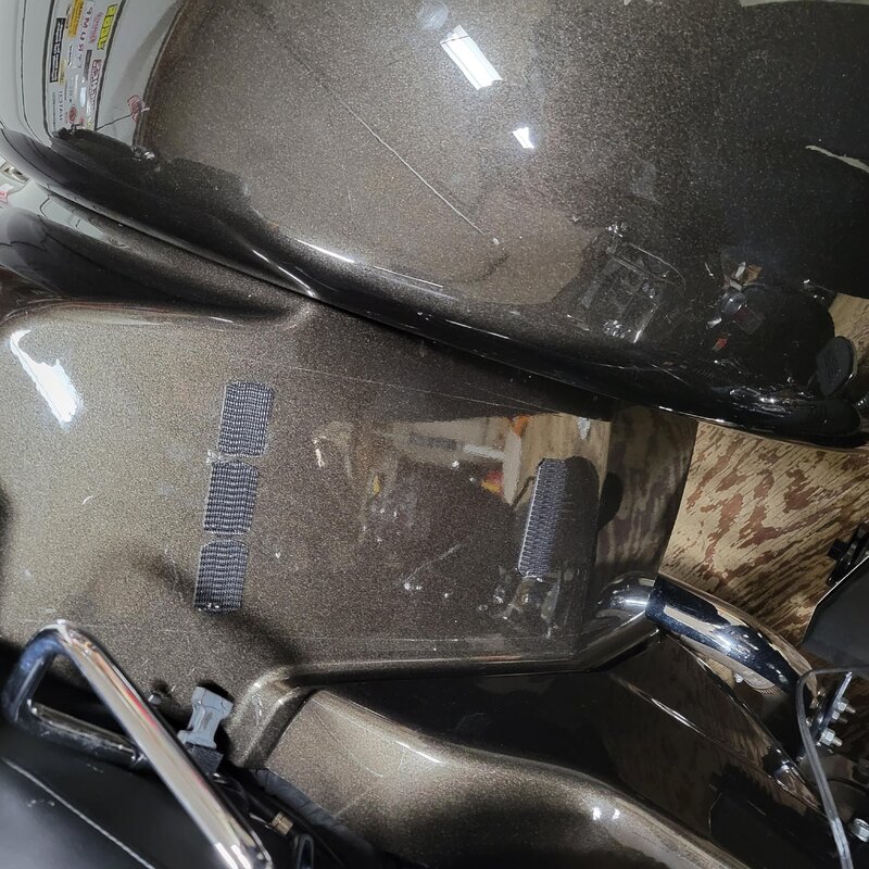

I couldn't bring myself to drill holes to mount them so I put a layer of 3M film down to protect the paint then used 2 different types of Velcro to hold them. I found the "self mating" type to give up pretty fast when pulled on. But if you use the hook and loop, loop side type with it, it locks on extremely tight. saddlebags.jpg Bag1.jpgBag3.jpg
I added a piece of plastic on the bag of the bags to give it a nice flat surface. If I end up hating them I can just tear off the film. No holes!
