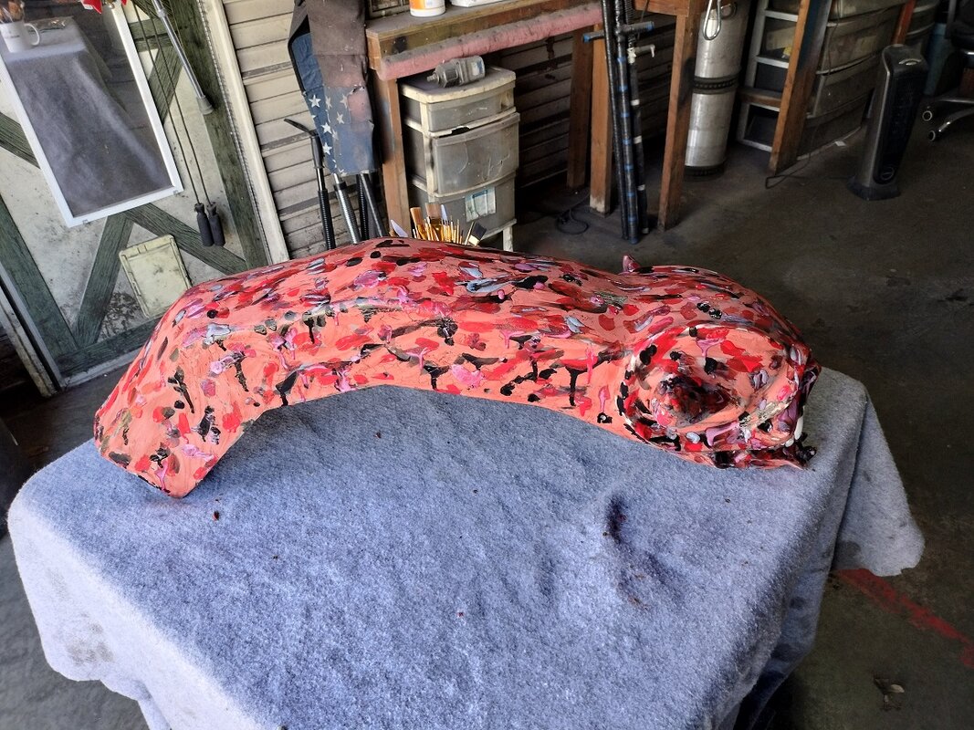

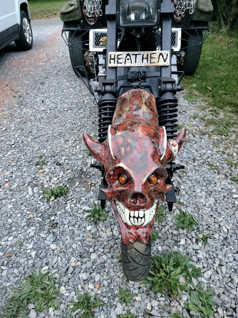

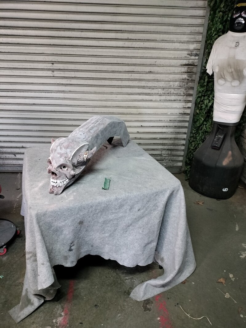

I have been working on my fender for days. I started by chipping out all the pits, holes and scratches. I wanted to be sure I removed anything that was loose. It was in bad shape. For the larger deeper ones I used JB weld to fill them in, the others I used Spot putty.
Back what I first made the fender I came across this pattern by accident. I was filling in spots and sanding and thought the pattern it made looked neat. since then I have tried to keep the pattern.
Here the big pits, scratches and such and been repaired and the entire fender have been painted with paint and spot putty. Not sanded yet
Here its sanded down to 320 grit. I started at 80. Notice I am still having an issue blending in the back where it had been painted black over the years. I will take it down to 800 to 1000 grit before I clear coat it.
The clear coat is the part I have never gotten right, I always get tiny pits in the clear coat. I think it is because I do not have a dust free place to paint it
I will post a pic once it is clear coated. If it does not pit to much it looks real neat all shined up.

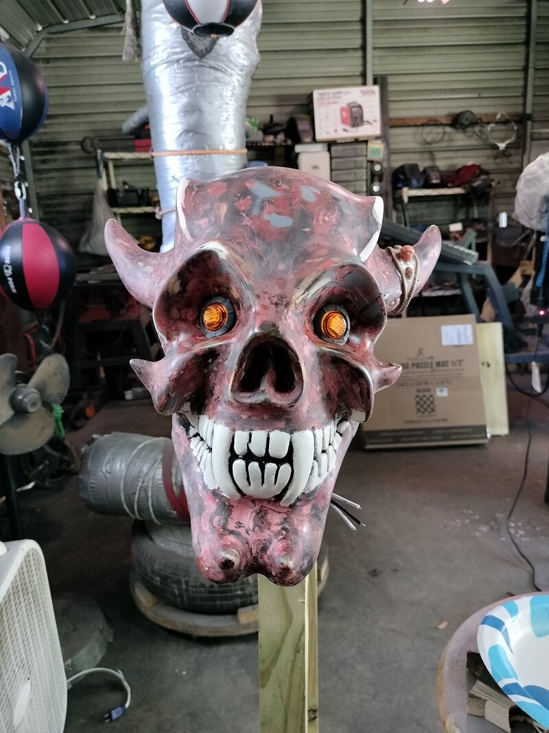

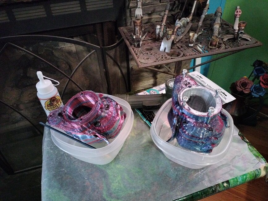

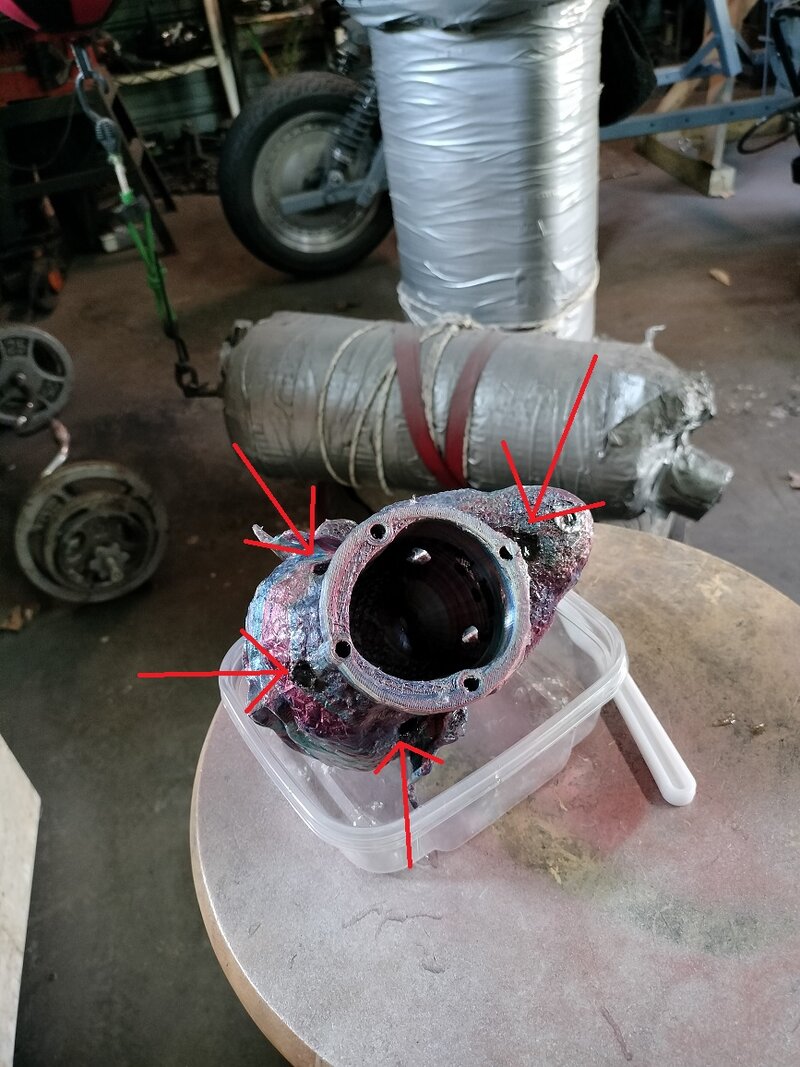

I did not like one of the turn signals so I m making another one.
You can see the holes I burned in to fill with epoxy
This is the pattern I use inside of the turn signal. It allows the epoxy to flow

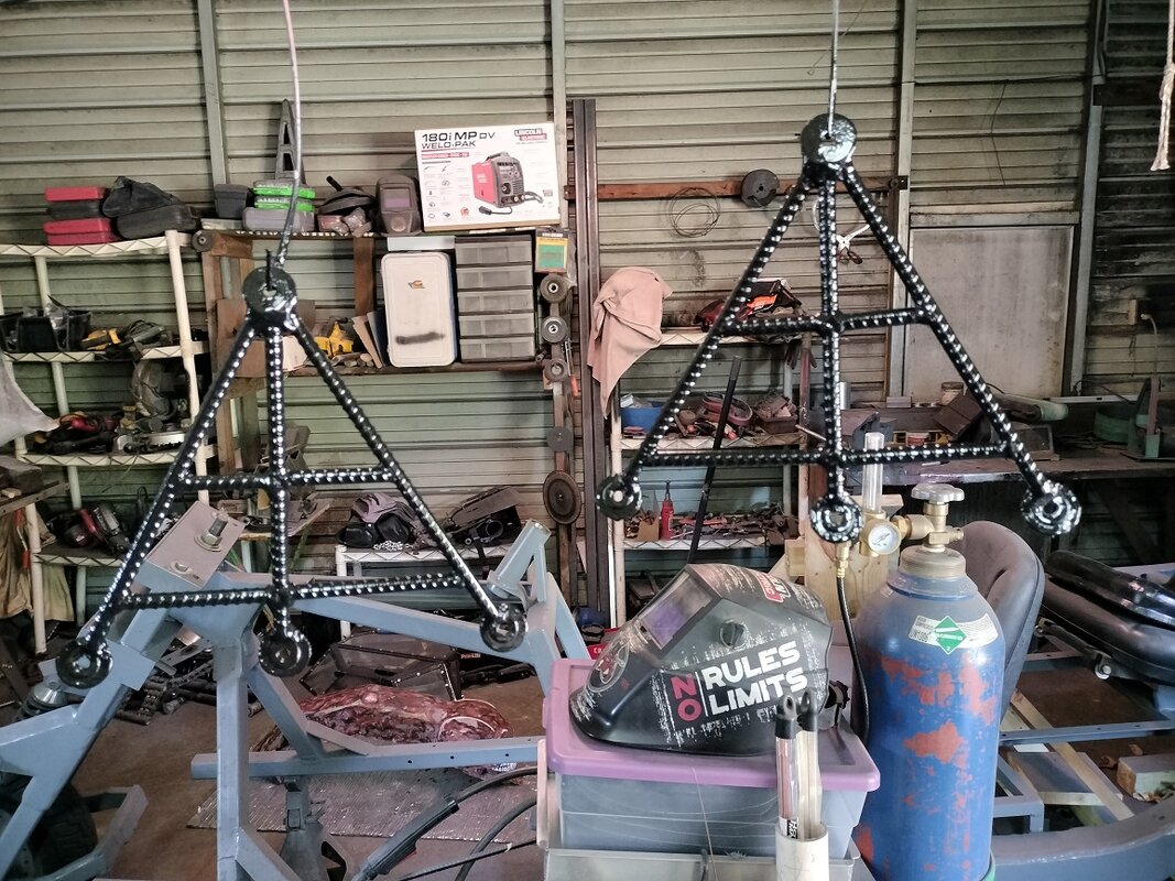

I looked at different pasterns for these fender braces but in the end I just went with simple

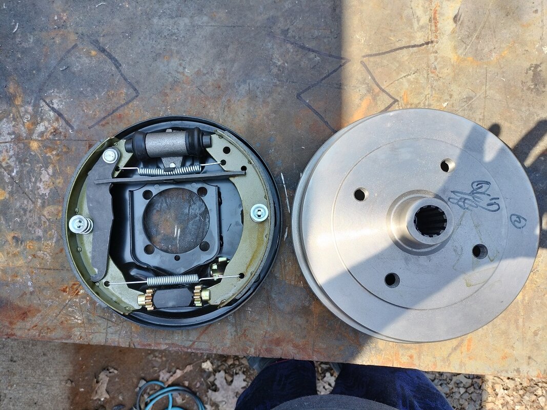

I installed the brakes yesterday. I bled them but I have a hard pedal and not very good brakes.
I had to adjust them all the way down to get the new drums on.

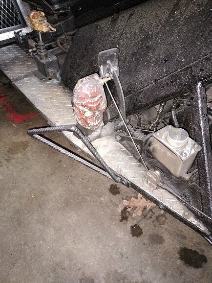

Reattached the emergency brake (It took a blood sacrifice at this point. cut the top of my wrist)

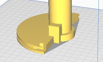

I accidentally put a kink in the cable when i was doing the front end so I have to replace it.

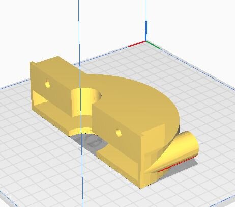

This time I designed a better slot for the cable end. I should be able to replace just the cable next time

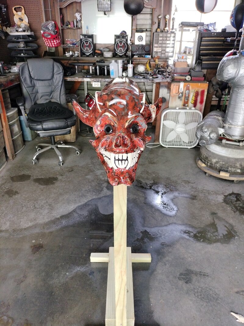

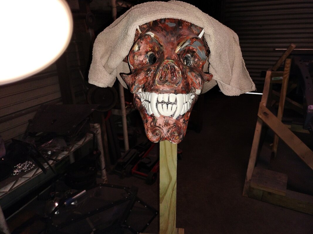

I have been working on his teeth

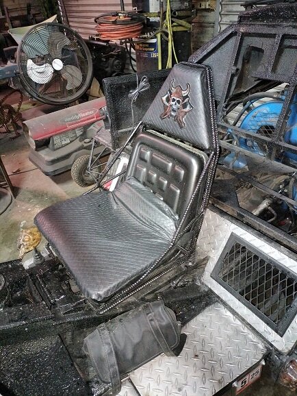

Got a new seat and my son and I also made a new extra bottom and top cushion

Got the brakes done. I backed off both adjustment screws on both side, disconnected the emergency brake at the handle end. Then adjusted the brakes and test drove. Took a few rides. Then connected the emergency brake and and test drove again. I can only get 2 clicks on the handle though.

Worked in the teeth and screwed them up, fixed them and now drying again

I am going to clear coat the fender soon. I always screw this part up. But I am going to try again. I'm using UPOL products. This is what I had the best results in the past

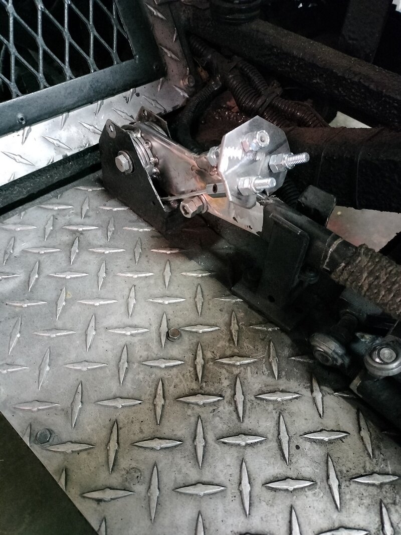

Another delay......The brakes are working good but the parking brake is not working like I want it to. SO I just ordered 2 new parking brake cables and ends. I was going to extend the cables to make it work but I decided to do it right and replace the cable.
This means I will have to adjust the brakes again.

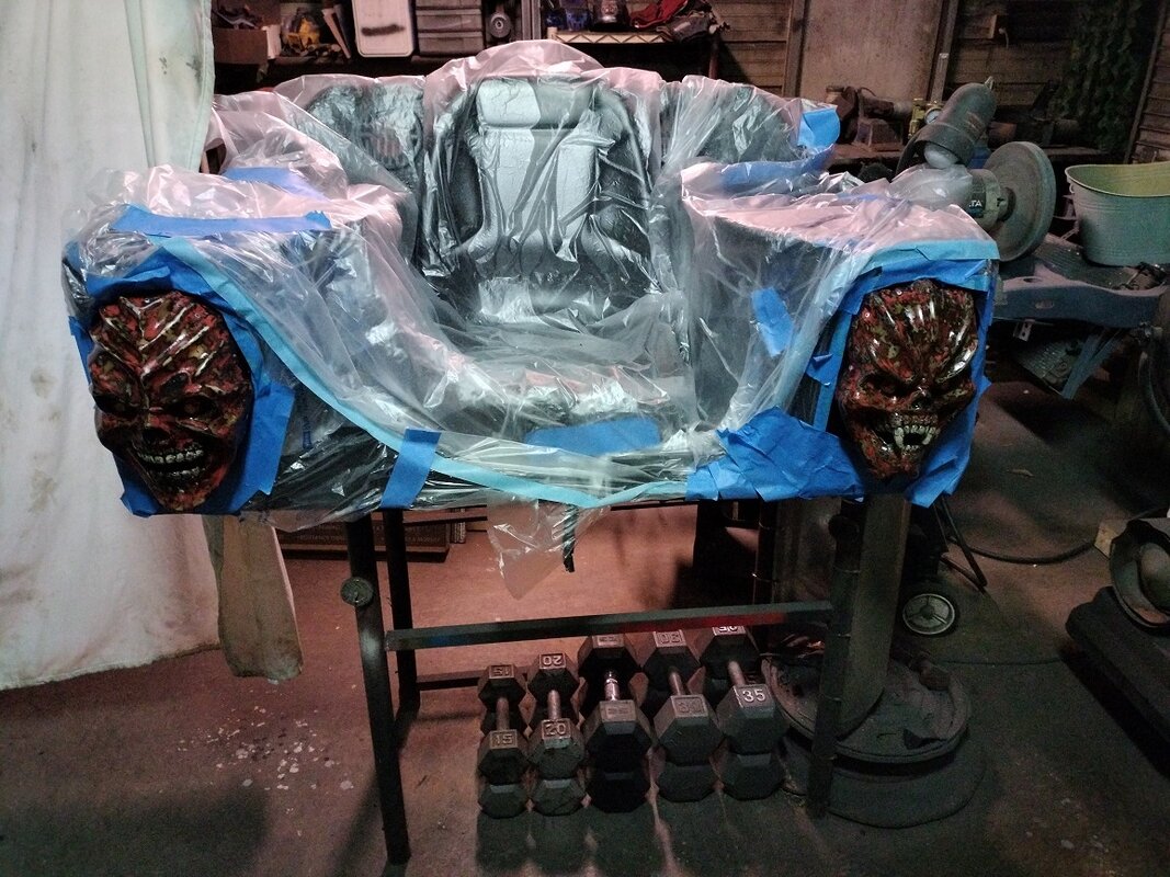

Started on the back seat area.
All cleaned up, faces sanded and clear coated. Need to sand again at 400 fine then clear coat again.

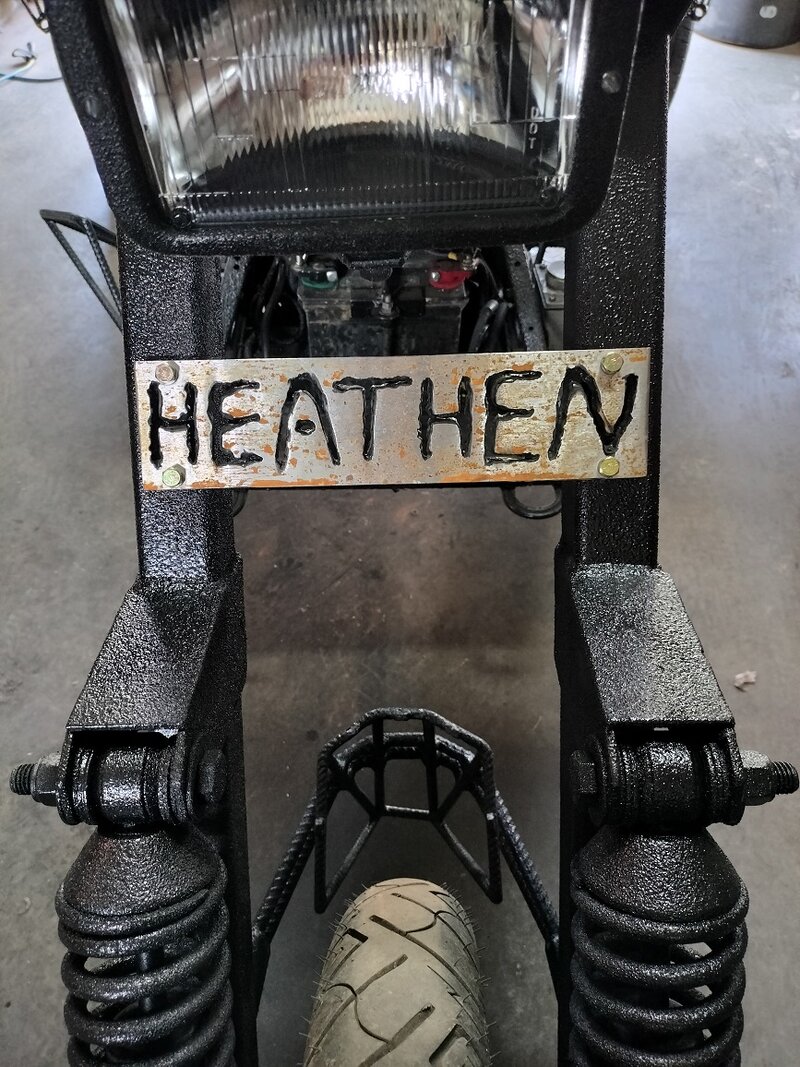

Got my Heathen sign back on. I left it unpainted for it will rust. At some point when it rust enough I may seal it
Put the LED eyes in the fender.

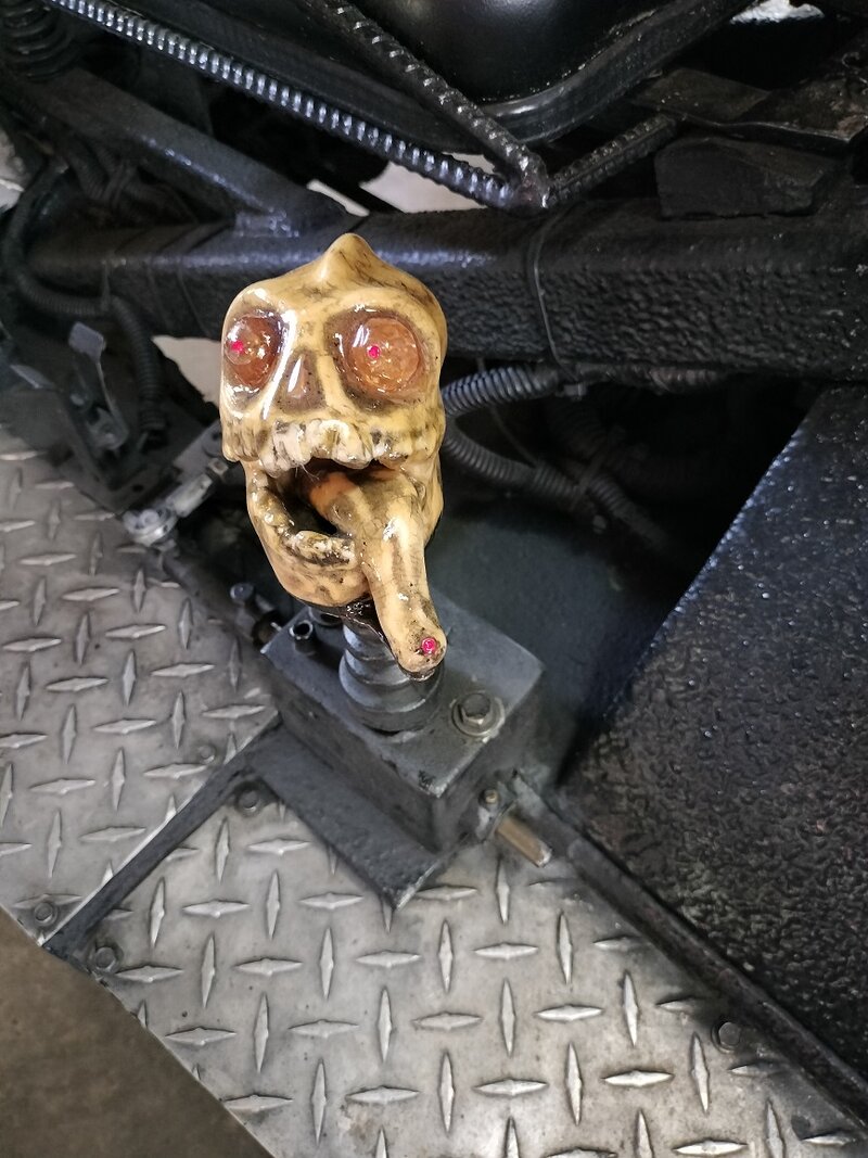

Got my gear shift knob cleaned up and clear coated

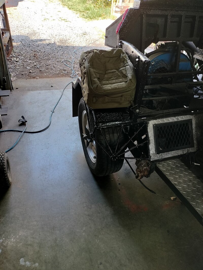

Attached bags on each side.

I did get the parking brake cables in and hope to get that done today.

replaced both hand brake cables and modified the handle some
works good

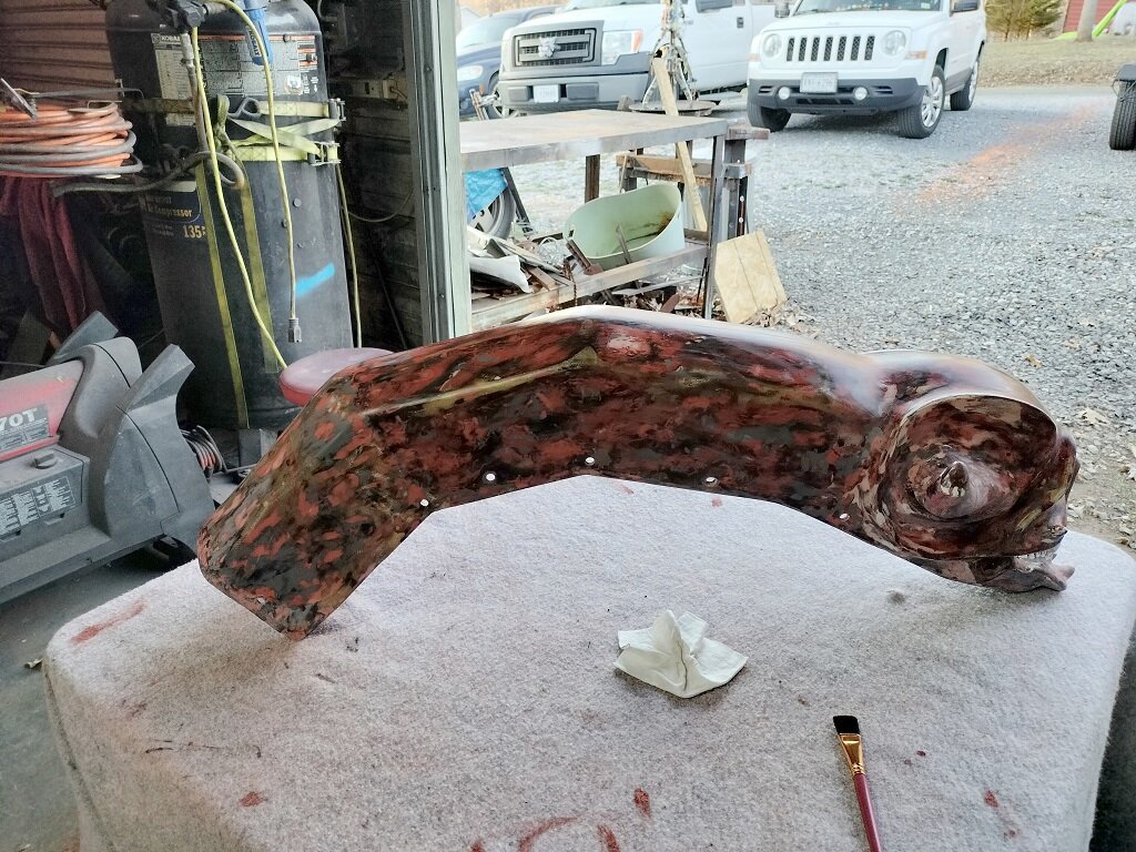

Used UPOL on my fender
turned out better than I usually get it but not as good as I want. Next year when I redo my back seat I will take off my fender also and have some with a paint both clear coat it

I did go back and sand the fender again and re-clear coated it again. It came out even better but still not as good as I would like.

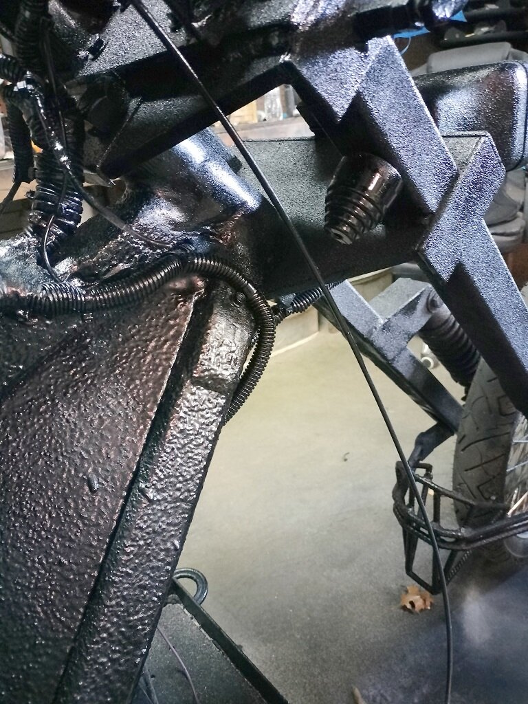

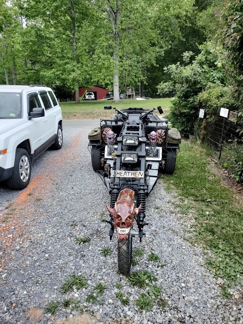

As promised

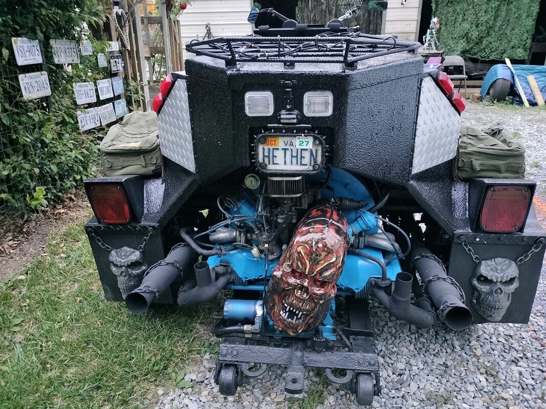

notice the coiled up wire. Its a trailer connection wire. I originally put a normal wire there but I had to make it longer than I liked to all enough for the fender movement. This wire will expand and contract as needed. It is anchored at each end so it does not putt against the connections
I still need to swap out the distributor, wires and plugs
