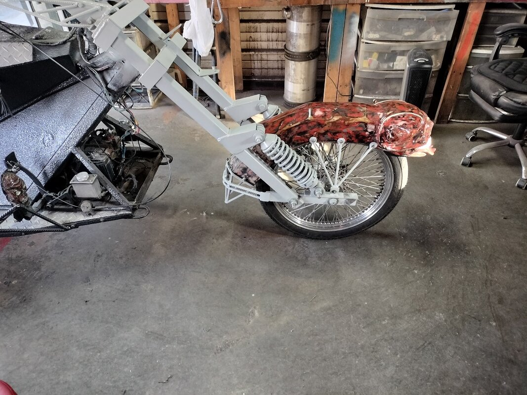

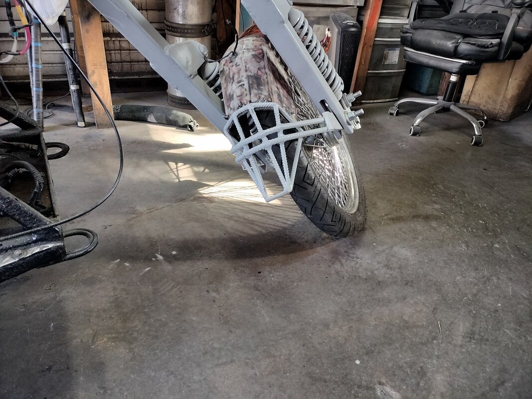

I don't know if it matters but keep in mind that the fender and braces will move with every bump the tire hits. Heavy = more reaction and maybe more chance to crack? I like the look of the rebar too.
I just realized I was thinking you meant 1 piece of rebar that is 2 1/2" in diameter. Did you mean 2 pieces 1/2" in diameter?
Yep, 2 pieces 1/2" in diameter
The fender moved when on the old forks also, but not as much as they will on this new setup. Yes I am concerned about it holding up. I will just have to wait and see. It it does not hold up I will have to go to plan B (a 3D printed fender)

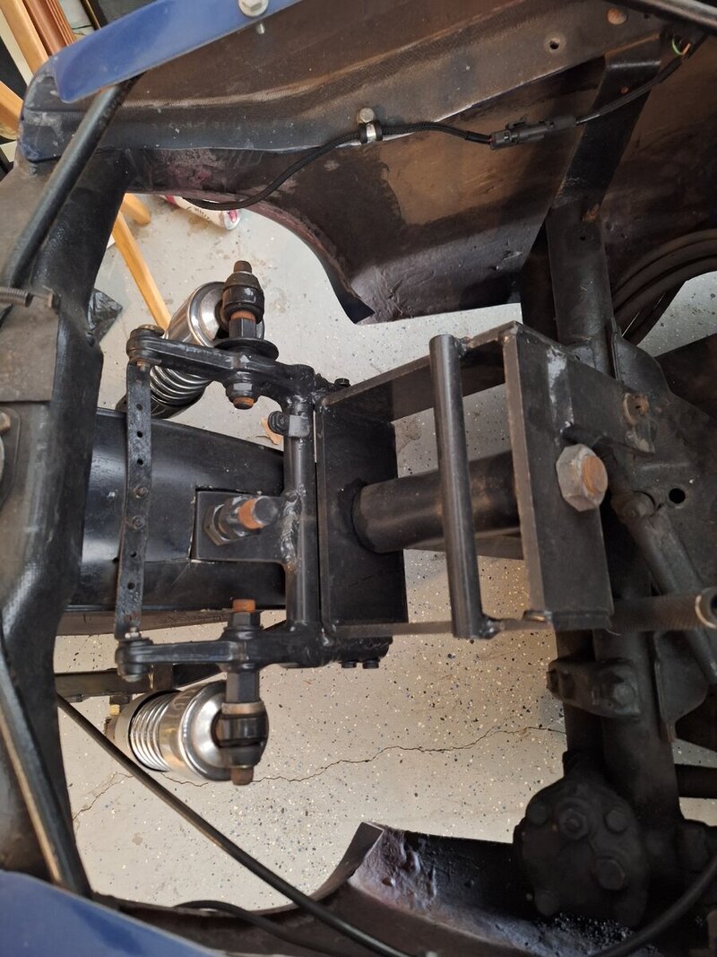

Yesterday I got the front brackets in place. Went with 3 pieces of rebar on each side. Right now they are just welded together at the bottom mount but I plan to make some other cross braces between them. I will post a pictures later.
I started on the back wraparound brace with the 1/2" rebar but I do not like how its turning out so far. I have not decided what I will do about it yet.

On the inside of the fender there is a flat bar across all 3 bolts on each side to distribute the force

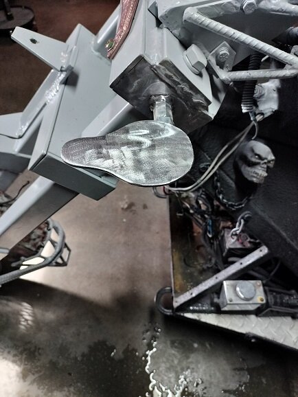

Welded the rebar to the rockers and then welded a flat piece across both on the outside. I think the next time I tear it apart I am going to put one on the inside also

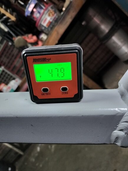

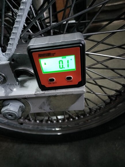

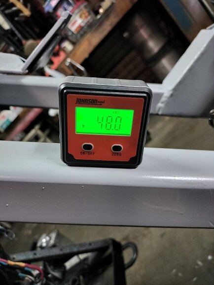

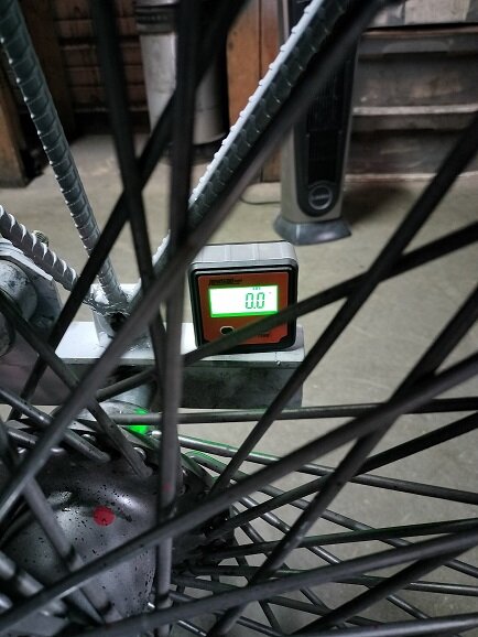

Took some measurements.
left and right legs The angles changed from before but they are still only .1 degrees off
Left and right rockers
again .1 difference

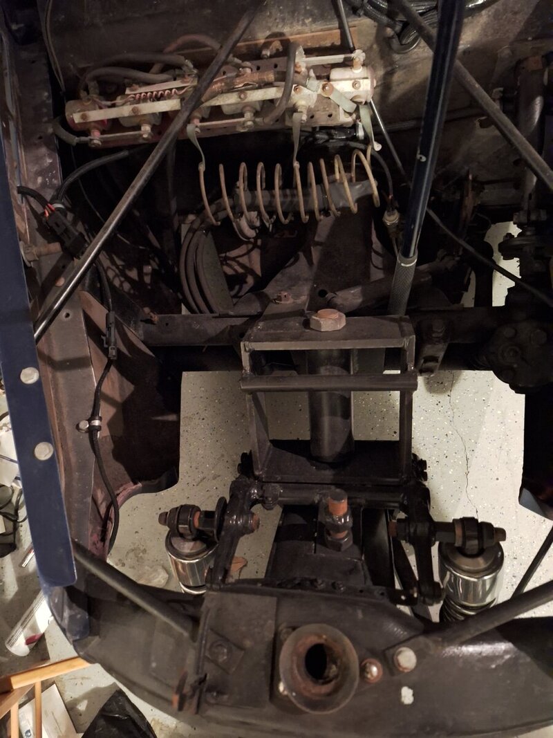

Anyway... I want to build new front forks for my VW trike. I want to build a leading link setup and was thinking of using VW coilover
Does anyone know the average spring weight of something like these?
Anyone ever try this with these

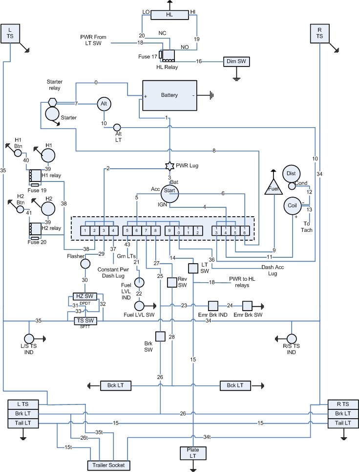

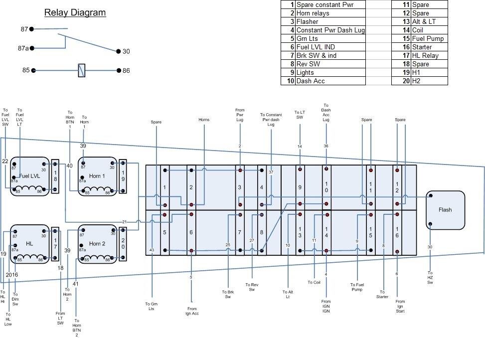

Got the headlights wired up and mounted. Still need to clean up the wires
Back when I first built it I numbered every wire. I put wire tags every so often on each wire.
Made it easy to know what was low and high beam wires. Did the diagram in an old version of Visio
I accidentally used 1 wire number 2 times.
Can you find it?

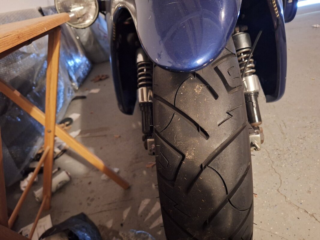

I just got back from another test ride. This time with the 180lb springs.
It was a lot better. I like the 180 springs much better than the 220 ones. It is a lot easier to steer then the last forks.
It still drifts to the right a little but not as much as before. If I have to I can live with it.
I am going to tighten up the left spring by 1 turn to see if that helps any. Not sure if it will since both rockers are connected in the back by the rap around

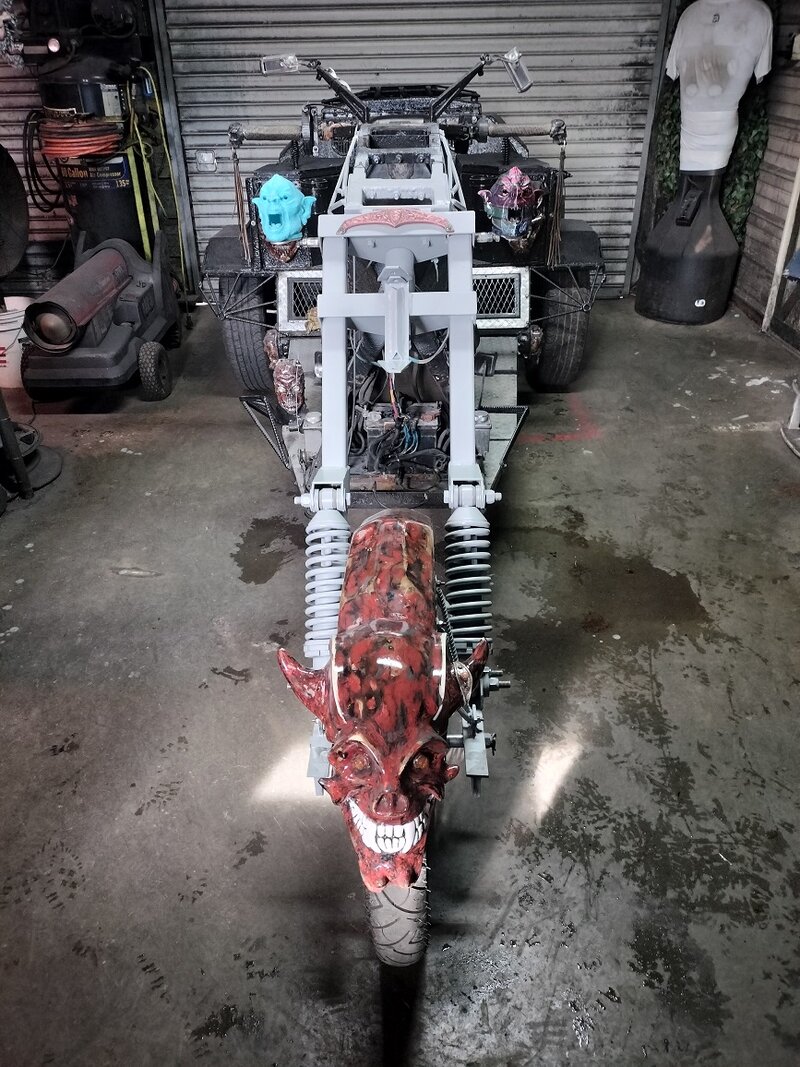

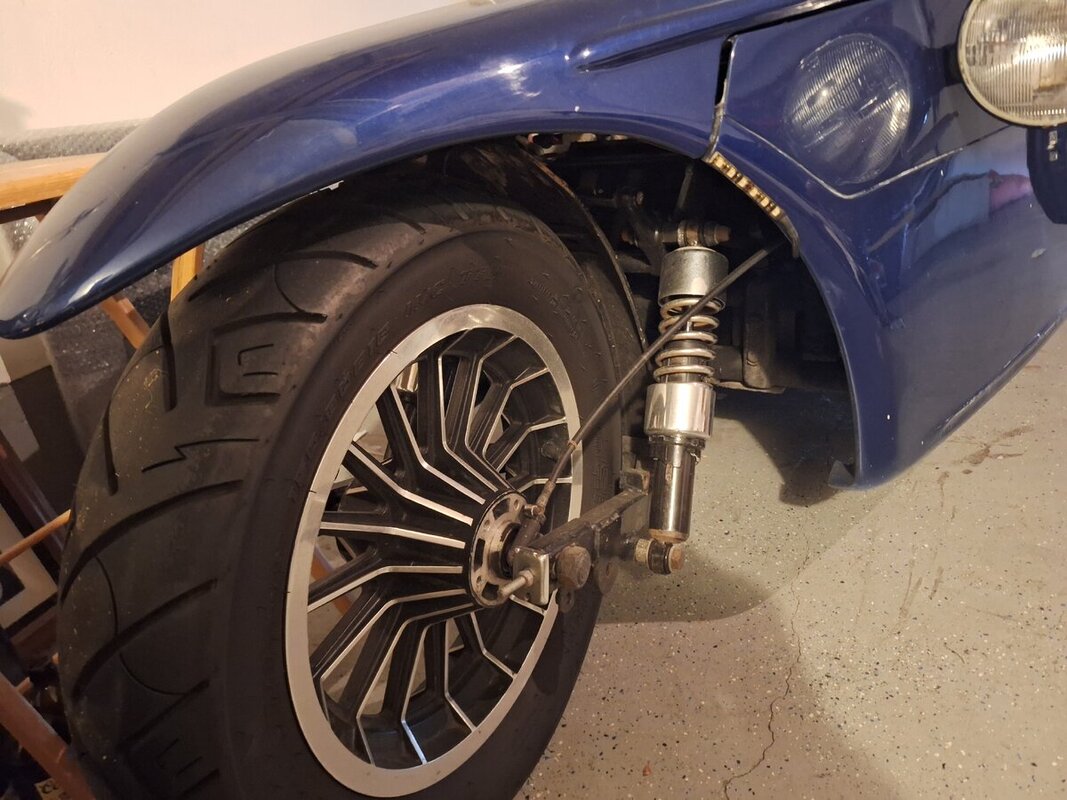

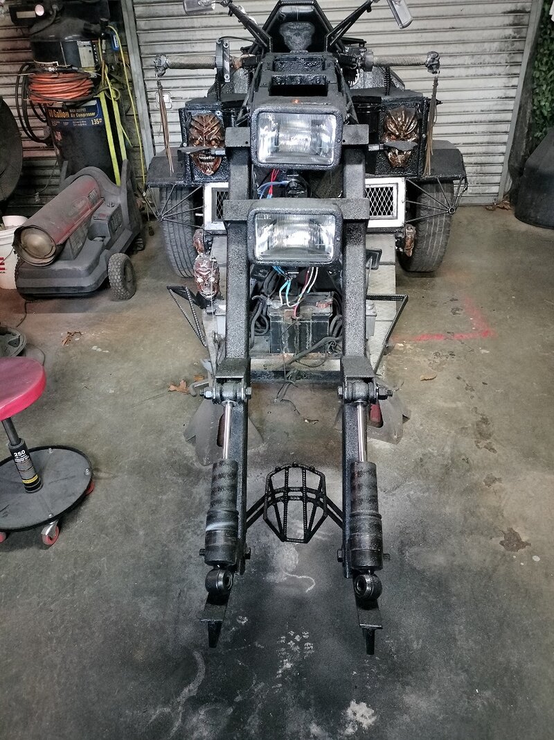

Here's a better look at my front fork set up and straight arrow front suspension
Interesting, I see that your triple tree plates are welded together and the neck is slid in between the 2 plates. I actually thought about this but decided against it. How is your steering setup? I see the 1 arm off the top plate.

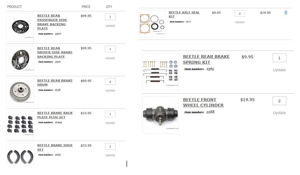

I am not going to adjust the left spring yet. I still need to do a rear brake job and adjust the camber. That is not the next job yet though. I am working my way from the front of the trike to the rear. I do know I am going to replace the brake backing plates, adjuster springs, brake pads and drums.

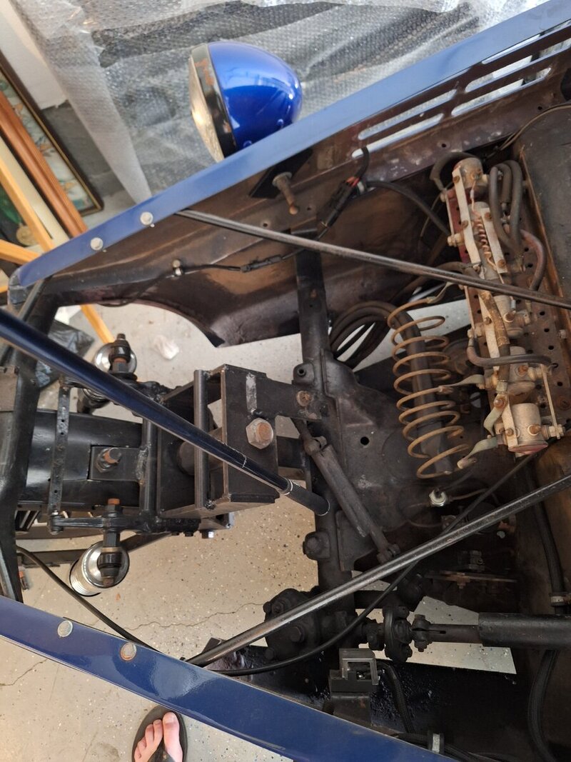

Cleaned up the battery area yesterday, I originally had another horn and more light in front but I took them off a log time ago. I cleaned up the wires. I also mounted the shocks and wheel again. My son noticed my headlights are a little crocked so have to look at that today. I think today I will tackle the stereo. At some point I have to work on the fender. It has some big pits in it. No cracks though.
This steering set up my dad figured out is absolutely amazing. I'm not the expert on this. But I can get it up to 80mph and take my hands off steering wheel and it goes straight as an arrow. Absolutely amazing
I'll take better pics of the steering arm down for you and post
