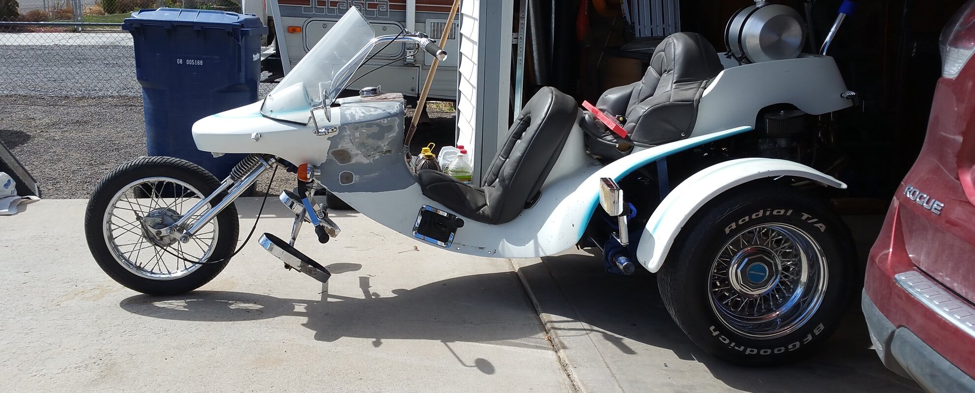

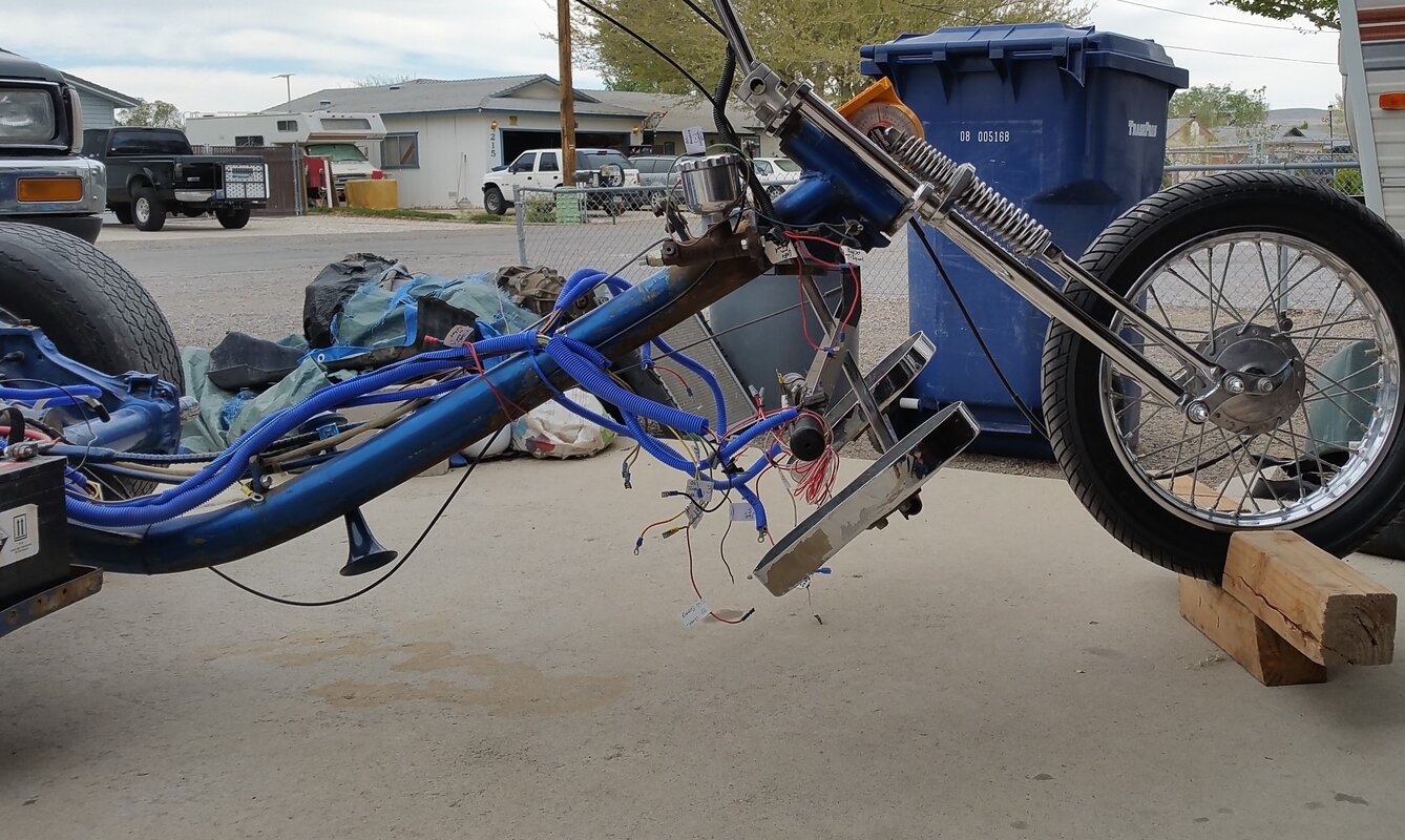

Okay so I do have a older pic, before I cut off the side lights, and when you look at the front end and body it does not look right.
and the side view in that same position.

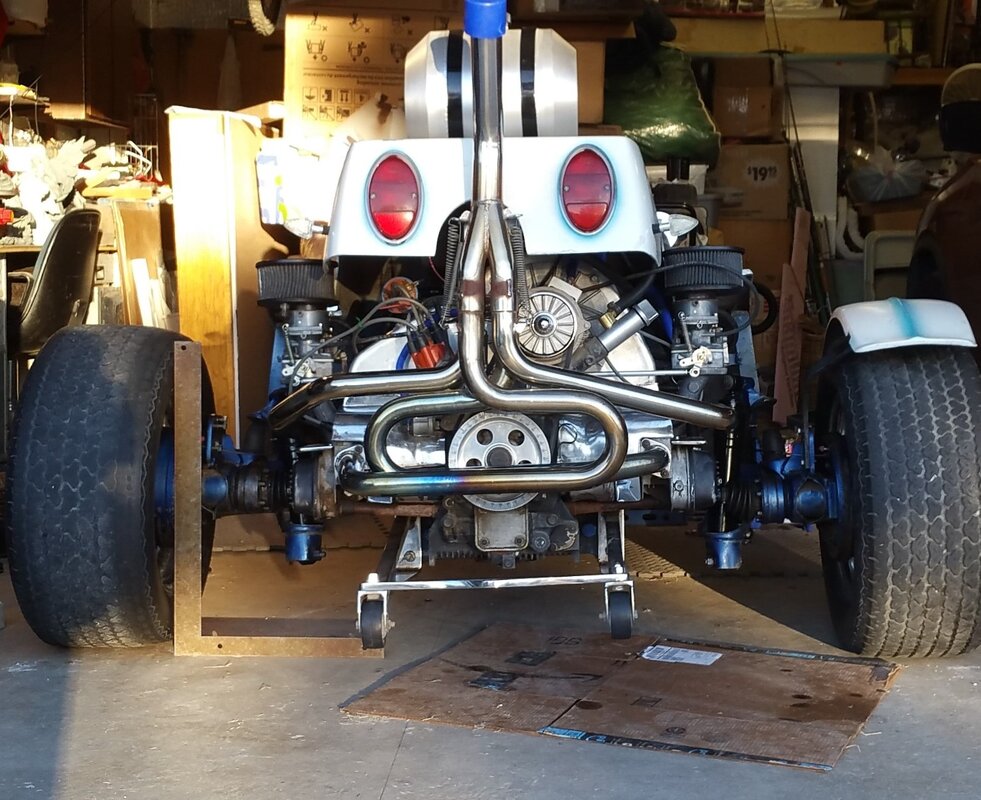

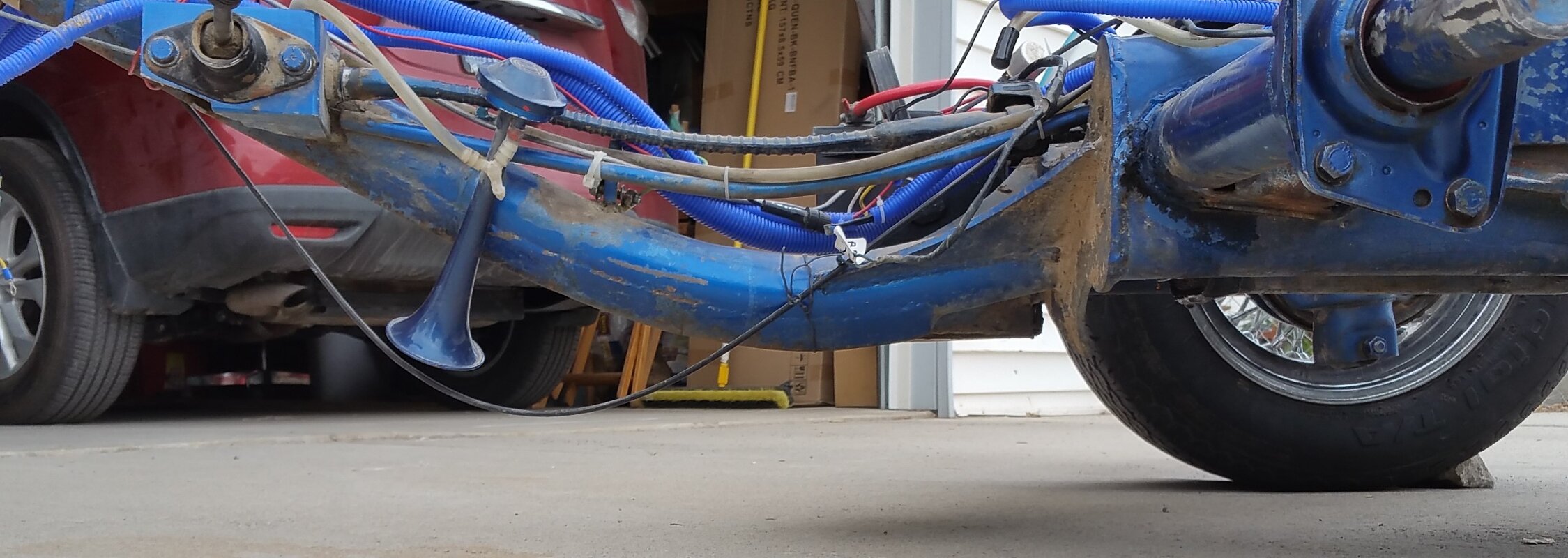

The negative camber on the rear right is bad, looks to be a bent trailing arm at the bearing hub. I have been told a few ways to try to straighten them, because the left has the bend starting also. Could see if a nice used pair are at the junk yard or some VW yard. Means I will have to weld new fender mounting flanges, maybe lower shock mounts, so this does raise the question of changing the drums, go back to the short stub axle and newer hub. I think it can wait until after I figure out the front end and riding height.
Pics with out the body
A look at the rear, do not ask why, but I went +10 inner and than -10 on outer splines on the torsion/spring plate. I like the tension of the spring plates, maybe just a littler stronger, but air shocks match up nice at his point and I like the level is sits at, especially when I raise the front end 3.5 inchs. Pics without the body.
This has a 45 degree rack at the neck with the rear set as stated above.

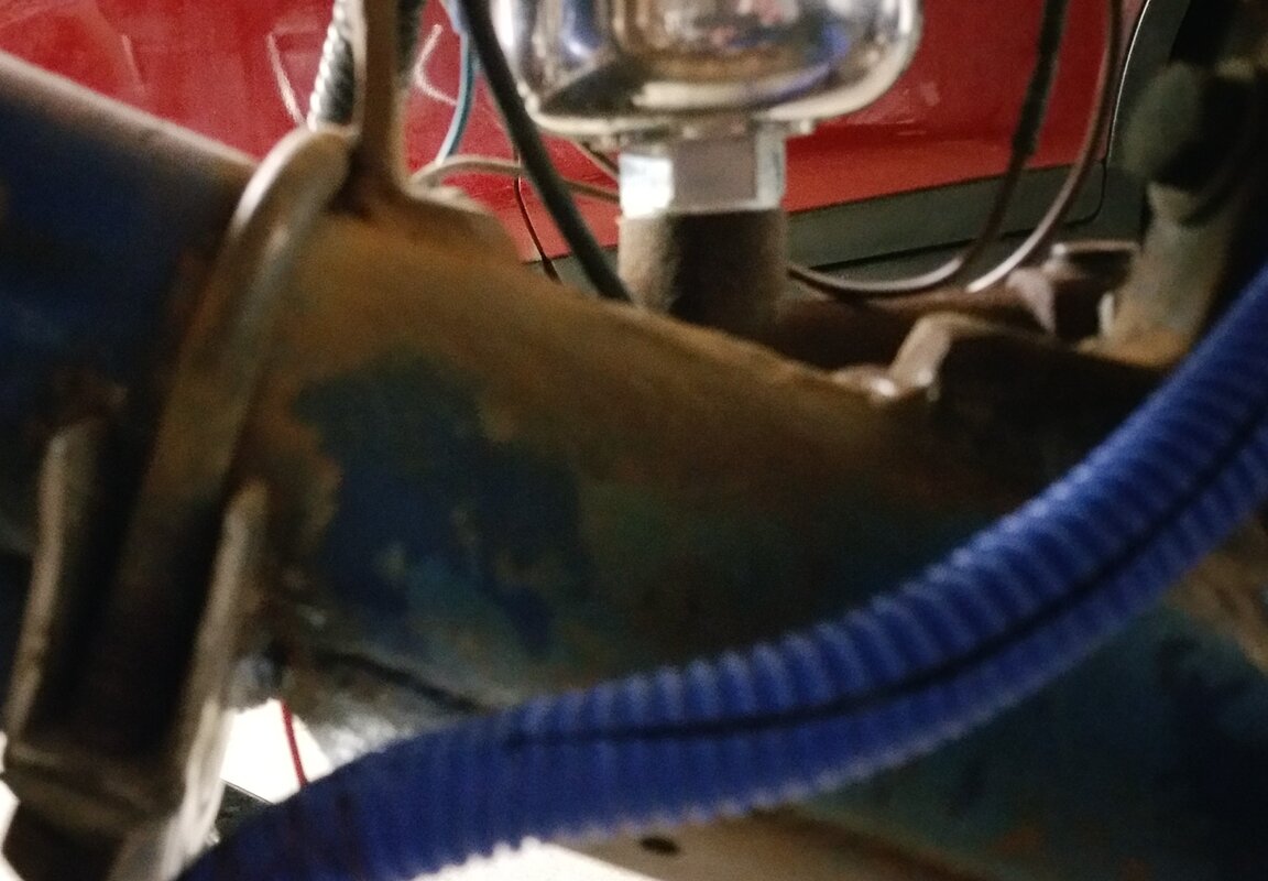

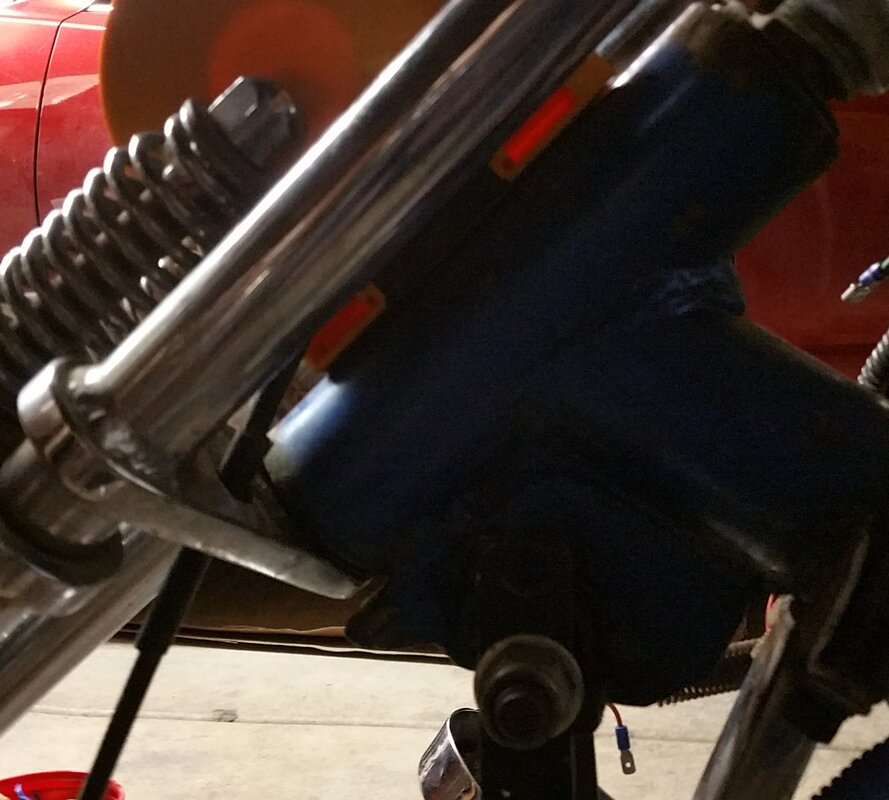

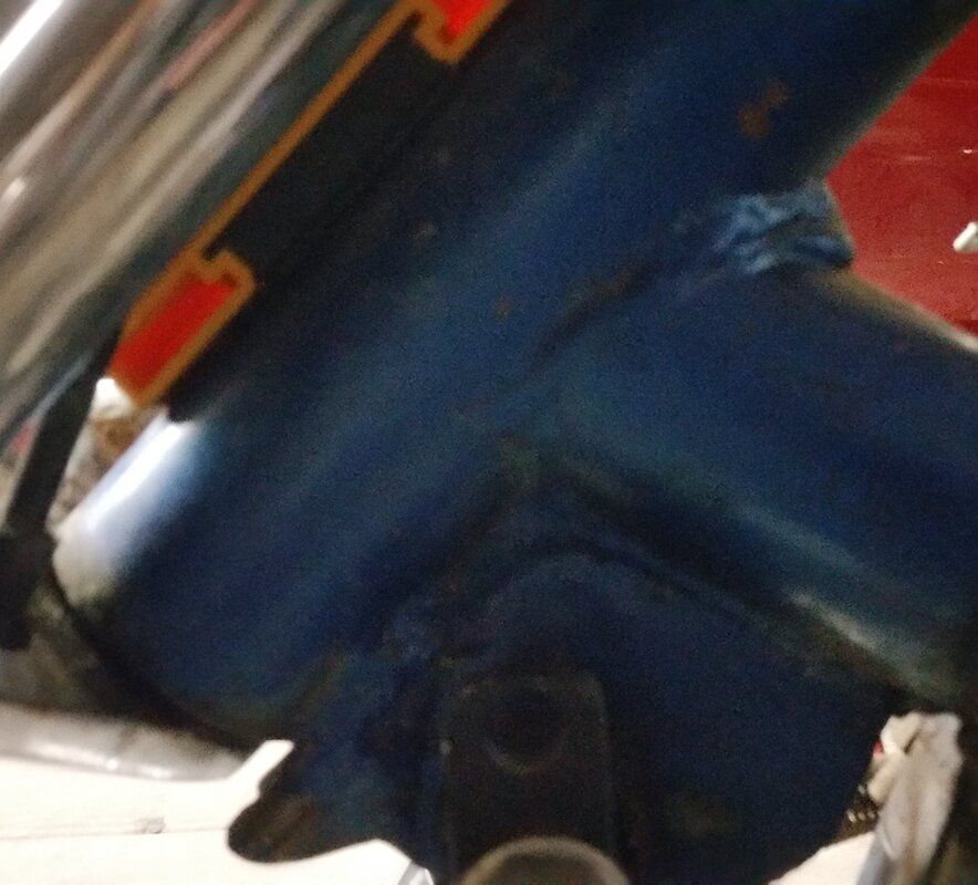

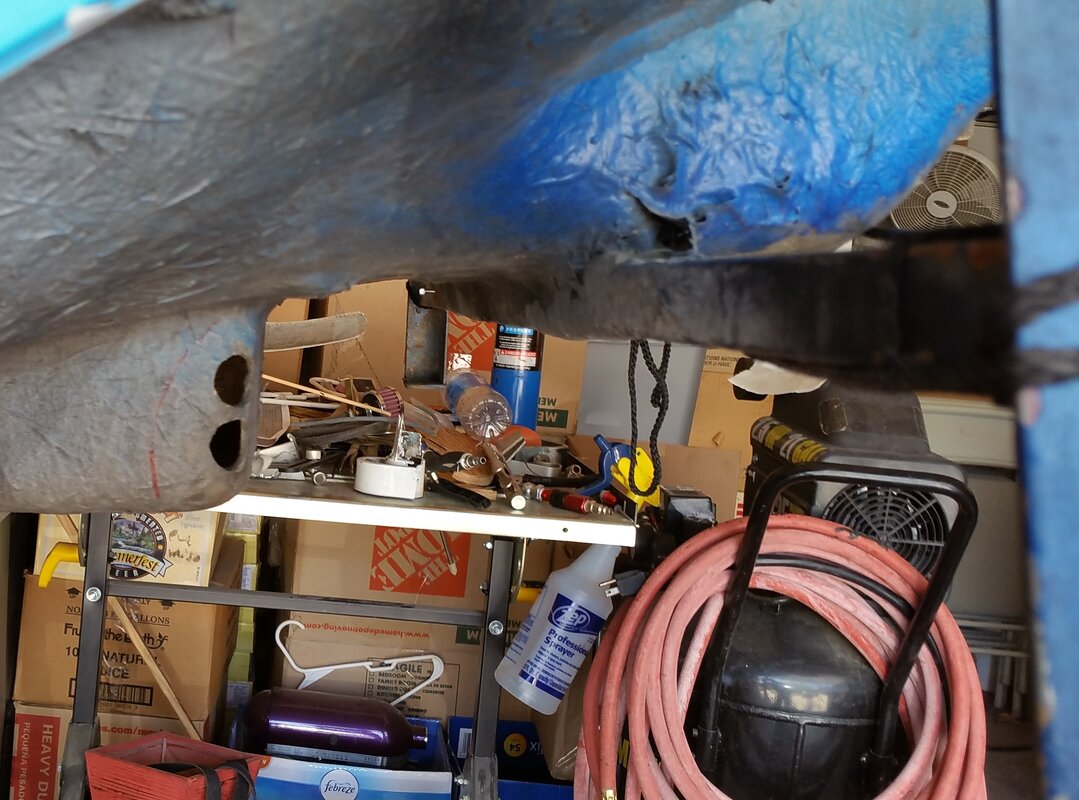

I do not see any crack in the welds or signs of bending at the neck area.

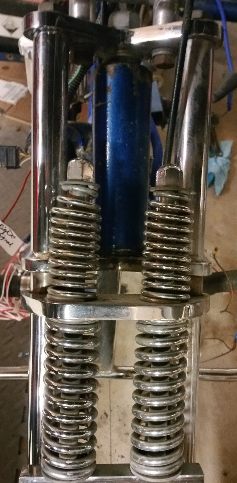

This area is a bit questionable, just looks bad as no real clean up when the welding was done, and could be attached in another fashion I am sure.

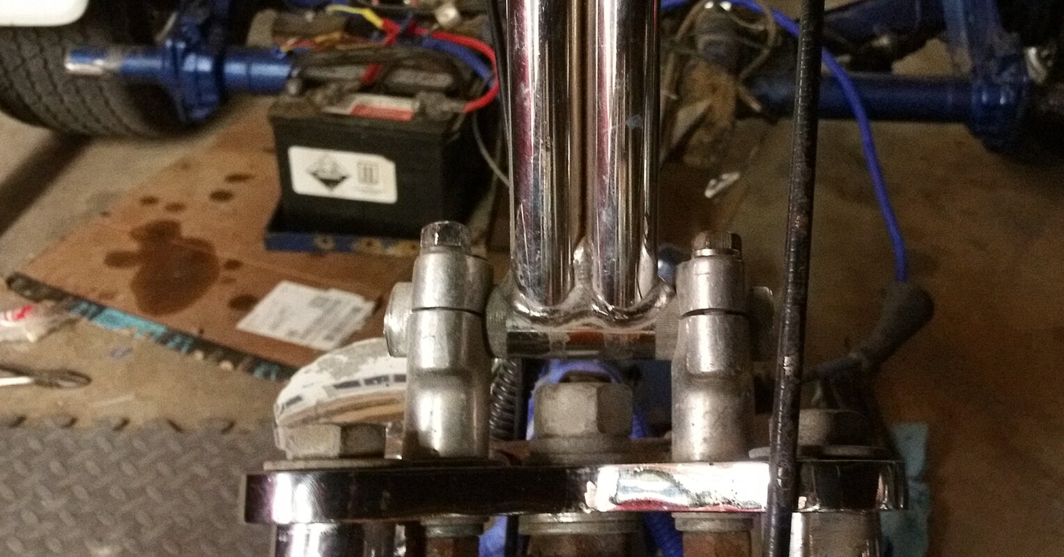

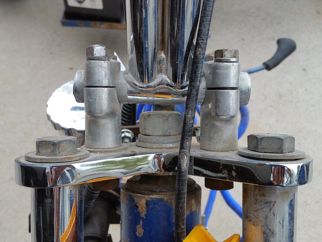

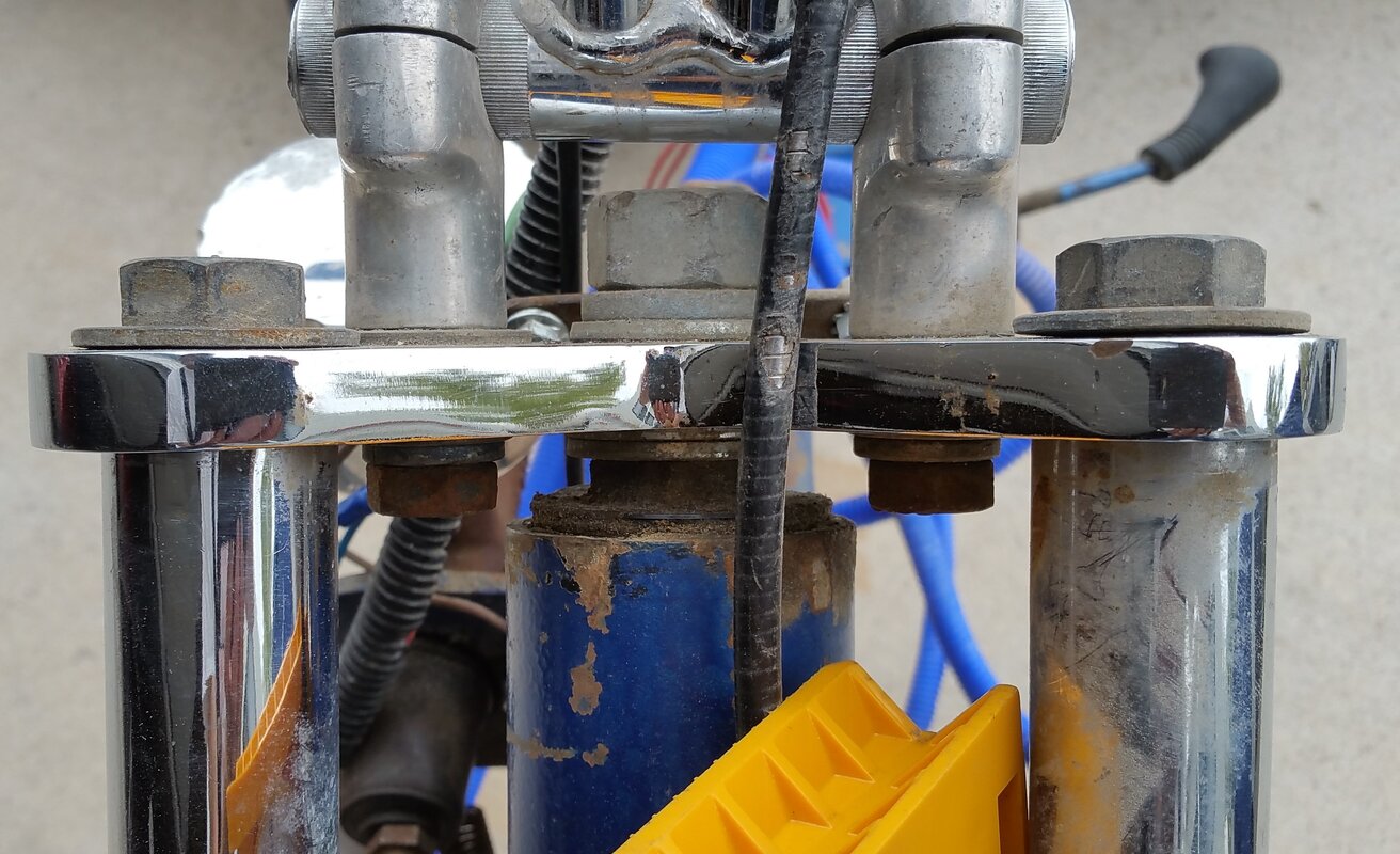

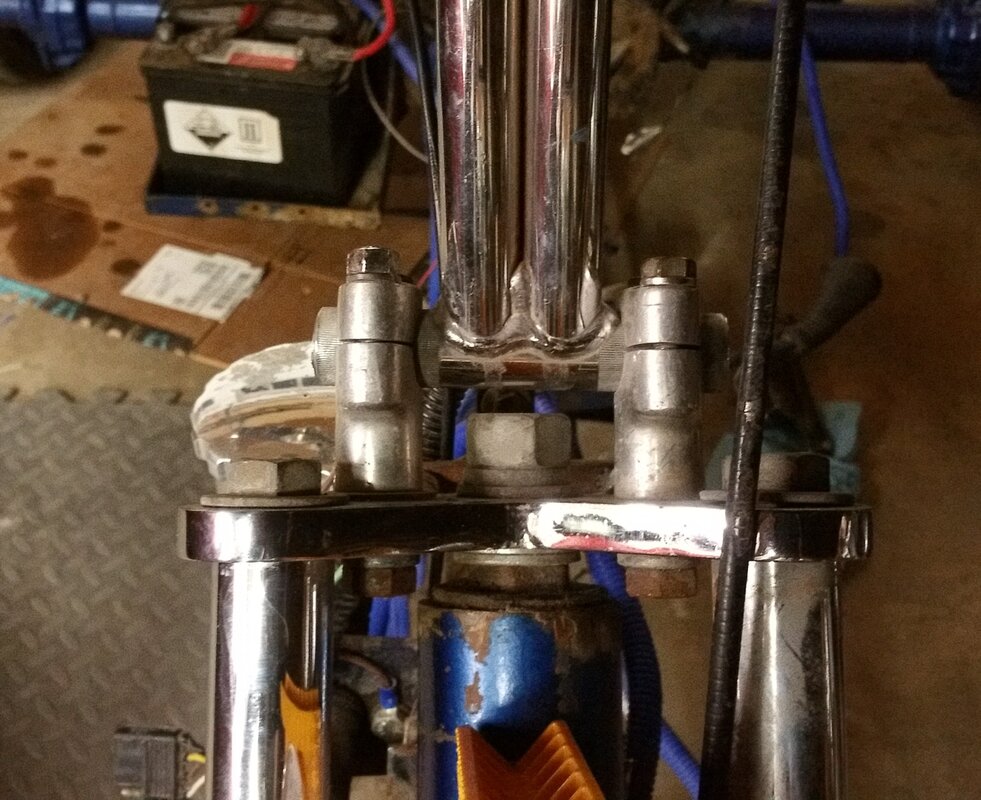

Now these top trees just do not look straight to me, but than again I thing the top tree is bent on the left side. More pics, need to take care of house chores.
more pic's
Good morning to everyone, I am not sure what pic is worth seeing, so trying to just put up what I think others need to see to help me figure out what I can do.
That top tree does not look right, that section of tree bent, or the top got jammed up on that side, either way I do not think it makes for a stable front end, or an aligned front axle. I always came up about 1/16th of an inch different from left side to right side when measuring axle height on the front tire, could be why.
sizing them to fit sometimes takes away from them, but I am trying.

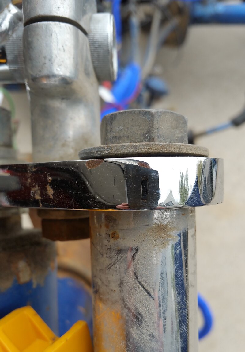

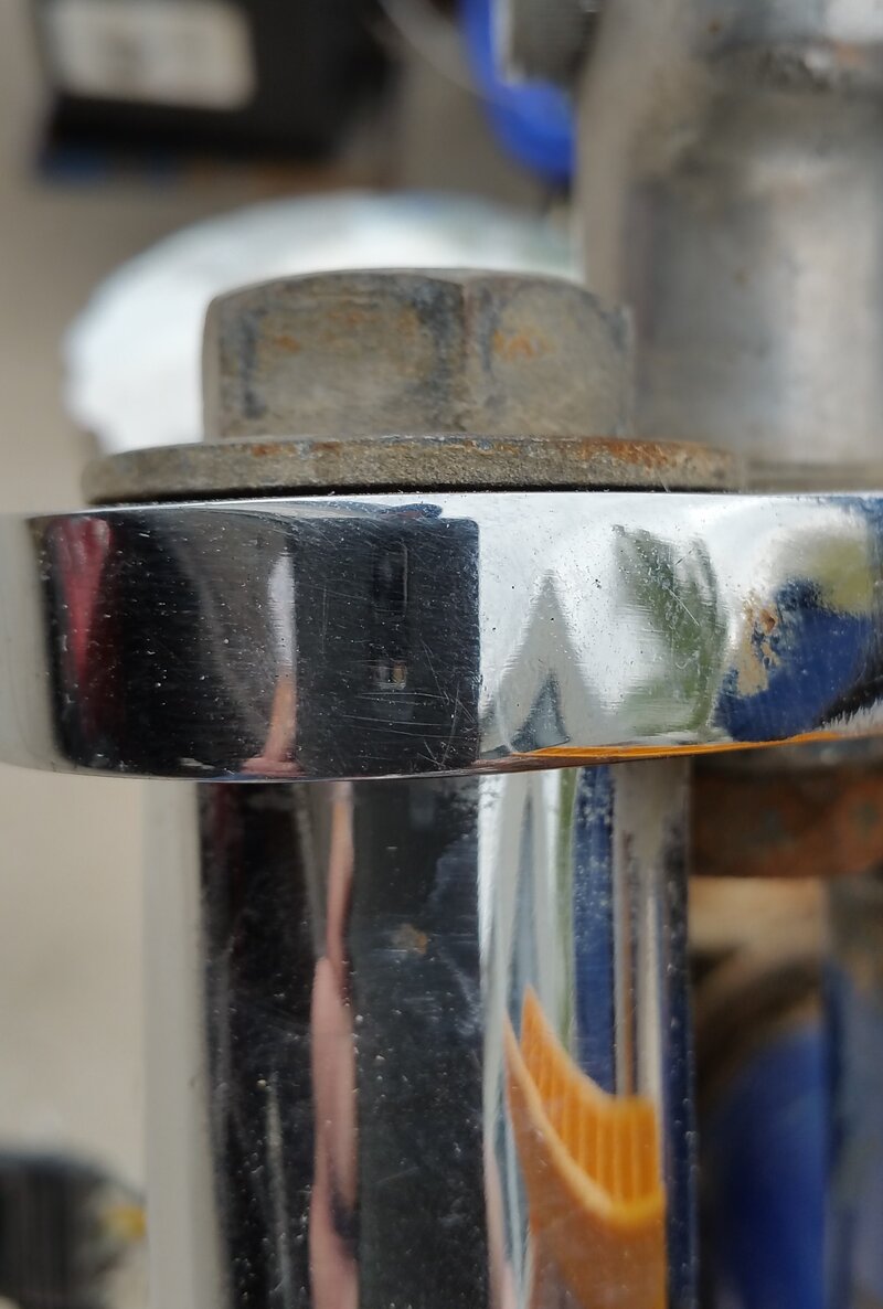

This is the right tube bolt at the top tree.
left fork tube bolt at the top of the tree.

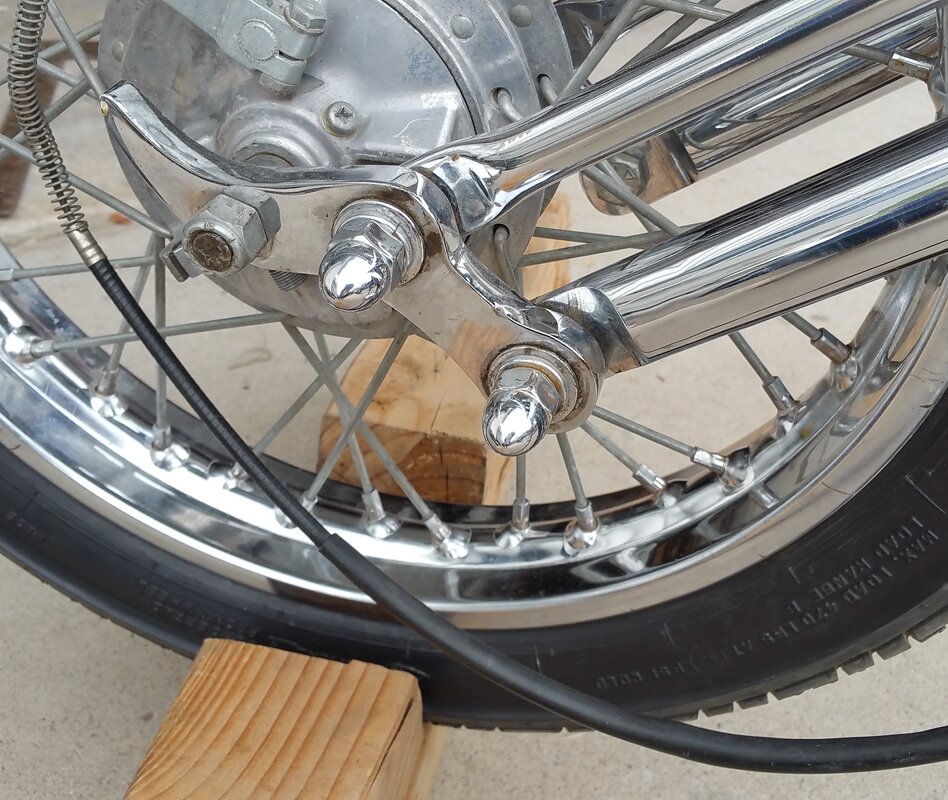

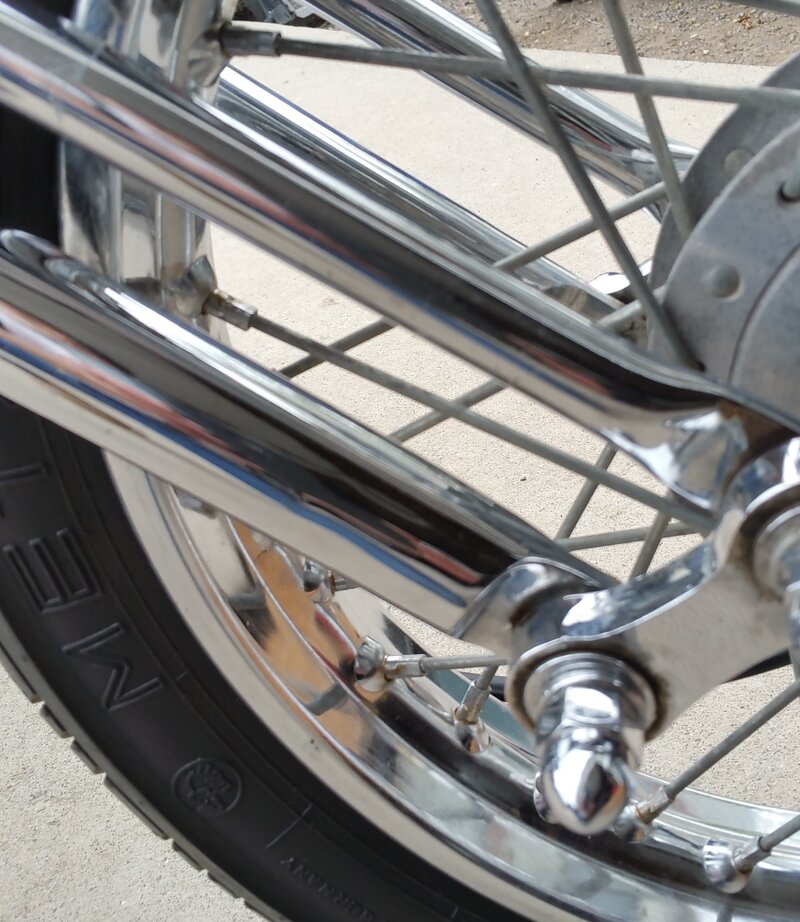

this lower pic is of the tubes near the rocker arm, about 2 inchs up from the bolt hole on the lower tube I can see a ripple or maybe just a blemish in the chrome.
now a pic of the left side fork area, it kind a has the same ripple look to it, good chance where work straightening was done.

the frame exsposed

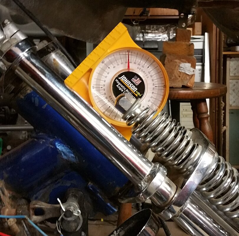

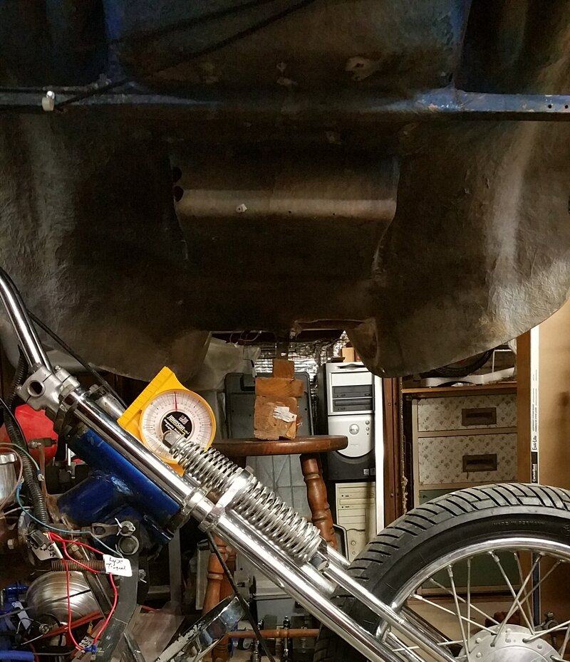

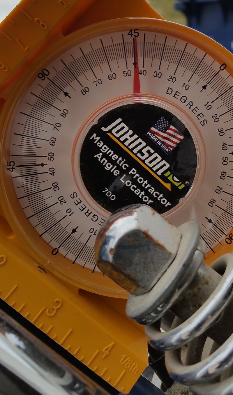

Now some where taken as it rests, than I had moved the front end up on the block and took more pics. The battery box will lean forward with current forks, with them raised 3.5 inch's all looks real close to level.
even with the rear low as it is raising the front end gives the frame more road clearance.

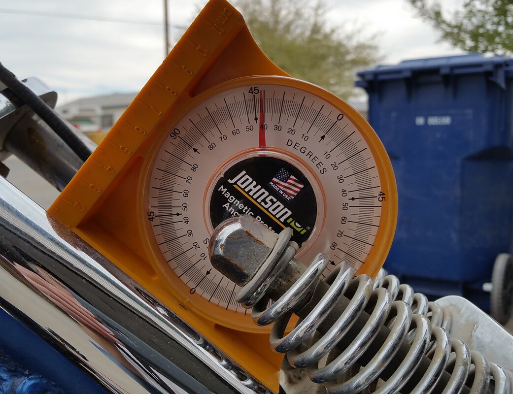

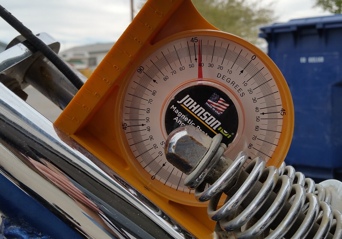

Now it was 45 degrees rake with front tire on the ground, with it raised 3.5" the rake has increased.
I just think the forks are wrong for the rake and to short.

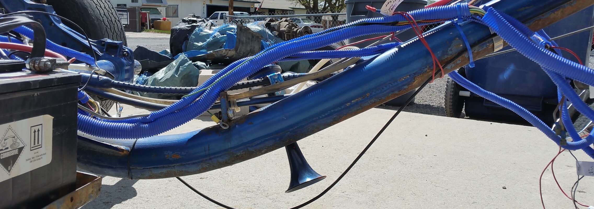

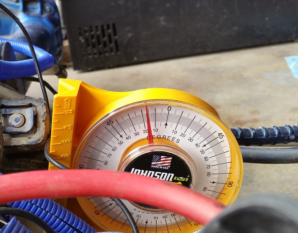

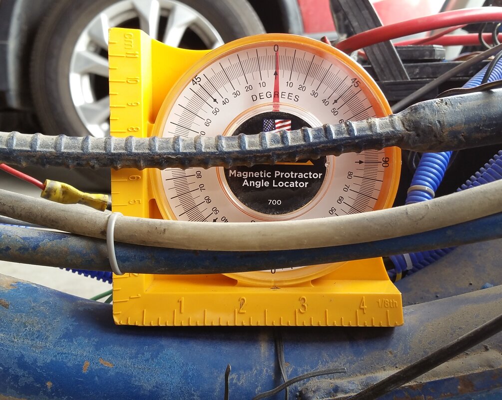

so did not get to really lay all down on the T square yet, but the right side spring plate has to slots and one hole drilled so that bolt is what pretty much fix's how much toe in/out can be played with, also the movement of position of the axle to center line. The left side spring plate is 3 slotted holes, has lots of movement, and also has notched plate that seems to align with welded beads on the hub mount plate. Got side tracked sorry.
Look at rear when front is raised 3.5" and torsion/spring plate is set at +10 -10

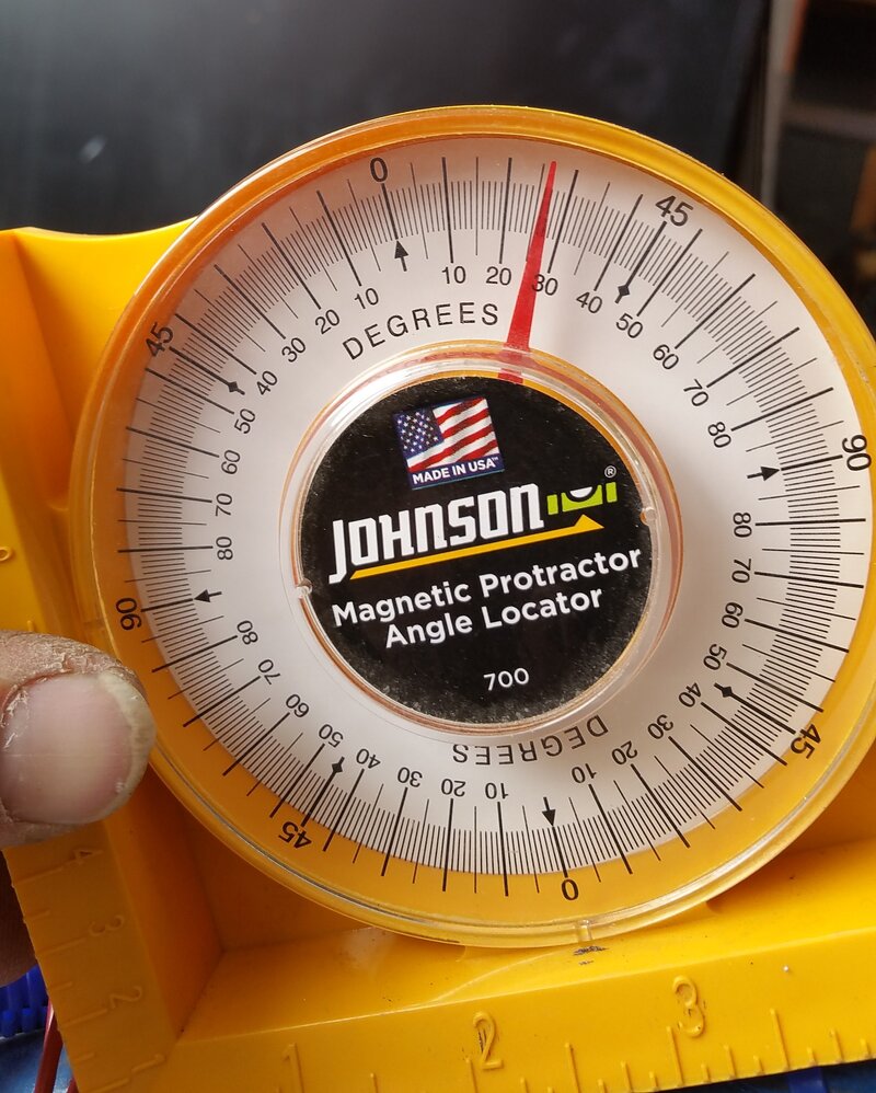

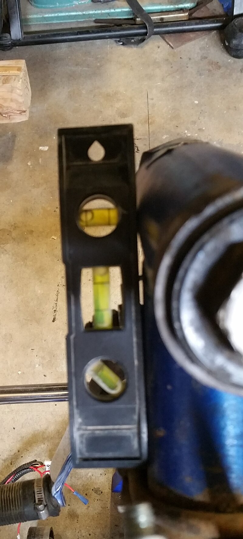

Now below is the angle finder setting at were the IRS beam and center beam meet.
And now I moved up to the bend area.
and now I moved up to near mid of the center beam, brake line a little in the way so I had to hold angle finder on beam.

Not that I like spending money, but I think new forks are in order because I need them a bit longer and I do think offset trees are in order so the forks are more at 40 degrees rake, regardless the trail is the secret, so the offset angle depends on what is needed to get 0 trail if possible.

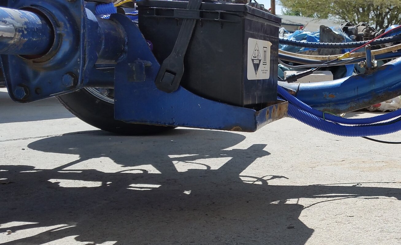

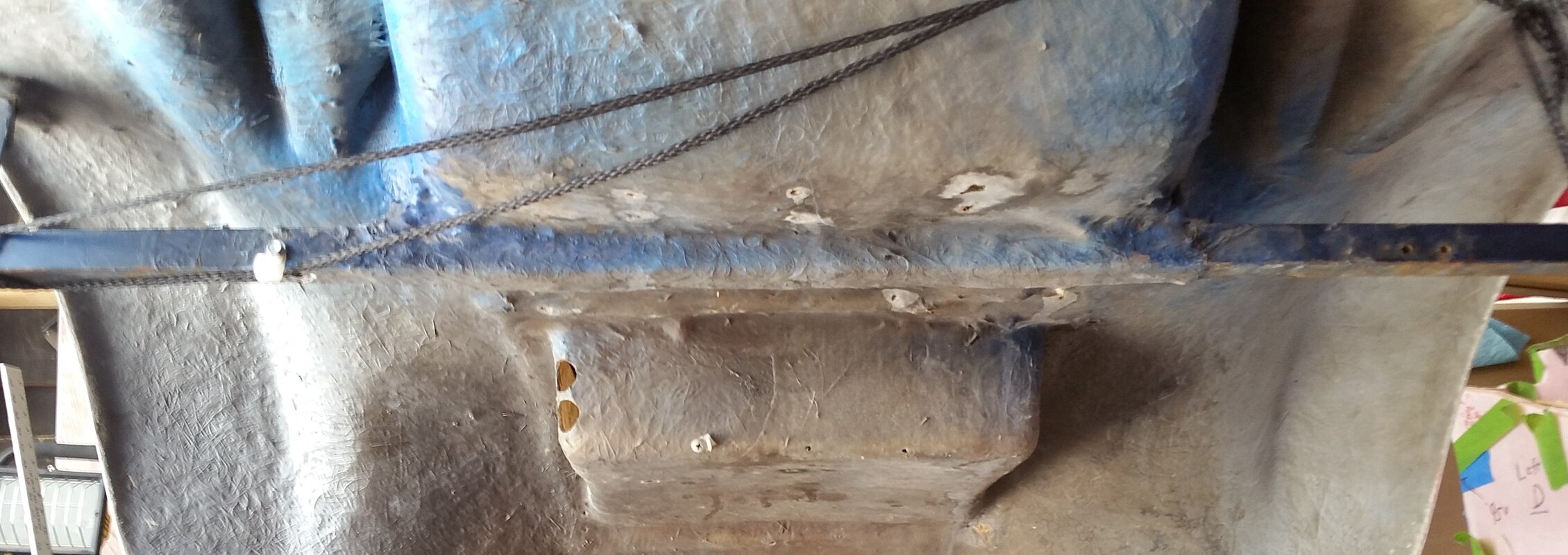

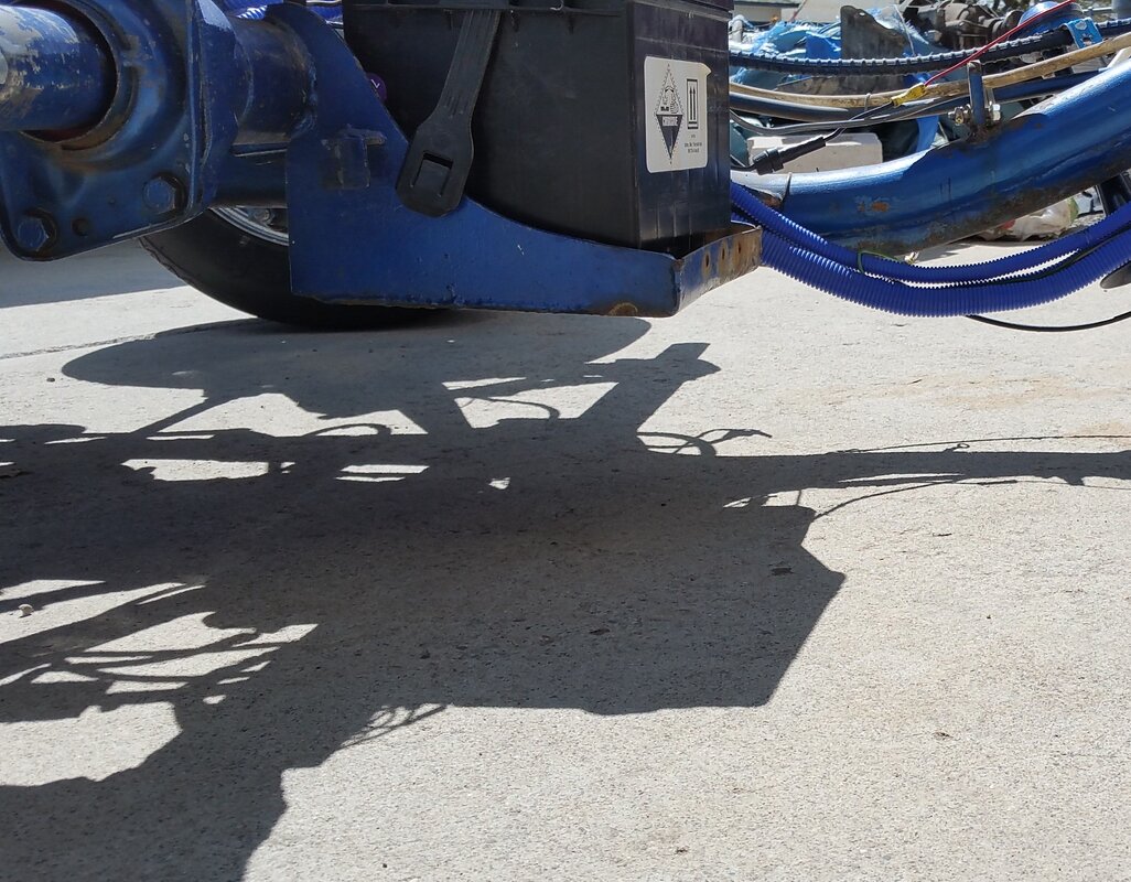

maybe a gas tank location
now that the body is off the frame, or should I say as I was taking it off I started looking at an area for a gas tank.
The rear cross beam that supports the body would be the mounting support for the tank.
At first I thought a 6" dia. tube would fit, but it is just to tight, so how does one maximize this area, a rectangular tank.
So I have a 4" height limitation issue, could go a little more if I indent the center of the tank because of transmission, but 4" clearance does exist. Now if I cut the fiberglass storage area under the driver seat, which I can, I can put a 7 or 8 inch wide x 4" deep tank across the 38" distance. A few angled pieces and a baffle and one can direct flow to outlet nipple, may cost a little more for that, but the tank would be lower than carb's up out of the way and should hold over 4 gallons of fuel, 4.5 or more if I go 8" wide, need to cut fiber glass out first to see exactly what will fit.
Now one can go off the top of tank near fender with filler neck, put a filler gas cap on the fender, or just have the filler emerge out of one end piece and have it a few inch's above tank level.
A look at the space.
The cross brace is 40 inch's long, and it is 38 inch's long between the supporting uprights used to attach it to the frame, so I think a 38inch long tank is good for the fit.
You might be getting away from yourself. Looking at too many trees at once will obscure the forest and overwhelm. It sure looks like something is tweeked in the pictures but pictures can be deceiving as they are a single perspective view at a specific point in time. It looks like you have one of the early Roth clones because it very closely copies the dipped round tube for the main frame that Roth used. Many other clones used a square tube that came straight out of the torsion bar assembly level to the ground.
As I understand it, Roth's original (first) frame had an even more pronounced dip as it left the torsion bar assembly and went forward. I read in an article that he found that there was a problem with the low seating in that he was virtually invisible when riding to the right side of most cars! Apparently he had some "exciting" moments. His subsequent frames had less dip and a higher seating arrangement. Here is a copy of the figures for his patent application.
If something is tweeked, it is probably not the main tube as that should be 1/4" thick tubing.
My money would be on the springer. The only way I know to check the springer is to remove it, disassemble it, and lay it out, piece by piece, on a good straight surface and take careful measurements. This will allow you to take comparative measurements between the fork tubes and the neck tube. If you use a small lazer level you will be able to project the lines out farther to reveal any runout or tweeks. Springers are notorious for bending/breaking just below the bottom triple tree especially when installed with large rakes. Beyond its crash history, a few hard wheelie landings will also take their toll on the springer.
When you have the front end off you can also check the frame neck alignment. There is a good discussion of how to check it over in Fowler's 88 Blazer trike thread in Home Built Trikes forum.
You might not want to do any more in the rear until you can verify that the front isn't tweeked. If the front end checks out, you might be able to get the ride height and trail you want by going to a larger diameter front wheel and redesigned rockers. Cheaper than a whole new front end!
Get your layout lines drawn on the floor.
Square up the torsion tube and see if the neck and/or backbone is in the middle/square with torsion.
Maybe the neck pushed over off center?
The fork dont look straight but it dont look bad enough to account for all.
You dont want zero trail. Well.....unless you have mega drop pivot like a sugar bear.
I am under 1 inch but I have significant pivot drop. I did not have the room for enough drop to go closer to zero trail.
I would shoot for around 2 inches if doing a normal front end like a leading link.
Raked trees are hard to figure. Effective rake won't change as that is to the neck bearings. But axle position and trail will change. If you de-rake it with the trees that will make the trail larger.
Do the math.
Where ever you put the neck and angle it is then figure where the front axle has to be. Style of front end dont matter at all but that relationship of axle to neck bearings does.

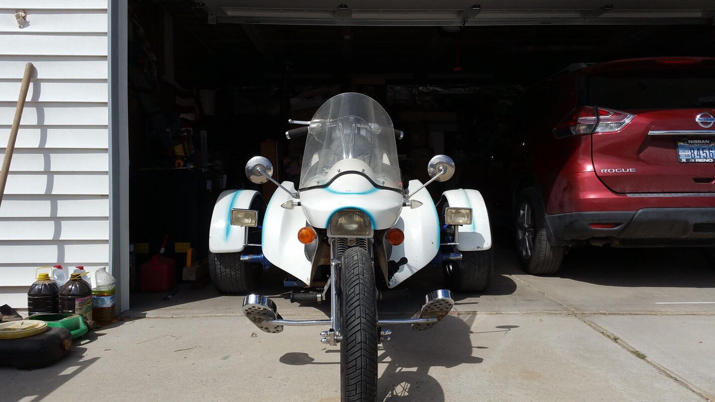

The idea of being to low and "not seen" by the car on the right of you, not cool, need to think about safety also, but first things first, square it up and see what we have, I can do this.

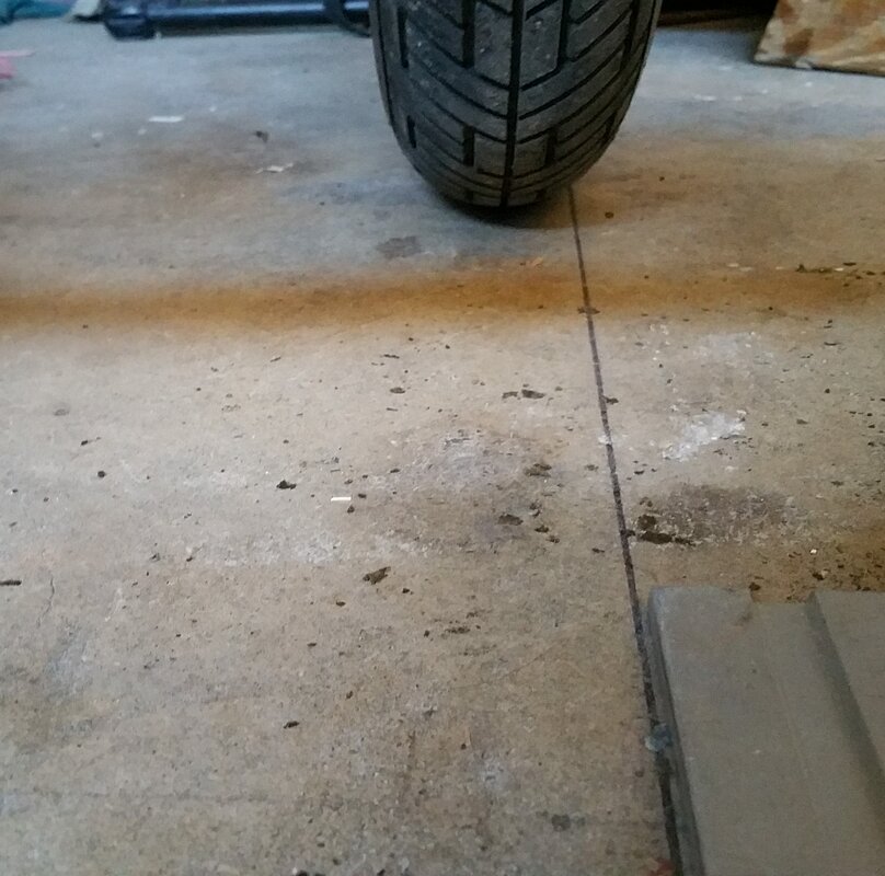

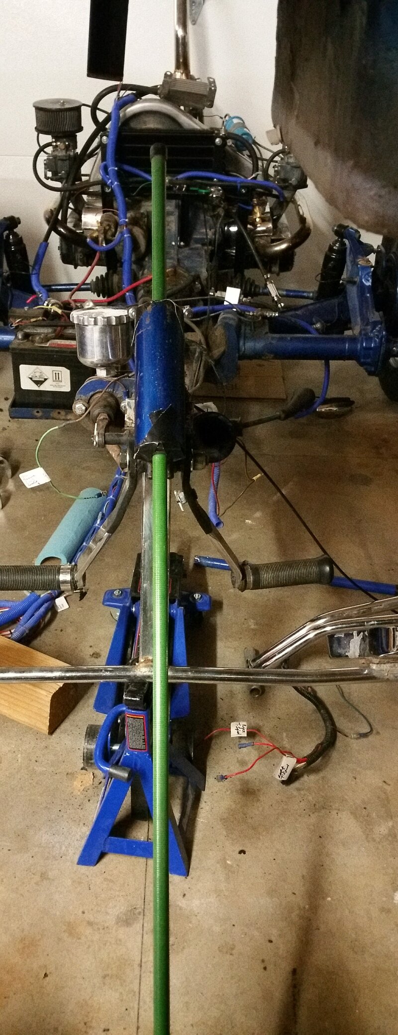

I am back, and I rechecked my measurements of the front end, and rechecked them before doing the trail calculation.
So as she sits she has a 4" positive trail with a 45 degree rack at the neck.

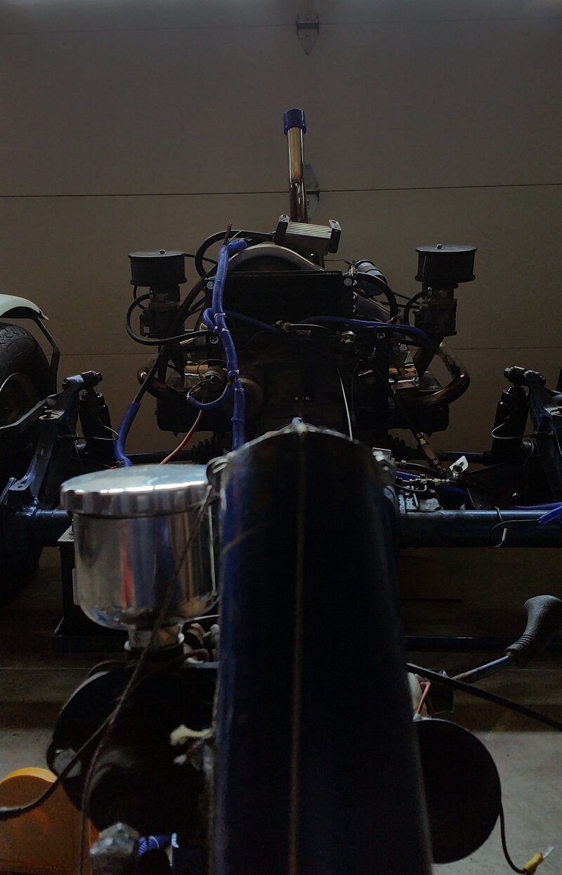

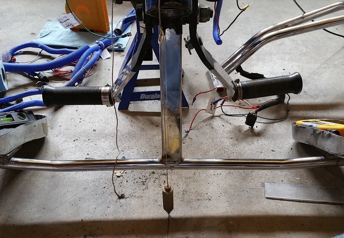

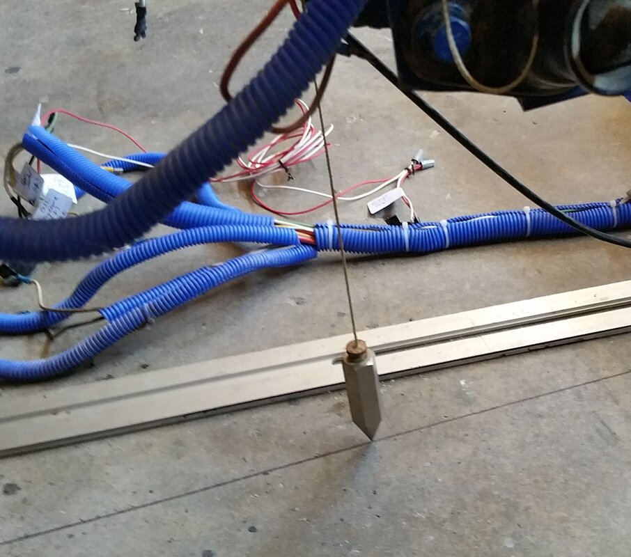

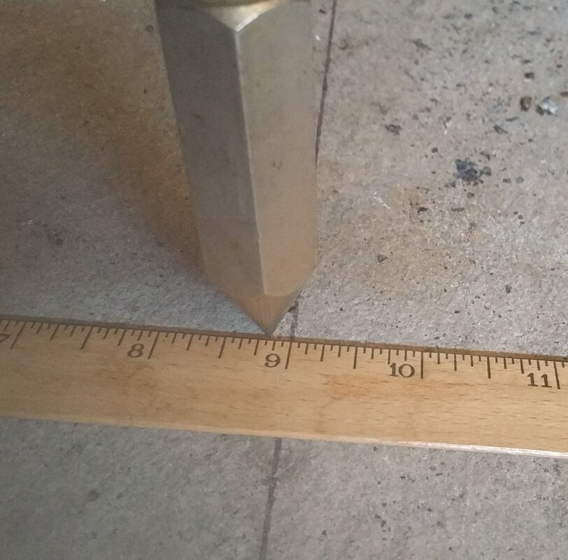

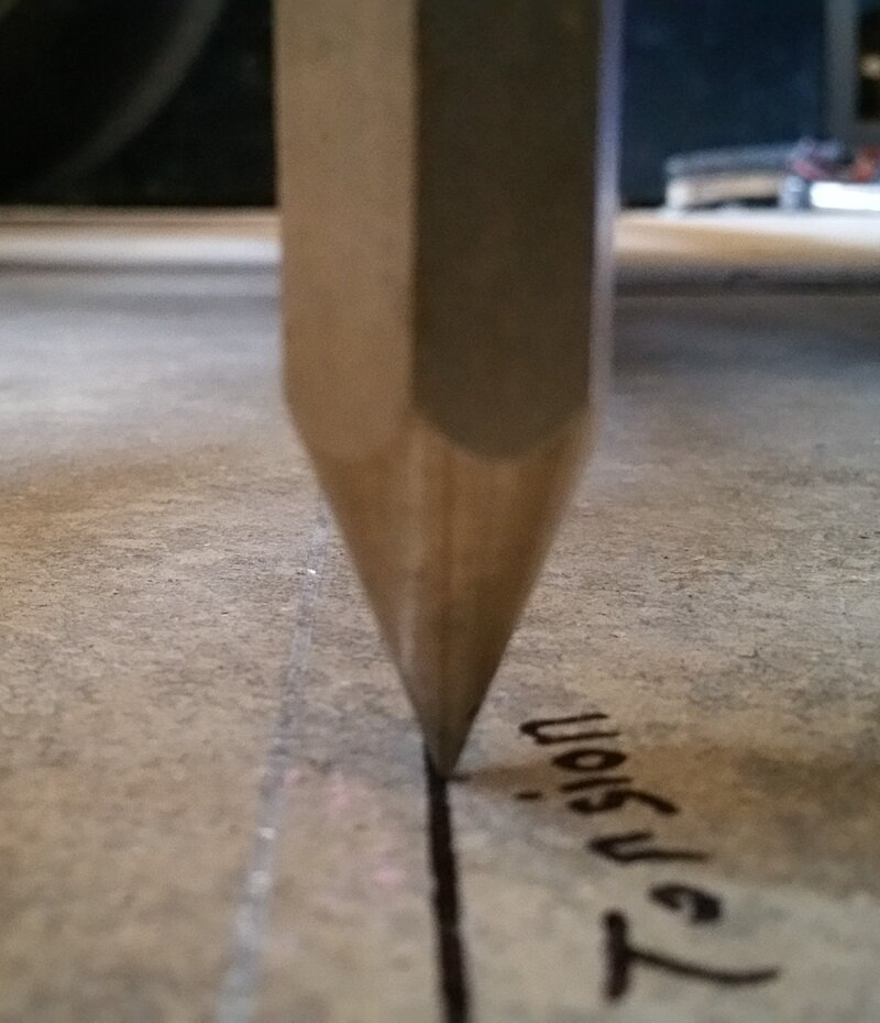

The T square on the floor and alignment of the torsion bars revealed something is tweaked, could even be me, LOL
Left torsion bar aligned to the line on the floor using a plum bob.
and the torsion bar on the right lined up the same, after moving the front end to the left until both torsion bars hit the mark.
Once that was set I checked the plum bob just above the shifter mounting on the backbone.
camera angle off some, but it was on the center line and I was happy. Next I moved up as close as I could to the neck.
tried to keep the string on the center mark of the backbone. This is how the plum bob settled.
which measured to be 3/16" off the center line.

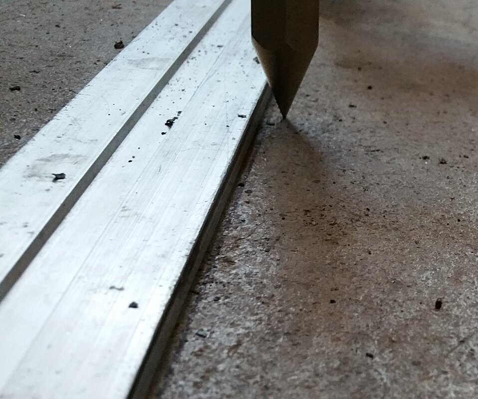

and than I looked at the front tire.
I tried it earlier and thought my lines on the floor were not square, so I had re did the cross line after confirming the center line was straight from end to end, than I did the aligning of torsion and took all the pic's.
I could support the backbone with a floor jack and take off the forks next, sure the bearings could use a cleaning and repacking, but if I lift it up enough I can see if the bearings in the neck are worn, or how badly worn. Also I wonder if it would help cleaned out so I could site the lazer done inside the neck centered and see how it lines up to the line on the floor, also if I had the trees and stuff out of the way wouldn't a long straight edge help me find out if the neck has a twist to it ?
Plus to me it looks like the forks where for a longer neck than what I have, as there is a couple of washers under the top tree taking up space before the neck.
3/16 ain't too bad for something that was hand fabbed. You could live with that.
So it does look like most of it is in the fork.
But yes....do all you can to check for twist in the neck. Drop the forks and stick something through the neck.
4 inches of trail....a lot less than it looked. Must be because it is short. If it is 4 inches you could live with it. As light as it is in the front it will not be terribly hard to steer. Gonna want to flip over to the stops when backing up....will have to strong arm that. But still not dangerous out.

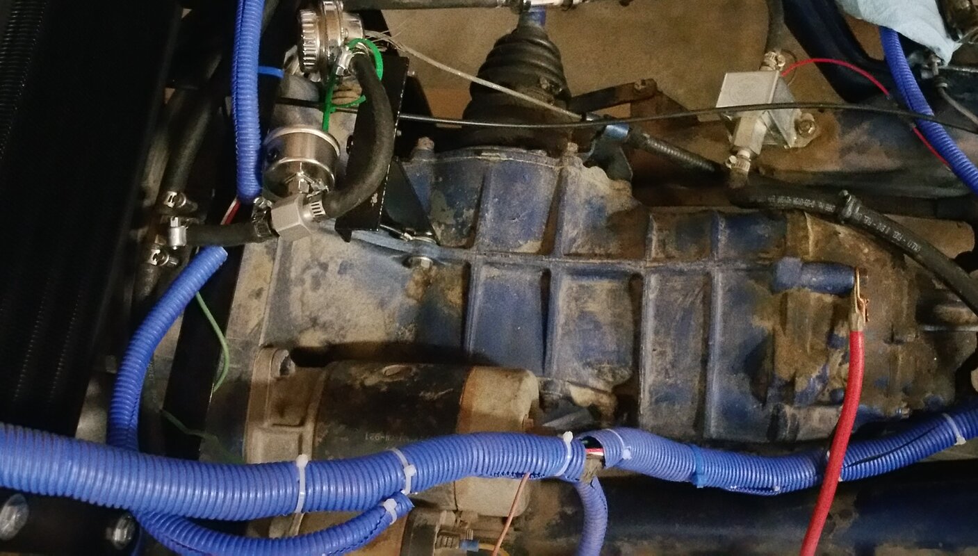

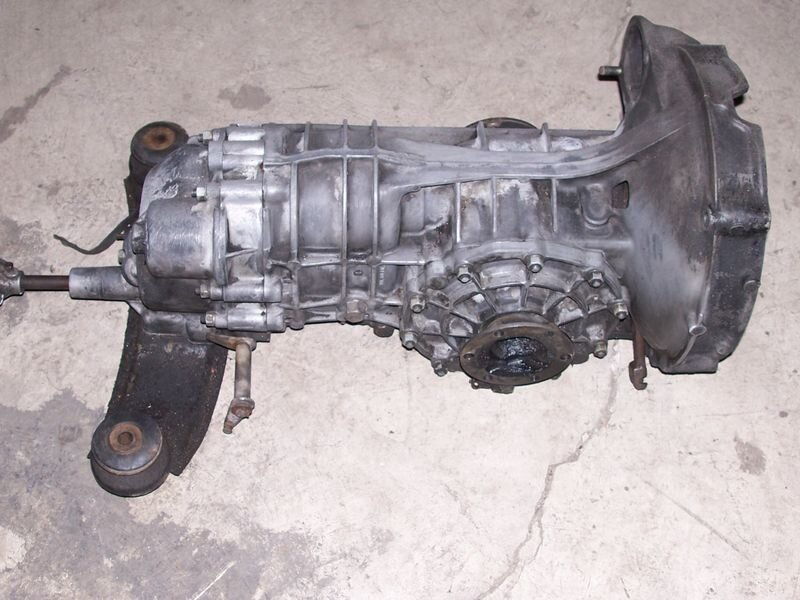

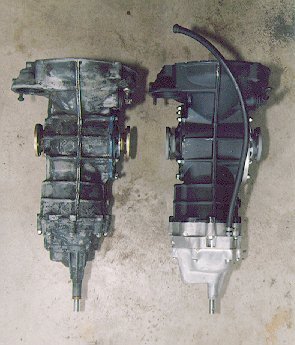

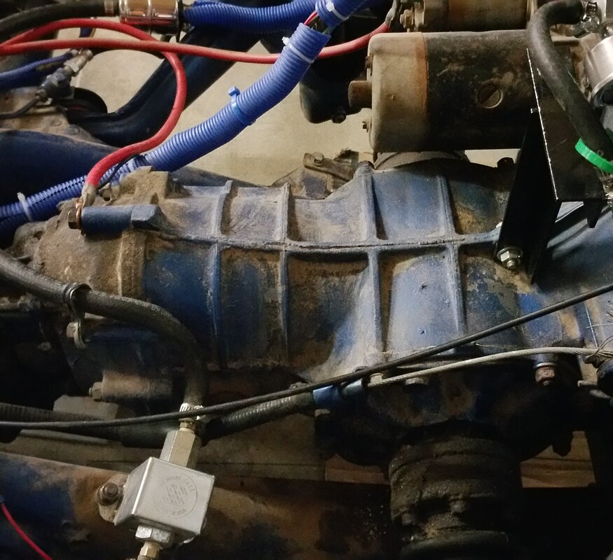

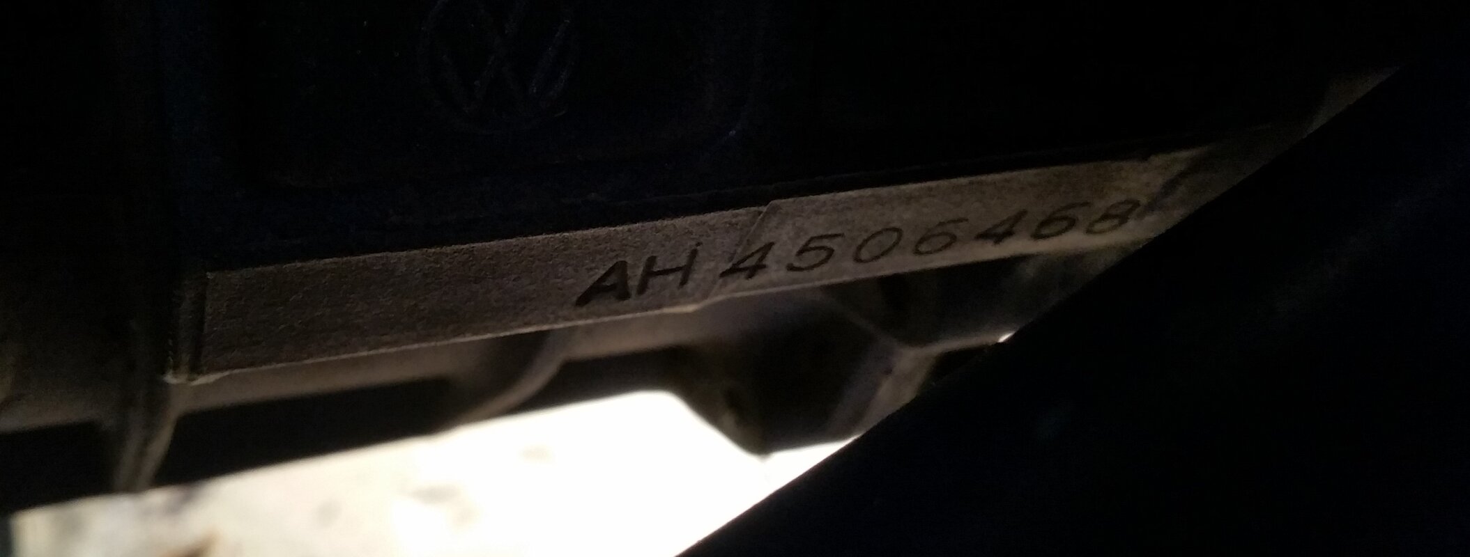

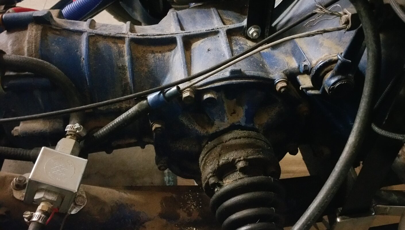

Pics of the tranny, not sure what it is you want to look at, but I read something about the ribs across the back, so here they are.
that is the stamped number on the transmission, was there something particular you wanted a pic of ?
Good to see the Bowden tube is there.
I am gonna guess 70 to 73 model.
4.12 ring and pinion. Do not put low profile tires on it. You want as tall of tire as reasonable.
And
That is not a 5 speed conversion.
It looks to be a normal 4 speed.

I was told it had a 5 speed in it, and to me it does seem to be a 5 speed shifting pattern.
Could a 5 speed shift linkage be used on a standard 4 speed transmission ?
Okay I here what you are saying, but I have checked it out again just yesterday after your reply.
I go from 1st to 2nd down that side of the H leg, stop in the cross bar of the H, push down and go to the left and back down and I am in reverse. Now going over to 3rd and down to 4th on the right leg of the H pattern, all is just normally fine. Now if I come up out of 4th gear and push down than I can mover more to the right and pull back down into 5th gear, so it seems to me. It does not pull back as far for 5th gear as 4th gear, at least that is how it feels and looks to me.
When you push down in that cross bar area of the H pattern, it will only pull back towards 4th gear location, you can not go upward towards third gear.
So this is a 5 speed transmission, or the shift linkage is moving around in a 5 speed pattern that allows on to shift out of 4th gear(normal position)and when one thinks they have gotten it into 5th gear, but the reality is that they just moved the shift linkage around and put the transmission back into 4th gear???????????

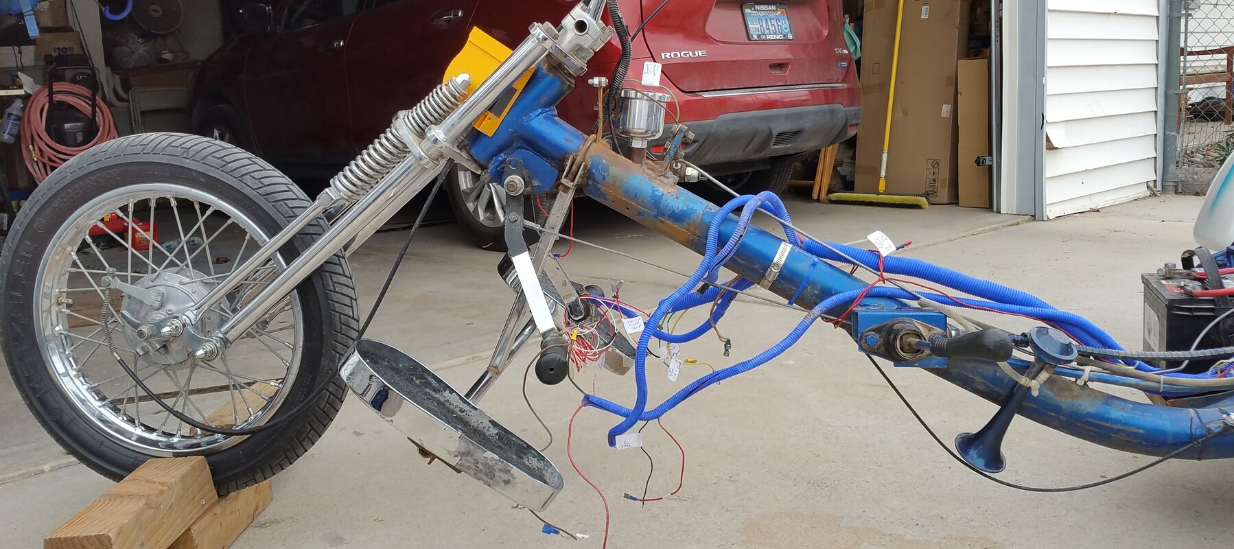

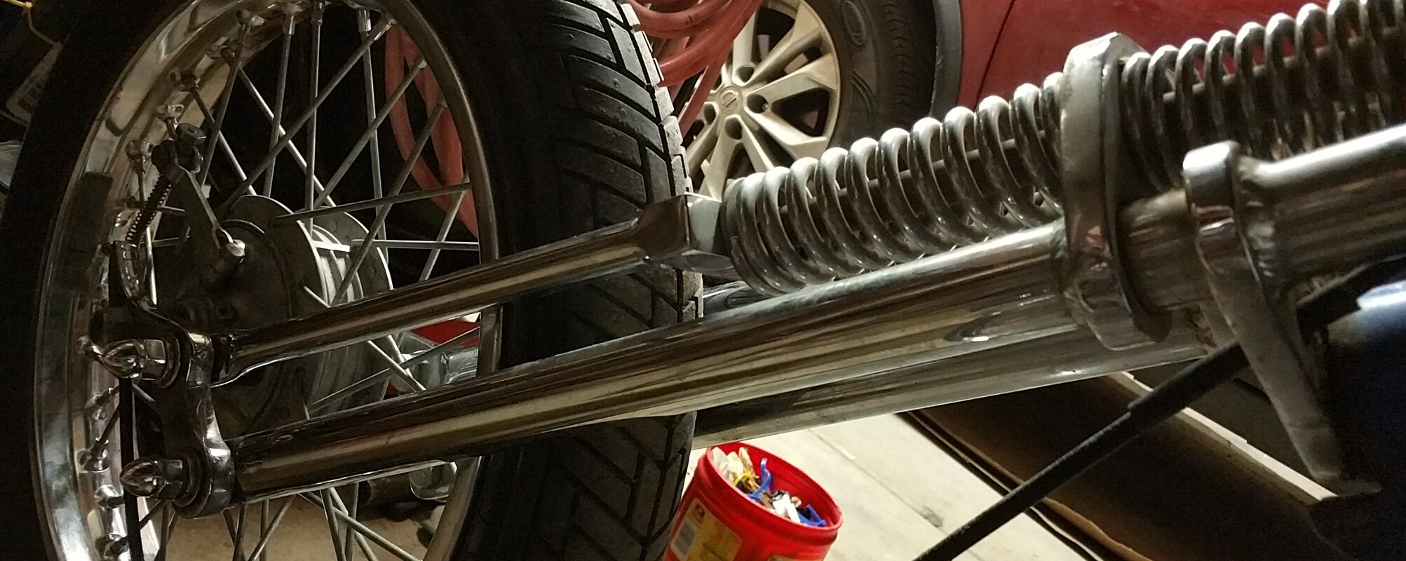

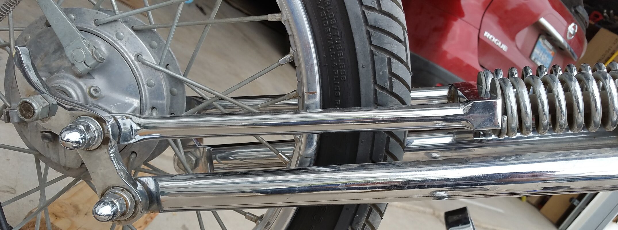

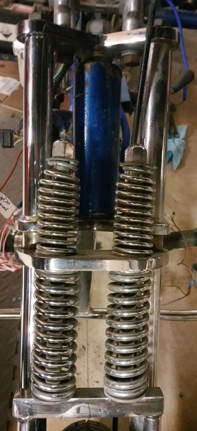

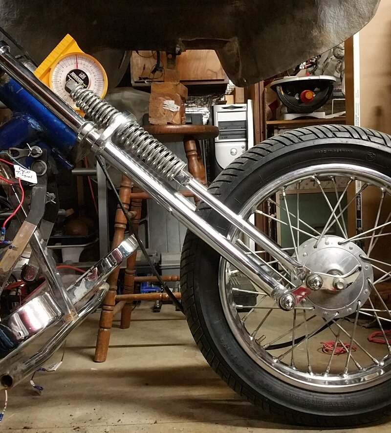

Forks of the trike, they are much heavier than I thought, so short looking, only 29" total length to them.
Now that the forks are off the trike, I wonder if laying the back bone beam on the floor over the center line with torsion bars on mark. The neck would be much closer to the ground so the framing square can be used to see if the neck tube aligns top and bottom to the straight edge of the square. Worth the try as nothing to loose from it.
I do hope all can, and do, enjoy everyday that we have to live. Life is to short not to enjoy it, so live your life and enjoy it.:)
reply
gp61....sorry I shortened your handle but.....just following along here on the short fork and low front end....just a thought, but if you found neck alignment "off" you could consider reducing rake to pickup the front end, or possible relocating neck to the rearward and angle enough to raise up. just thinking outloud here on how to use existing forks.
the forks can be checked and straightened if not too far off. rocker length can help adjust trail also. just my .02 Interesting project you have got going here....enjoying following along!
Std 4 speed next to a 5 speed conversion.
There is not a place to put a 5th gear inside the case. So a lot of pieces added to create the area for it to be in (the silver bare aluminum)
The Porsche 901 does come close to fitting. But is hard to find and even harder to afford. It even looks like the conversion vw trans.
I was not doubting what you said, I was wondering why it shifted the way it does, which leads one to believe it is a 5 speed transmission.
Looking at a standard 4speed up against the 5speed, a very noticeable difference for sure, plus the need for the extra room makes total sense. I do not think I need a 5 speed, but it did sound nice and it would help when going down the Freeway.

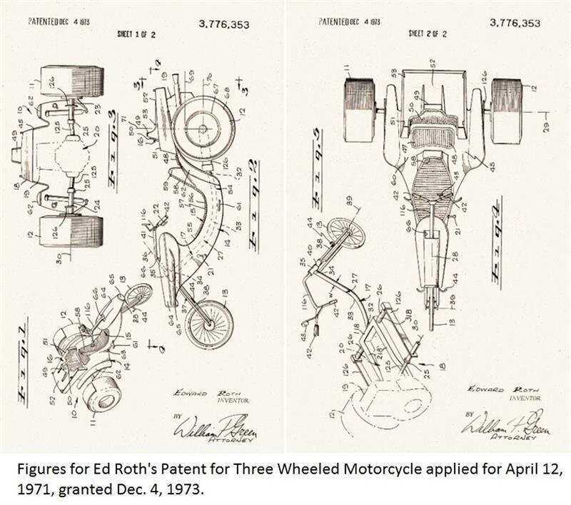

Okay, I noticed the patent drawing, further search got me to download a copy of the entire thing I believe. It has been a interesting read for sure, and the inventor had a reason for it to be low to the ground, but to low is a hazard with other drivers, so he had to change a little from his very first design.

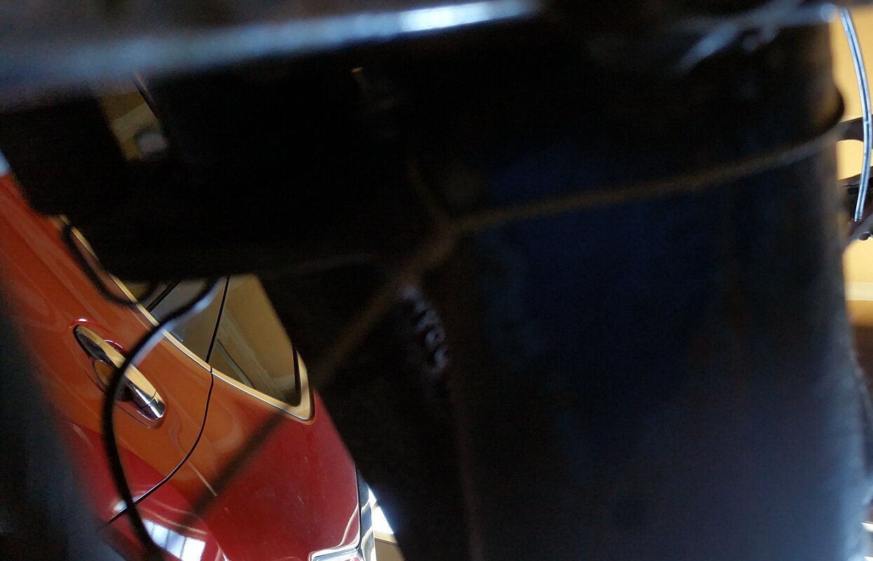

Here is pic's of what I did yesterday.

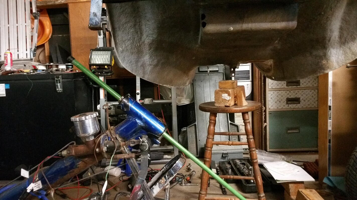

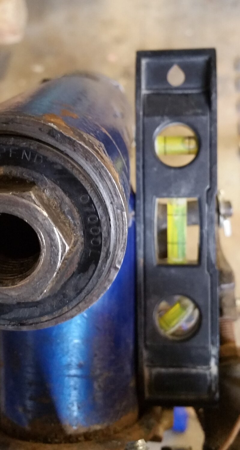

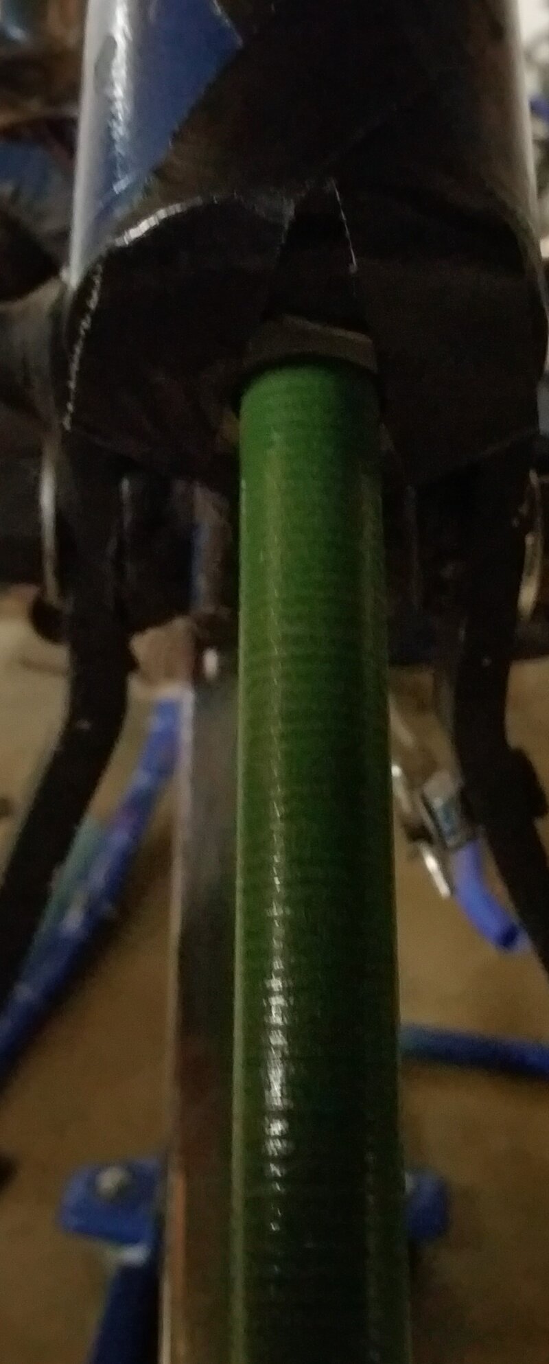

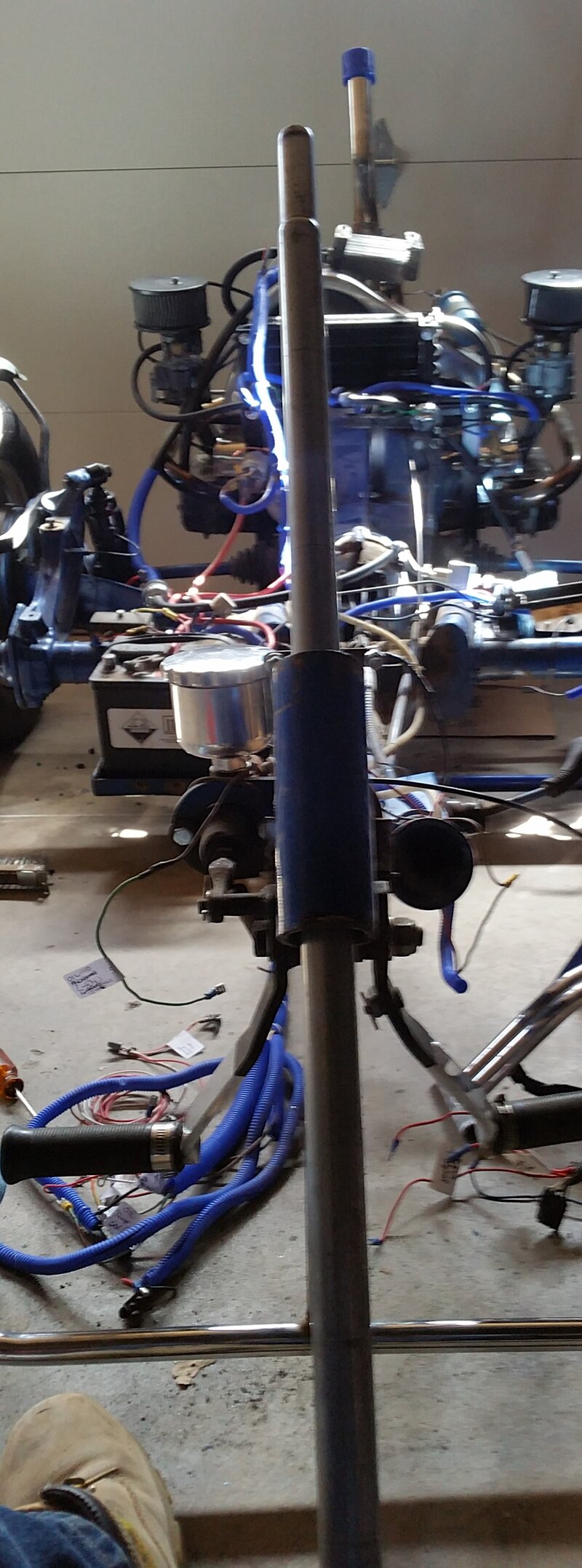

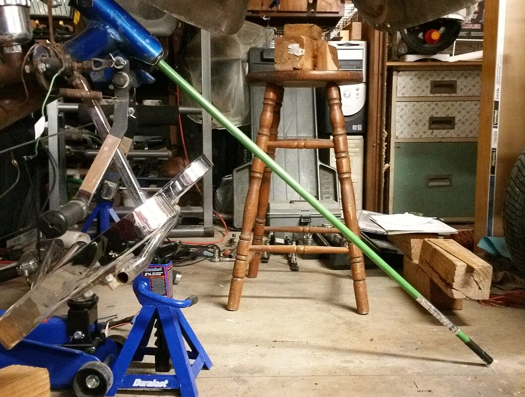

I tried to center this pipe down inside the neck tube as I slide it down to contact the floor.
and we always have to check our alignment of the T bar and floor line before looking at the neck for anything.
So you can see the foot rest assy. does not align perpendicular to the plum bob string.
I put the top bearing back in the neck tube, aligned the points on the nut to form a center line at top, ran the plum bob string and had to keep moving it to the right ( if I was sitting on the trike ) in order to get the plum bob to align with the line on the floor ( yes I checked floor lines with a lazer light )
I tried to stay square with the camera so this pic might reveal line of sight of top of neck to rear center of engine/tranny.
I will hopefully get to the forks today, see if I can see any real out of wackiness that maybe exist. I have to get a few other things done first.
Now as you jack up the back bone the rake angle changes on the neck. Above pic's have the foot rest on the ground and the rake is near 40 degrees, jack it up to original height and rake is 45 degrees, jack it up more to the height I thought I wanted, and the rack is 48/49 degrees. And of course as this rake increase so does the trail distance from the axle mark on the floor. So reading the patent papers the idea was to keep all low to the ground as possible for stableness and to keep it from overturning during cornering maneuvers. I do understand it, but do think I would like to be off the ground a bit more than what it was. I have to run some horizontal plane lines and what not to see how and what the rise in height will effect. I do not see a few inch's making a difference, but we need to check and make sure that we do not exceed what the design calls for. I do not want to create issues for myself. Just wish the patent had more true figures in it as it would be more helpful. Oh yeah, this trike has the original designed foot pegs that are in this old patent, I had taken them off the trike while I worked on it, plus wife is short legged and I was looking at having to relocate them, or find a second set for her, and a two step method might be in her favor.

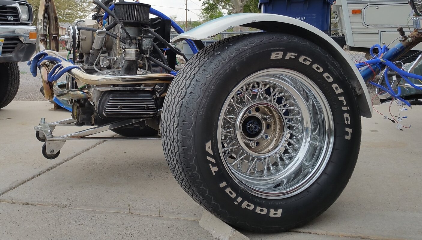

I forgot, DeathSnubySnu, are you saying that the tires that are on it are "low profile" type tires ?
As far as I have found out they have been on the trike from the beginning.
Or are you referring to the 1 inch of rubber around the rim type low profile tire/rim design ?
I have had others argue about this, but VW did make a 5 speed transmission for their Transporter, which was only sold overseas, never in the USA. I am almost 100% sure this is not such a transmission as the numbers do not match up for it, and as I learned a stock 4 speed has one look to it and the 5 speed has a much larger bulkier look. And the public got fooled a bit as I keep getting told that a Super Beetle was sold with a 5 speed transmission in it, yes it had to be ordered apparently, so what they just put the 5 speed up grade kit to the original 4 speed when it was ordered and sold ?
I am not saying I have a 5 speed, I am just puzzled and lost at why it's shift pattern is that of a 5 speed and why does it all feel like it truly is a 5 speed.
I just can not get my mind off of it, how does one get 4th gear into place from two different locations with this shift pattern. I guess it is time to get into transmission design and reading up on what I have to understand it how it works, also I wonder about what damage could be done (if not a 5 speed ) and yet all who rode it shifted and used it as a 5 speed ? Love my puzzling issue.:xzqxz:
I dont know what tire you have now.
But a lot of the newer tires are shorter and wider, somewheres around 24 inch diameter.
Try to stay around 26 diameter of at all possible.
The shift linkage probably has been hacked all up and cobbled back together. It is just sloppy or not adjusted or adjustable.
The late vanagon did have a 5 speed. It dont fit a type one.....but if you want to badly enough anything is possible.
I have not been able to see what is so off that makes your front tire off center so much.
Something is bent on the forks I just caint see it in the pics. That top yoke fitment tells you something is off.
How was the neck alignment with the bar stuck through the bearings?
I never had that much slope in a shifting linkage before, first time for everything and something else to fix.

I just had a thought of a jig to see if main tubes align with neck stem, all are equal distances apart and the stem is center , but the lower tree looks bent on the right side area near the main tube hole.
I did another thread "springer forks", as it is a subject that has it's own world. My mind is still thinking of how to confirm how many degrees off the neck twist is. It will get done, what ever is needed to be done.
A wonderful morning to everyone.
The bearings rest in the top and bottom of the neck tube, guess one could clamp or tape into position as they slide the rod down thru the bearings.
I do not have any 3/4 inch straight stock in the garage, will have to go buy it or borrow it so I can do it:(
I guess one way to do it is with 3/4" all thread rod and if the threads were the same as the top bearings nut than we need only one other nut to hold against the bottom bearings. This would tighten bearings into place as the rod is centered in the neck.
Okay I had a telescopic fiberglass fishing pole, and it tapers slowly from thick to thin like any fishing pole, but the base was large than 3/4", so it centered in the top bearing and it took a shim in the right place to hold the bottom of the pole center in the bearing. It almost went all the way to the floor, guess I could have set the trike on the floor and than it would have touched, but it would not have centered itself on the top bearing, so this way worked out so we can see how it lines up.
20180512_045255.jpg The end of the pole is a bit less than a 1/2" from contact with the floor. I used the lazer beam to run down the center line from the head of the T square on the floor, make sure I am on a straight line.
The out come is "the center of the pole line measured 1 1/2" off to the left of the center line on the floor.
I guess if one ties the plum bob string at the top end of the pole above the top bearing at the up most point, than the plum bob should reveal a equal off set to the right side of the line, hum have to go try that.
Yes this method was not ideal, but I just wanted to get as close to that as possible so that the outcome would be accurate as possible. I know it is off, now how do I re set it, grind the welds to weaken them so I can move the neck into proper alignment, than weld into place ? maybe wrap the neck with a steel to reinforce it and weld that to the back bone as well as on the neck tube where contact is, ideally the front half of the neck tube would be welded to the metal reinforcement plate. Help me.. I see I need better idea's and ways than mine, any thoughts about it ?
I got a head ache thinking to hard about it, after laying down I woke up with a thought.
Wow, it worked and now I know what needs to be fixed. Just how am I going to do it ?
I have a small level that is magnetic on own side. I just stuck it up against the back bone by the neck area and I was able to see the offset neck were it attach's to the backbone. I took a few pics of it.
and for some reason I can not upload them at this time, maybe later.
The left side of the neck tube sticks out past the side of the back bone beam.
and with the level against the right side of the back bone we can see how the neck is off center of the backbone beam, and apparently with a twist from top to bottom, which also explains why the risers off the top tree always looked a bit off to the left, plus I am sure the body was aligned trying to cover it up some, so might have to do some work on that, but first have to get this done.
Rather than cut and grind neck welds maybe you should think about "adjusting" the main tube to get the neck back into alignment. If you've got good welds in the neck area, why mess with them? If you take a big rosebud oxyacetylene torch to the main tube further back nearer to the U bend and heat the tube and bend it there, a little tweak there will make a big change up front. You can attach a come along to the rear torsion tube casting and the neck and apply pressure to move the neck over to where you want it. The main tube is a long lever arm and a "little" force on the neck with heat at the back can be quite productive. Also a movement of 1 1/2" at the neck will equal maybe 1/8" movement 4' away on the tube.
No big rosebud torch? Most welding shops will have one and can handle this part.
gotta agree with vw bug.....can't envision an accident that would cause a twist in the top tube, the light front end of the trike would just slide sideways before twisting that tube, no doubt, construction error. if your frame can be clamped secure to a heavy welding table with a centerline established, then heat about 4/6 in. of the top tube and twist into alignment. most welding shops are very good at getting things aligned, straight and square and plumb.
From what I found out earlier is that it was a fab error, no one knows of any front end damage ever, the person backing into the front forks was kept hush hush, and they were cold pressed once to be straightened, and they do suffer some bend in the main tube just below the lower tree partly because of rake angle when wheelies where done and slamming back down on the ground.
I do think resetting a few mounting brackets a bit easier than the neck job of grinding and welding, the idea of lower back on the back bone with heat is a good one, small amount back there would lead to much more up front. I do like this idea as it is also a open area to work on.

Good morning, I am back, but with not so good news.
I would be throwing the body alignment off if I tweak the back bone back by the curve, the shift linkage bracket and brake master cylinder. Further looking and checking the back bone is square and centered coming of the torsion tube/rear end.
Getting at the very last 1/2 inch of round backbone by the neck tube only revealed maybe a 1/16th of inch off center to the left, so some one screwed the pouch setting this neck. It is just not the neck tube, but the bracket for the foot pedals is off and will also need to be re set. If you just twist the tube to correct the neck twist, than that foot pedal bracket would need to be re set, either way the foot pedal needs to be re set along with neck tube.
After that the foot rest bar will need re alignment so the line up centered behind the forks.
I guess the next step is to find fork length and see if I can find a pair with 3/4" dia. neck stem. I did the measurements, just keep looking things over waiting for new ideas to surface and seeing if they are viable ones.
