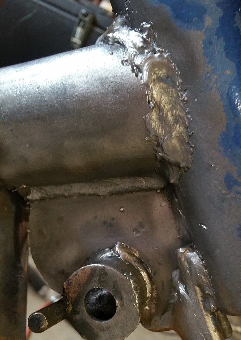

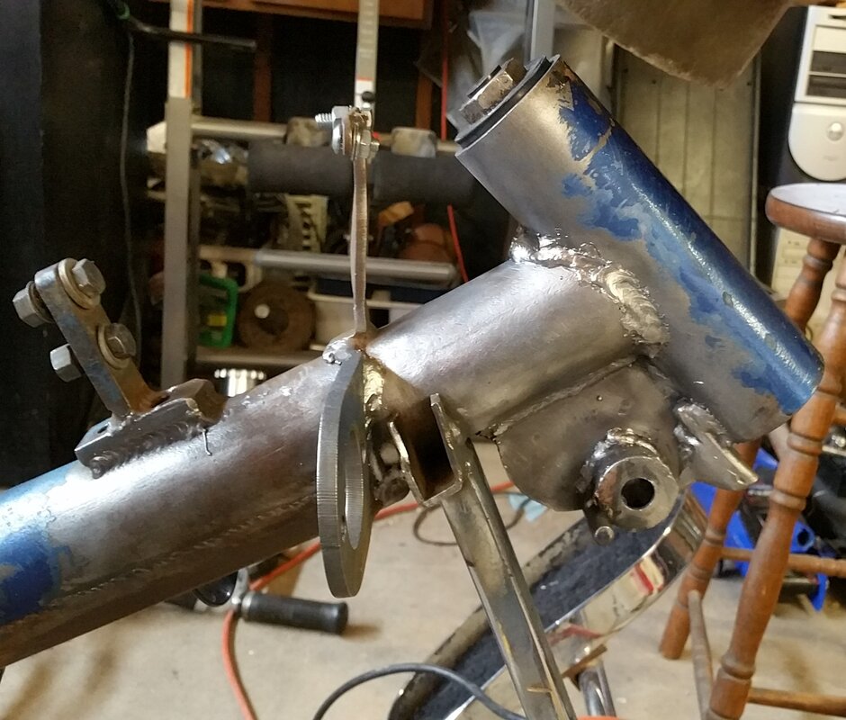

Now in this pic below this piece of angle iron was formed to the back bone 2 3/8" tube, giving it that center line look on the underside, this is what I was lining up the plum bob from, and so we see it could be off a little as it twist when bent to curvature of backbone. It also stops about 4.5" from the neck tube connection. Here we have brake master cylinder bracket attached to right side.
I can not play with chemicals much, so a lot of work is down with wire wheel and than sand paper, but almost done, main thing was to see the welds and metal as clean as possible.

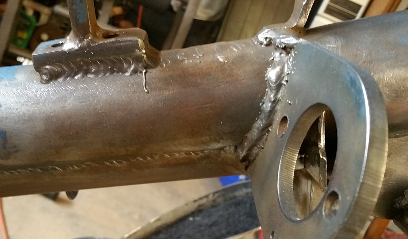

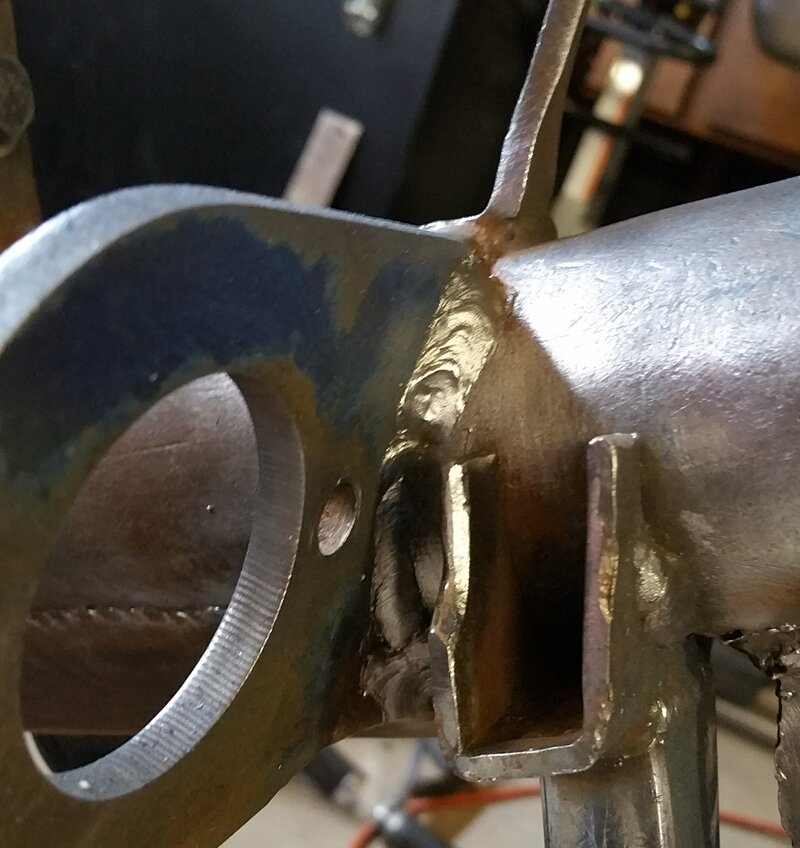

Now in this pic we can see the chrome foot rest assy. was attached after trike was painted blue, no blue on the welds or the chrome at the weld point on the backbone.
Now the weld was not applied to the center area of the bracket, was it hard to reach or bad area, evidence shows me they did not remove the chrome from the foot rest bracket before welding it into place. There was a exhaust U bolt used to hold it in place as it was welded.

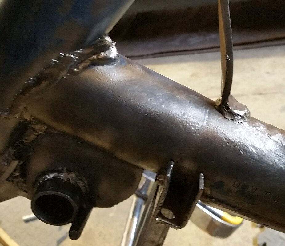

The next pick is the underside view.
I having trouble getting up in there for a good cleaning, but it looks a little rusty, old master cylinder leakage. So the foot rest is not centered to the line on the floor, looks to be centered to foot pedals mostly, and that foot pedal bracket looks to be perpendicular to the neck and main tube, so now I wonder about this next pic.
This area is cleaned, yet you can see a line where the U bolt set, no not a rusted eaten groove by the U bolt, front edge has a higher lip than the back edge near that up right piece, a grounding post is what it is. So looking at this I feel one over heated the metal in the backbone tube trying to weld the foot rest into place, if forks were on the trike the weight could have caused the bend as all cooled, or the foot rest bracket was off and so one heated more and gave a push to one side causing the neck to go off perpendicular.
I could remove the welds and drop the foot rest bracket, now reattaching it one could cut a slot in the center and slide it onto the pedal bracket and weld it, but alignment to pedal location becomes off.
I say there is a bit of a upward swing in the backbone. A straight edge shows that there is some .
All welds look solid, a bit ugly, but solid, so as I study this I do wonder if the neck tube was welded off center on the back bone because it was off a 1/16th, but when one welded in the foot rest bracket things got tweaked at the tube as it bent upward increasing rake a few degrees maybe, but if one moved foot rest trying to align it while still hot, could have put the twist in the neck tube.

I did a bit more work and got the neck off.
What is still attached should come off easy enough and I think all will grind/sand down to look good enough to re attach on the new extension piece.
Originally I thought I would cut off just at the front of the brake MC bracket, but I wonder if just going to the other side where the backbone looks more straight, yes I will have to cut thru the angle iron on the bottom a little. This should provide a nice area to join the new piece. Oh yeah the backbone is filled with buckshot, when I looked down inside the tube I seen it, must have did it for the extra weight it added ?
The tube used for the backbone is not as thick as I thought, so less needs to be milled off the new extension piece which only leaves it stronger. My cut off area on the backbone went well considering it was all free hand work.
I remember I had taken pics with a ruler using the bracket as a stop, so I wanted to see if I could make the cut with the bracket still attached. I have to remove some welding over flow out of the inside of the tube, but all is looking good so far.
I am still at it. I had to take care of a few things as my son is returning to NV and I had to get the RV ready for him.
I had been working on the neck and getting that lower support flange cut off with out destroying the neck tube.
A few photos of the neck tube after I cleaned it up.
I tried to rotate it and take a pic so that I could show off my work. I had a bit of welding material to grind off and than the 80 grit flapper in the grinder did help a lot to get it looking this good. Maybe I could do a little more, but it will get painted and is cover up by the body, so it will do for me.
