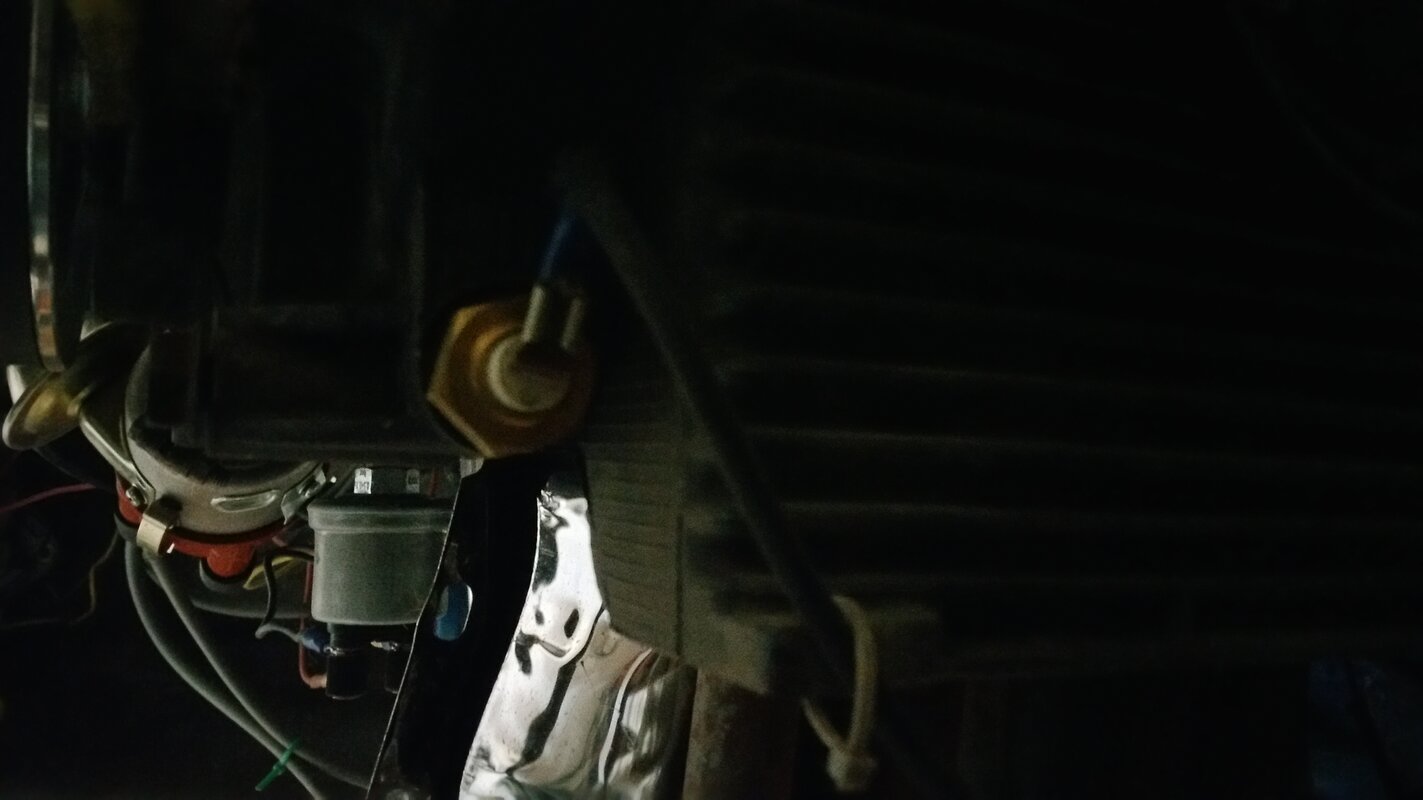

good day, so oil temperature sensor location, what is the best place for it to be on the engine?
I do have the dual relief port block and currently have the sensor at the rear port near #4 cylinder.
I will check the wiring again, verify it is the right sensor for the VDO gauge, but it does not really work correctly.
It takes some time before any needle movement occurs, and than it barely gets past 120 degrees.
I have to be honest, this side of the VW I do not know. I was 16 years old when I ran my first bug into the ground. Later in life I had the old rag top bug, wow, should have kept it, but young families do what they must to survive.
This is the most I have dove into a VW engine, electrical, and have learned about them and some of their design's.
I just started wondering if I choose the right place for the temp senor.:xzqxz:

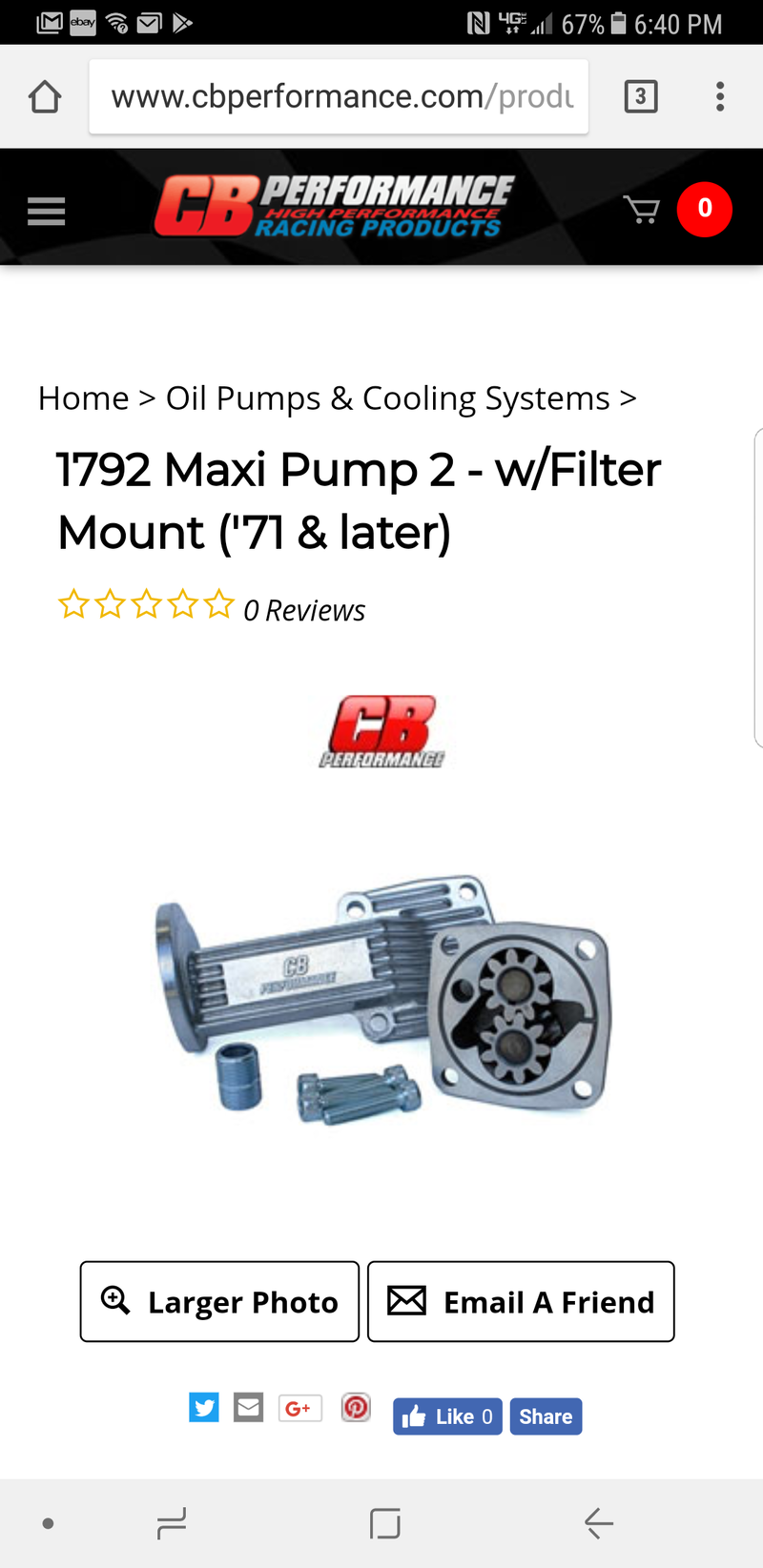

The vw engineers assumed hot oil equals lower pressure. So the oil cooler flow is controlled by a pressure spring. It does NOT turn off the flow this direction and then turn on flow to the other direction. The path to the cooler just opens and it becomes the path of least resistance. If you add too much resistance to the cooler path then oil will just go the other way around. So don't put the filter on the adapter hoses....cooler only.
So you are already talking about the filter on the oil pump.
There are several set ups for doing this. Be careful with what you choose. It is easy to do this wrong.
Almost all of the pump covers with a single out fitting require internal machine work...ie...blocking passages for the re-direct. Then an oil entry point machined into the case and back into the galley.
A large amount of the made in China two port (in out) covers are either machined wrong or have no instruction about the additional machine work needed.
The filter pump covers....some are good....large amounts of them are not.
The only place I have direct experience with that makes the modifications correctly is cb performance. They have complete pumps (not just a cover plate) that are not a stock type pump. It is made/machined in a way to reduce or eliminate the other machine work needed to work.
The place you have your oil temp is not a good flow hot spot. Anywhere is better than nowhere. The sump is not the best place but some report good results from tapping into the sump plate near the oil pick up tube. Most will say that in the oil passage right before the bearings is the ideal spot. As in the oil line returning to the engine from an external cooler or filter.
hummm
one problem with doing to many gauges at once, one can get lost. So the sensor is correct for the gauge, but I some how over looked the words " use 14 gauge wire for the isolated ground " and I do think it was 16 gauge wire I used.
than a bit later in small print I read "many just mount the sensor in the oil drain plug location, as they are threaded the same."
so I can not put the current sensor in line of the return cooled oil from the cooler, okay I could if I a T type block, on port to mount the sensor, and the other two would be for the flow of oil, have to be the same size as the oil hose line, 1/2 inch I believe.
I do think I will put the temp. sensor in the drain plug location, should that not give the temp of the cooled oil after it is re introduced to the engine from the cooler ? maybe a bit warmer than that coming right out of the cooler, but still a good over all idea of what the oil temp. is ?

So than, the idea of external oil filter is something that is best done when the engine is getting rebuilt, correct ?
A lot to find out and think about before the rebuilding phase.
A true full flow should be done with engine apart.
There are some good filter pumps out there. But there are so many bad ones that they all get the bad rep. Finding one that is made well and correctly is difficult.
The oil pump can be pulled out of an assembled engine. It is not fun to do. Then the filter pump and pump cover can be installed.
The maxi pump is the only one I have experienced with.
This is just an example. Do not rush out and buy this exact part thinking I told you to.

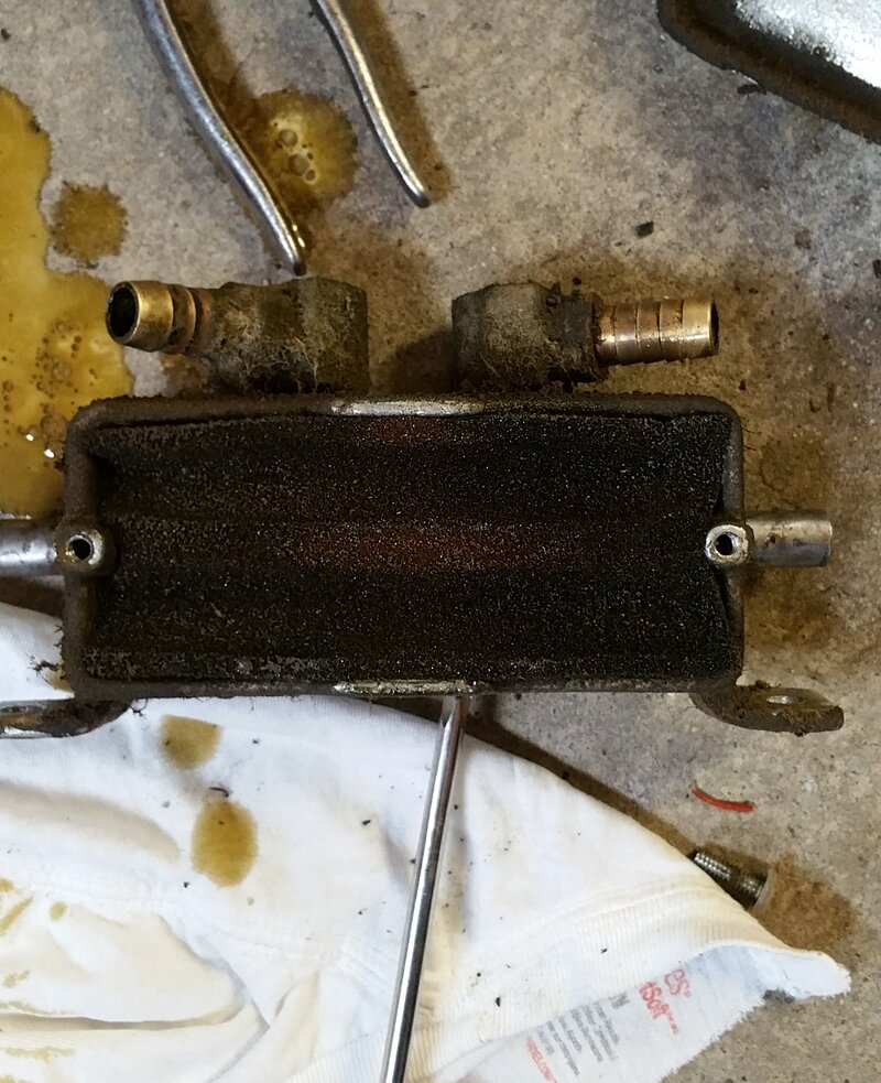

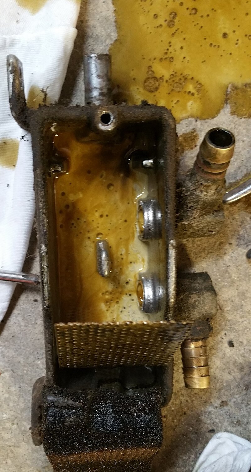

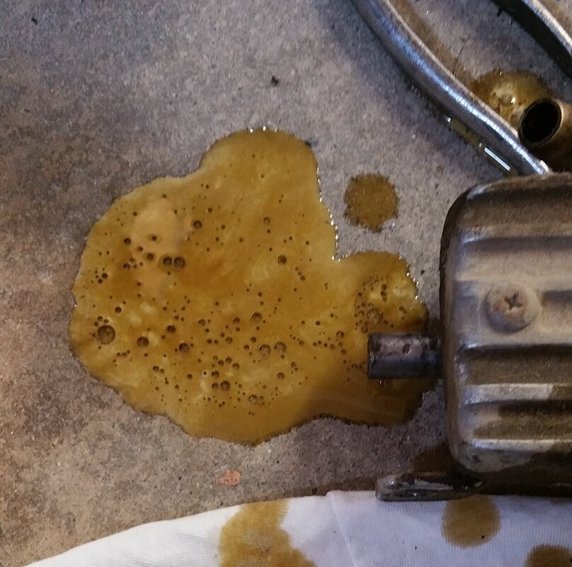

I also had water drain out of the valve covers when I had checked my valve clearances the other day, but no sign of water in the oil I drained out of the engine. And the white oil/water film was present, really got me wondering how water got in.
My mind told me condensation, water from the air. Still not sure where it came from, but today I read about how if the pressure relief valve spring is to strong, keeping the valve closed, than a back up of condensation can occur and as the engine and oil heats up this turns to steam and increased pressure can cause the valve to open. This makes me think than all that crude goes into the oil pan.
regardless, I checked more as I read and it is a long chromed spring that takes a lot of strength and pressure against to thread in the plug or sensor, they both are the same length, so as I read I found the chromed spring is aftermarket spring to improve oil pressure, basically stronger than stock so it keeps the pressure relief valve closed to long, and that is not stock operation.
So earlier I took off the hoses and removed the breather box to see what it looked like inside, and of course clean it up, have new hose on the way.
than I had to look inside the box.
So the real question is, does this crude come from the valve covers up into the breather box, or does it come from the breather box down into the valve covers ?
Yes the oil fill tube has the vent port and the hose ran from there to the breather box, so is this the path it takes to enter the breather box to accumulate and than it drains down into the valve cover's ??? lost on this one.
I do know I spent some time cleaning the extension tube of the fill tube, the vent port was just full of the white oil/water crude, or is just the foam created by water/oil and heat ?
I did not look for the sensor adapter that would allow it to be inline to the oil cooler, not yet, but if it is not available, I think I can make it, 1/2" dia hole drilled thru the block, tape threads for the nipples, come down center from the side drilling and tapping the sensor port. In line sensor mounting block, or is the control valve plug the better location ?

Water poured out?
Condensation does happen. A lot of short runs never getting to full temp plus the humidity does sweat up and make the milky mess all over the place. But seldom enough water to pour out.
I want to think more of rain and an exposed engine to get enough water to pour out.
Excessive oil pressure would make heat. And that would likely evaporate the water. I have overheated oil to the point of making foam that was simular to what you have. But yours does look more like water to me.
Not I see how that much water could have built up inside of the engine, but the damp air filter from rain, the trike sat out covered in the drive way all last year, brought it back into the garage this fall, or told the wife I was selling it.

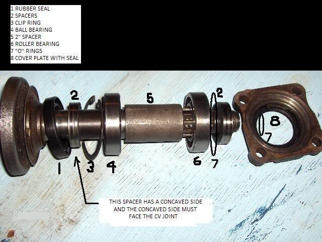

bearings
Good day to everyone, so I got into the bearings of the right side. Not super worn, but inner bearing is worn more, but that sleeve spacer that the axle slides in, well I can see wear on the axle shaft, kind a grooved by the long sleeve spacer.
I have to clean up some for pic's, but I started the left side last night, out bearing was worn into two pieces, still at it, but hope to compare ware.
Grease was old, some hardened up, and seals a bit rusted in place, no paper gasket was used on the bearing hubs, but know I do know why the left side camber was so off.
I do wonder about the drive axles and CV joints, at least I would think one should clean out old grease and re pack the with new grease ? wrong or right......... or does one just get new drive axles and CV joints together and replace the old that way ?
I do have things to get done today, no I have not ordered any bearings or drive shafts yet, not sure what I got or need yet. So much fun, sure do hope all have a wonderful day today..
If I remember correctly....the center area of the shaft is undercut a bit. The space sleeve does not fit tight on shaft but sandwiches between the two bearings.
The area of the shaft where the bearing rides need to be a snug fit. Also the bores the bearings fit need to be snug. As in not ovaled out from a spinning race. Closely check that one with the split race.
Chances are that it has been run with the brake drums loose or not fully tight. Them things are supposed to be mega tight... as in special tools kinda tight.
I do have one last seal to remove, a little more clean up, than really look over the clean parts for the excessive wear.
Do not forget the drums, probably still good, but all should be checked out.

Ther are 2 different style oil pumps, one for "flat" cam gears and the other for "dished" cam gears. The only way that i know to determine what you have installed on a modified engine (if you didn't build it or see it built yourself) is to pull the oil pump and look at the face of the cam gear. Here is a Samba post discussion about oil pump removal and some tips: https://www.thesamba.com/vw/forum/archive/index.php/o-t--t-363360--.html
