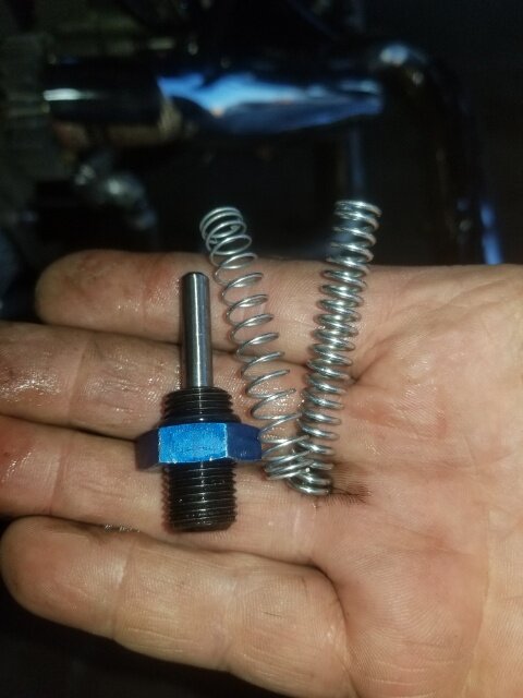

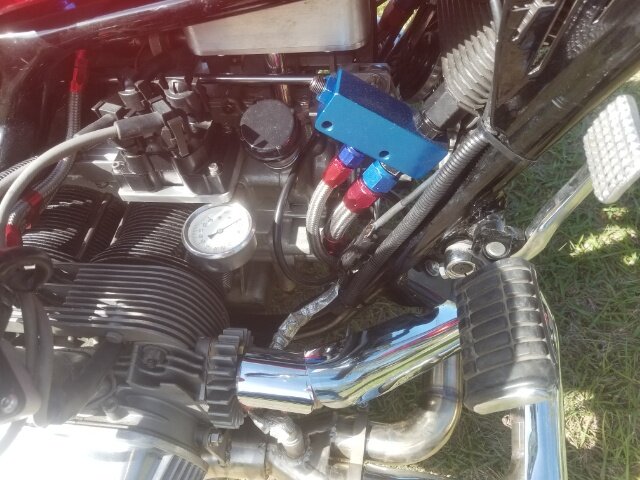

Now messing with the oil pressure. The pressure spring that came in the regulator is too much pressure. I put a different spring in and it seemed ok. But now that it is mostly broke in the pressure is lower than I want while hot. I have also taken the break on oil out. I now has 5w20 in it. Still dino oil but will be switching to synthetic after a couple thousand miles (next oil change). I might even try 0w10 oil.
But anyway....I wound up stretching the light spring and putting it back in. Will see what that does. I gotta search for a spring somewhere in the middle.
Stretching that light spring did put me in the range I want to be in. I am still going to find a spring of the right pressure.

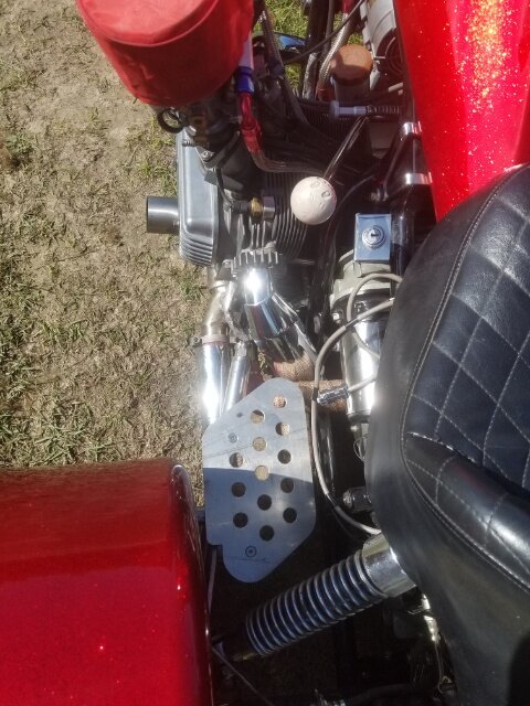

My girls liked the big rear floor boards that were also the heat shielding.....but I did not like the look.....they seemed out of place......not fit in.
So I made something else. A more hot rod styled floor board that is smaller but big enough. Then cobbled together bits of old motorcycle clamp on heat shield to cover the pipes.
I like it better and think it fits me better.

looking good.......ya, floorboards fit the trike,look right on there.
I'm lost with the anti reversion business, but proof is in the performance!
The upper rpm range is where the math, science and physics live, sounds like good things goin on up there!

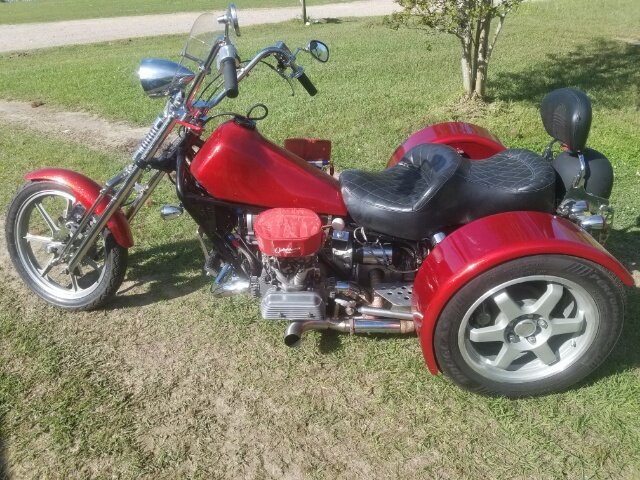

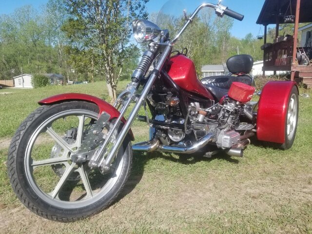

Maybe post a side shot of that trike? thanks
side shot
thanks....about all your pics were front/rear or quartering, no sides that I remember. Have mentioned before....your weight distribution must be about perfect, solo or w/ passenger.
With all that new found power, weight distribution is super important.
Nice side profile, tank looks great. Like the exhaust running thru blank tranny case!
When looking at anything, to me,the side profile is the most important, that said, in my opinion, you nailed it!:clapping:

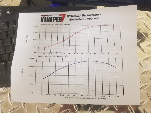

196 at the wheels translates to around 225 at the crank.

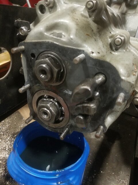

Breaks parts.....something is wrong with third.
Yep....I put a hurting on it.
That nut was not loose...no shaft endplay.
So it is definitely deep in there.
I am guessing a split/cracked 3-4 syncro hub.
I thought I had it built up to handle 200 crankshaft hp. But I made more than that.
Apart it comes.

Get into 3rd and get it stable and at an rpm you think you can start at without bogging. Basically as slow as you can go in 3rd without chugging and pinging. Get stable aaaand....start recording......and nail it. No jerk, dump, snatch.....just as hard as it will dead pull.
Computer calculates the rate of acceleration of the heavy rollor.
I spun it 132mph in third gear.

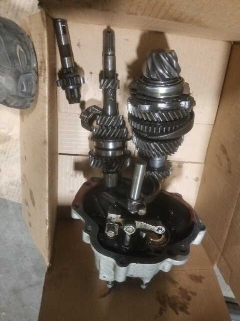

I have the gear stack out and on the table.

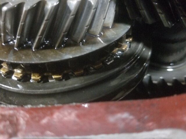

Not yet tore down. Just by a visual inspection it looks like 3-4 hub and/or slider is not round.

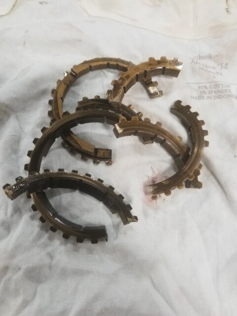

The big thing is both brass syncros are broken into several pieces.
could it be a shaft bending under load , or a worn hub/gear tooth profile allowing the partial disengagement in
3rd gear? doesn,t sound like it popped out of gear, but some sleeve or bearing allowing 3rd gears/hubs to rattle around?:confused:
It looks like the hub twisted.
It is not as hard as a gear.
The gears and shafts will take it.
The syncro hubs are what connects the gears to the shaft.
hopefully there are stronger hubs available.....I had thought that a loose pocket bushing/bearing or loose countershaft front bearings, or worse yet spreading case bores could let the 3rd gears get loose....a bad hub is actually maybe the best news you could get!...at least that would explain the broken syncronizer I suppose with a direct 4th gear tranny 3rd is the weakest gear, but the gear that catches most of the grief....just the way it goes...good luck...hope you can make it stronger!

It looks like I put a replacement "heavy duty" aftermarket hub and slider assembly on 3-4.
After talking to a race trans builder I have been told that that heavy duty unit is half junk. Said the slider is excellent but the hubs were soft. A stock hub would be better.
I think I am gonna put it back together with a German hub, the hd slider, and new syncro rings.
Now to dig in my junk pile for an original keyed 3-4 hub. Then buy some new brass parts.

3-4 hub is not round anymore. These broke rings are just collateral damage.
I tore down another core.....and not happy with the rings in it either.
But the hub was real nice.
I thought I was going to scrounge up some parts and put it right back together. Just ain't working out that way. Looks like I will be ordering parts.
