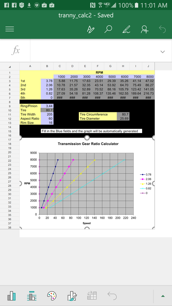

Here is a spread sheet calculation of rpm to gear ratio.
Remember it is massively re-geared.
It is a 7500rpm motor.
As you can see it is mathematically possible to reach 200mph. But I don't know if the engine will produce enough torque to pull 4th all the way to red line.

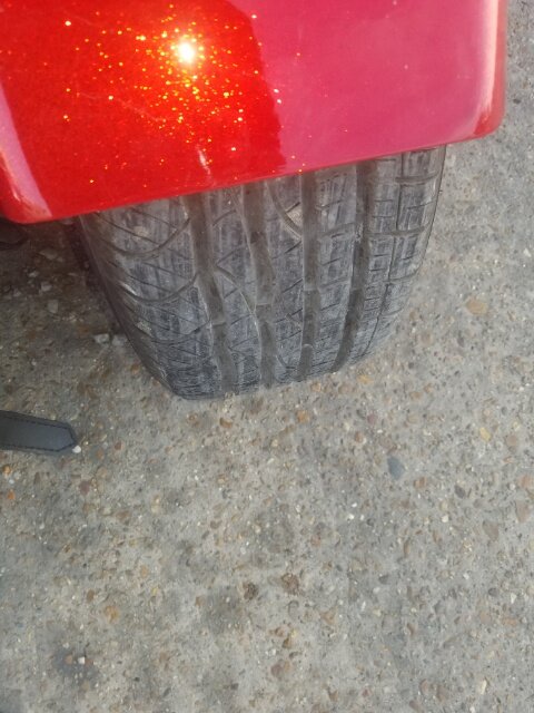

Tires did get some scratch lines around them somehow.

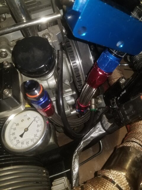

I gotta get the time to work on a dripping ss braid oil line.

I replaced an oil hose this morn.
Then burned another tank of gas.
The leak seemed to be gone for a while but now seem back at a lesser degree.
Will replace the small hose next.
exhaust pipe looks like a good gray color.....nice sound, every cylinder hits hard, liking the fancy crank pulley and bolt. ya, oil leaks on an aircooled make a little more smoke than on water cooled. no matter, water or oil ya gotta fix those leaks!
It looks like a possible leak somewhere on the braided lines, somehow? I've never used those trick -an fittings in a build. They're clean/sanitary looking and are supposed to be basically bulletproof from what I've read.
Can they fail to properly seat/seal together and if not, what would the possible reasons be for a failure?
You have to build/assemble those hoses.
And it ain't just real easy either.
So I thought I had a leak on the end to hose joint in how it crams together and screws down to wedge tight on hose. I have a little hose left over. Took the ends of and put them on a new hose. I really did not see any problems with it.
I thought I had it but it is wet again where the drips blow back onto the coil area.
I will do the same with the smaller bypass hose next.
None of the other hoses leak at all.

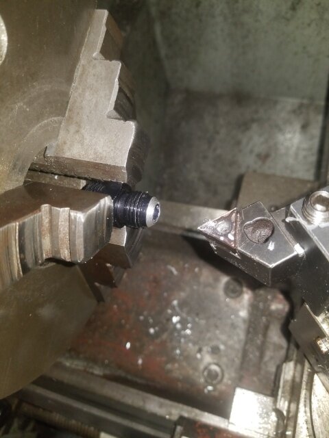

I was looking at this adapter fitting...the seat just did not seem right...like not round. Thought I could see tracks on it where it leaked.
So re-cut the seat taper on it.
Now to give it a try.
