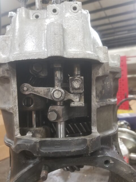

Then adjusting the shifter forks you can do with a make shift jig. Cut the side out of an old trans case.

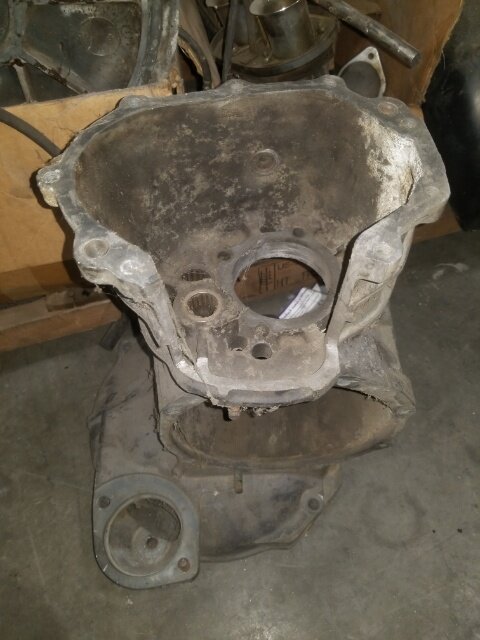

This hacked case has not been used in a long time.
It will need some cleaning before use.

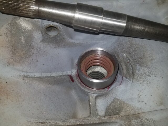

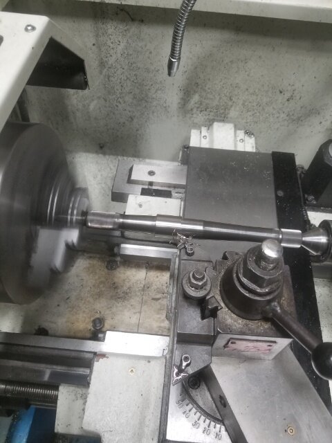

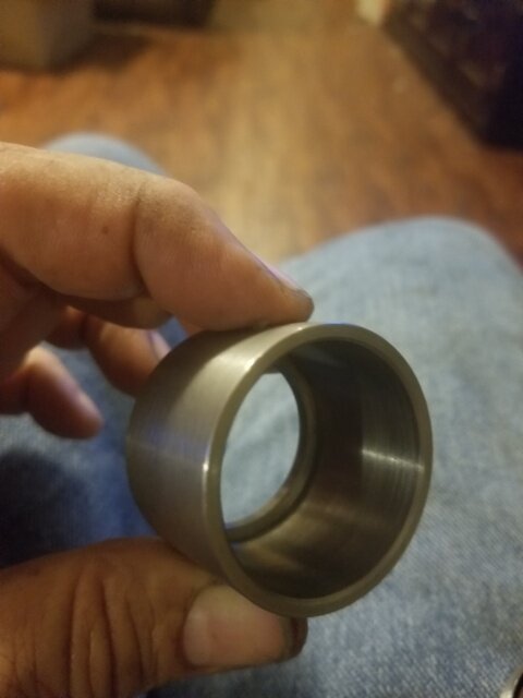

I am sleeving the shaft and boring the case to put double stack of oil seals on the input shaft.

input shaft?
oil getting into the clutch? on 4 spd muncieS was told to leave tranny oil level slightly low. Maybe vw with unique layout and differential included makes for more oil slinging?
No.
The clutch is not there.
The trans is upside down. That means the input shaft is below oil level.
It is difficult to keep an oil seal working there.
Now, I understand the need for two seals with a good case bore and input shaft finish Looks like the leaks will be a thing of the past!:D Imagine it would be a very expensive repair if taken to a shop. It's a good thing you can do the tear down, machining and reassembly yourself.

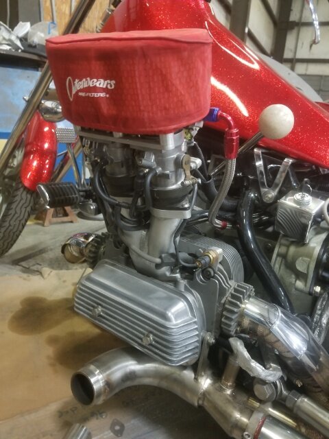

So gear carrier in and inputs shaft mods in.
And the case hung back in the frame with one axle half done.

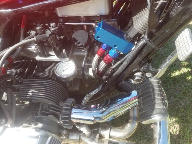

??? what is that part that is above the heim, but below the exhaust pipe.....hook shaped?
those triple seals should stop any leaks! Ya, agree, leave expensive tranny mods for next winter......just maybe be easier on the throttle.......wondering if the dyno run is what twisted the hub?
That hook shape is a pig tail of wires in heat insulating tubing.
That is the O2 sensor for that bank.
Here is the same thing on the other bank.
Computer inputs for the fuel injection.

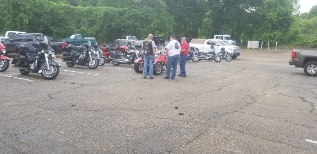

This was Friday evening. The rally is actually Saturday, which is today now and it is raining. These folks were the distance ride in that are overnight at the hotel.
If it will quit raining i suspect a lot of day trippers this evening.
