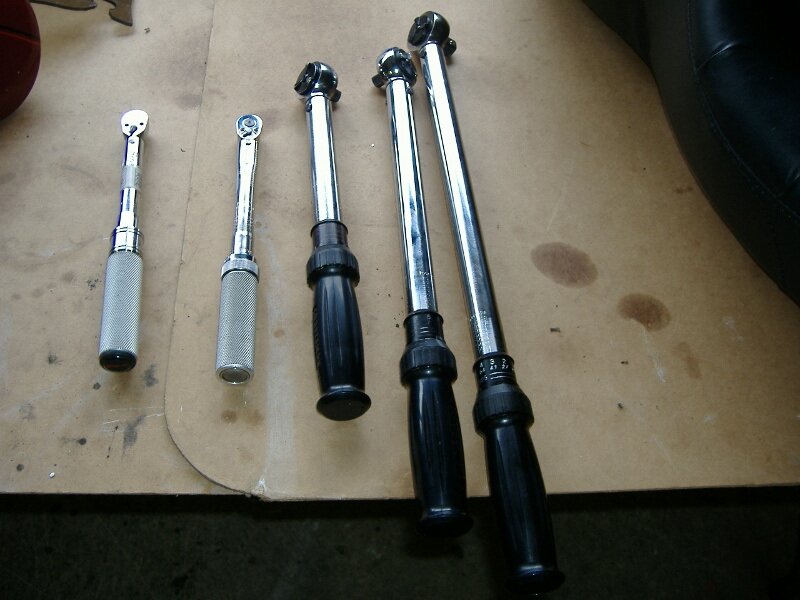

I'm a bit of a torque wrench junkie, have a couple Snap-on and 3 Craftsman. The 2 Snap-On are 1/4" drive, one is 10 - 50in/lbs and the other is 10 - 200in/lbs. 2 of th Craftsman are 3/8" drive and the other is 1/2" drive. I love the 10 - 50in/lb wrench for tightening the outer fairing bolts which are 25 - 32in/lbs. If I was buying again I'd be going digital, they are the bomb.
Yes, the digital's are the bomb, they are far more accurate and easer to read, I have had mine some time now.
I have a cheap, cheap Harbor Fright, I think $16. I checked it with a $500 + Snap On and they "clicked at the same time!
