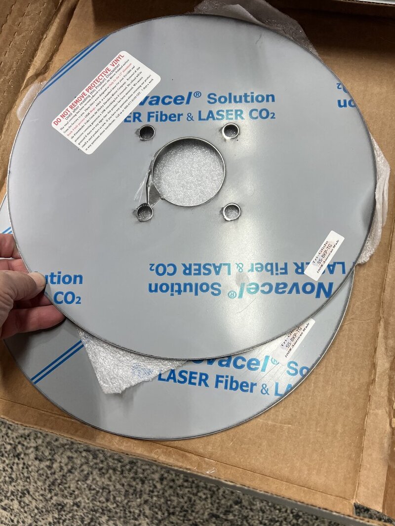

Today, I received my wheel disks!
Thanks again RJ!!

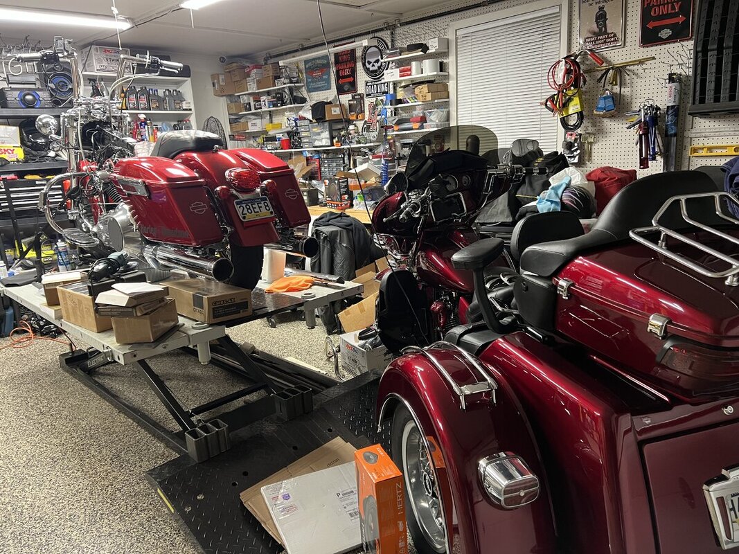

I have my son’s Dyna FLD Switchback on the lift getting new handle bars, cables and Müller clutch kit at the moment:
So I will have to wait until I get it done and get my lift free before I install them.

They are nice and thick (Not too thick, not too thin… PERFECTLY thick! And stout!) I pulled back just a small portion of the outer protective covering and they are polished great and shiny too!
Quality definitely shows in these RJS disks!

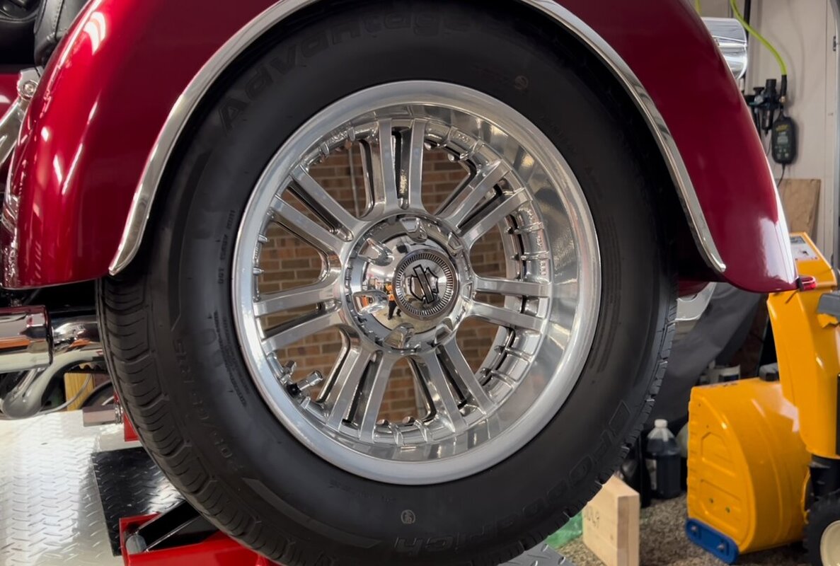

I got my R.J.S. Originals Polished Stainless Rear wheel disks installed and looks AMAZING!!!
I also got my buddies Amazon pair that he got a couple months ago (he never had a chance to install them) so I did a “Real World” true comparison!
The Amazon is slightly thicker & also slightly taller. They do fit …. BUT under the “protective film”, the polishing is sub par and has 3 issues with the finish and truthfully is unacceptable, in my opinion.
This proves just how good the R.J.S. Originals really are and well worth the little extra $$ difference!
Made in USA 🇺🇸 and supports an awesome guy too!
