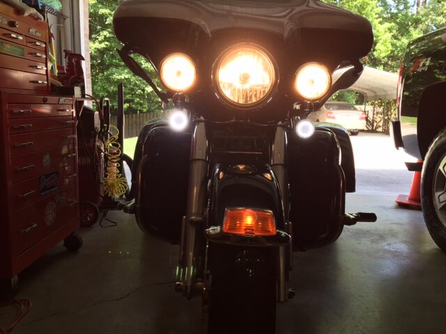

This weekends projects included mounting the Memphis Shades fairing and getting started on LED lighting. Got the most difficult ones done, under the tank and bottom of frame.

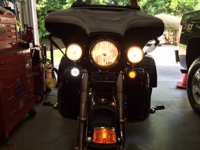

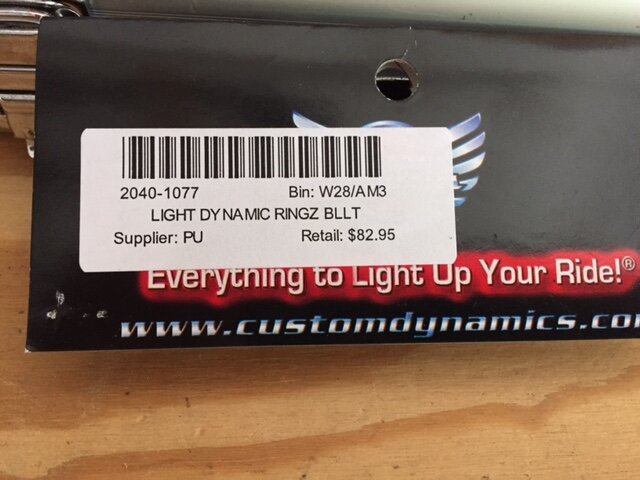

Changed out my Turn Signal lights. Install LED lights, they now stay on as driving lights in the bright white color. When you apply the turn signal it changes to flashing Yellow color. They are Very Bright lights . Very easy install, just pulg and play. one pic shows yellow signal, also tag with part number. Got it at local HD dealer.
WOW, you guys are on a streak! You got a lot finished and things are looking good!

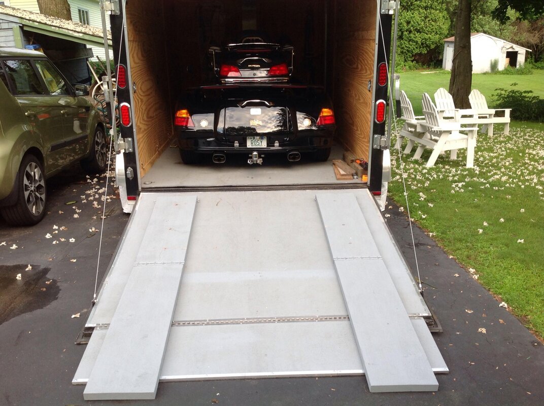

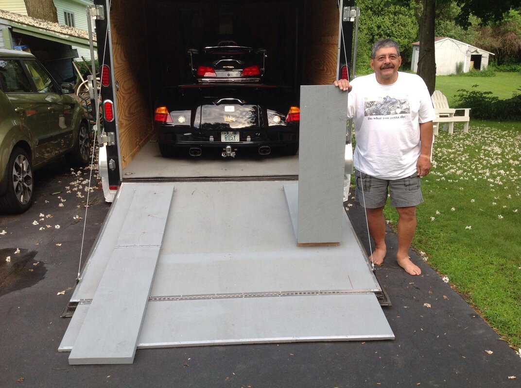

Trailer Ramps

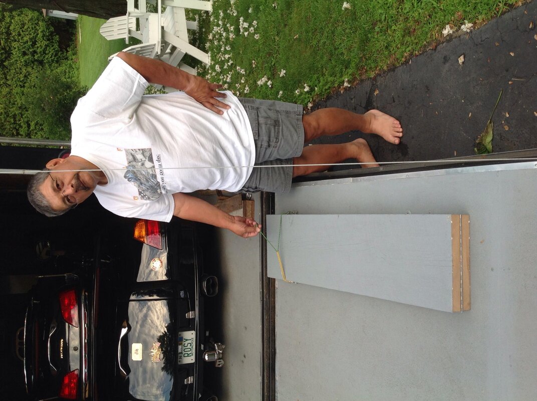

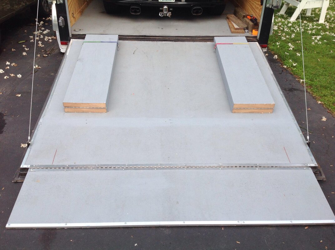

Almost finished with my trailer ramps. Need to paint a few things and should be finished.
Here are a few pictures on how they work, hopefully they will right side up, but with me, you never know.
Oh yes, didn't need any help from NY or MS, as they would have come to "help" me!
Ramp up and down.
Rosy
Use bungies to hold boards in place while on the road.

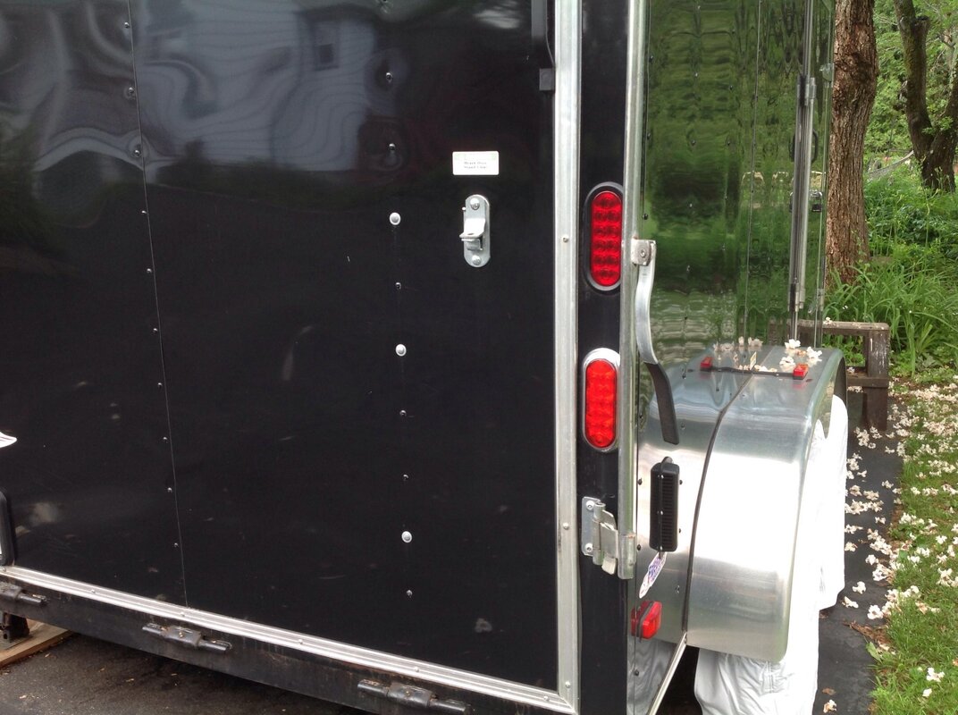

Carriage bolted through rear door and frame to hold the boards on.
We needed the ramps for the extra heigh so the trike doesn't bottom out. Hannigan kit low to the ground. Also, take the extra weight off the flap which comes down on the trailer door.

looks good rosy, have you closed the door too see how far from the back of the trike, try some screen door hooks too secure.
Janice says, she would not trust the screen door hing because of the bouncing around during travel. See, I have help even in NH! LOL
Rosy

Don't worry, the ramps are bolted to the door, so they won't be coming off. I didn't want the one hanging to swing as we traveled, so I bunged it. I don't think it would hit the trike, but why take a chance.

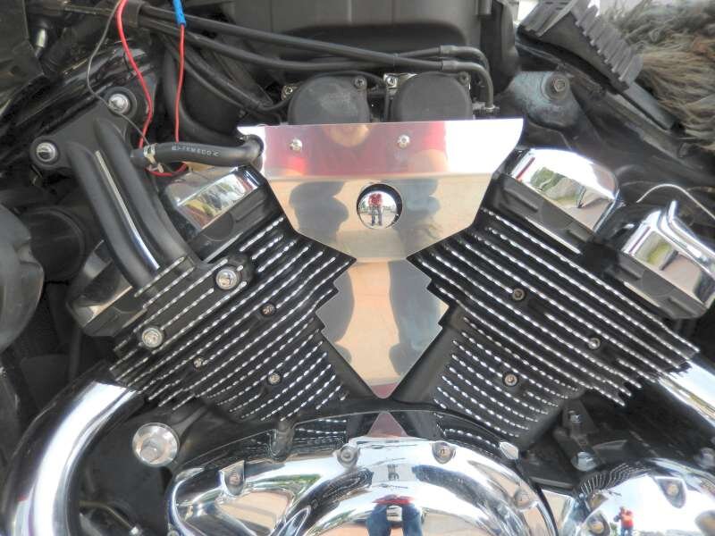

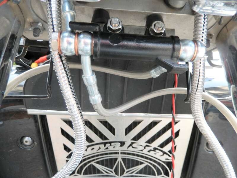

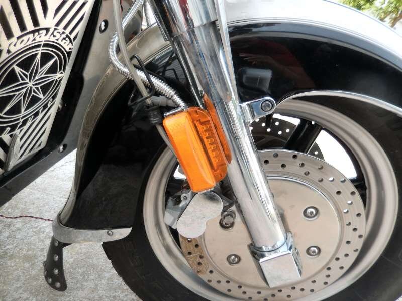

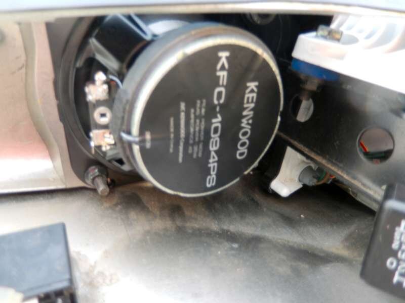

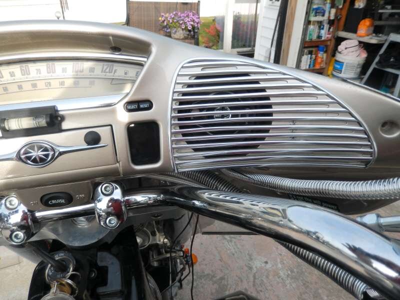

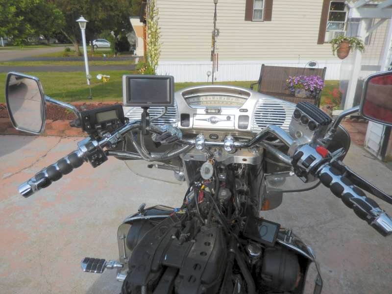

Finally got around to putting the Flanders bars on my RSV with Baron's risers, along with upgrading my front brakes to Gold dot R1 calipers and SS lines and VMax line splitter. Had to add longer SS throttle cables and longer hydraulic clutch hose so I went SS there as well. Installed heat to the new Kuryakin grips. Did a little dress up work on the wiring harnesses and added some spiffy engine side covers designed by a guy in Iceland and even hand delivered to me on his last visit to the US! Replaced the anemic stock speakers with some triaxial Kenwoods.
Still have some more lighting work to do before I put her all back together but seeing as the crew at Venturerider.org demanded pictures here's some shots of what got done so far...
Thank you for the pictures, looking good!
Funny seeing a trike when it is strip down. Then you realize how much goes into the production of a motorcycle. No wonder they charge $85 hour to work on them.
