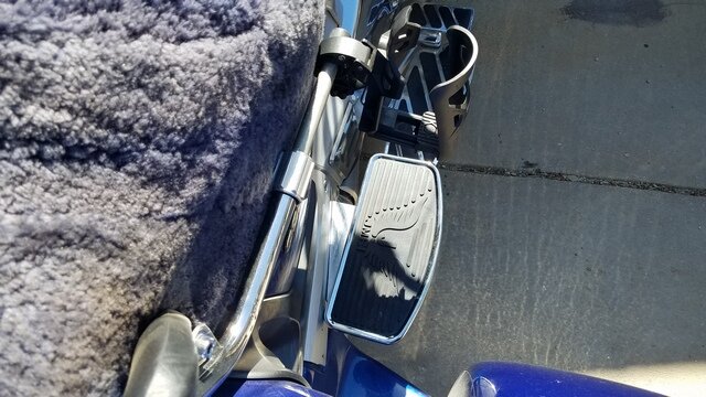

Hi all. Picked up a 2001 GL1800 a few months ago. I'm a cheap guy and have made some inexpensive mods (mostly from the wife's honeyDo list for when she's a passenger). Pictures follow...

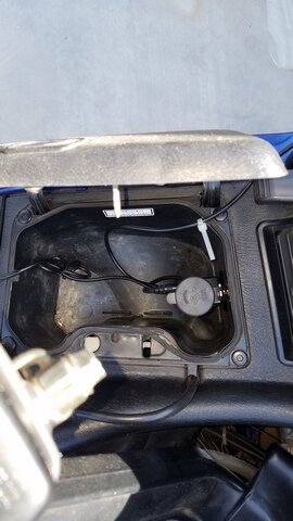

  • Added Bluetooth with a triple USB outlet. Brings my phone into the bike speakers for music and Maps direction.

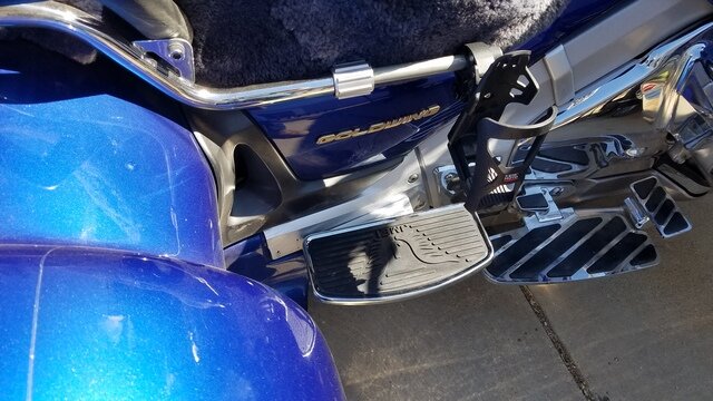

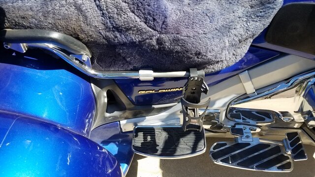

  • Have the crossunder bar for the back rest. It helped locate a place to put a water bottle. I don't use the back rest when she's with me so I just added a piece of 5/8 tube to clamp to.

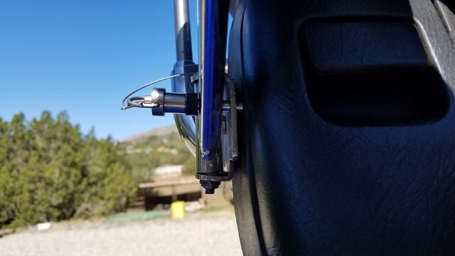

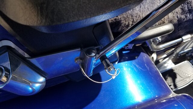

  • Added push in ball lock pins to the arm rest struts to lock in place. Keeps them from flying around.

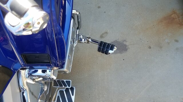

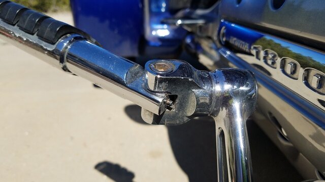

  • Replaced footped extensions with 1 1/2" longer and added a roll pin stop to keep them angled out more. Saves my knees from bending around the air cowling.

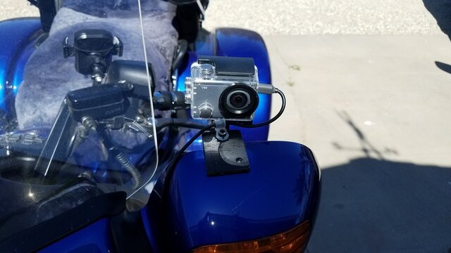

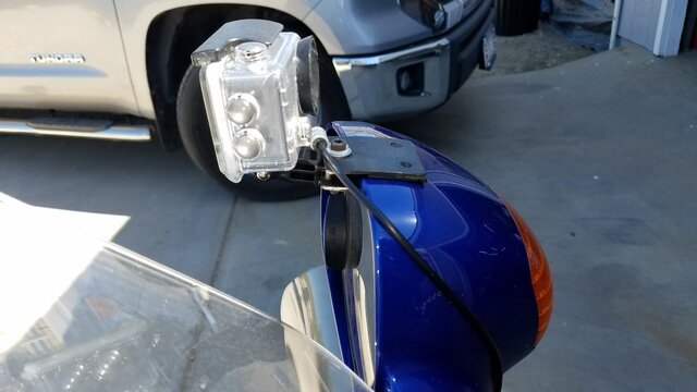

  • Made a mount to hold the sport cam in an accessible spot and ran the cable to the outlet to keep charging the battery. Always on and recording when I startup.
  • Bought cheap aftermarket front foot rests and put them in the back for my wifes big feet. Also added alum. wedged blocks between the mounts to angle them outward more. Saves her knees from bending inward onto the older, smaller footrests.

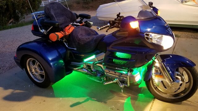

  • Had to add some lighting. Mainly because I like lights.
Mods were not expensive but useful. Happy wife..Happy life
