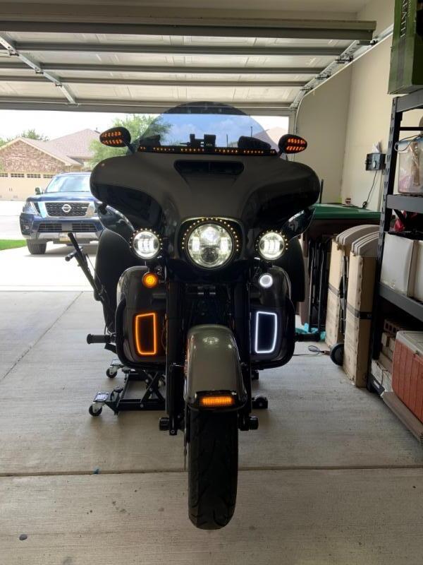

Today's Project #3 Part 2
This is the Custom Dynamics TF-R 20 LED mounted permanently in place with no power applied.
This is the Custom Dynamics TF-R 20 LED mounted permanently in place with power applied.
Makes a big difference! Picture was taken in a fully lighted garage.
I think I'm done with projects for today! And yes, I did torque the wheels when I put them back on, to 100 ft-lbs, and will recheck them after I go for a ride!
