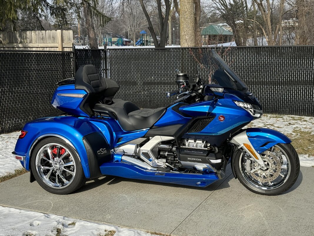

I'm getting about 36-38 MPG with my 2022 DCT CSC Encore......Had it converted right out of the crate, so not sure what this particular bike would get as a 2-wheeler.
My 2019 DCT Tour 2-wheeler got about 45 MPG.
I'm very happy with the mileage on my Encore.......better than I expected. The smiles outweigh any loss in MPG! :D
With the CSC Aux fuel tank I get better range than a stock 2-wheeler Goldwing.
