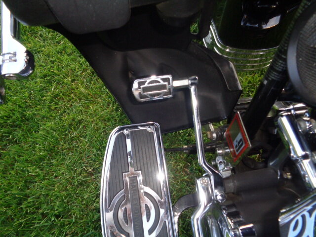

Now old Shiney has had the spacers on the floorboards since I adopted it. However reaching in to get to the toe shifter has been somewhat annoying to me. I can't leave anything alone so I purchased a 5/16" bolt 3 !/2" long and manufactured another spacer to match the floorboard spacers. Only problem is I could not find a 3 1/2" chrome button head bolt so I used a grade 8 and turned to fit. I had to slot it to make it secure. Ride safe FredView attachment 87136DSC01682.JPG
Now old Shiney has had the spacers on the floorboards since I adopted it. However reaching in to get to the toe shifter has been somewhat annoying to me. I can't leave anything alone so I purchased a 5/16" bolt 3 !/2" long and manufactured another spacer to match the floorboard spacers. Only problem is I could not find a 3 1/2" chrome button head bolt so I used a grade 8 and turned to fit. I had to slot it to make it secure. Ride safe FredView attachment 87136View attachment 87137
Looks good Fred. BTW they do make a spacer for that for those of us who aren't as handy at innovation and modification as you.
I used a CB antenna connector drilled it to fit the 5/16 fine thread bolt. Chucked it in the drill press and turned the head down to fit. Then I used a dremel cutting wheel to slot the grade 8 bolt head. I wish I could find a button head 3 1/2" fine thread chrome but till then this will work. Fred
Next time ask ,Fred. I have a bag of those bolts. I bought them 3 yrs ago when I got spacers for my 16. If I had been on here sooner would have hollered at ya. Been off day & 1/2 or so. When I looked for those bolts ,could only buy a bag of 20 or so.Have a bunch left.
When we see you later in a month or so we will take a look at that bag of bolts. It only makes sense if you space the floorboards you need to do the shifter peg. I never liked the short stubby shifter but I adapted to it. Who ever markets spacer's for the floor boards should do a complete kit including a shifter spacer as well. The back one was switched out for an extended one this winter and I just am getting used to it, I do like the extra space on the floorboard. Thanks for the offer of a bolt, I would really like to swap it out for the proper one. :good: Ride safe Fred
I was having same problem after the floorboard job. Payzac has a machine shop here & made me a couple spacers for the shifters. Sprayed em black .
I had a little time being laid off and thought I would give it a try, it's solid and look just fine but I like chrome you know LOL...DSC01673.JPG
