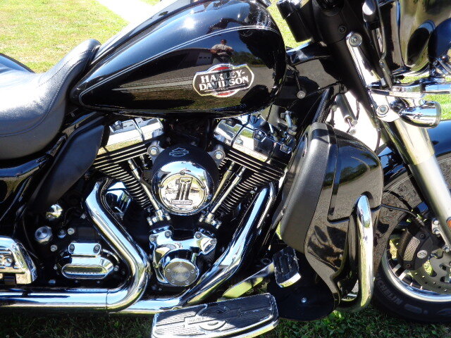

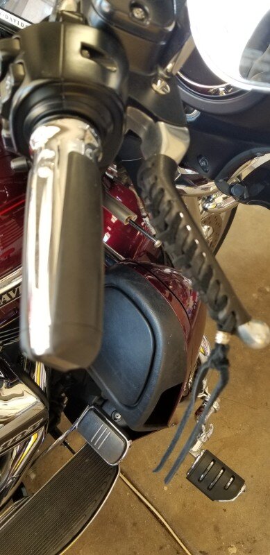

Installed my DK 1.5” deluxe lift with the cdw’s. Not to bad, right side was a pain in the butt. Had to take the reservoir off and move cables around. Still had a hard time with the top nut, these old fingers ain’t what the used to be lol.
That looks really good! I hope you don't mind we put your photo on the website.
Next time you do a Tank Lift, raise the front of the tank up, so you don't have to get your fingers between the backbone and the tank ears. Yeah, I know it's a bit late now, but may help others.

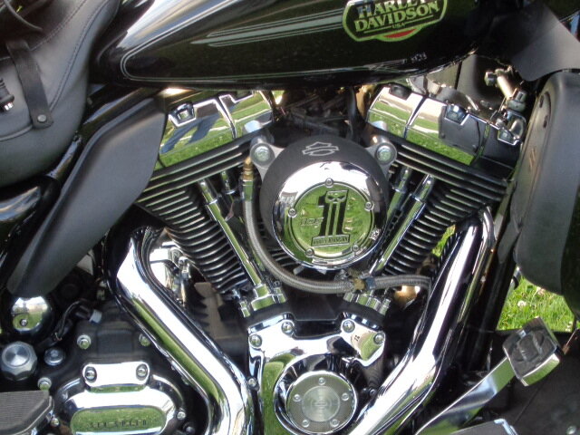

Decatted Headpipe
I had been reading here and elsewhere about decatting the stock headpipe on my '14 to accomplish various ends. A good friend offered a take off pipe from decatting his 103 and actually removed the Cat for me. Yesterday, another good friend swapped the pipes, stock to decatted stock, for me.
These pipes go into a set of RCxhaust slip on slash-cuts. There is definitely a loader exhaust note. I haven't taken it on the road yet, that happens today when it warms up a little here in West Michigan. I'll post my impression.

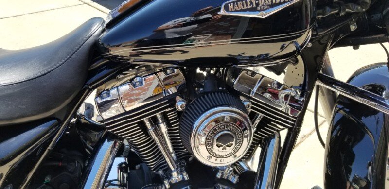

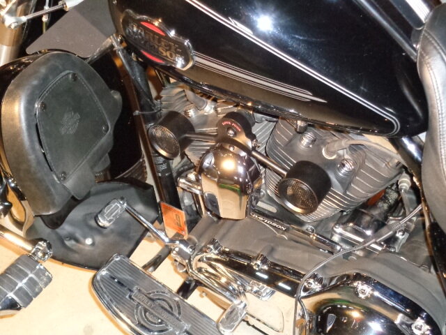

As others have said DK Customs has different height lift kits I chose 2". I wanted to make sure my 2+2 Wide sweeper Khrome werks bars would clear or was it make sure the bars cleared the tank well anyway. What the tank lift will do is push more air on the motor which is a good thing, less air in your face and chest area another good thing. Along with the cooler motor and less buffeting you can also clean the rocker boxes much easier. To me this is second to having a cooler motor these heat monsters need all the help they can get. While we are discussing tank lifts also look at the air deflectors Kevin markets these little wings sure compliment the tank lift to really do a complete job of air control and direction. I included an old picture before the air deflectors so you can see how the fit. Ride safe Fred

Seems you have played this game before LOL good for you. :good: Travel safe Fred

Had fun today putting on some DK Custom Product items to help with cooling.

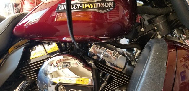

The 1.5 inch Tank Lift Kit (with rear lift included) worked well with my TSK Mayhem Bagger handle bars. From the look of things the 2" lift would have caused interference with the tank and bars on full turns so I'm glad I guessed right on choosing the 1.5".
Installed the Cooling Deflector Wings. Had to use a flex joint on my socket to tighten the tank bolts. The wings don't allow a straight clear shot to the tank bolts.

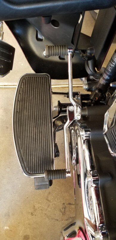

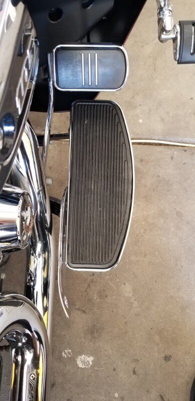

Installed the Floor Board Extensions which is a great improvement for the ankle comfort on the right side. The heat on the right side had me riding with my foot out on the very edge of the floorboard. Here in Florida it is not uncommon to jump on the trike with shorts on and flip flops or in low top tennis shoes for those quick runs around town and the heat was excessive. The test run today with low top tennis shoes was totally comfortable. Problem fixed.
Congratulations not only you were comfortable but also a great step in preventing heat damage to your motor. With that said you will find more money for more bling LOL good job :good: Fred
