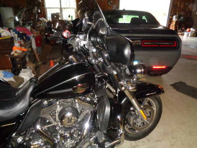

It's almost worth and I said (almost) worth buy a alignment tool as much as some change things ya know. This afternoon I realized that I needed a fork clamp slash vise securement for working on the Legs so I made one lined it with Thin shim bearing material strips (no scratches or marks of any kind). I get pictures tomorrow as I progress through the project. I have go re-read the section about pulling the switch out the only scary part of the job LOL. :AGGHH:travel safe Fred
Dinner break update
I never got started till lunch time I have it apart now going to start on rebuilding the legs after Dinner. I had to go buy an 1 3/8" wrench for the cap nuts on the legs, It was either that or take the batwing clean off "Nata" so bought the wrench. Finish up later will post pictures, pray the ignition switch goes back in properly... just sayin... Fred
After Dinner break
Well this is an experience a little more than I thought. First I had to buy a set of huge combination wrenches to get one 1 3/8" as it turns out. One problem solved it was for the top nut on legs. Next the plug for the fender tip light would not come through the space for it to clear, tried to release pins in plug Nada so snip I will splice it is in a sheltered place anyway (didn't want to do it but)... Next the video from Pro Action shows removing bottom plug bolt that holds the damper rods after unloading top spring. Well that may work with new ones but not old Shiney. I reinstalled and load spring to load the damper rod to get the bolt out, done not easy but done. Now I have one more to dissemble and clean and reassemble figure on doing that in a bit. The damper rod plug is now out and draining oil reason for tall cold glass of water). Tomorrow after I watch a little Church the Good Lord knows I need a little talking to after today I will finish the job. I'm not sure I want to do another a little more than I want I think.... Pictures tomorrow ;) Fred
Finish tomorrow it is most likely the first and last fork upgrade way more than I thought it would be. A little more training and a few less years on these old bones. Sorry Bill rear shocks not a problem but the front forks not again.
Wow what an ordeal let me tell ya...
I have now taken both ends apart and I'm not sure I ever want to do another set of fork legs. It started when the light wire had to cut and respliced going back together waterproof connectors there. One fork leg was Gorrilla tightened, it took me awhile stumped I PM'ed Randall before he could call I checked out U Tube an found you use the triple tree as a vice live and learn. And last but not least the Switch that Damn Switch what a friggin nightmare, I finally got but wow talk about sweating bullets. The front fork rebuild is complete and test ridden no more nose dives. I never changed oil the front forks in 32K+ it was black metalic slime no wonder it wanted to washout on corners. And the nose dive was unbelievable. It seem like riding a new machine with both rear and front ends now Pro Action Suspension Travel safe FredDSC01656.JPG
