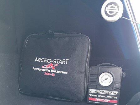

I keep a jump starter and mini air compressor in the trunk. I have them attached to the inner wall with velcro. I wired a harness to the battery and ran it to under the side cover. I can pop the side cover off and jump the battery in 2 minutes. Keep in mind, you can not jump start thru the battery tender cable

NO you can not jump start thru the tender cable. Most jump starters send too much current for the tender cable to handle, and you will melt them if not careful. You can purchase a much higher gauge plug like I did and wire it directly to the battery. Once complete you can use it as either the jump start cable or battery tender.

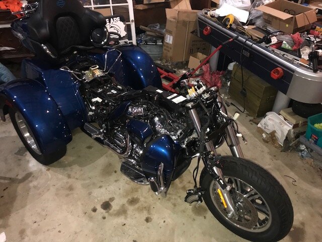

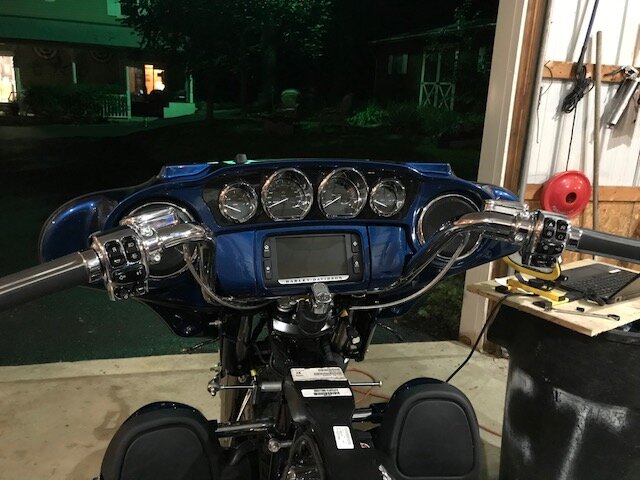

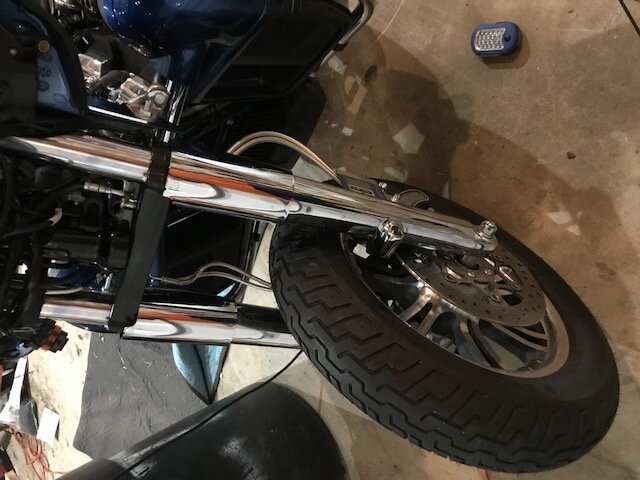

Getting ready for the front end mods. Will be swapping out the inner fairing and dash panel for painted to match ones, adding the new amp and speakers, swapping out the radio face and the gauges with ones that have blue back lighting to match the bike, new bars with all chrome hand controls, new braided chrome clutch line and brake lines, new clutch cover and new chrome lower forks.
Here is partial tear down progress.....
Let's see, so far we've added the comfort lift, Adjustable Rider Backrest, WHIM (along with 2 HD Sena 20S EVO's), garage door opener, rear bumper, trunk organizer, tour pack organizer, L2RR2L Gold Console Door, L2RR2L Air Cleaner Cover, HD paint protection, along with the Smart Siren II with Remote and the HD Road Zeppelin Seat. We are also adding the L2RR2L Gold Derby Cover, Timing Cover, the Kuryakyn mud flaps, Kuryakyn Trunk Latch Accent, and the Hog Skins Fairing Protection.

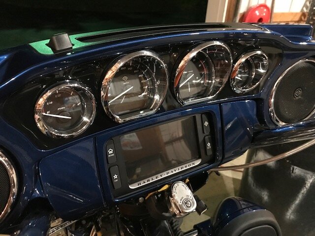

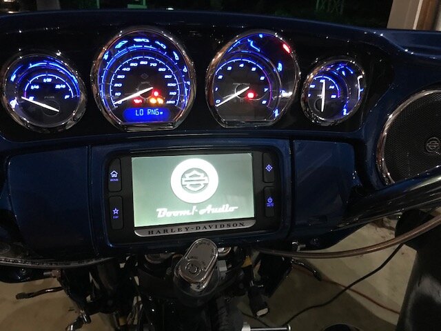

OK, so I have the catless headpipe I made, ceramic coated inside and out and installed. I have the new chrome fork cans and lowers installed. The new stainless brake lines installed. The new bars with internal wiring, all chrome controls and backlit buttons installed. And the new painted to match inner fairing with trim installed with the new amp and whim module, and the new CVO gauges I had modified to blue back lighting. Just need to button it up and enjoy. I am hoping to get her done in time for the 115th anniversary ride coming thru York PA this weekend.
