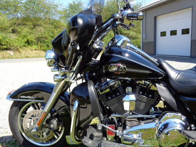

wheels
I put a Harley chrome 19 on the front and a set of chromed 16's on the rear using Pirelli tires. It fills out the wheel wells nicely and looks great.
By the way; if anyone is interested, I have the 2 chrome 15's with tires for 500 plus shipping that includes the 1100 mile tires, near new. The wheels are from my 2017.
Didn’t happen without pix :Shrug:

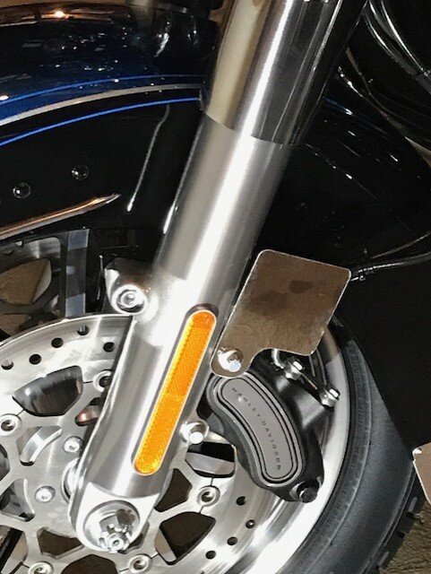

Inspection Tag
Here in PA we are supposed to get the bike inspected once a year, and they typically put the sticker on the front fork slider or can. I did not want to do that especially since I have chrome sliders and cans to put on the bike. I dont want them placing that sticker onto the chrome. I bought a polished stainless steel inspection sticker plate, and placed it on the front fork using the upper caliper bolt. I had to use a spacer behind it to fill the machined area around the bolt hole. I had the sticker put on it yesterday.
Nice touch!

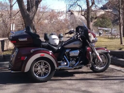

Better ride with DK Comfort lift
Received and installed DK's Comfort lift a few weeks ago. Went for a 70 mile ride through the foot hills to feel the difference in the ride. And what a difference, the new suspension felt softer and more responsive to the constant changes in road surface. No more wig/wag pounding as I navigate through the pot holes and ruts. This is a must do upgrade if you own a trike.

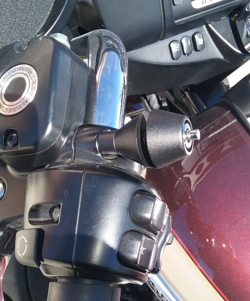

Also installed the Lidlox helmet locks I received the other day.
A little spendy but worth the security.
