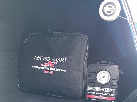

I had previously purchased a mini jump starter and a mini air compressor to keep on my bikes. I added heavy duty velcro to the back of the compressor and the jump start storage pouch and stuck fast to the inside on the trunk liner on the side out of the way.

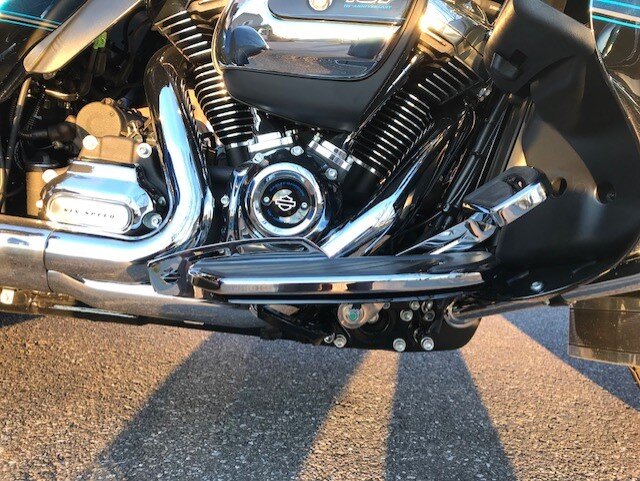

New Brake Pedal and Footboard spacers

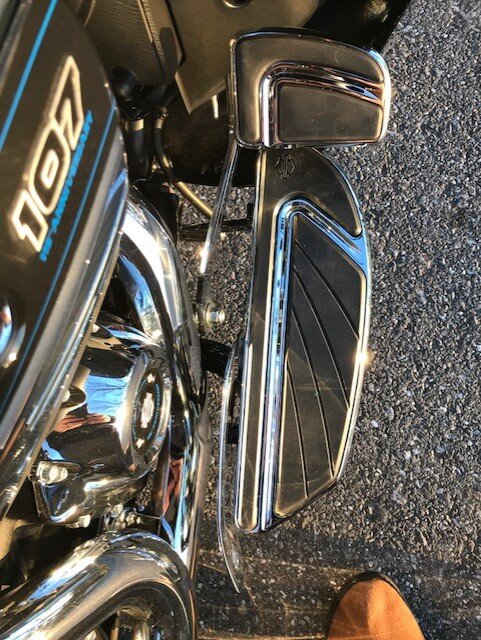

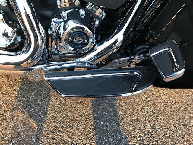

I also added today, a new extended CVO style brake pedal and pad, my CVO footboards, a boot guard and 3/4" spacers.
The extended CVO style brake pedal is from Softbrake. It lowers the brake pedal closer to the footboard. It gives you more room for your foot on the board and less movement to use the brake pedal. The 3/4" spacers are to bring the boards outward away from the exhaust heat and make it a more comfortable stance for your legs. The boot guard keeps you from putting your boot up against the pipes, and the CVO pad and footboards are to just add some CVO style. I'll update the left side next weekend.

I have the original XP-3 jump starter, it comes in a bag that holds the jump starter, jumper cables and some cables to let you run other things like a cel phone. The jump starter is only 5" x 3" x 1". It also has a built in flashlight. I also purchased the hard wired jumper wires and have them wired to the battery and tucked behind the side cover. They do not recommend you use the battery tender wire for the jump starter (too much voltage). I also purchased the tire inflator that is only 4" x 3.5" x 1.5" in size. I then used heavy duty velcro and attached to the inside of the trunk out of the way.
Took her out today. I definitely like the reduced reach clutch and brake levers as well as the extended brake pedal and footboard spacers.

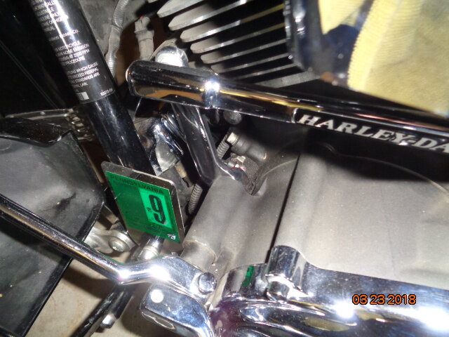

Greaseable Shifter shaft...

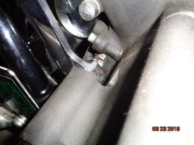

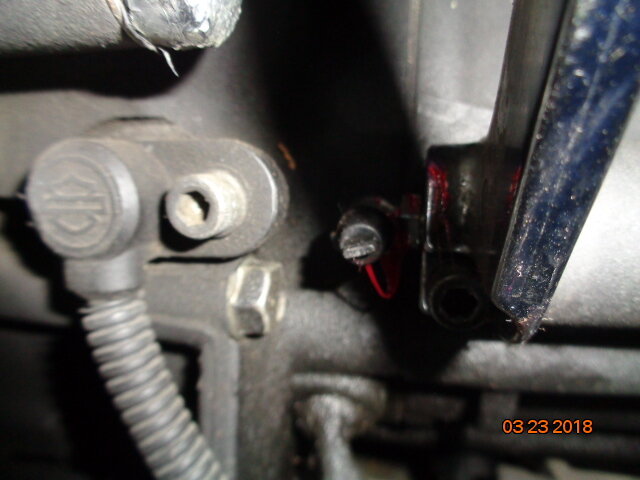

I noticed my Toe shifter was loose so I tried to tighten it up. No deal pull as I may nothing changed so new shifter shaft easy change although I did go with a pricey one from Pingel it has a zerk fitting on the motor end grease once a year or as needed. a little hard to see but it sure is smooth. The old shaft sure was corroded from no lube my neglect I suppose.DSC00723.JPGDSC00724.JPGDSC00725.JPG
I noticed my Toe shifter was loose so I tried to tighten it up. No deal pull as I may nothing changed so new shifter shaft easy change although I did go with a pricey one from Pingel it has a zerk fitting on the motor end grease once a year or as needed. a little hard to see but it sure is smooth. The old shaft sure was corroded from no lube my neglect I suppose.View attachment 55793View attachment 55794View attachment 55795

yes that is the one a little pricey but it is easy to install. You have to hold the Zerk fitting just right to get it to start but no problem just lucky I guess. Gold member JPC ya kno. just looking for replacement for bad one stumbled across it on website. Really hard see from beside trike.
