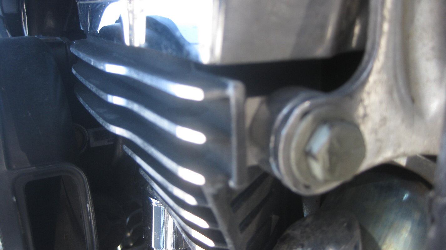

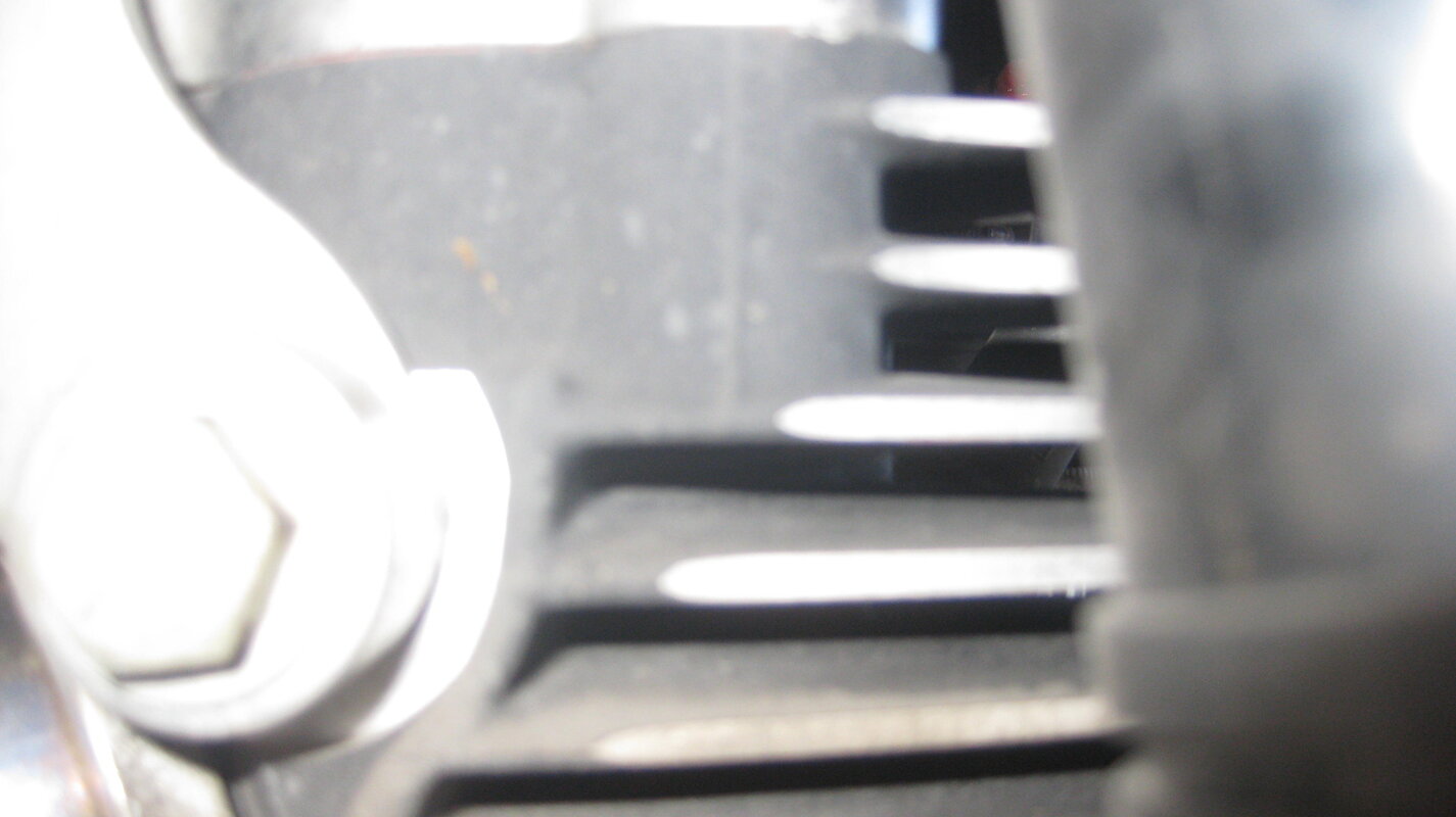

my '09 t/g rt. bolt sheared off & had the ft. head replaced, by dealer
Yep those are the bolts that I had to used green lock-tight on. So far that's the only way I could keep them tight..
If they loosen and you don't catch it in time, They'll break or worst ream out the threads in the head.

Lost mine last year with spacer. Didn't break just walked out. Didn't notice until washing bike.
you can drill the bolt heads & safety wire them.just go to a old h-d bike & look at the 2 inner primary bolts. they came safety wired from the factory.
