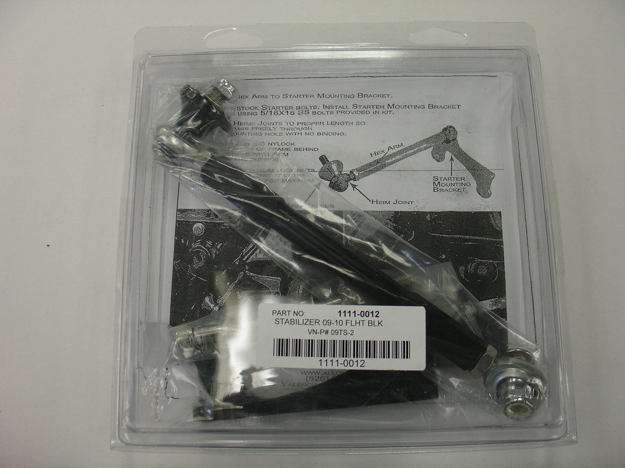

Has any one tried one of these on their 09+ TriGlide?....
I did put a dampner style link on the front of engine, but wondered if one of these would be of benefit as well?????

This kit is designed for the 09+ models..It bolts to the starter housing and I presume to the frame near where the right heat deflector goes...I do believe the rear does flex on my trike, and with the dampner style link added to the front, allows the rear end to twist even more...I can see how the rigid link on the front breaks the bolts off the head from swingarm / engine twist and just wondering how this kit would work and if it would put strain on the 2 starter housing bolts, or the frame area for that matter...Hmm...Always new products and we are the testers..!!!
When Harley designed the frame for the Triglide they beefed it up, I'd be shocked if it twisted. I've had the front end up a couple times, done some burnouts and hammerd many of windy roads and never felt any flex. I'd be hesitant to stiffen things up more than they are.
Mike...I was referring to the powertrain twisting in the frame, not the frame itself twisting..it seems as even tho the powertrain is mounted on 4 isolators on the 09+ that they still twist..This is what puts strain on the upper front link which tends to break the bolts in the head off...Now that iv put a dampened link on there, it appears to me I have allowed the powertrain to twist, somewhat like the previous 08- version on just 3 isolators...This kit appears to mount to the starter bolts and frame to keep the rear of the powertrain from twisting in the frame...Not sure if its a good idea or not...
Im just reaserching the product too see if anyone has actually put one on a 09+ chassis, 2 or 3 wheeled..HanKb.
Oops, good old night shift head up the butt ides kind of bit me. I'd watch things real close if you decide to give this a try, its bound to place stress on the inner primary which might crack it or cause a leak.

The threadstarter mentioned the Alloy Art Touring Stabilizer - has anyone installed this thing on a Tri Glide?
How is the experience? Especially with a view on the front stabilizer and the force on it?
