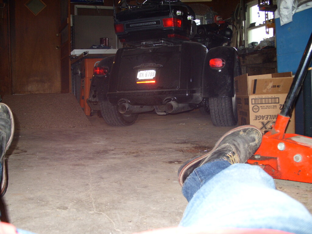

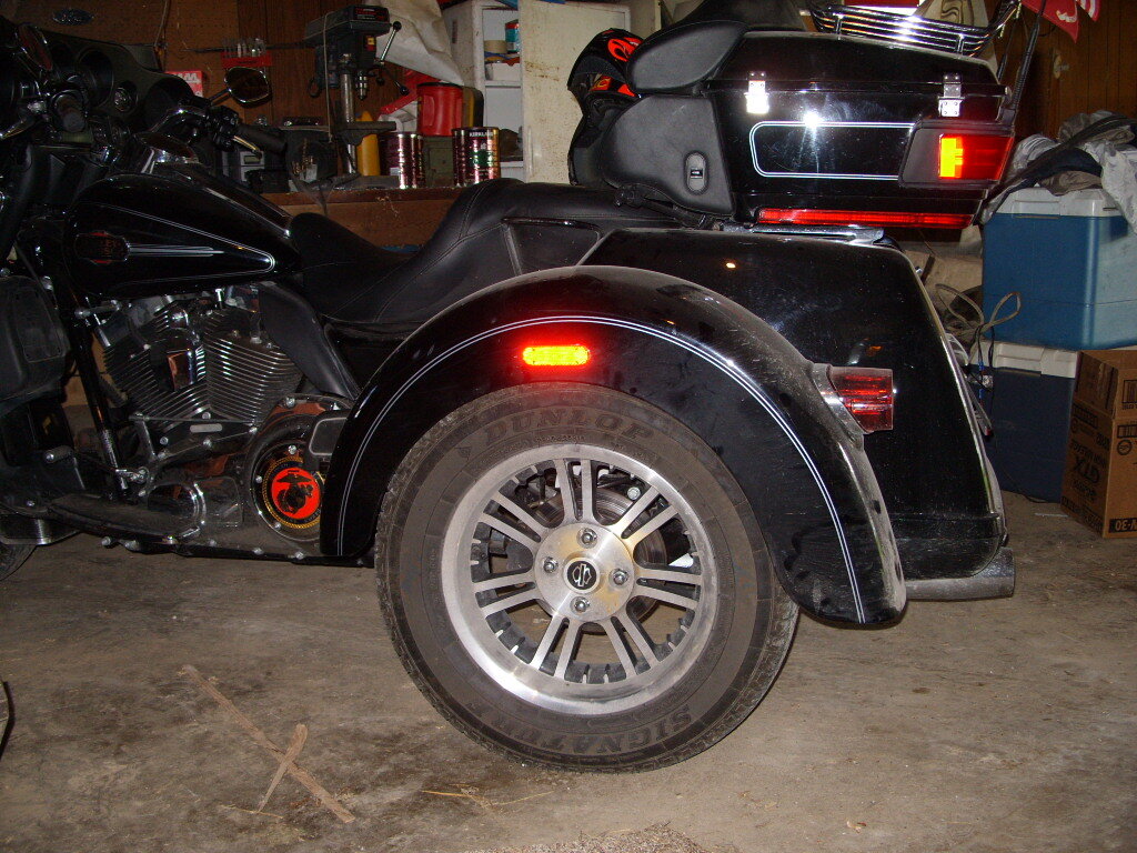

I just put a lift on mine last week - don't know the brand. I just went out and measured it and it's just under 11". Originally the top of the fenders were just above the top edge of the rim, and the pipes were about 3" off the ground - Real tail dragger. Now the top of the fender is almost at the top of the tire and the pipes are about 6" off the ground. Oh and there were no instructions. Still only took about 2 hours. It took longer to figure out how to get it up in the air than anything else. Happy trails.
