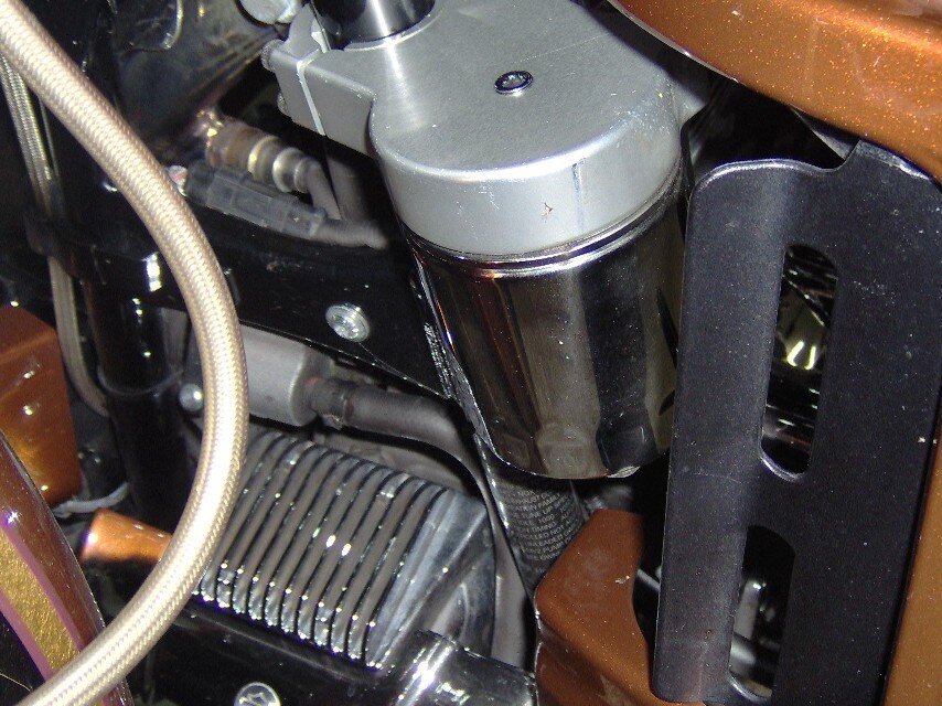

3 1/2 qts has always works for me. No blow by.001.JPG I installed a remote oil filter assembly on the frame up from the oil cooler. I loosen the oil filter a bit and remove drain plug. Siphoning action cleans out lines and cooler.
