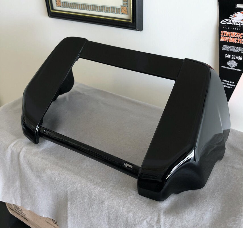

So I got out my manual, looked up on google, tried to find a video on youtube and then went at it to remove the plastic oil cooler cover. I did successfully remove it but destroyed the bottom posts while doing so. While at Harley buying a new cooler cover, they asked me if I needed the grommet set. I went back to the shop and asked them about removing and reinstalling the new one. Once seeing that the grommets stay mounted to the frame (which I thought were part of the cover) the project was so easy I was like "duh" :gah: I sent the new cover to the guys at The Factory Match and they Vivid Blacked it for me. Reinstall was head shakingly easy. ... Did you use something to clean up the fins or just water?
Your cover looks great Noodles. What I was trying to do was shoot a light spray of flat black enamel on the fins to tone down some bright spots that developed, probably from road scum and debris hitting it. They just needed a freshening up and I wanted to do a good clean of the cover ring. When I was done I ran the fan for a few seconds to make sure air flow was still good. It was, so I reset the grommets and put the cover back on. Now that I know what I'm dealing with next time I'll squirt a bit of lube onto those grommets to make popping that cover off a bit easier.
