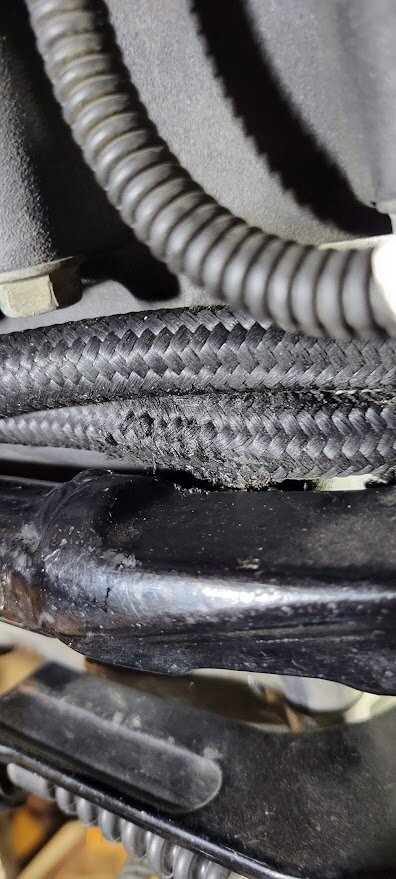

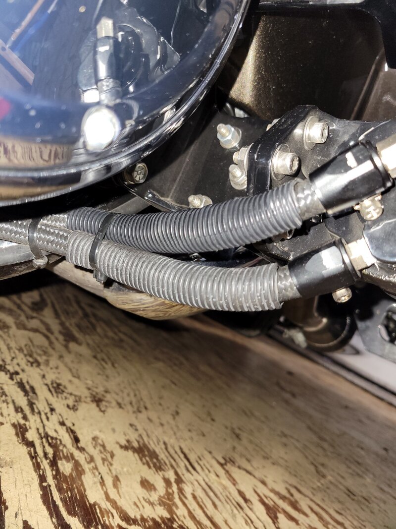

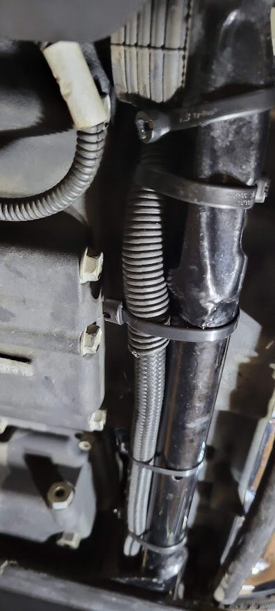

Love the DK remote oil filter kit. I didn't like the hose that came with it so upgraded to braided. Might have been a mistake because after checking it out at the end on the season I found the braid fraying in one spot. Added a length of wire harness tubing over it. Also added it to the section exposed at the filter housing.
