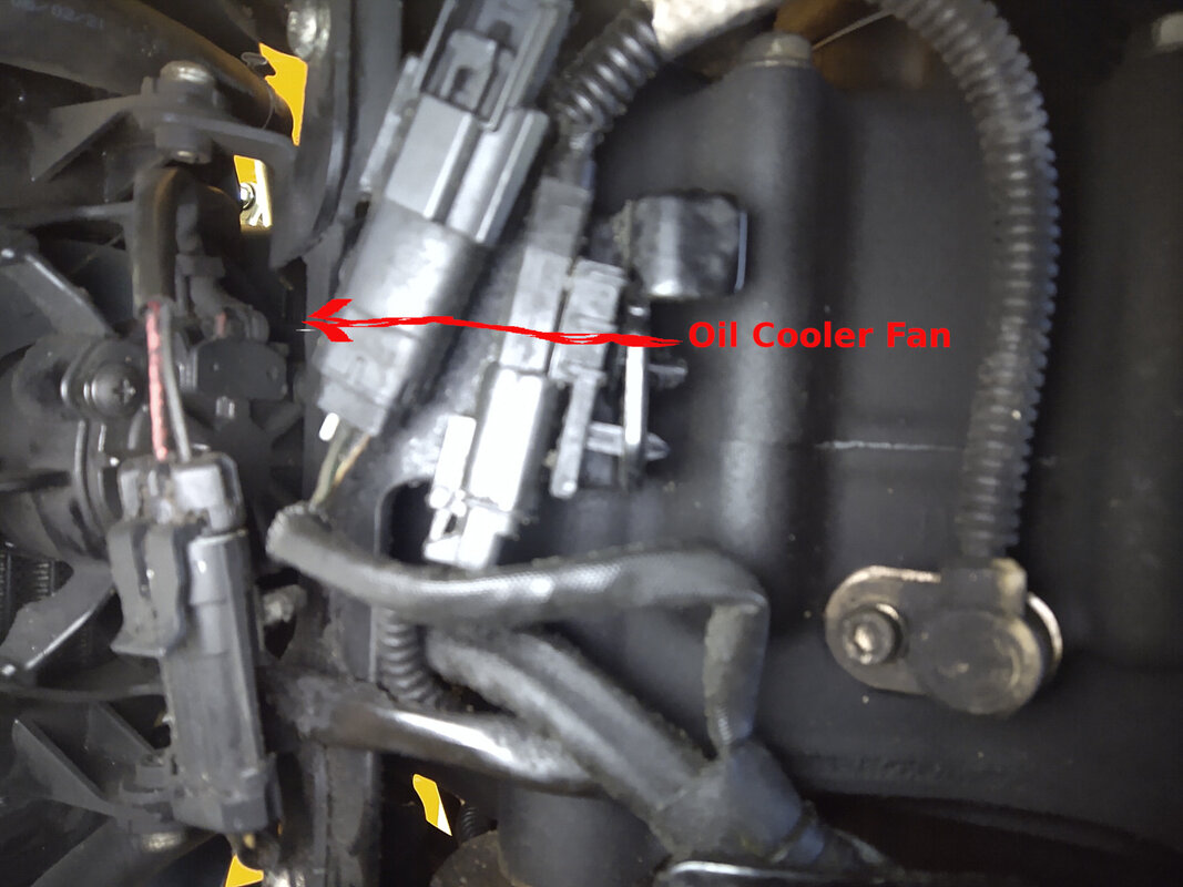

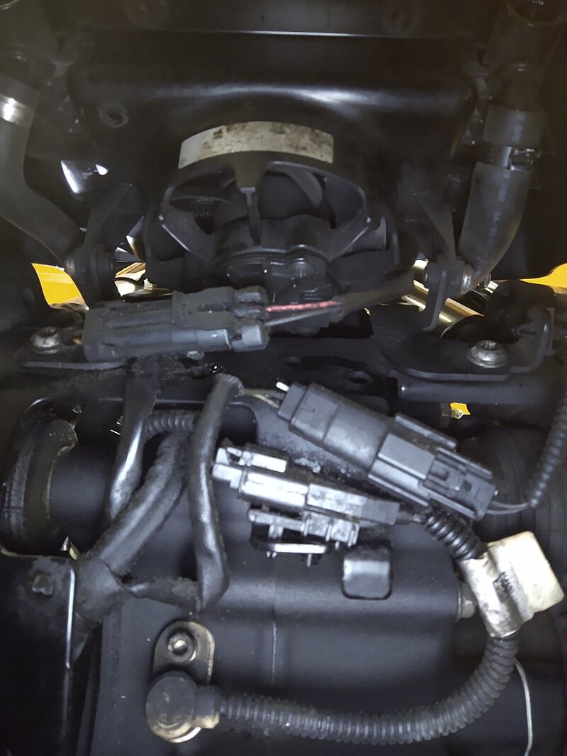

Had a occasion to hit some road construction locally and picked up road tar on my wheels. Didn't see it 'till I got home in the garage. A fine mess. Got 95% off the wheels and miscellaneous other places with some WD40, but I was looking underneath at the oil cooler wiring mess and was wondering if anybody has ever seen a cover for that area. Those wires get a lot of road debris on them and seems a plastic cover of some sort would be useful. I cleaned them up with water and dish detergent mix then blew it dry with the cooler fan and a pat down with a rag.
I was thinking more of a piece of plastic that would attach to the oil cooler cover and clip to the frame to protect the entire area.
The flexible wire loom would be the easiest or just temporary till you come up with something.
Thanks, but what I want to do is cover that area where the wiring is completely, not just the wires and connectors. Think something like the skid plates on Pans and Shovels. The wiring already has wire covers on them, but oily road scum tends to find it's way into exposed connectors. A cover would keep the area clean and hopefully avoid connection issues.

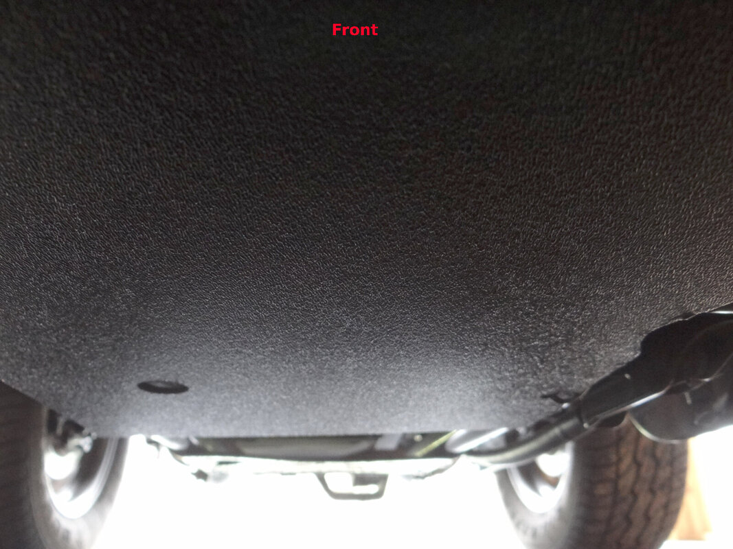

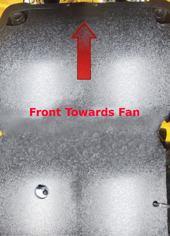

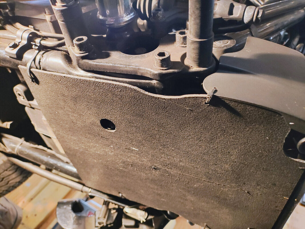

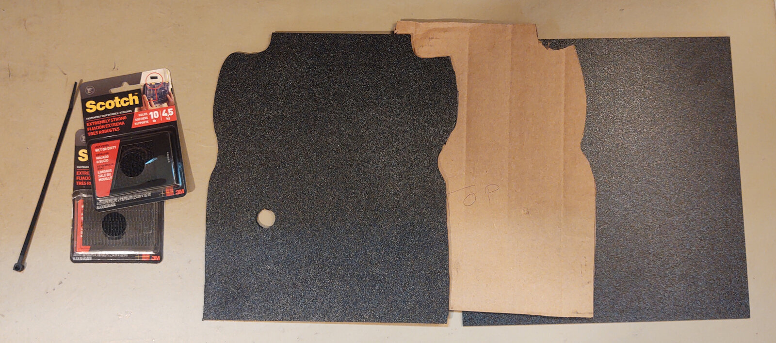

This is what I came up with. Using a piece of cardboard I made a template of the area then jigsawed the plastic to match. Used Super Velcro attached to the bottom of the cooling fan housing and on a flat plate on the right side that secures a connector. Had to drill a hole to let it show through to keep the plastic flat against the frame. The left side I needed to use a wire tie because the frame over there is much thinner in that spot than the other side and there's nothing to attach Velcro to. Sorry about the crudely stitched together pick of the cover. I'd have to find somebody with a trike lift to get a good picture.
Below is the area I want covered and two with the cover in place.

As an update, although I never had an issue with the heavy duty Velcro I was using, I opted to put small zip ties on all 4 corners. It's a minor inconvenience when it's time for an oil filter change, but that area where those exposed wires and connectors are is always clean, so it makes me feel better. It's been in place for over 7 months with no problems.
