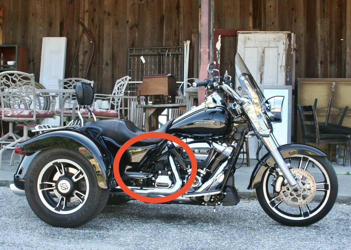

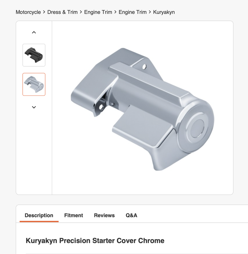

So I have had this Chrome Starter Motor Cover on my wish list for a while now. It's not an expensive piece but I have hesitated because the installation instructions say disconnect the battery, pull the main fuse, use a ball head hex wrench to install the bolts. The YouTube guy (from J&P) puts it on in 1 minute 43 seconds and never says a word about getting near wires (which is definitely not my thing) So today I actually saw this Chrome Cover on a FW and it looked great. It's a mighty dark area behind the engine where the starter sits. A perfect piece of chrome place. Any input is always greatly appreciated ... Thanks

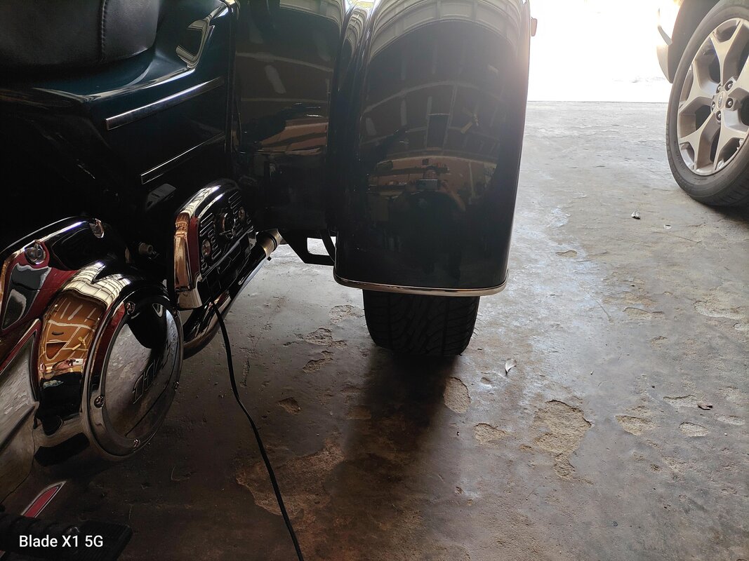

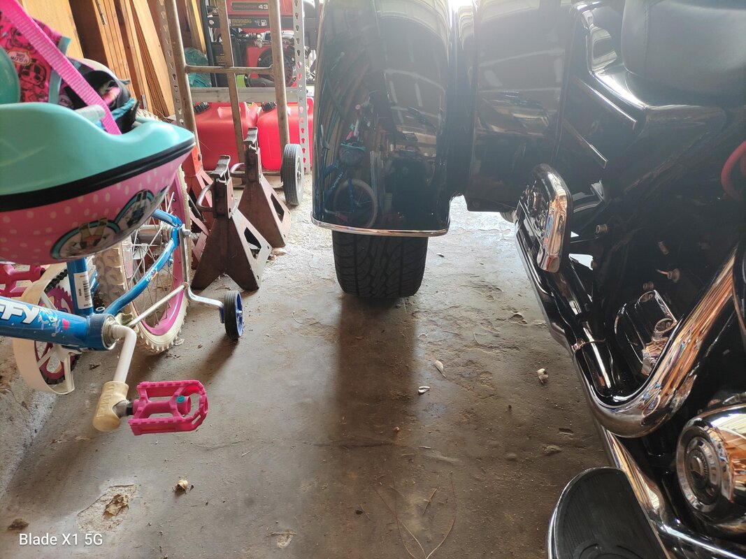

Added chrome to bottom of rear fenders

Jeff...from the video, at least to my eyes, granted that they like the rest of myself are 72 years old, the Kuryakyn Chrome Cover is just that..a Cover. It appears to fit over the existing starter not replace the original assembled cover. Therefore no worries about electrical contacts, fuses, etc. Again, merely my observation and indeed will be an easy and positive appearance upgrade. Keep us informed.

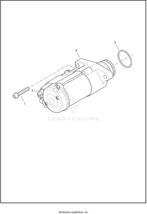

Look @ the cover then look @ this picture and you will see that the cover will be over the solenoid

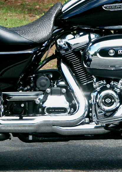

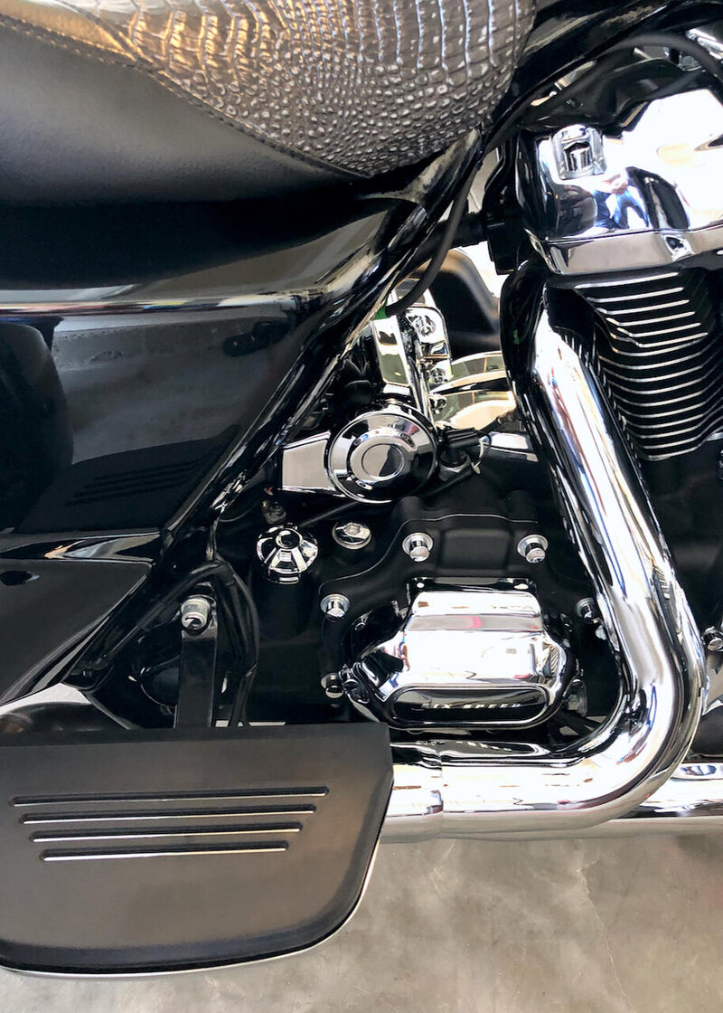

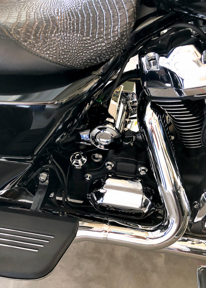

Chrome Starter Motor Cover ... Install requires a minor amount of cursing and just a touch of loosing my mind, but in the end, WalLah. Nice right? imho

My Kuryakyn Starter Motor Cover showed up today. Two hours later I gave up. The holes didn't line up. I could catch a couple of threads on that inside bolt then it would stop turning. Even pushing down while trying to thread it in didn't help. It got to the point where I was afraid of stripping out the threads on that inner primary cover and that would be a really bad day. I'm a stubborn man, but it was time to quit. Maybe I'll try it again another day.
JT, would it help to ream the holes a bit for some wiggle room
That is why I do not like stamped parts ,some times 1 run gets screwed up, nothing but bad JUJU
Hey JT ... I'm gonna assume that you used a ball end allen socket to get to the rear bolt. After several expressions of profanity myself, and a couple of socket head slips while removing the original bolts where I was sure I had snapped the bolt, I regrouped, called in the level headed wife and anxiety meds, we went at it together. This made a big difference. Debs got on the wrench end and I went around to the other side of the bike. When the socket was properly in the bolt head I held it in place while Debs backed it out. The extra set of hands (and eyes) made all the difference. The directions also call for a 5/16 allen head and I'm sure that you quickly discovered that it's actually 1/4 that you need. I didn't think it was going on but after the regroup it all fell right into place
It's on! Had to ream out both holes to get the holes in the cover lined up with the holes in the inner primary housing, but that rear mounting bolt still wouldn't tighten down. Put the original factory bolt back in and it tightened right up. Something about the chrome plating on the Kuryakyn bolts weren't mating right with the threads on that back primary hole. If not for those two issues that entire install should have taken no more than 20 minutes, start to finish. It does look nice.

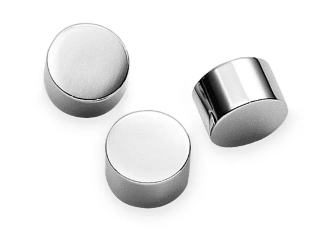

Glad you got that worked out JT. You should check out the YouTube video of the guy from JP Cycles installing this. Takes him like 1 minute and 34. I found that humorous during my install event :) Also if you like, you can put 2 "snap caps" over the bolt heads so everything is chrome again
