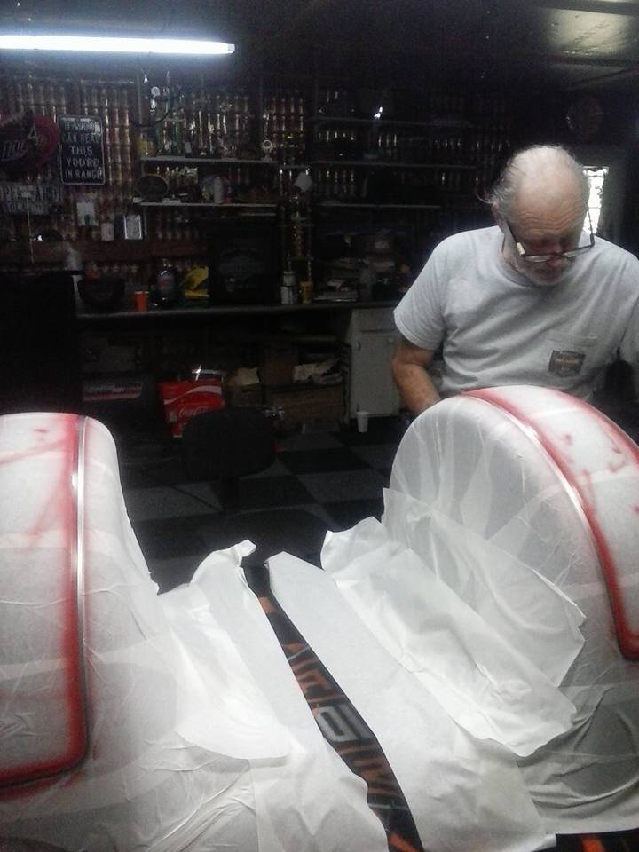

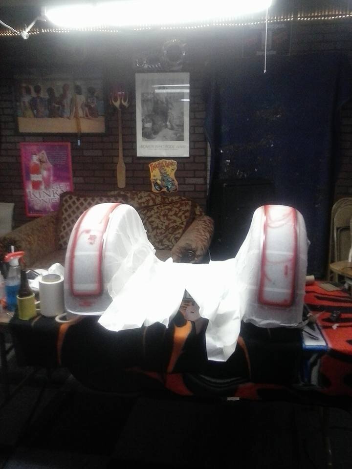

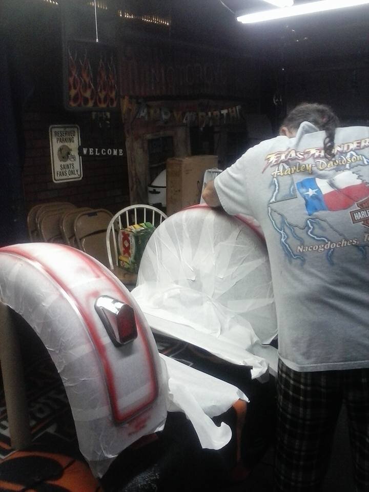

Coming together! Now this is just masking tape. There will be two pinstripes, with the bike color between them. One Redish Orange and a smaller one silver! They will be painted and not a sticker!

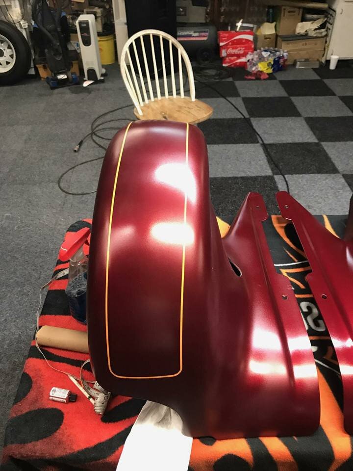

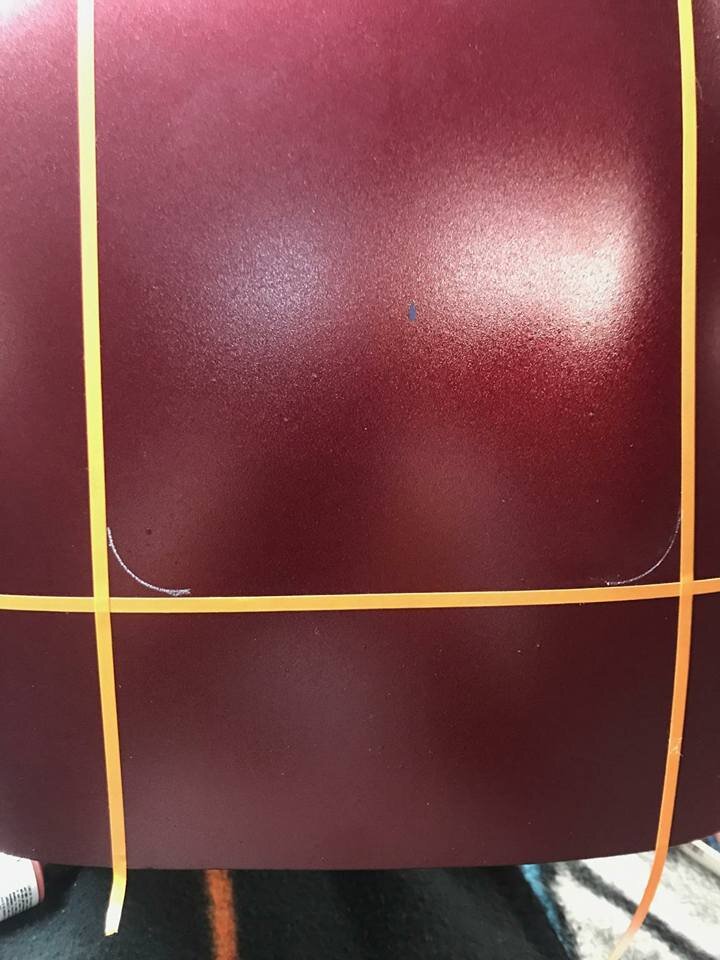

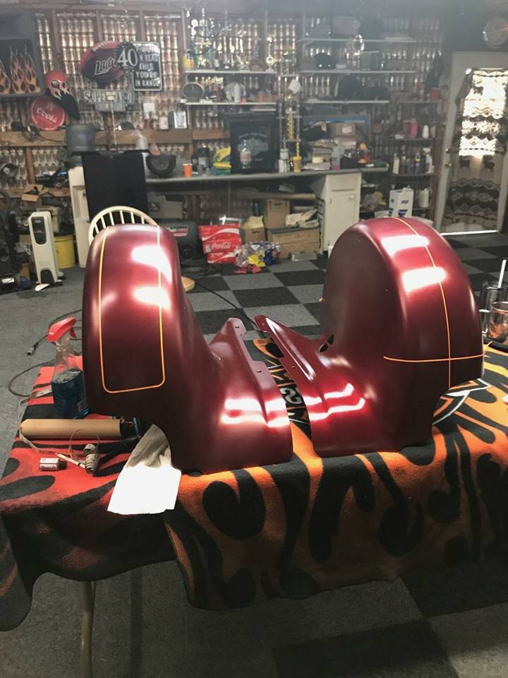

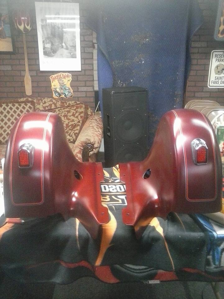

Pin-striping done, holes drilled for lights so paper tape was removed, lights will be removed. Now 4 coats of clear and sanding and buffing! Then lights and wiring. a few more days and it will be ready!
