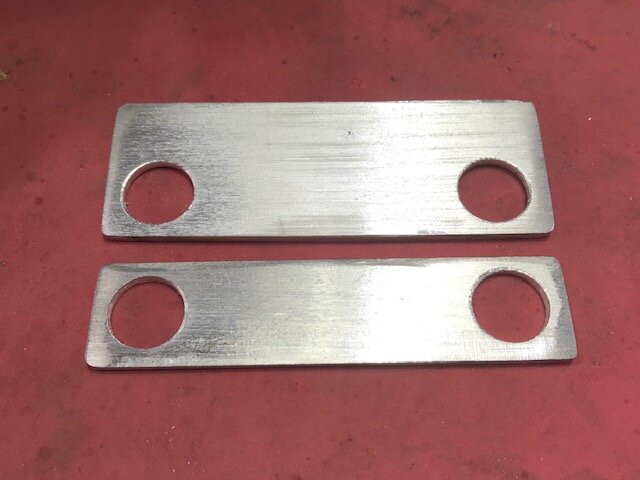

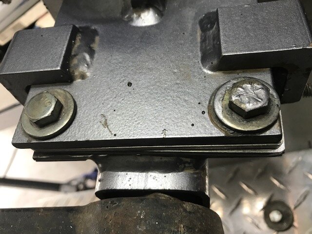

First thing I did was to manufacture some aluminum shims from some stock I had... I purposely made the holes in the shims large to facilitate wheel alignment. See photo below.

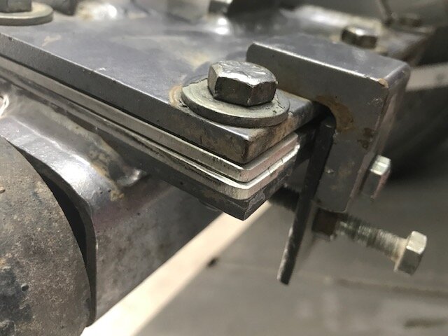

I had previous experience with wheel alignment on the Tow Pac cart and in some cases it is necessary to grind the holes in the plates a bit larger, hence the large holes in the shims... On the right side, it took 2 shims of about 1/8" thickness each to obtain vertical alignment of the wheel... See pics below...
image3.jpeg.

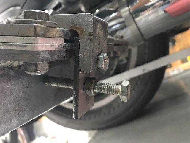

It was also necessary to fabricate new brackets for the alignment stop screws as seen in the last photo... I will at some point in the future beef these up a bit by welding some additional material to them but I did not want to weld with the cart attached to the bike, so the cold roll plate will do for now...

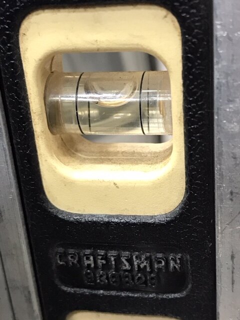

The end results of the shimming are shown in the photo below...
image4.jpeg.
After the vertical alignment I did a standard parallel wheel alignment and the right wheel is within 1/32" of an inch or less parallel to the rear tire...

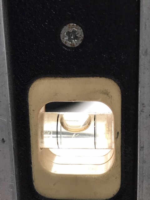

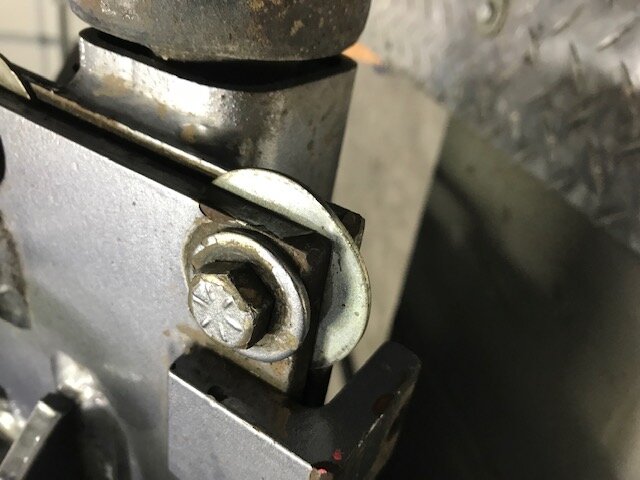

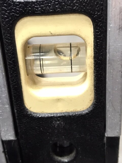

So, re-threaded 2 metric bolts to 5/16-18 and started the other (left) side of trike... First picture shows level before I started...

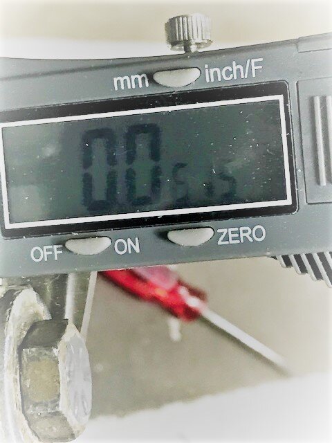

Next photo shows fender washers used for shimming which are about 1/16" thick as shown on digital caliper...
And finally, the finished product as seen on level... Also realigned parallel adjustment to rear tire and is less than 1/32" out... Now, if it ever stops raining, we'll go for a test ride... As it turned out, because the washer was only about 1/16", there was no need to add an extension bracket to the adjustment stop bracket, so I did not need to use the 2 bolts I re-threaded...
