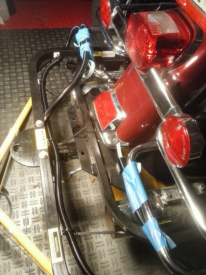

Doing the electrical wiring under the seat and running the wires to the back of the motorcycle for tail lights. This will in tale more than I first thought. The lights must draw current from the battery and the signal from the wiring harness. So two Items do this on a Harley for about $120.00. To go direct to the harness is not correct and can cause problems.
At that point the bike part of this build will be finished. Electrical Parts are on order Now.

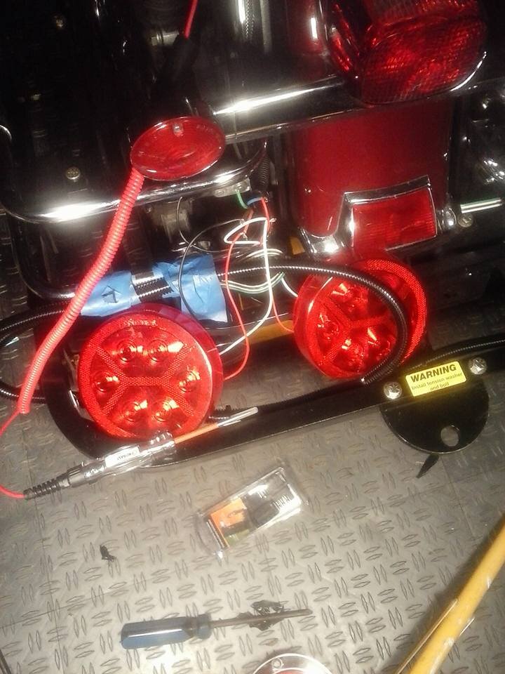

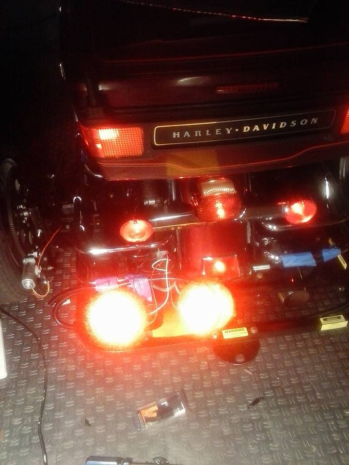

Sub-frame looks good Bob... May I suggest you go with LED lighting to keep the current draw down... That way you can probably go directly to the particular lights directly... That is what I did with mine and encountered no problems to date...
Les
I'm going with LED 6" round lights. They draw very little, and I thought the same as you and we are probably right but both Harley and the factory, for the electronics, assured me that wiring direct into the wiring harness can cause problem no matter the draw. I know they want to sell there product but I don't want to take any chances. I can't see how .0654 amps. could hurt anything. Factory guy said it's not the wire it's the computer. Don't want to take a chance. I know it sounds like I bought a bill of goods!

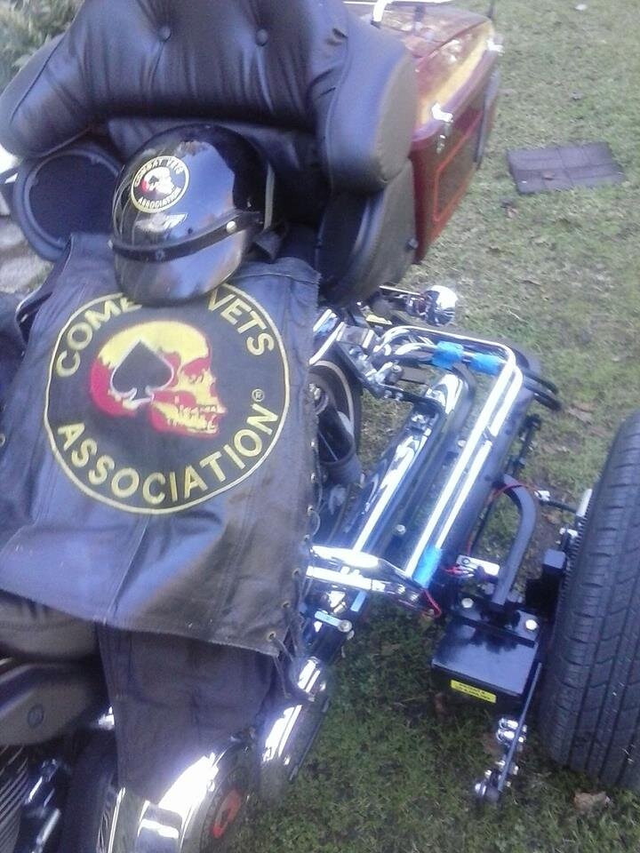

This is where the Two wheel Cart will attach to the motorcycle in three places. Very good strong attachment in my opinion! On the hitch attachment, in the center, there in another large bolt that you can't see in the picture. Also of course you can't see the left attachment that is just like the right one you can see.
Yep, agree Bob... I have had my cart off and on several times over the last few years and there is no issue with the attachment points... I did have an issue with the left attachment bolt cross threading once when I tried to remove it, but running a threading die up the bolt cleaned up the thread nicely and it was usable again... Looks like your getting close - I am anxious to see the finished product and hear your thoughts on ride and handling...

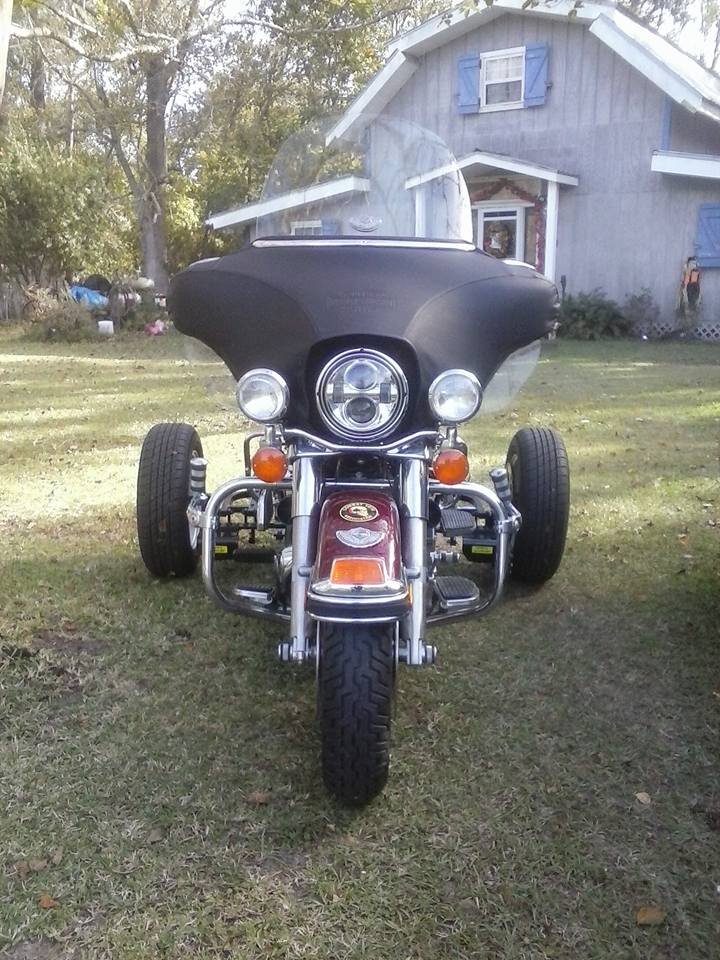

Cart on bike! the wheel base looks much wider on the bike than I thought it would!
Tires look Big and nice! Saddle bags and side covers stay off until it's all adjusted.

I've been riding it around our yard. Note how wide the wheel base is compared to our Big SUV! Wide to me mean more stability, So far handles like a dream at low speeds!
Toe was out a bit so I will ride it around the yard and down a little street today.

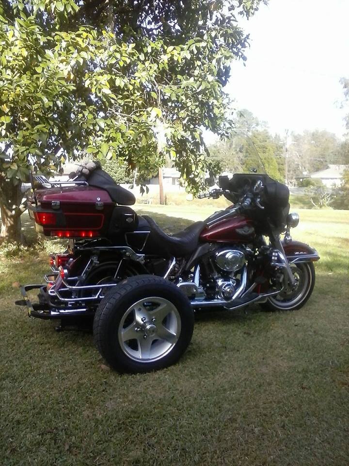

******THE TEST RIDE******
I got it all adjusted in about 1-1/2 hours this morning.
I didn't fool around with the down pressure.
Then took it for a test drive. The following was the test results on different types of roads.
I've been riding 3 hours!
Test #1--- 0 to 20 M.P.H. No shimmy as the Harley free-wheeler I rented did at low speed. Very smooth out the gate.
Test #2--- 0 to 50 M.P.H. Easy steering, one hand no problem, No pressure needed to keep it straight.
Test #3--- 0 to 65 M.P.H. Same as test # two, curved well. not shacking very smooth ride.
Test #4--- 0 to 75 M.P.H. Same as all of the above. No finders on the bike to test shake. Smooth. Now I didn't go one handed on this test, But I could have.
It short I'm more than satisfied with the performance of this kit! In my opinion it out rode any Harley kit I have tested.
Suspension worked awesome, better than Harley's straight axle set up! Stability was superb!
Now I'm yet to complete the set up and test the reverse and the finders on the kit.
More riding is in order and more testing, but so far I'm glad I got this Tow-Pac Kit!

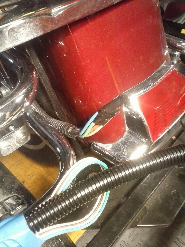

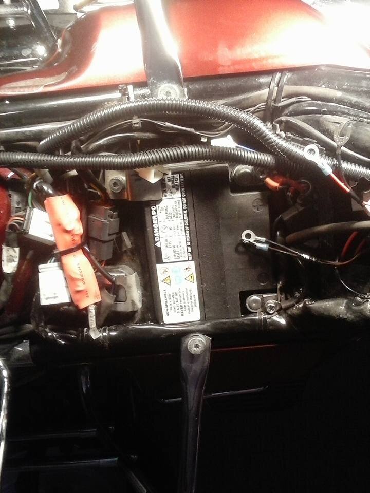

Harley wires and isolator, neat under the seat Two Hot and Two ground not connected but for tail lights and reverse.

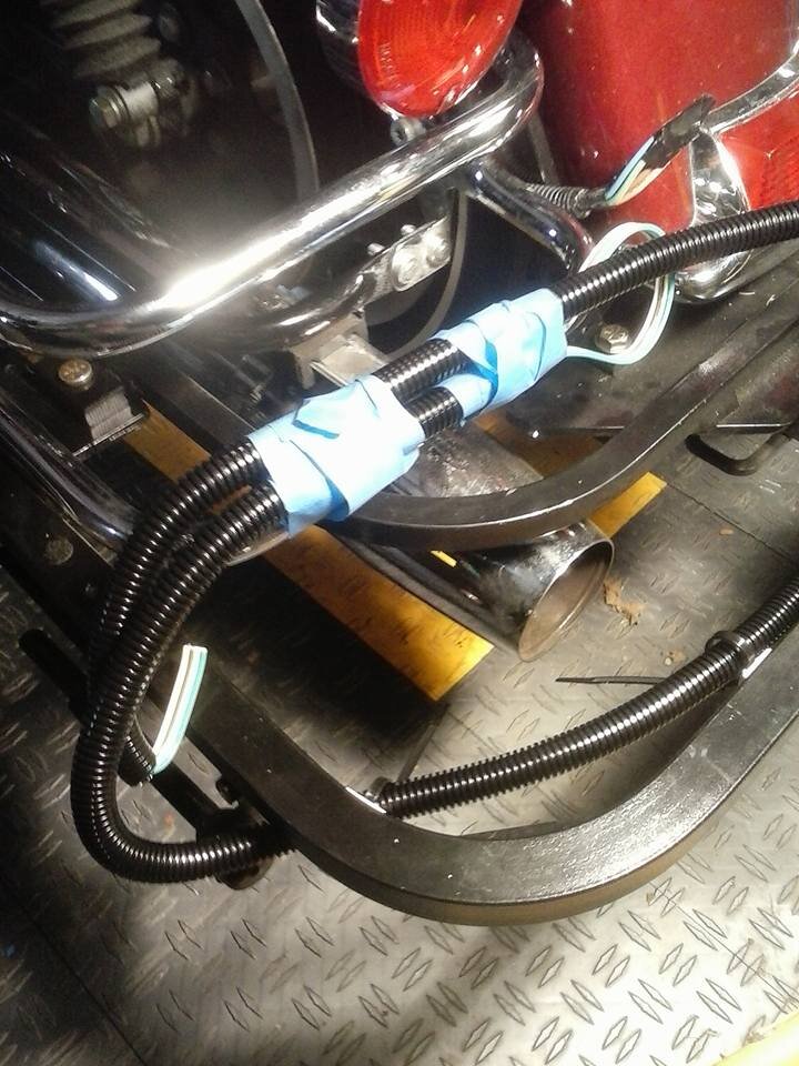

Tail lights wire harness run to back awaiting plug that's on order.
Also notice tail light wiring on cart run and awaiting fenders.

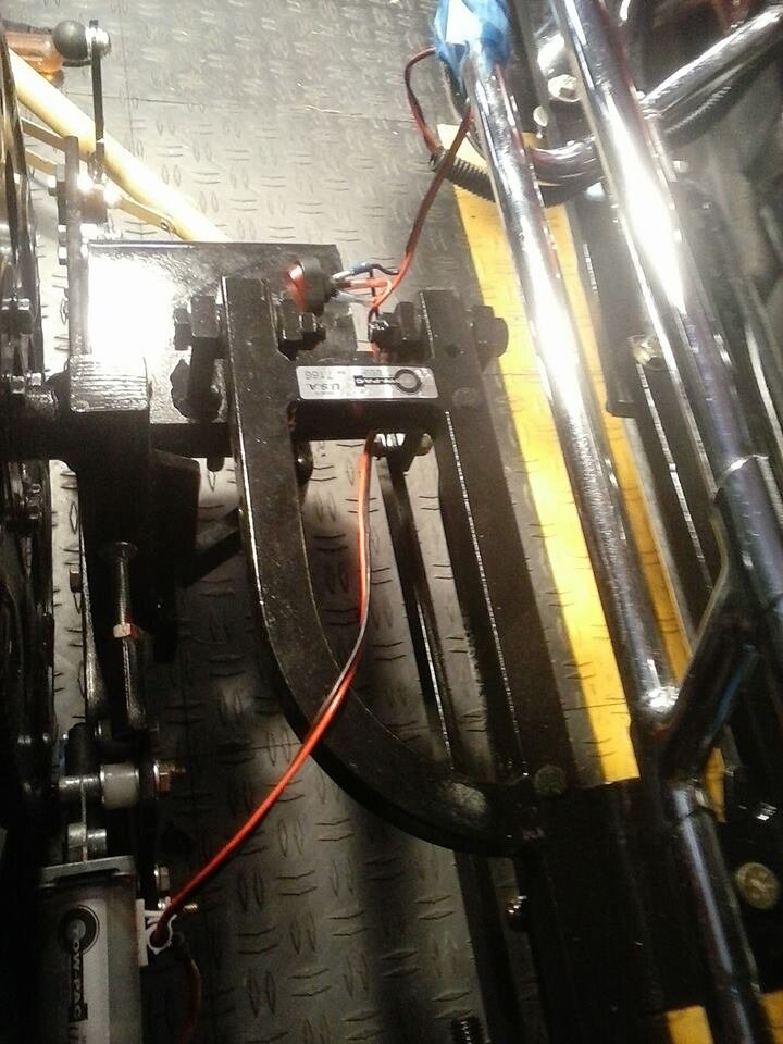

Factory wiring for reverse that will attach to finder skirts, I will add wire loom!
Note the switch that will go through hole in fender skirt I will drill, the lighted Red switch is sideways in picture.
Blue tape is just temporary to hold wires out the way so I can ride awaiting paint job on fenders!
Tie wraps are loose and I have extra wire until I can complete the job. Could be two weeks for paint job!
Next will be to test the reverse and test the tail lights. Also more riding and testing!

The tail lights are still not working right. I installed Rivco kit HD007-13 on my bike harness under the seat, then had to put in Rivco GL18007-IU still not working right. brake lights stay on all the time, everything else works. Now they are telling me I need Rivco kit EC 07664 to add to and go between the two kits I already have installed, because my cart tail lights are four wire and the bike is a five wire. So it's on order and shipped out.
These are my Big 6" tail lights I'm testing, I wanted surface mount LED's in 4" but couldn't find them. I'll have to use gaskets and a little caulking , because the finder have a slight round to them and the lights are flat.
I'm still waiting on the painter. This morning I will ride over to his shop on the bike to check on my parts. His shop is only 5 miles away.
