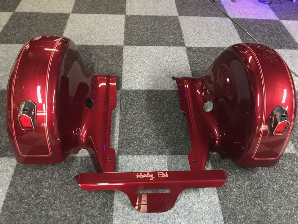

Rainy and nasty today. So I headed to town to get the last few things I will need when the painter calls me to bring my bike to his place for the final install!

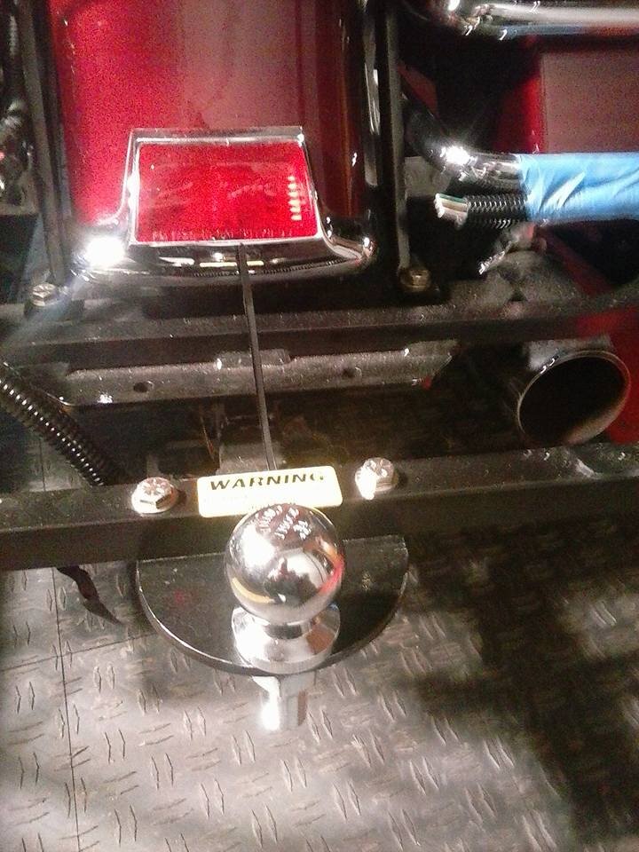

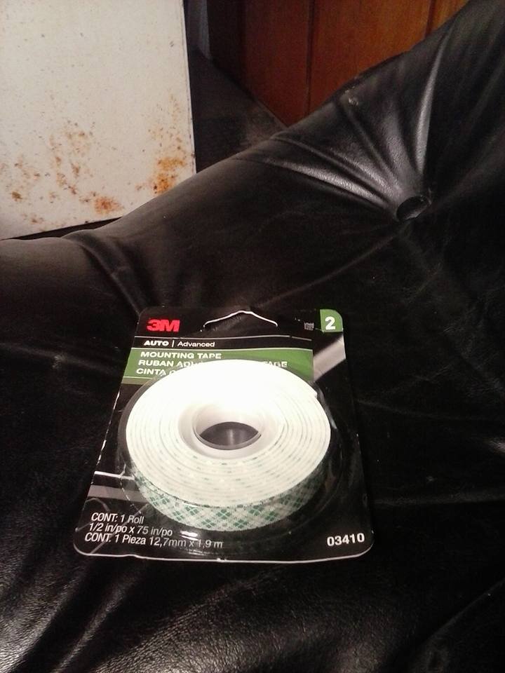

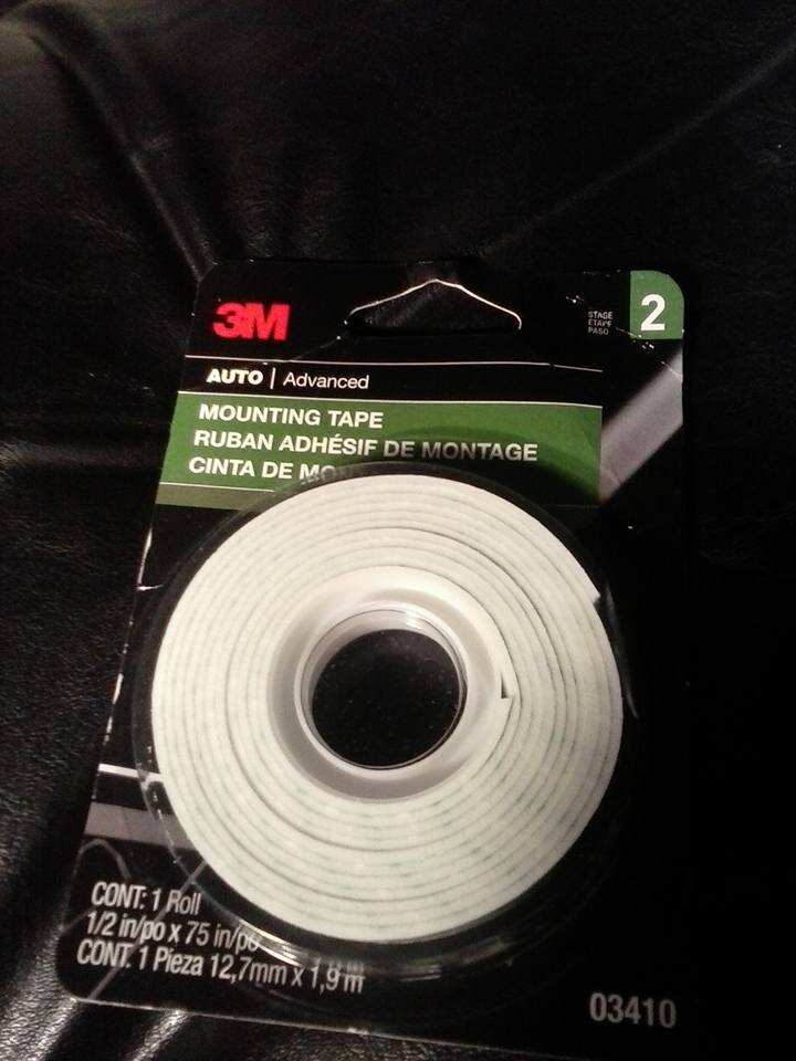

First the back frame cover is held on by double side tape no bolts or screws.
So I got some at the auto parts store.
If the tape should fail and it should not, then this trailer ball will keep it on the bike.

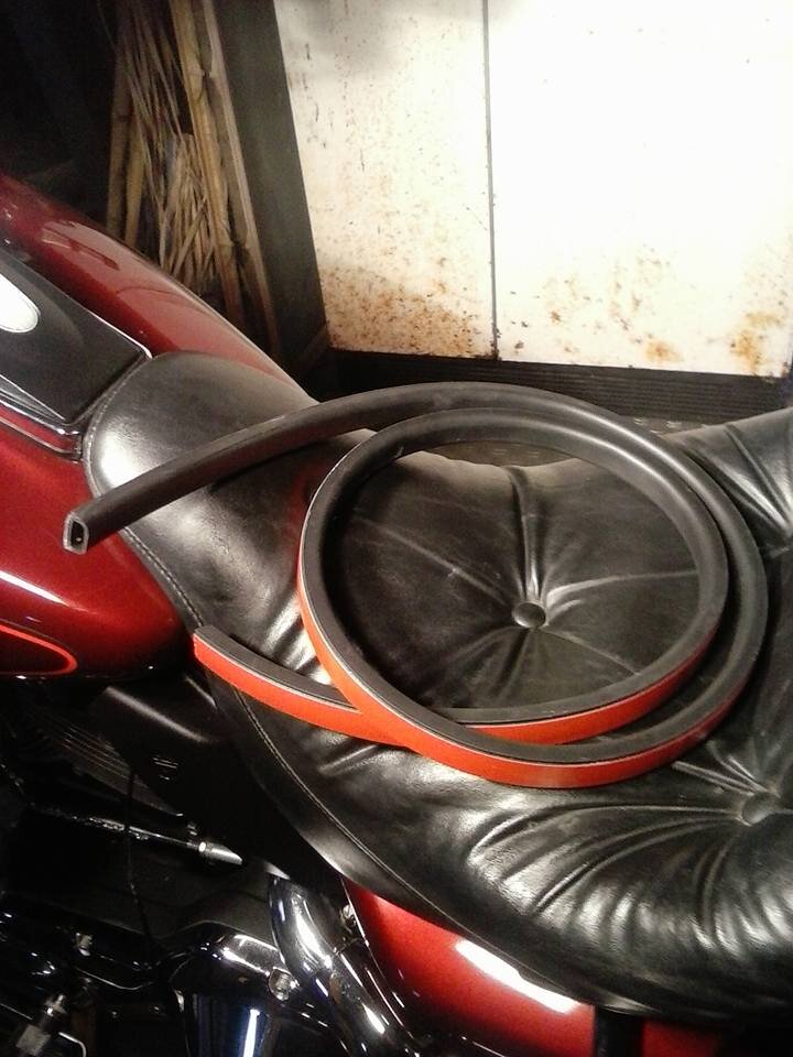

Denis, the painter asked me to get some of this adhesive loom. It has one side that will stick to the underside of the fenders to hold the wires for the tail lights! I have some other stickers that has a side that sticks and you put a tie wrap in. I will use those as well. He told me this is the best. I got 6 ft. at the Harley Shop. The part that is red is the tape you remove to expose the glue side. After cleaning the place you want to stick it to with rubbing alcohol, you just push it in place.

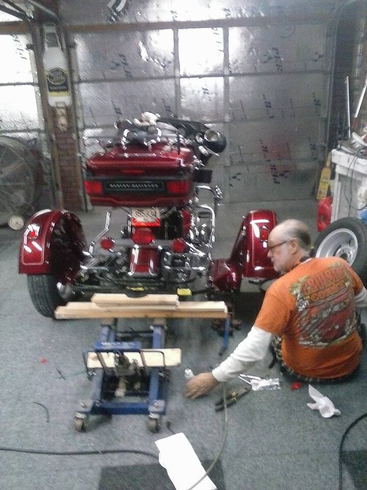

THE FINAL INSTALL!
I just got a call from Denis, parts are ready so I'm heading over there in the morning and we will install them! There are two fender "T"bars not shone in this picture, That bolt to the inside of the fenders and go through the big holes and bolt to the frame.

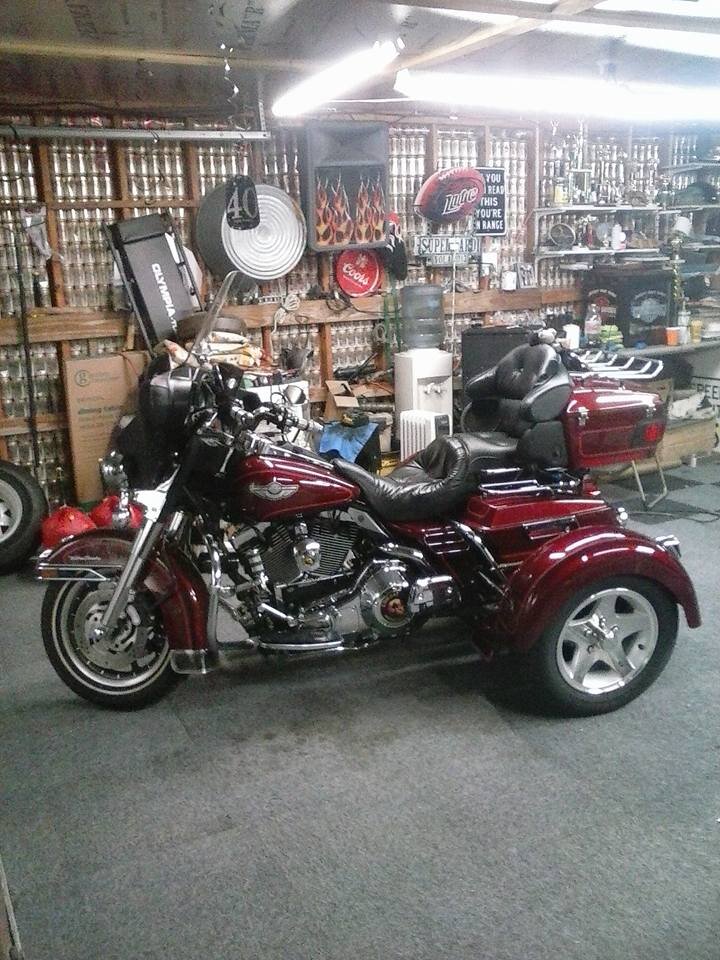

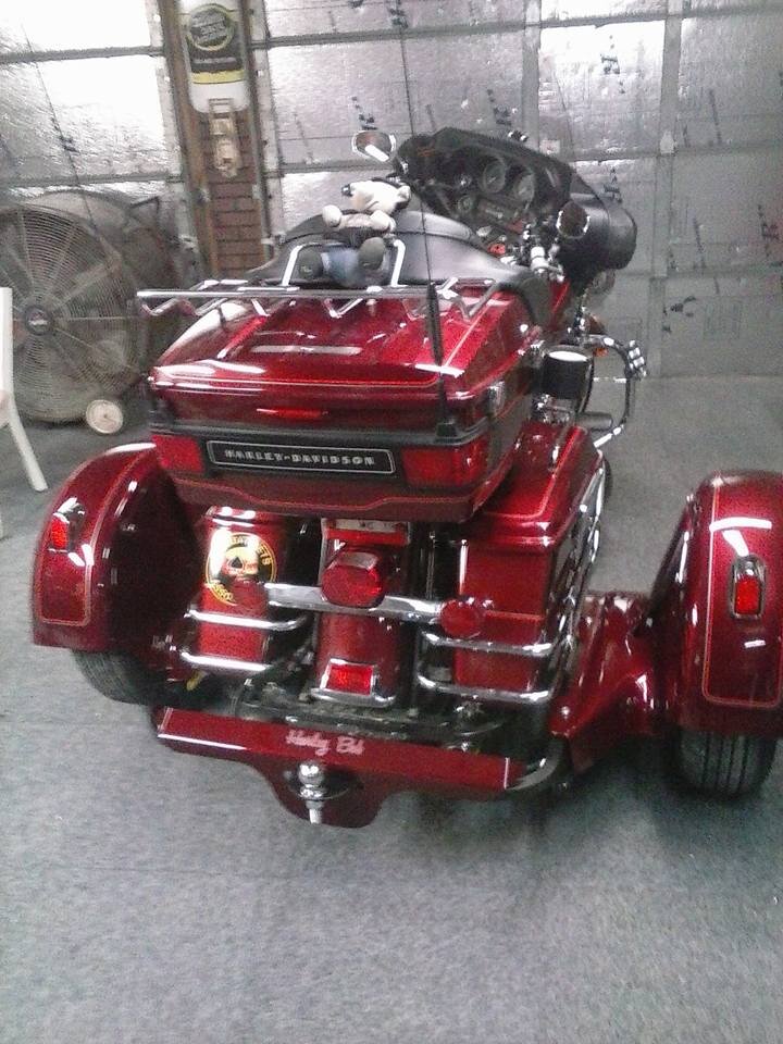

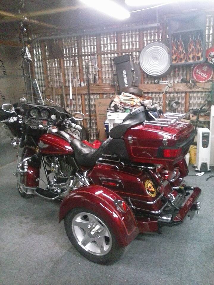

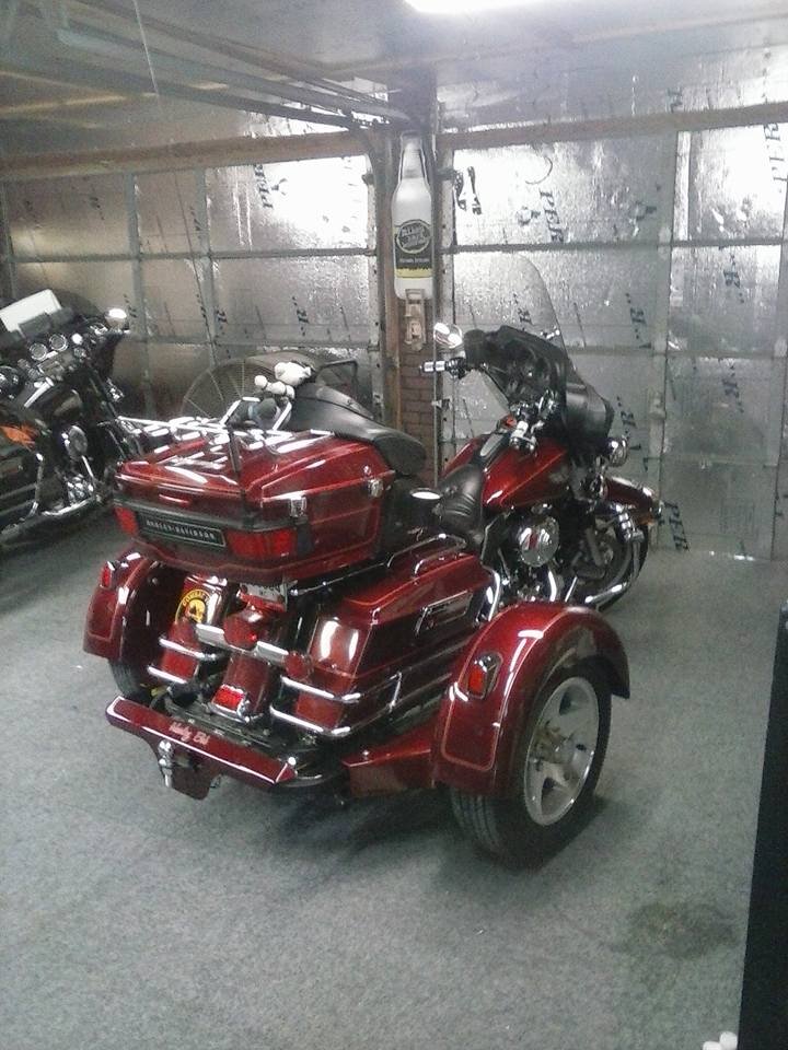

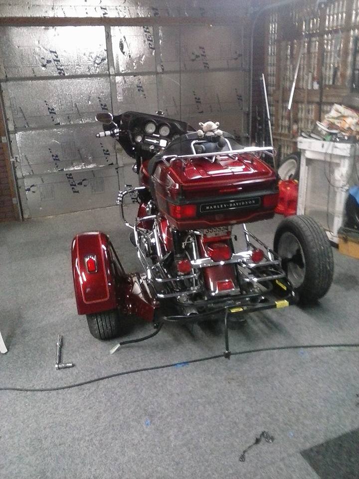

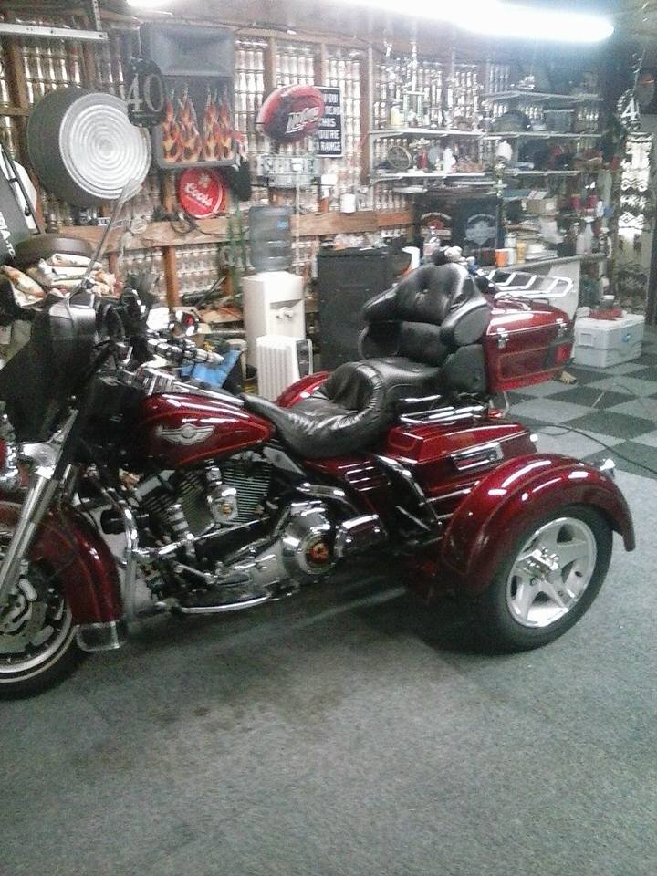

Completed! It took Three hours non stop to get it all together.
I road 10 miles in the Cold Rain to get this job finished and 10 miles back to my house. I just got a big bowl of warm Homemade soup in me and just glad it is Finished and She's home! These pictures were taken at the painter just before I left for home! It's going to turn to Ice in a day so had to get this finished today!
When the weather gets better, I'll do some test riding!

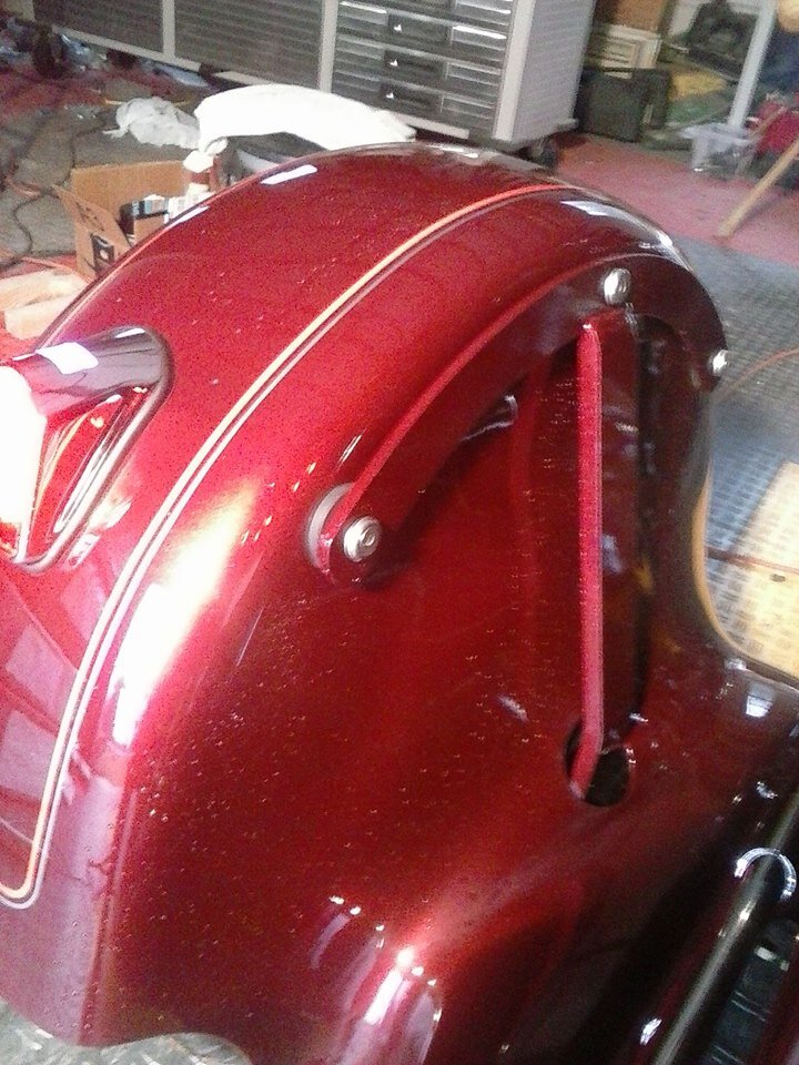

Here is a picture of the fender braces. They are 1/2" flat bar.
The finders do not budge when pushed on. Yet to give it a 75 M.P.H. test.

My Fenders do not rattle but above 70MPH they shake rather violently... So much so that I'm afraid the FG may crack so I keep the speed down below 70 when on trips... I'm going to experiment with cart tire pressure to see if that makes a difference and if it doesn't. I may make a brace that I can bolt on for Interstate Riding (although we do tend to stay off the Interstates while on the bike)...
I obtained some longer bolts from an Internet supplier (https://www.boltdepot.com/Socket_flat_head_Stainless_steel_18-8_1_4-20.aspx) that fit my fenders, so I can experiment a bit with struts and such...

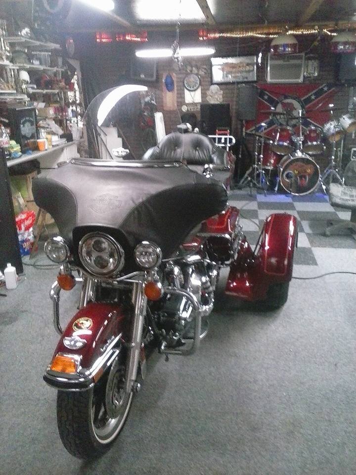

Still too cold to ride here! Well now is the time to do a Trike Build.
I did it the right time of year!

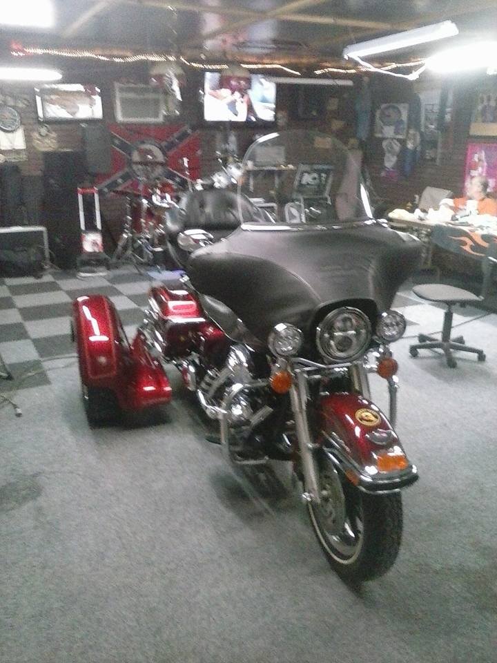

My Trike is finished and waiting for good weather!
When I did ride to the Harley shop, Hooters and around town.
Everywhere I stopped people came out to see it and complement me on the looks.
Two people asked me what would I charge to do their bike.
I told them $1000.00 but with the liability I don't think I would do that!
Nearest Tow-Pac dealer from here is 500 miles!
Now this was just my first ride in town, it's a head turner for sure!
This last picture does not show the true colors of the bike. The first two pictures do!
