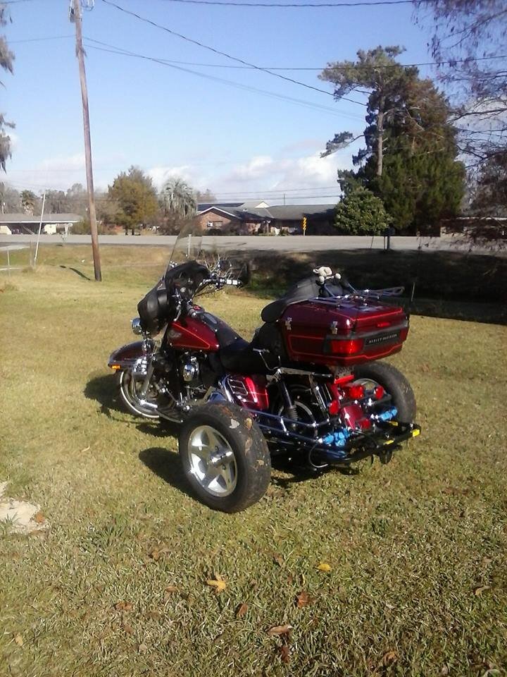

My Tow-Pac 14" InstaTrike Install on Ultra Classic Harley
Please don't judge me
Please don't judge all trike kits to these. If you are reading this and trying to choose what kit to get, be sure and check us out at Trip Trike then give me a call, I can answer all your questions. :Angel: Oh, and we have patented air ride suspension!
Actually the ride on this Tow-Pac was better than both of Harley's Trikes and a Voyager I road. I rented both Harleys for a week each their Freewheel and tri glide, so I know their ride.
The Voyager was for a friend and we could never get it right, it was held together with U bolts and had a low ground clearance I didn't care for ether!
See my ***Test Ride*** post on this kit. I'm very pleased with this kits ride. It does NOT require racking the neck or a steering damper!
Now the reverse on the Tow-Pac is garbage along with customer support! Maybe your reverse is better.
A friend of mine Merlin from Raceland, La. has one of your trikes.
I'm yet to ride it and talk to him about it, but will soon now that you brought my attention to it . He will ride mine and I his!

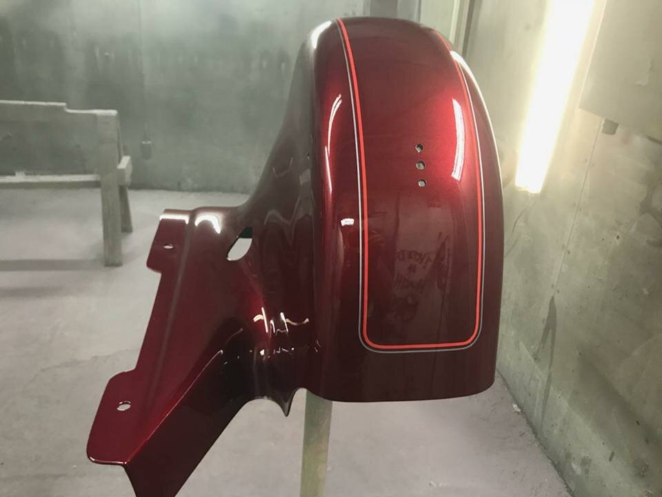

Finally we got some sun. So good day to wash and wax before instilling the trike parts on the scooter after Christmas! Today After it's dry, it's in my shop for a Good wax Job!

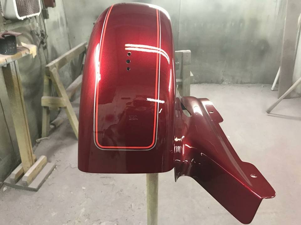

Get those fenders on Bob, I'm dying to see the finished product - a very pretty paint job on that bike of yours too!!
Les
Les
I can't wait also!

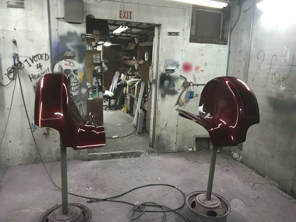

The painter is having his prostrate drilled out today but will be back to
it day after Christmas. He told me he likes to let them dry real good
before bolting on the tail lights and installing them on bike!
I've been waxing and paper toweling.
I learn that from an older detail guy.
You wax it real good then any scuffs remaining you use a paper towel
with wax on it and rub hard in a circle motion. It works awesome.
My LED spot lights should be here tomorrow. I will install them and
finish any waxing I have left and align that new axle.
Then Christmas and then we put it all together!
That's the plan.

Well said. In as much as I don't like Tow-Pac's reverse and rip off support.
This kit for me was "Plug and Play" Out the gate it road better than Harley's full
conversion. No damper or rake needed. The ground clearance is high.
Only time will tell how good it will be and last.
I've read here where people have to work hard to get their kits set up to handle
some what better.
After renting the Harley trikes I found the Freewheeler to be a chore to ride with
it's low speed wobble. You had to learn how to not try to man handle it and just
loosen your grip and let it do it's thing at speeds under 30MPH.
So I thought this is how the Tow-Pac would be if not worse.
So when I road my kit for the first time I was Amazed at how well it handled.
Smooth as silk. I would almost put it with Hannigan a $17,000.00 conversion.

They are Very Bright! I will have to get the painter to adjust them as he has the special wrench to do so.
Final wheel alignment completed.
Tires mush be in alignment with the drive Wheel.
Use straight edge not on any raised letters.
Measure front and back of wheel, both sides.
Must be within 1/16"
Then torque down to 75'lbs.
This was the axle that replaced the reverse and needed to be adjusted.
The other wheel I did when I first got the kit was still right on!
That's a hunk of junk! What kit is that? Who makes it? Please Tell us it could save someone from getting hurt or killed! U bolts will slide![/QUOTE]
Looks like a Richland Roadster.I different thought process for suspension than any other.The axle is welded solid to the frame and the brackets run across the frame are designed to flex.They used to claim you could ride with only 1 side on if you really wanted to.4e12e62452a94c92b20a10179cae7c75.JPG
