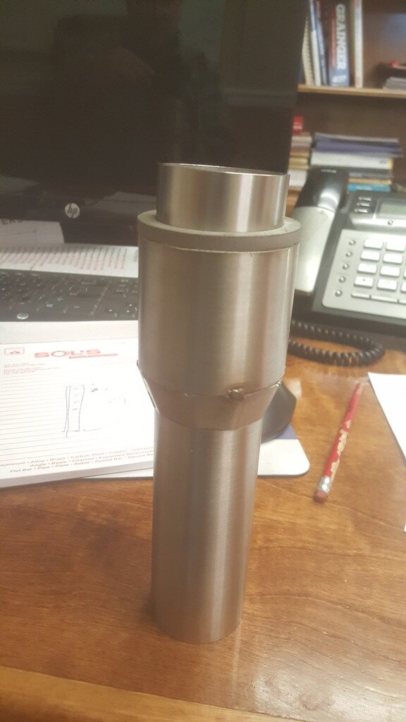

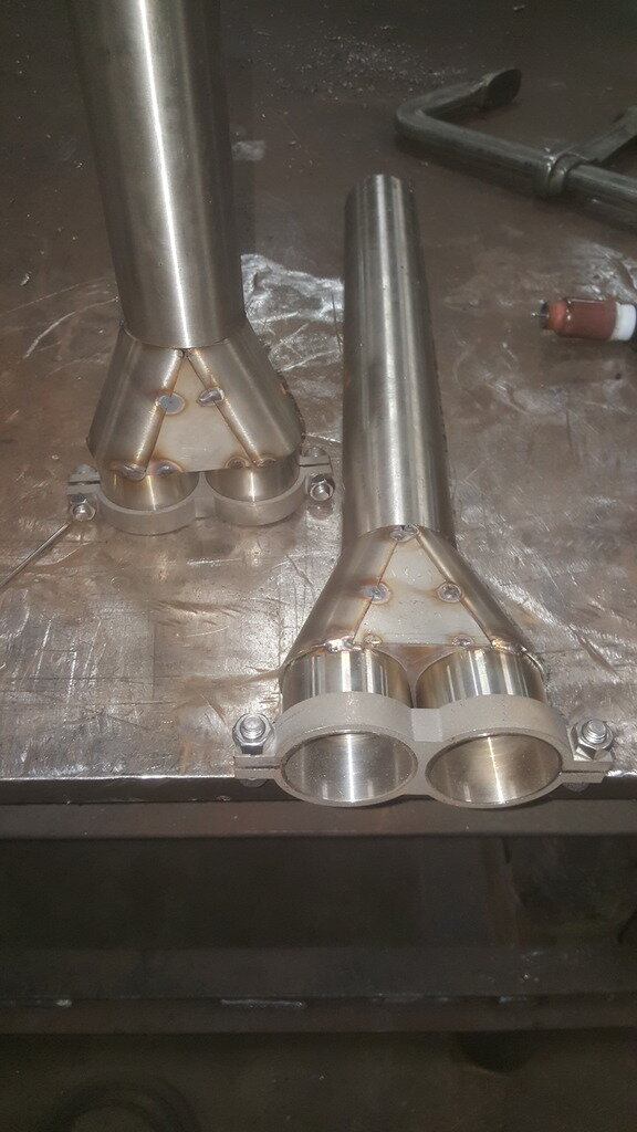

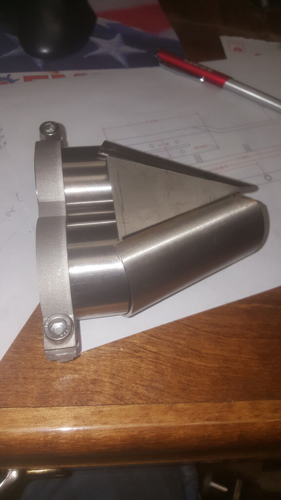

The end result is something like this.
One on each head pipe.
If the theory hold true it will not really increase maximum VE.
But
VE will be much higher at lower rpm. Torque curve should be bigger and "on" sooner.
Does this by reducing the negative side effects of large cam valve overlap.

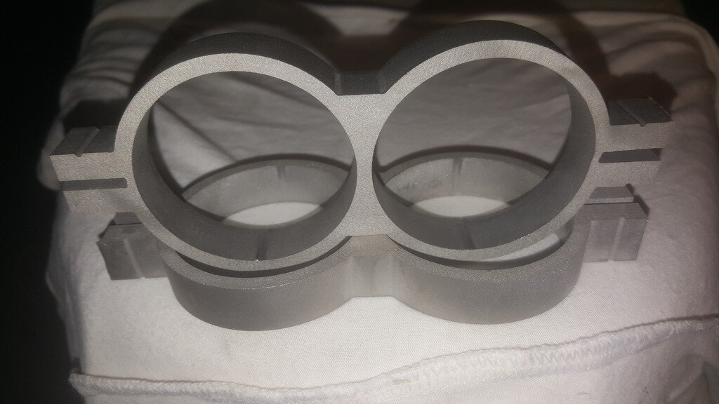

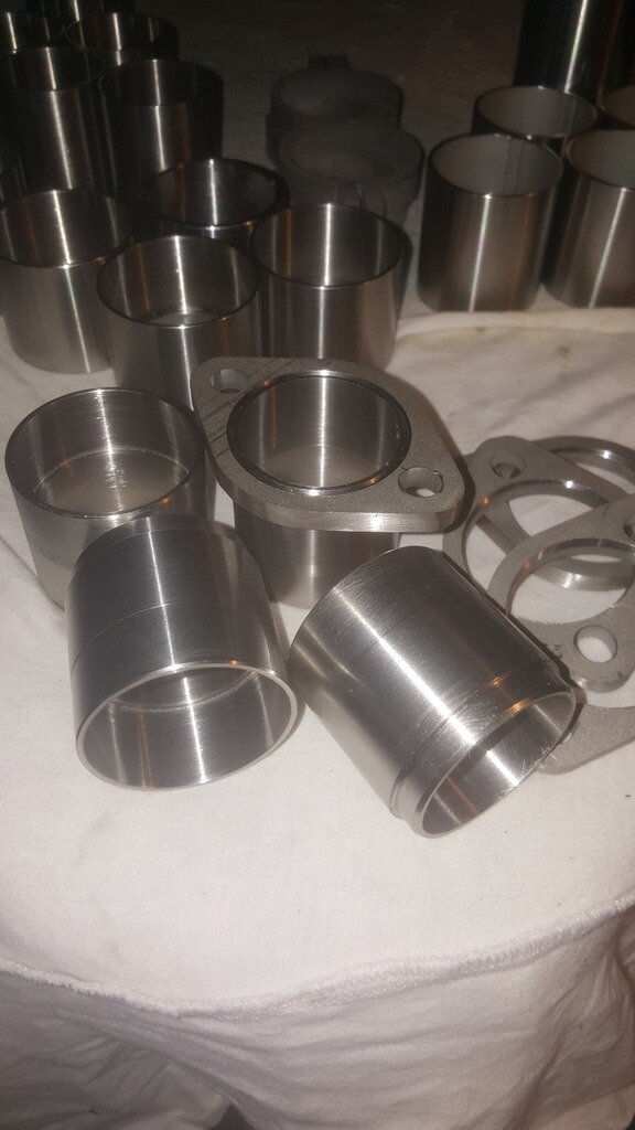

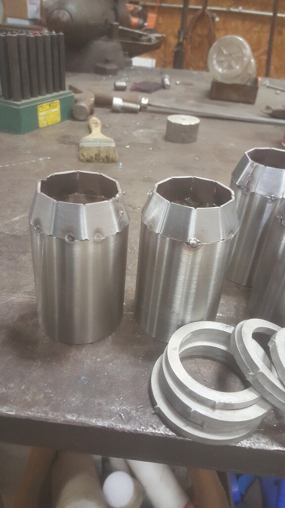

Still working on headers.
Whittling out the clamps, slip joints, collectors and thread bungs for the o2 sensors.
Lots of tedious small stuff.

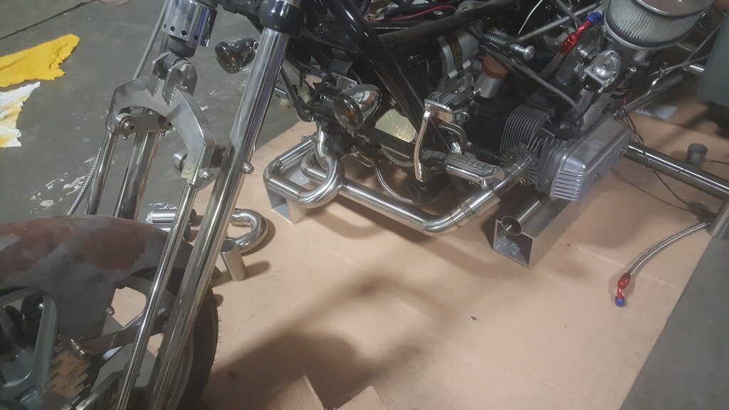

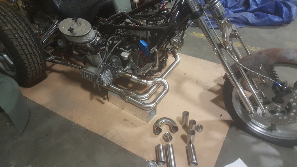

I have worked with the header parts and pieces a small amount. No pics or anything.
Getting back into things though.
It has been a couple months since I have had the time or energy to do much with the project or other things the family wants. But I am getting back to it.
I did get to work with the header pipes an hour or so this morning. Figure out where I left off and tacked up a few more pieces. Not much but something.

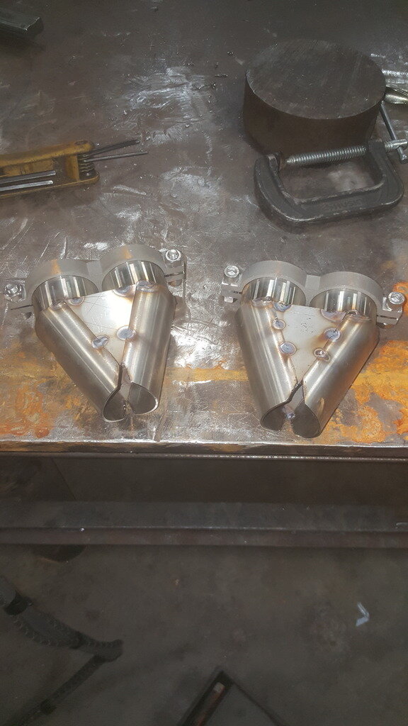

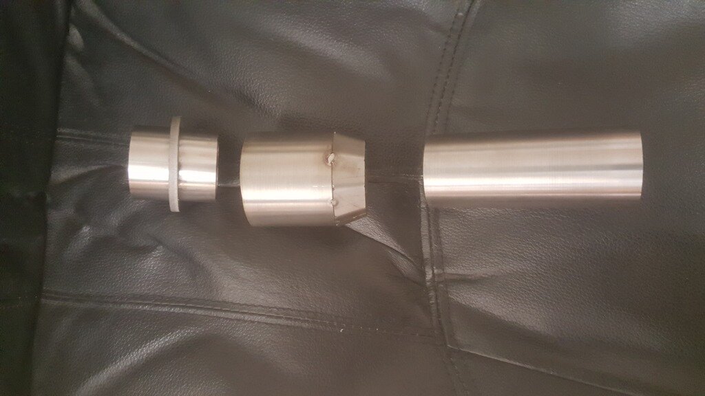

I did get a couple hours to spend on the trike yesterday. Whittled some more tubing and fittings for the headers. Nothing fantastic, just time consuming.
