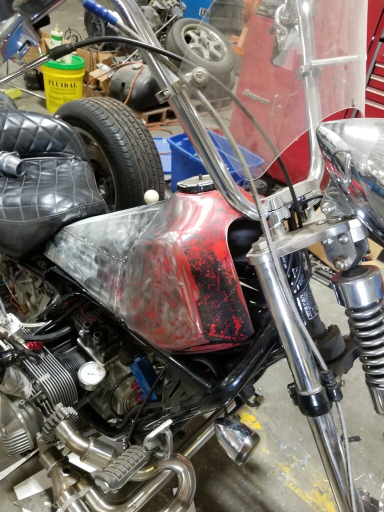

Couple of thoughts.
The rest of the lines of your trike are smooth and round. Front and rear fender lines are round, seat has rounded curves, etc. An angular tank doesn't seem to blend in to the overall design. How's your English wheel or hammer and sand bag skills?
Maybe you could add a non-functional front section to the tank (angular or rounded) ala Roth or early Stires trike to give a forward motion to the tank.
Just my $ .02.
Yeah.....I just dont have a wheel.
Was thinking flats would work this time around.
I dunno..... still figuring it out.
The old tank was a buncha smaller flats with bondo smoothing it out.
like that dirtbike tank
this last tank gots more attitude, and is leaner looking than the stealth tank......if you go with the stealth i would taper the front of the tank to blend into the neck.ie the top square would become triangular narrowing as it approached the neck... just my .02
Yeah it is still a work in progress.
Still thinking of a few more pieces.
Since this pic I have widened it so it is wider than the frame tubes.
Next might be something on the top side to blend in better.
Sorta liking the general attitude, just not there yet.

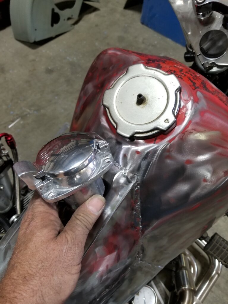

The dune/bug cap looks more "custom", but the flatter original cap isn't too bad either. Bit more work to incorporate the buggy cap body wise but you seem fully capable of getting the job done, if that's the direction you decide to go.
Since you're asking, I'd be more partial to the original. Even better if the center vent on the orig. can somehow "go away".
Does your f/i need to be a "closed" system? Not too hard to "plug" venting on either of those caps, if needed...
I am an old dirt bike guy, make me prefer the dirt gas cap style.
I need a vented cap. Might even use the hose vent.
The dune buggy cap free vents right there, might be messy. I had it for the stealth tank idea that did not work out how I hoped.

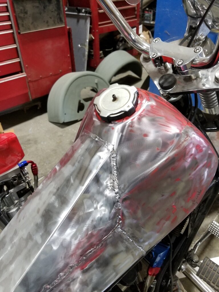

Amazingly difficult to weld 22g metal now that it is so hard to see. What a pain getting old. The combination of bifocals and cheater lenses makes for a very small sweet spot that I can see in. I suppose if I was a welder or had to weld often I could get a prescription just for the application.
tank/eyes
I like that tank....reminds me of the muscled shoulders on PBR bulls! welding with tired old eyes.... for stick...i use the lightest shade you can get...forgot the #.... the extra lite acts like stronger bifocals, at least for me. If u do a bunch of wire welding u need a dark one tho.
