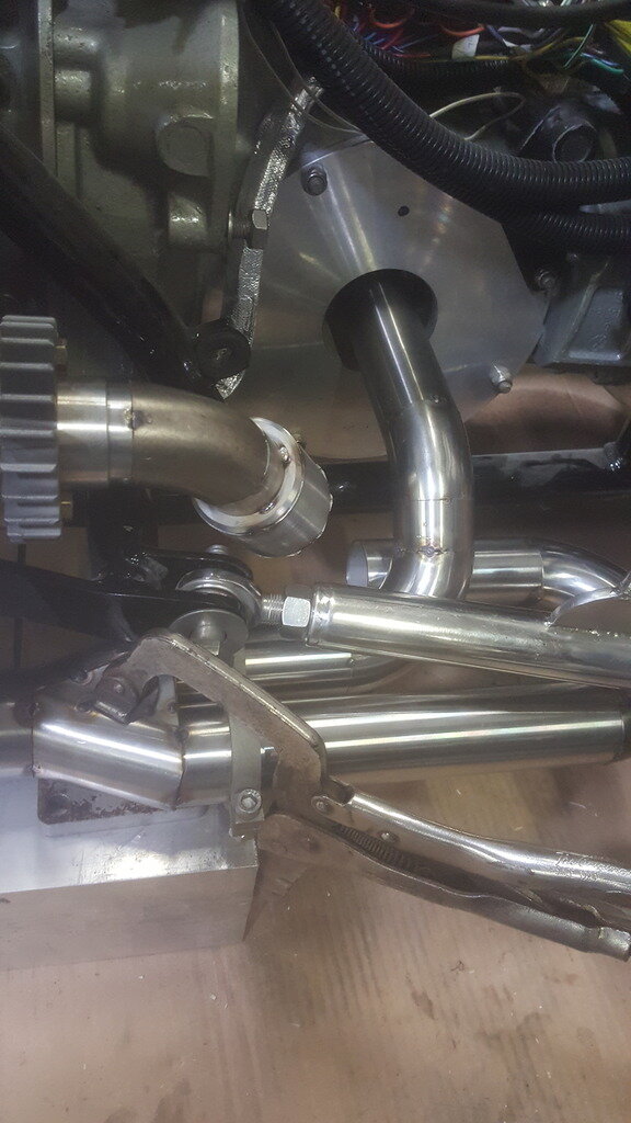

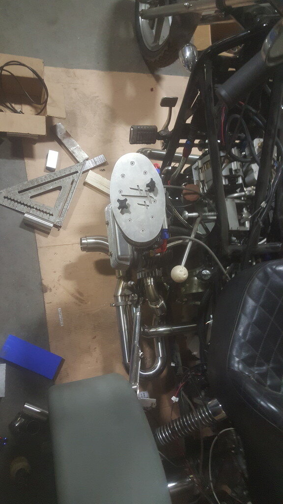

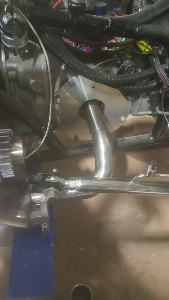

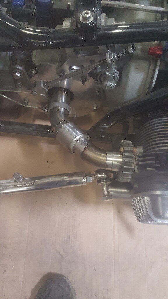

thru the blank trans case?? where will other pipe cross over?? also what are strut rods w/ heims for?? nice ss exhaust components! larry
The other one that crosses over is around the other end of engine. Back up a page and you will see it.

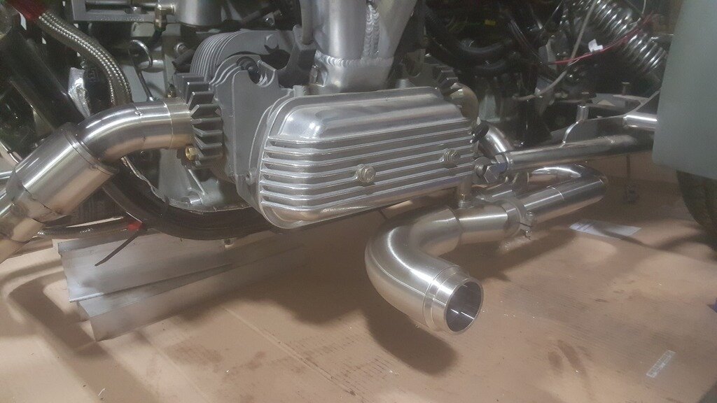

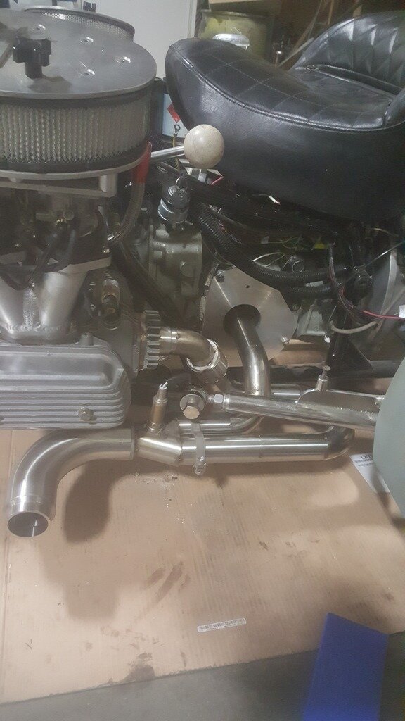

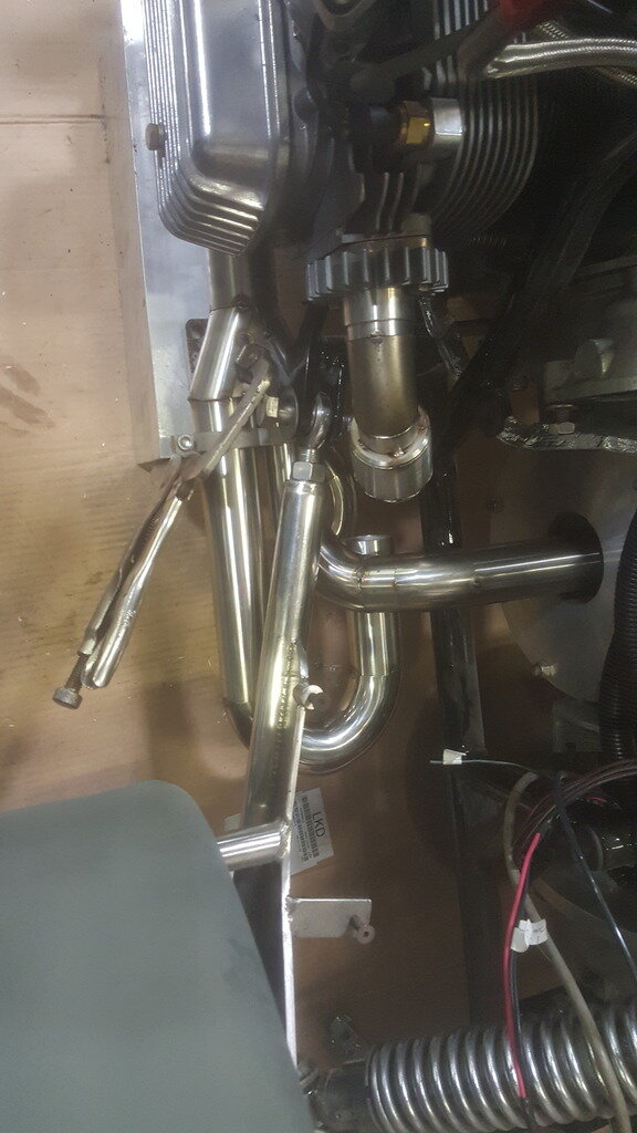

The correct pairing for a split header is
1 and 3 together
2 and 4 together
Those buggy dual cannons are not headers at all, just free flowing exhaust pipes, no scavenge or tuned header effect at all.
The best for a 4 cyl is a 4 into 1 merged. I dont have a place to pit one. So the next best is a 4 into 2 that is correct pairing.
The anti reversion chambers dont do anything for peak hp, no real change there. But make a huge cam come in harder. Helps make much more torque, especially in lower and mid rpms where a big cam would normally be boggy.

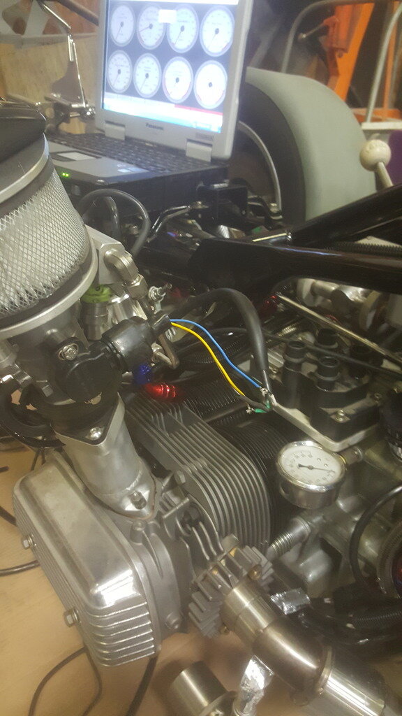

I see the ox sensor bungs in the headers. So, will this be a wideband controlled setup, or will you have to map both ign. and fuel?? I'm not real up on this stuff , but reading up, and interested. I have been working with the stock chry 2.2 turbo t1 setup,getting some problems solved. Starting to understand it somewhat. I understand the challenge you have taken on! Good luck with it.
Yes I will have to write the maps.
It is narrow band right now. It may become a wide band if I can not tune it like I want.
It will have a map for 1 and 3 and a seperate map for 3 and 4. Just like the headers are split.
And it is split like it is for this reason. It is the synchronized pairing and will tune the best.
Then there is a map for the ignition also.

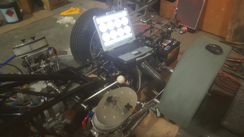

Booted the computer today.
Still sorting stuff out there.
The temperature inputs all seemed to work and calibrate fine.
The tps has a real short span and is twitchy as all get out.
Have not gotten to the O2 inputs yet.
The outputs seem ok so far, not much is plugged in on the output side right now.

Don't see any intake crossover?? Are you using separate mass air flows sensors or 2 map sensors or one common map?? Also these npn relays you speak of.... do you mean they are solid state relays npn type, or common relays using npn transistors to drive the relay coil? I have read the entire build but, maybe missed/forgot some stuff along the way. Thanks.....
I am not sure what you mean by cross overs.
But it is independent throttle bodies. Like a motorcycle. Four completly seperate throats.
I doubt I will have enough vacuum to use a mass air pressure set up. I do have a map soldered on the cpu board and I may get some useful info from it.
But I plan on being alpha n. The calculations based off the throttle position sensor.
And yes the relays are std stuff. It is the controll logic that is npn.
I hid the wiring inside the handle bars. All of it is on the negative side and small in size. If something were to short out in the bars all it would do is turn something on.
more ??? but starting to understand
... by the term crossover, i maybe should have said, balance tube? ( connecting one intake bank to the other side) however you are using throttle bodies. i had also wondered, if there was a mass airflow sensor, or a manifold pressure sensor for each side. or each throttle body....if it is a speed/density system? ie. map sensor/rpm/throttle position and engine temp inputs. If i understand you correctly, throttle position/ rpm are your inputs?then no engine load data, (map sensor data) needed?
footnote here ....just read up on alpha n fuel systems....understanding now....my setup is speed density...some are speed density at lowpower/cruise and alpha n for top end.... this alpha n should work for you! going to follow this thread closely!!
Yes I have all those inputs except for a mass air flow. I have open air filters and no ducting for an air flow meter to be.
Even though I have a MAP sensor I doubt that I have the vacuum to work it. If I did it would be the better "load sensing" input and make the best table for general purposes.
So if you are looking into setting up fuel injection, I would recommend speed density and a map sensor. As long as you are not running a huge cam and independent throttle bodies at the same time. A milder cam and vacuum hose from each throat going to a plenum can with yhe map hooked to the can would work just fine. Or a plenum intake and a single throttle body would be the easiest to set up.

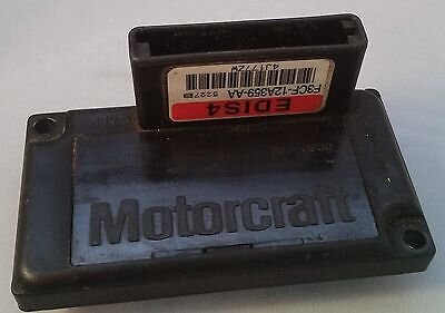

Started plugging in outputs. The injectors click like they work. The ford ignition has a problem. No time to troubleshoot, but probably a wiring error mixing these parts.

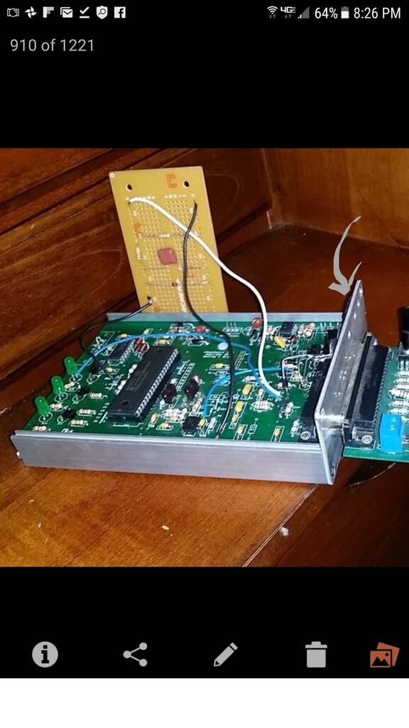

I have been back through all the wiring. Even had the computer all apart and ran it on fabricated inputs. Everything still checks out correct.
So the only thing left is the Ford module has to be bad. It did come from the junk yard and dont know it it was good/running when it went there.
Now to get a new one of those......or do something else entirely. The only big reason this type was choosen was simplicity. It is external of the original cars computer and has the coil drivers and all the dwell all built into it. I could do it a more modern way and build those parts into my computer.

Yes.
It is sort of stand alone. More modern cars have the parts that are in that seperate module built inside the engine computer.
Yes it will wire up and run with no advance without a computer.
It outputs a pip (profile ignition pulse) which is a pulse like you think of a tach.
And you input a saw (spark advance word) to tell it how much to advance.
It is an old set up from the 90's, but it is simple.
A more modern approach would be coil on plug or the ever popular chevy coil near plug.
Maybe one day I will upgrade the conroller to full sequential and coil on plug
