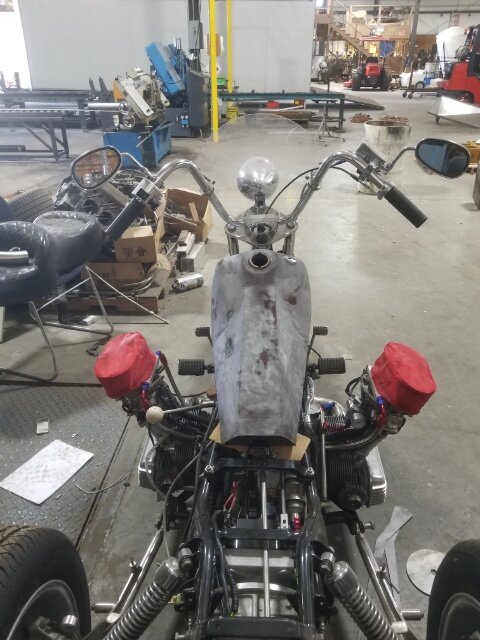

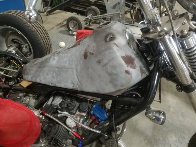

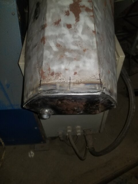

Some small amount of work done with the gas tank.
Closing the ends. One end tacked it.
Test fit tacked onto the bottom.
And how it sits on the frame.

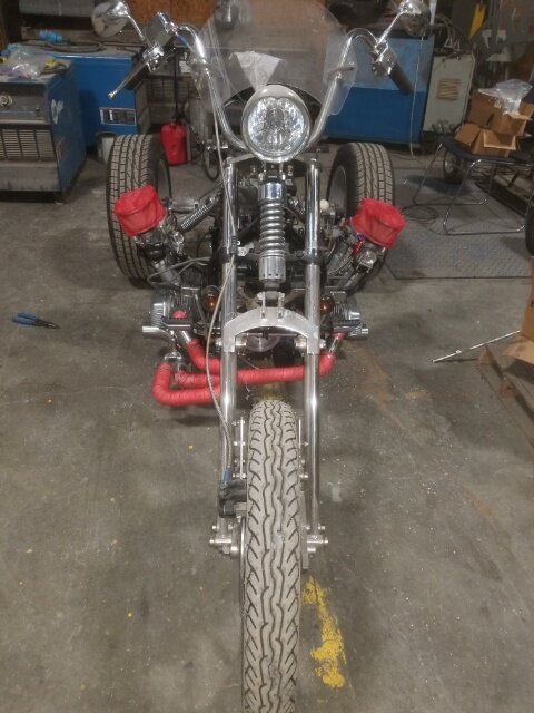

And I think it is the kinda narrow chopper look I wanted to the front.
Now to make up the rear of the tank and tack it out.
Then the shell comes back off for welding end panels in.

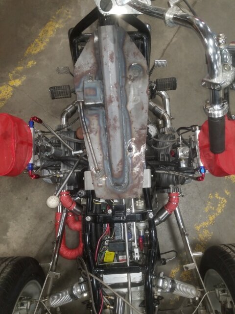

top cyl ducts?
will there be any over the cylinder ducting?.....seen you had some made for underneath. lotsa trike in a small package. looking good!
No probably not.
It has run a long time with no tins on it.
I will just have to see how this larger motor handles it.

Some more on the gas tank.

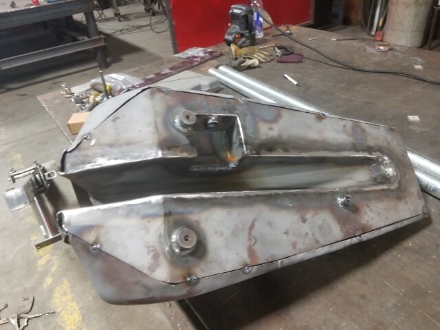

Some small amounts done.
The two halves of the tank are welded out.
The sealer is ordered. I am going to put the sealer on everything other than the last seam. Then weld the two halves together and roll put sealer in and roll that last seam.

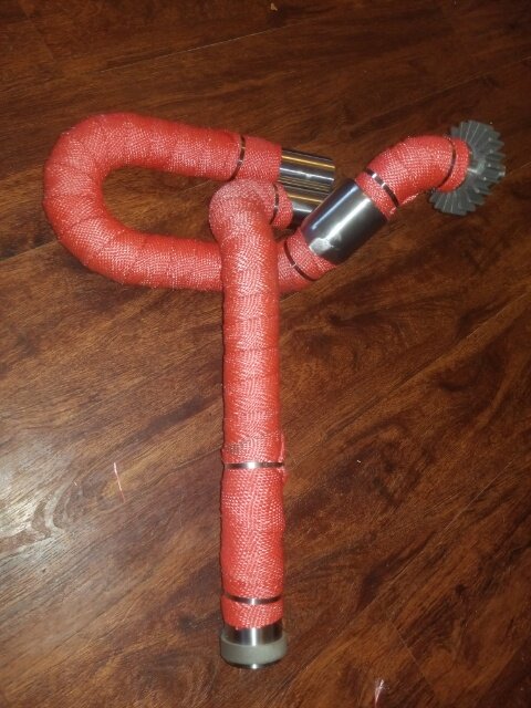

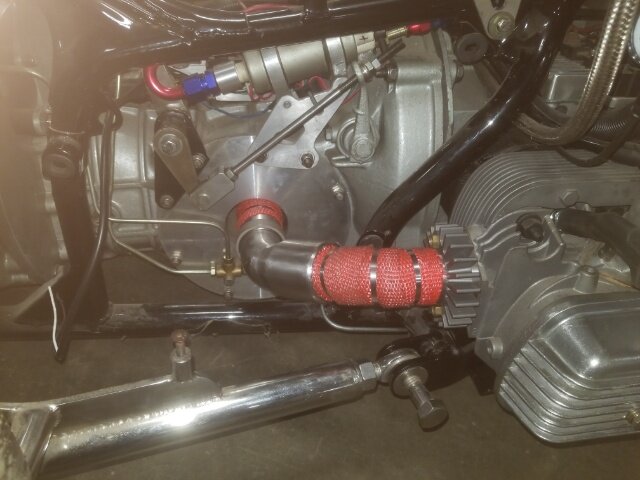

I am going to have to recruit some welding help with the headers.

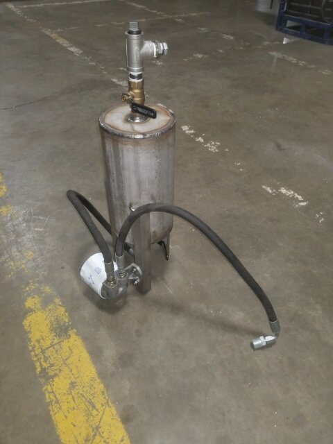

I primed up the oil system today.
It all seemed to work as it should.
I have lots of oil pressure. Probably too much.
But then I do plan on thin synthetic oil after break in.
On another note.....
That oil pressure can is hard to control.
I sprayed about a quart if oil all over the place including in my face right off the bat.
Learned real quick that a little air goes a long way and to sneak up on it.

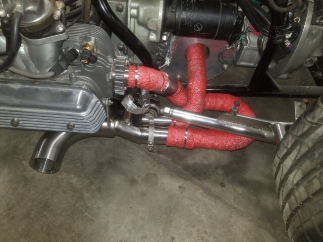

The main thing missing is welding out the headers.

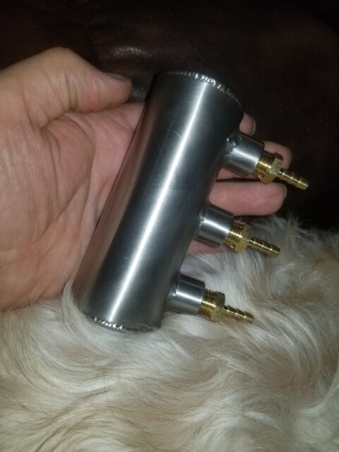

Made a vacuum accumulator can today.
I am going to hook up the map sensor and find out if I have enough vacuum and/or variance thereof to program with.

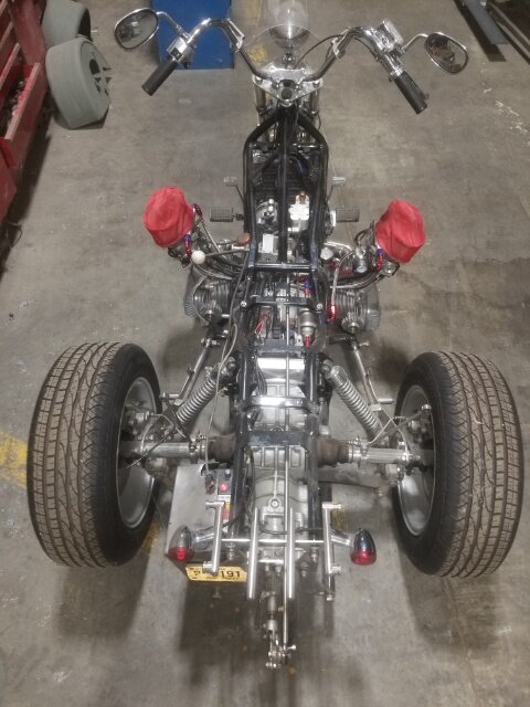

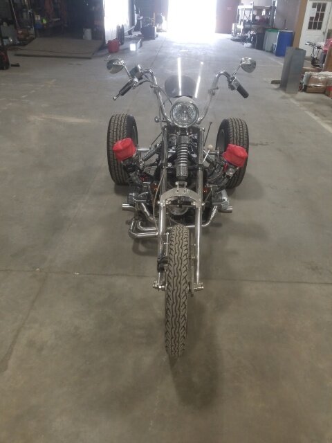

Nope.
No wheelie bars.
Sorta amazing all the mix and match parts are all working together.
Now to finish that tank.
