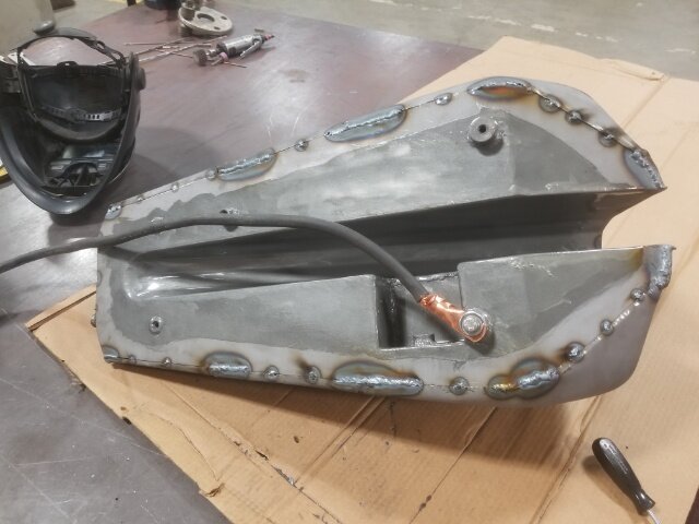

The gas tank is welded, pressure tested and touched up on the welds.
Putting the sealer coating on it now.
Next will be all the external sanding and body filler to smooth it out.
The rear fenders are complete, sand blasted and a light coat of primer. So they are ready for paint.
I had blasted and prepped the front fender but did not have the primer so it rusted again. Gotta re prep it, but raining today so sandblasting won't happen.
