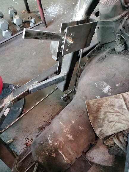

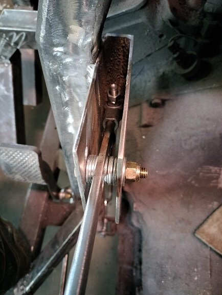

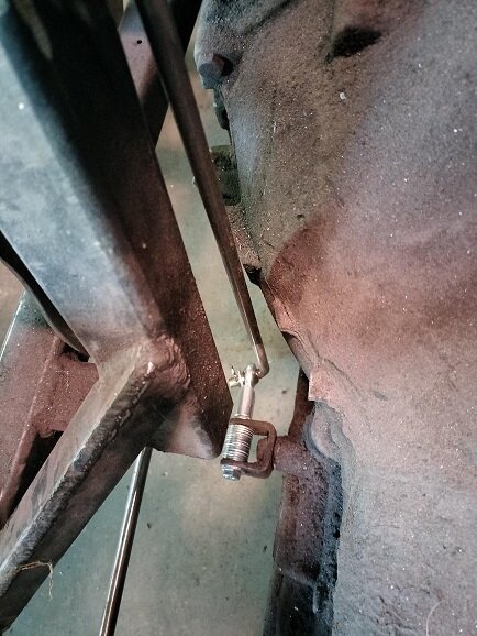

linkage at booster not depressed and depressed. I need to move the rod in the first pic to the right side of the linkage. I did not notice that until I looked at the PIC
View attachment 115772 View attachment 115773

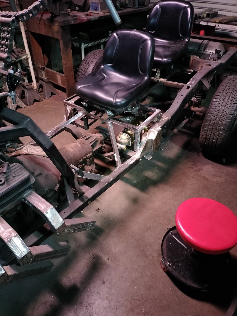

Added a support for my seat bracket. Not finished yet. I can remove the master cyl still with this brace. The problem is now I have to redo the brace on the other side sine its not at the same angle.

fixed the brake rod placement and replaced the brace on the left side.
Im going to build the frame above the master cyl and booster to look something like the left side that has the battery box

I made the box over the master cyl yesterday. Still plenty of room to remove the master cyl and booster. Although I don't have the valves and lines to deal with yet.

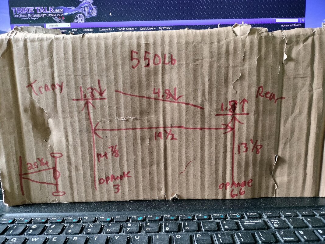

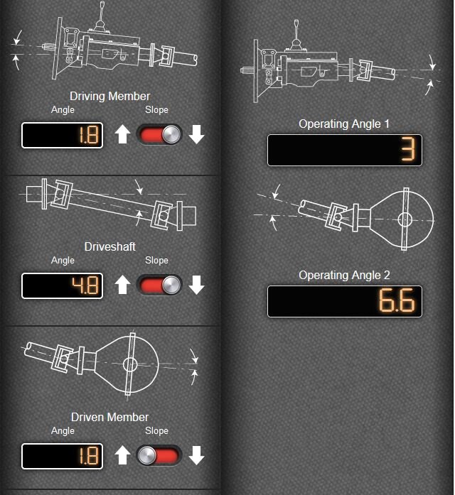

I have been adjusting my drive line angle today. I was supersized how little of a adjustment it actually took
This is what I have. From what I have read this should be good.
What do you all think
A while back I thought the Trike would be shorter and my angles would be out of range. So I thought I would have to use a double Cardan joint. Now that it is longer than I thought (10' wheel base, 19 1/2 drive shaft) I should NOT have to use a double cardan.
My understanding is I have to keep the operating angles below 10
I had to adjust my 4 link to get the angles the way they are now. I was having some issues with it binding. SO I sprayed oil under the back wheels so as I tried different adjustments the rear end would slide back and forth.
Now my link shafts measure 25 1/4"
I put some weights on the back end and had my Ol'Lady and son sit on the trike.
The weight came out to about 550lbs although I think the Ol'Lady is lying about her weight (she would not let me see it in the scale) So I think I could add 10 more pounds

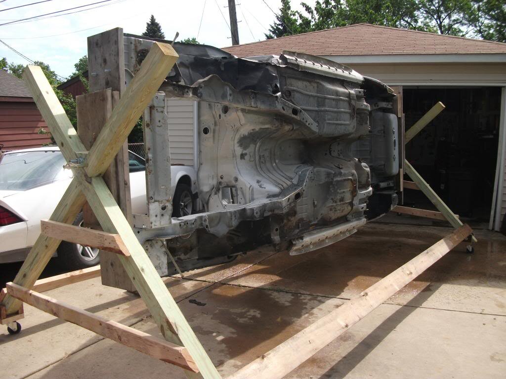

How about a disposable rotisserie? Do you have enough room in your shop to roll it on it's side? Here's some stuff from the web:
http://www.mossmotoring.com/diy-rotisserie/
Sure beats welding upside down!

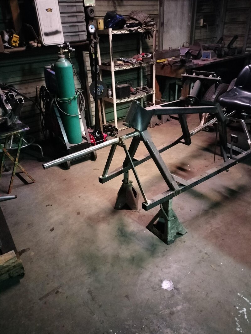

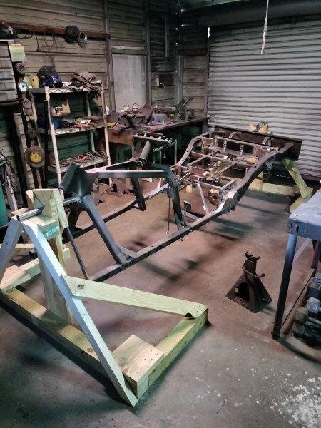

Pulled the engine and trany, added a temp bar on the front to sit on the rotisserie. When I am done with all the welding I will remove the bar
Still need to pull the rear end and add a bar to the back Then build the rotisserie
I'M back.....

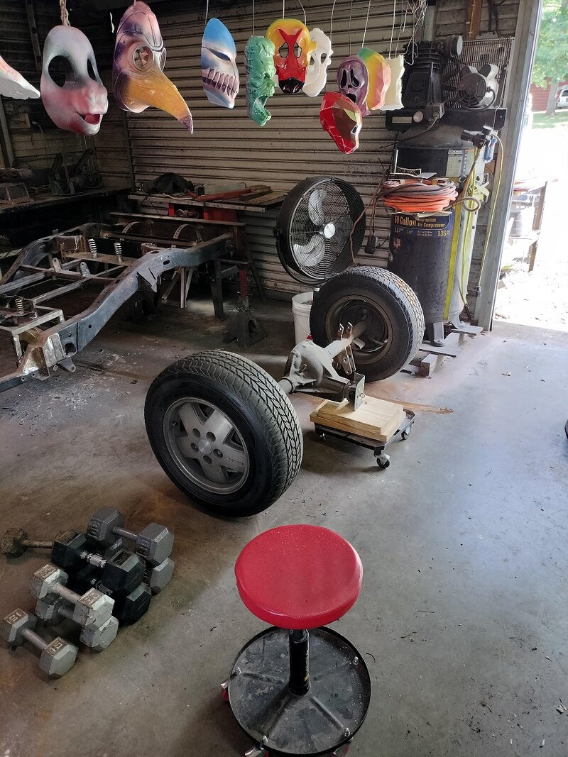

I was working on striping the frame and building a Rotisserie
I think tomorrow I will have the rear end out, I have to rearrange my garage/shop around to do this
It is good see have you back Bob. Been missing your fab posts.

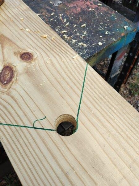

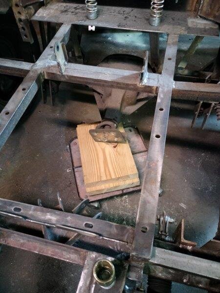

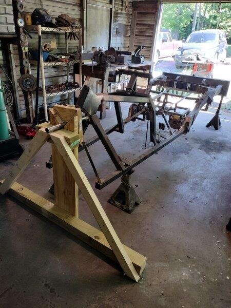

When I slid the rear end out I chopped up a old stool and used it to stop it from dragging
I had some lumber left over from another project. I did have to but a little though

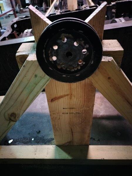

So this was my idea to lock it in position.
I figured I could just push some rebar through a hole and let it rest on the 4x4.
It had way to much slop.
If I would had measured and drilled the holes more precise I could add a hollow rod in back to slide a bolt through but I did not think about that at first.
I cant do that with with that pulley now. I have another one I will do more precise

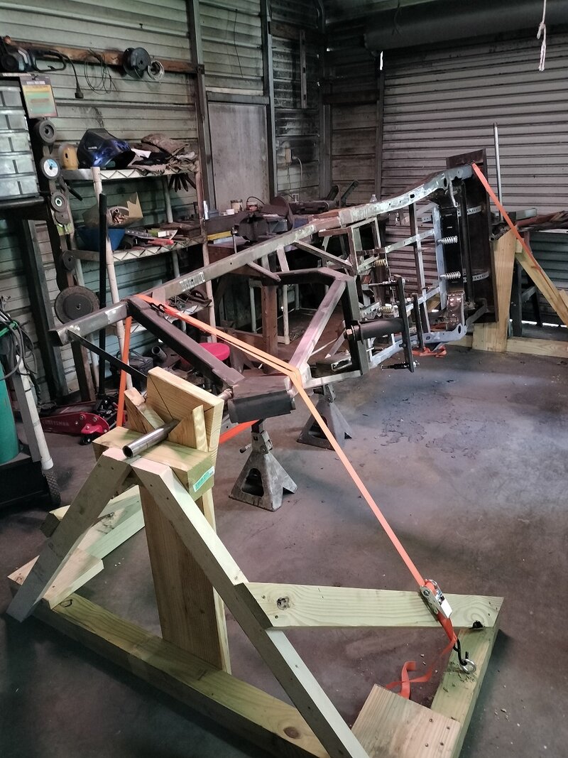

On its side on the rotisserie
4 straps and 2 jack stands holding it in place
I have already done a little of the welding. Its so much easier on its side.
I think I could flip it all the way over up side down but I don't think I will need to
More welding done today.Using a lot of wire. It is so much easier with the trike on its side.
