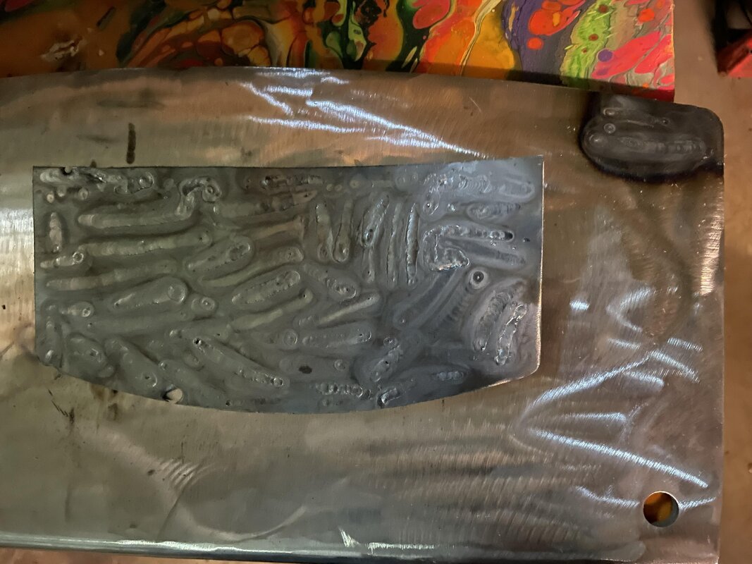

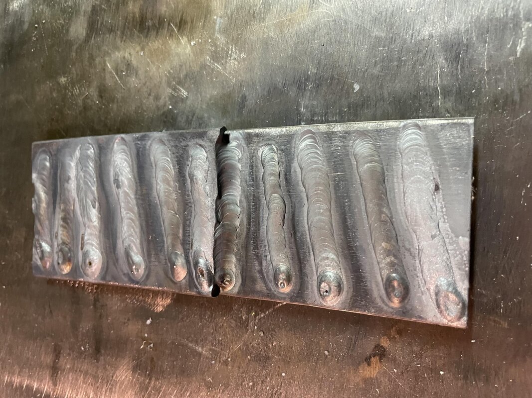

I played with the welder for a while today.
first on a 15a 120 outlet. Worked well for the thinner stuff but started to trip the breaker on thicker plates. switched to 220. worked great. I was even able to make some OK welds.
I'm not used to holding the filler wire. First when I ended a weld I put the rod against my stomach, now have a 2 inch burn, 2nd and 3rd I placed the end of the hot wire on my legs
I'm learning the hard (hot) way
The torch head is adjustable to different positions. It also came with a foot pedal (just on and off) but I have issues with my feet. It also comes with a button on the torch. I like that since the foot pedal for me is not going to work.
On 220 it welded 1/4 inch angle to1/4 plate. I did a crappy weld but the welder was able to do it and more

not good yet but better
Wont even show you how bad I did on then thinner metal.
I will get the hang of it at some point.

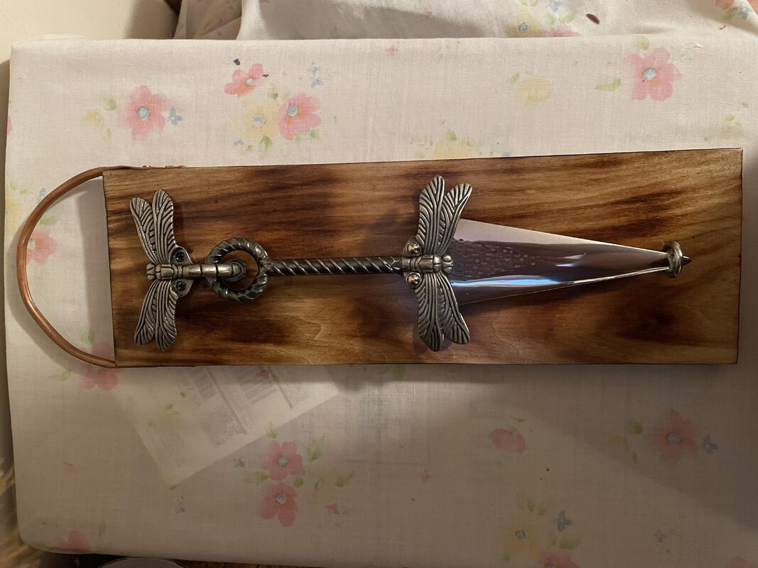

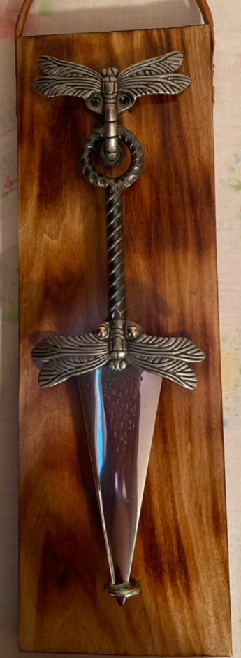

My Granddaughter wanted a Kunai knife for Christmas. She wanted a plastic fake one. I did make a few of them for her and I bought her one.
I also made her a real one. This is terribly off balance but its a wall hanger.
The blade is a small section of leaf spring I shaped and heat treated in my forge
The handle is some rebar I had around (and I tig welded it to the bladed before heat treatment)
The guards are old dragon fly coat hooks that I cut the tails (hooks) off
Sorry cant get the picture to turn the right way

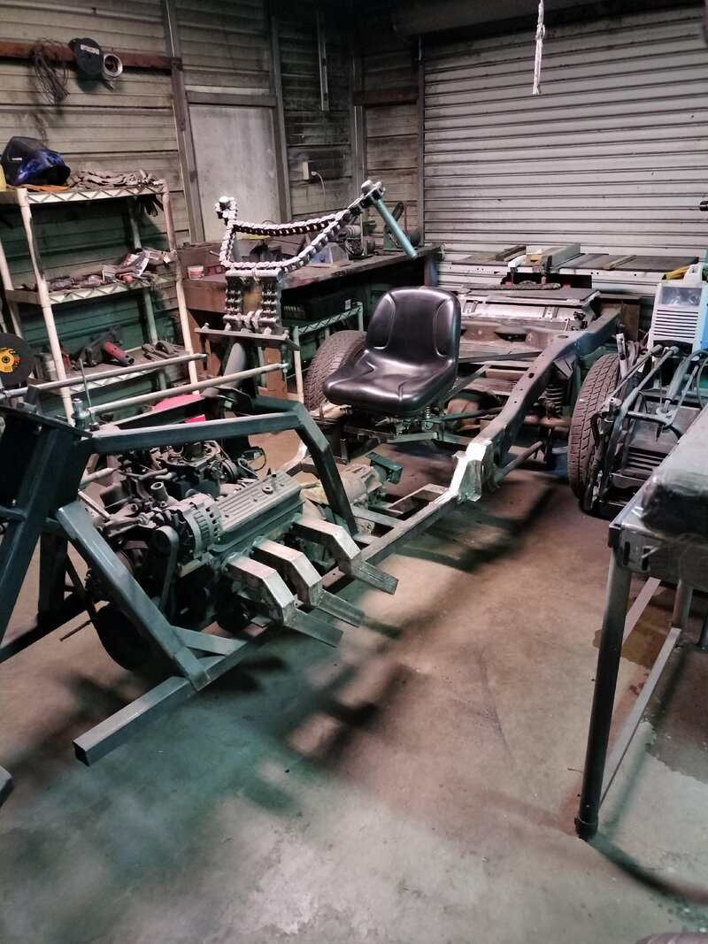

I shortened the frame some and took away the big seats. For now I have an old lawn mower seat on it
I did make my square exhaust I wanted but I still have to weld up the seams, its just tack welded for now. I need to use my TIG welder to do it but I stopped learning on that also while I was dealing with things.

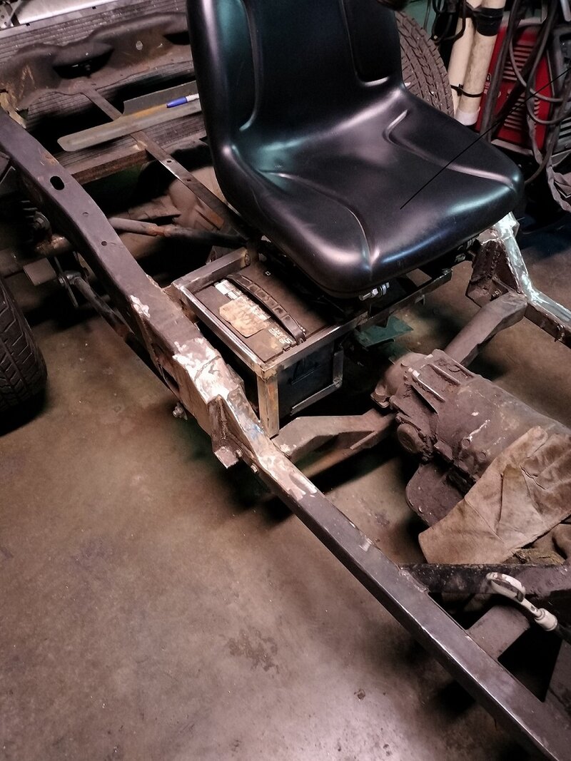

Welcome back Bob, I too have been down with medical issues. (broken left hip) so between the Trikes build and the partial enclosing of my 56 x 12 ft carport, almost ready to be walking with a cane.:gah:

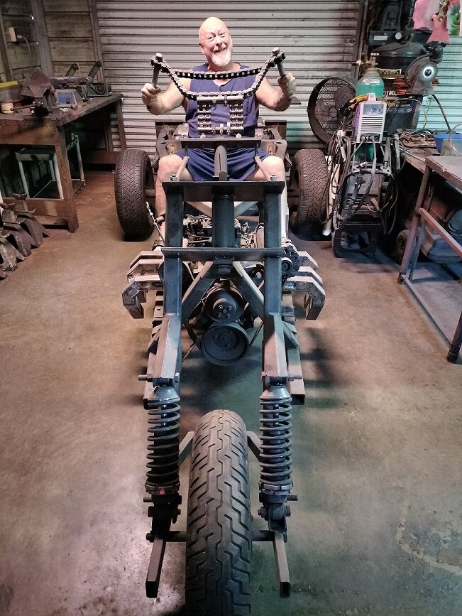

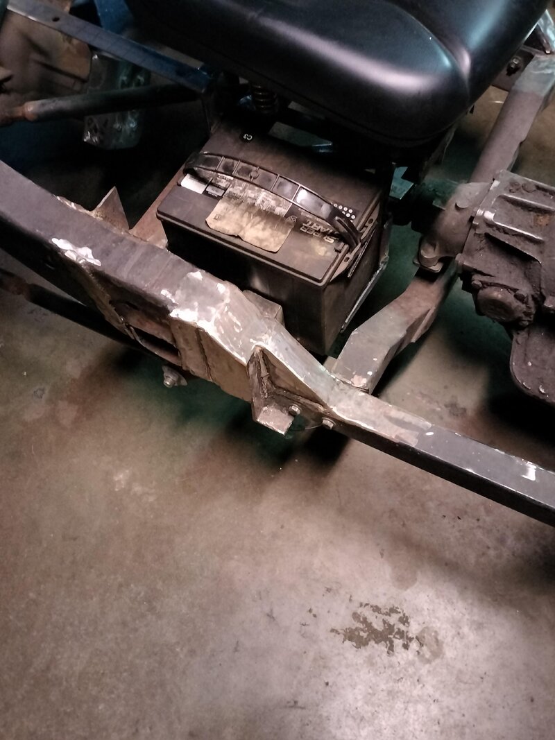

Here are some pics of the Trikes
The square exhaust and seat.
Everything is tack welded for now
The battery box and where I am welding the 2 half's of the frame back together

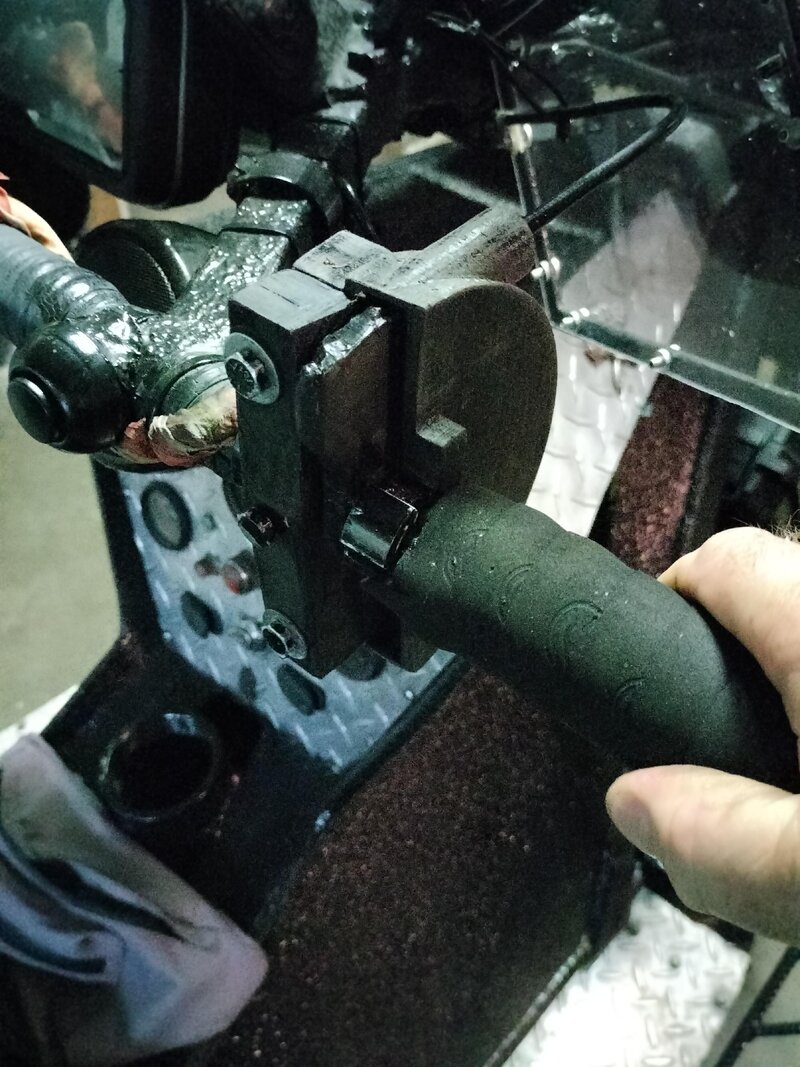

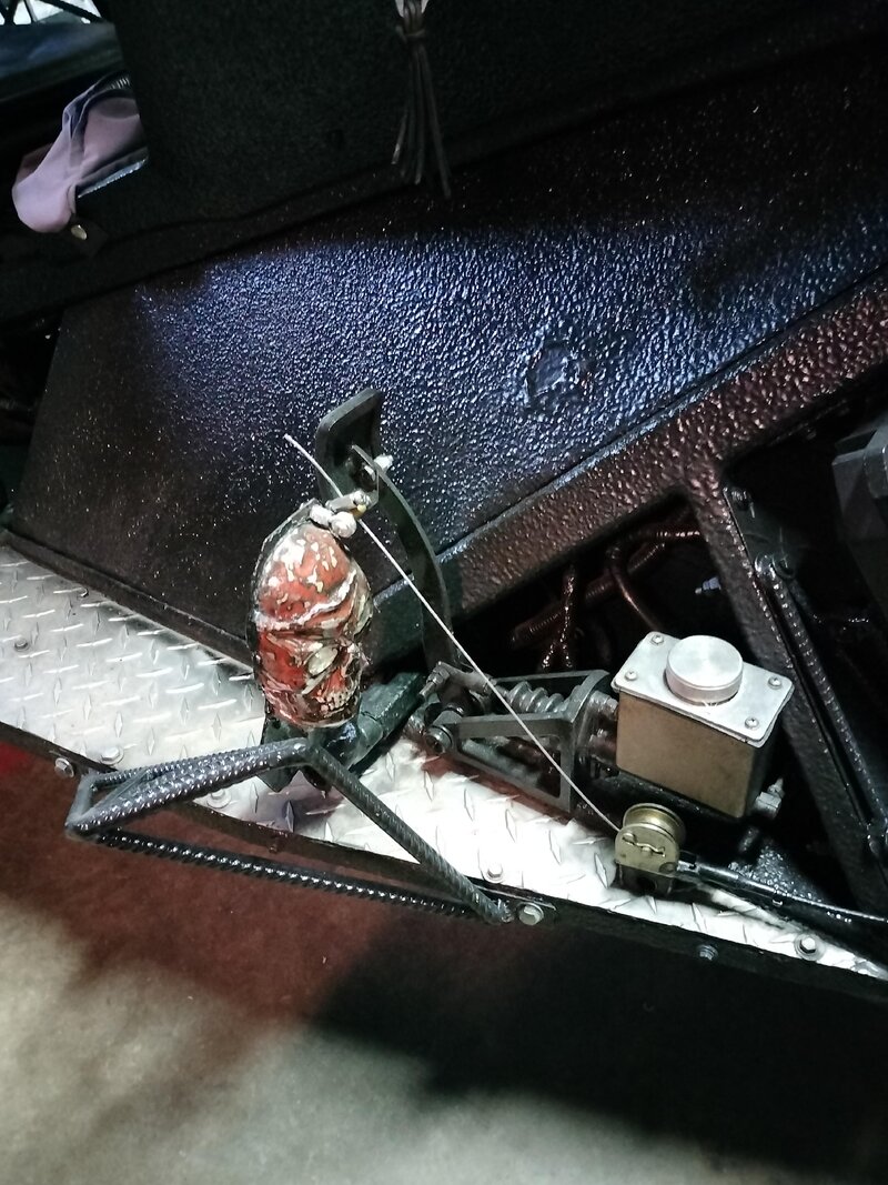

With my braces on I have a hard time pushing the gas pedal. So on my VW Trike I 3D printed a hand throttle. I am on design version 10 now.

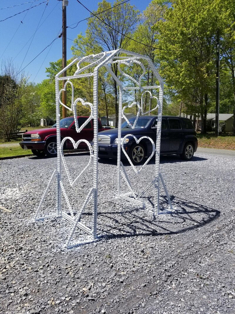

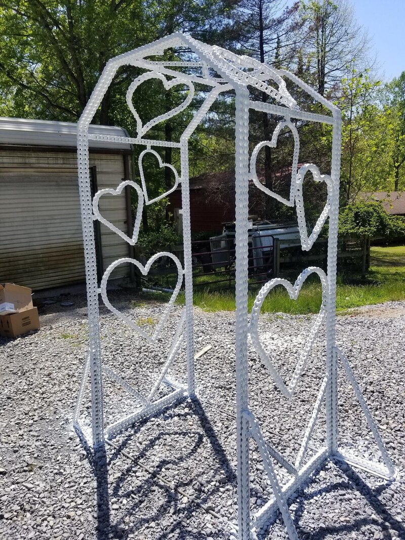

My daughter got married in the woods of our property.
She had asked me to build her an arch and put it on a trail
I ended up in the hospital and got a later start on it.
I built this while having braces on my feet/legs and a neck brace (and on some good pain meds)
I built it for it can be disassembled and moved around
Cant find a pic of it setup in the woods on the trail
