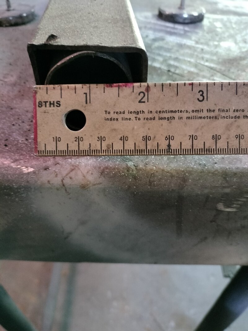

From the exhaust flange I have about 4 inches of 1 1/2 inch round, Over the round I have welded 2" square and from there forward it is the 2" square.
I have not connected the individual exhaust to a main pipe yet.
I am trying to figure out if I can carry on with the 2" square all the way back or if I need a larger pipe
Looking online it seems people are using anything for 2" to 2.5" but most 2.5.
Would a 3" collector and exhaust be or is that to big. What about back pressure or have I already screwed that up with my 2 inch square header?

Keep your headers equal lengths, smooth radius, forget back pressure, think about exhaust reversion
That is what will slow down your exhaust and also cause exhaust to still be in the combustion chamber fighting the incoming charge
I know the square exhaust is not the best design but it looks cool.
A while back I found some old post on a different forum from the guy I am copying this idea from.
He had a 350 with square exhaust
He said the power loss was not noticeable.
If I remember correctly he had 2" down pipes. I know he had a bigger collector but I don't know the size. I cant seem to find that info anymore.(don't remember where I seen it)
There was a guy on you tube a few years back. He took a new set of headers and beat the tubes flat more and more until he really saw performance on the Dyno drop off. Let me tell you he beat them up. Anyway he did it because every body is an expert and they all said even a little dent would kill power. But it didn't.Yours can't be any worse than some of the old exhaust manifolds they had on cars.
I think I will go with 2 1/2" for the exhaust collector and back.

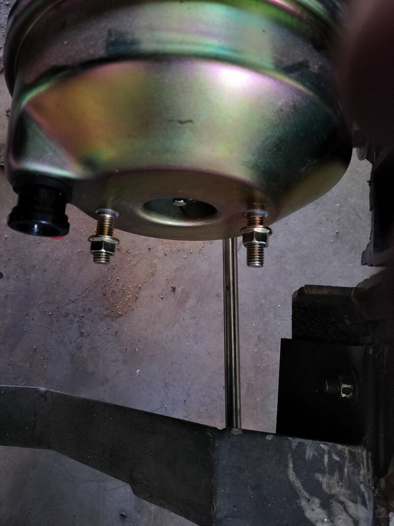

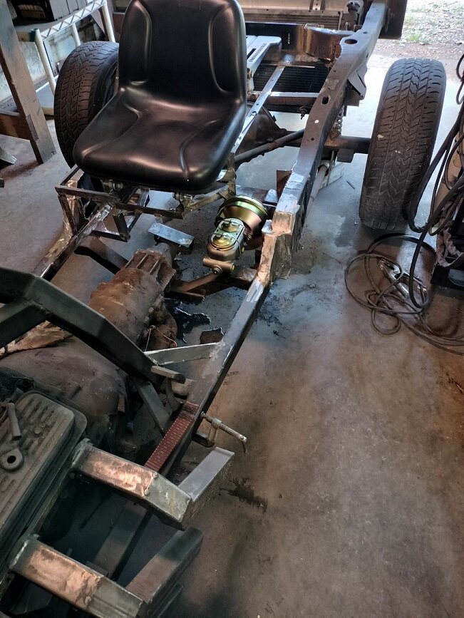

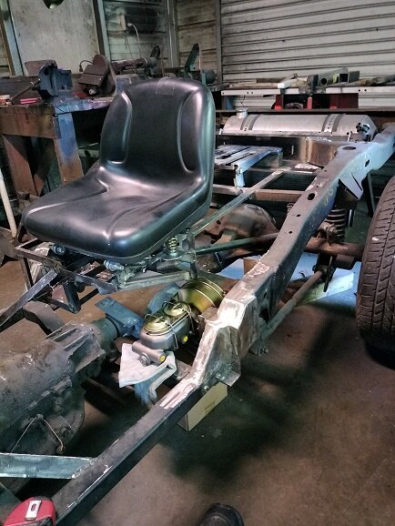

Here is a pic of where I am mounting the brake system. Its not exactly in place right now its sitting on a box and some welding gloves.
It is above the wheel cylinders but the brake line will run above the master cyl
I am still figuring out the mounting of it.

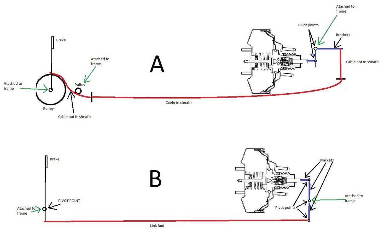

I have been thinking about brake linkage
Sorry for the crude drawings. I used to do these in Visio years ago but I don't have that app anymore
With Idea A I don't know how big to make the pulley. I have a few different pulleys I can try
With Idea B I don't think I can get a straight run on the long brake rod and the rod will be under the frame open to get hit by road debris
I like A best, but would just extend the lever hanging down from pivot point and attach the cable end there, thus eliminating the linkages to the right and down of the pivot point
Regarding the pulleys ..look up the minimum radius permitted for the cable dia. your'e using.
plan B would need to have a tubing type push rod so as not to buckle, both A and B may need to be protected from snagging on what gets ran over! Just my .02
Hi Bob and Larry
If you want to go the cable route, try some reading in "Control Cables (Inc) .com" They will make the strength and length of cable for what you want. I would think "Parking Brake cable" strength. I like your build and I hope you're having fun with it...:clapping:
After looking at it more I believe plan B will be best and as suggested I will need to make some type of guard for the rod and linkage.
I took a piece of ready rod and found I can make a straight rod work.
I wont use the ready rod for the actual rod though. Larry you suggested a tube. I assume a tube would be stronger than a solid rod. Right?
I will start looking for the rod and Heim joints I will use

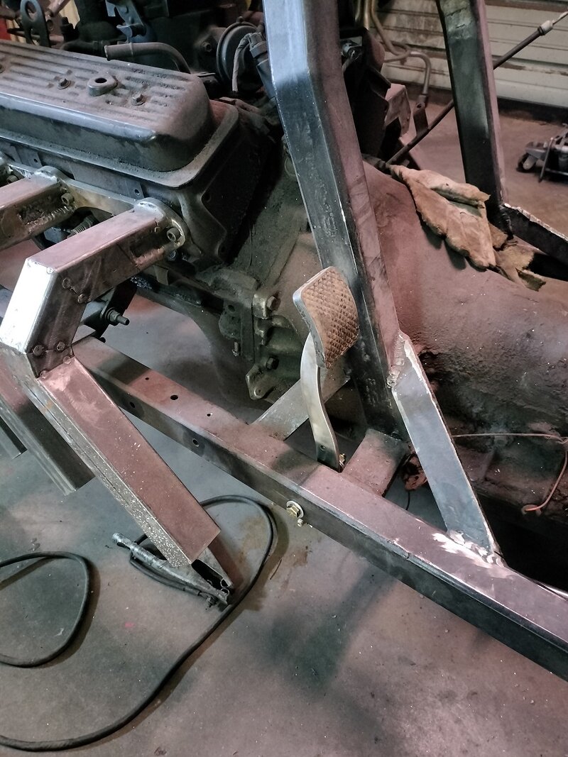

I started fabricating the brake linkage but I ran into a snag.
I need to know how far the brake booster rod will need to depress

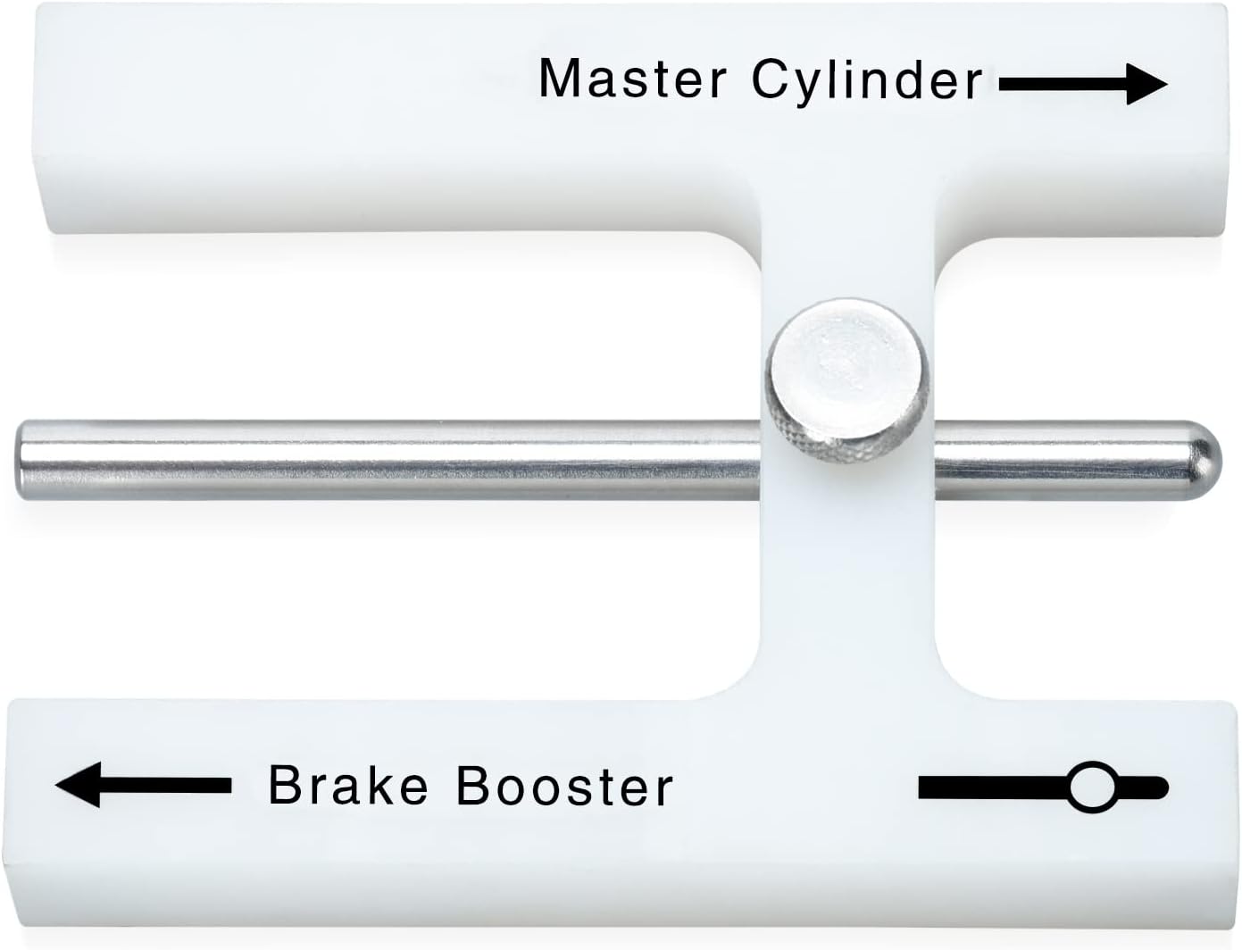

Question..... if I depress the booster by hand to measure it, will that be an accurate measurement?
Too long of an adjustment could cause the brakes to lock, there are gauges available to set the length of the booster rod
I just watched a video on how to use the tool. I did not now that end needed adjustment. Know I do. Will order the tool soon.
What about the other side of the booster. How far does it depress?
I ordered the tool you suggested.

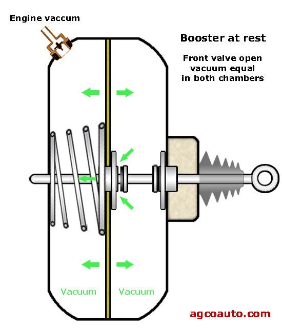

booster
The only consideration I can think of, is to make your pedal linkage travel somewhat longer than m/c travel so as to accommodate the longer travel of the booster. You can feel the lost motion that is used to contact the floating valve in the booster.

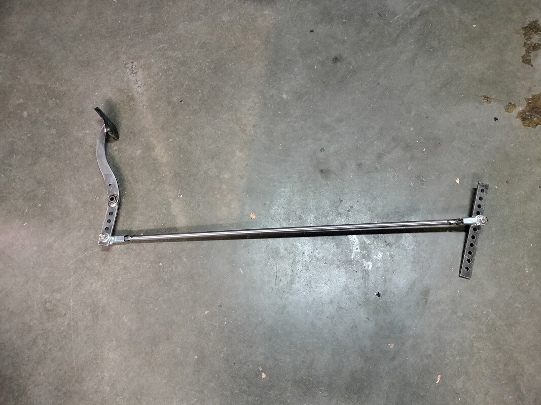

I have most of the linkage fabricated now. I just need to figure out the rod length and pivot point.
I will take some pic soon and post them.

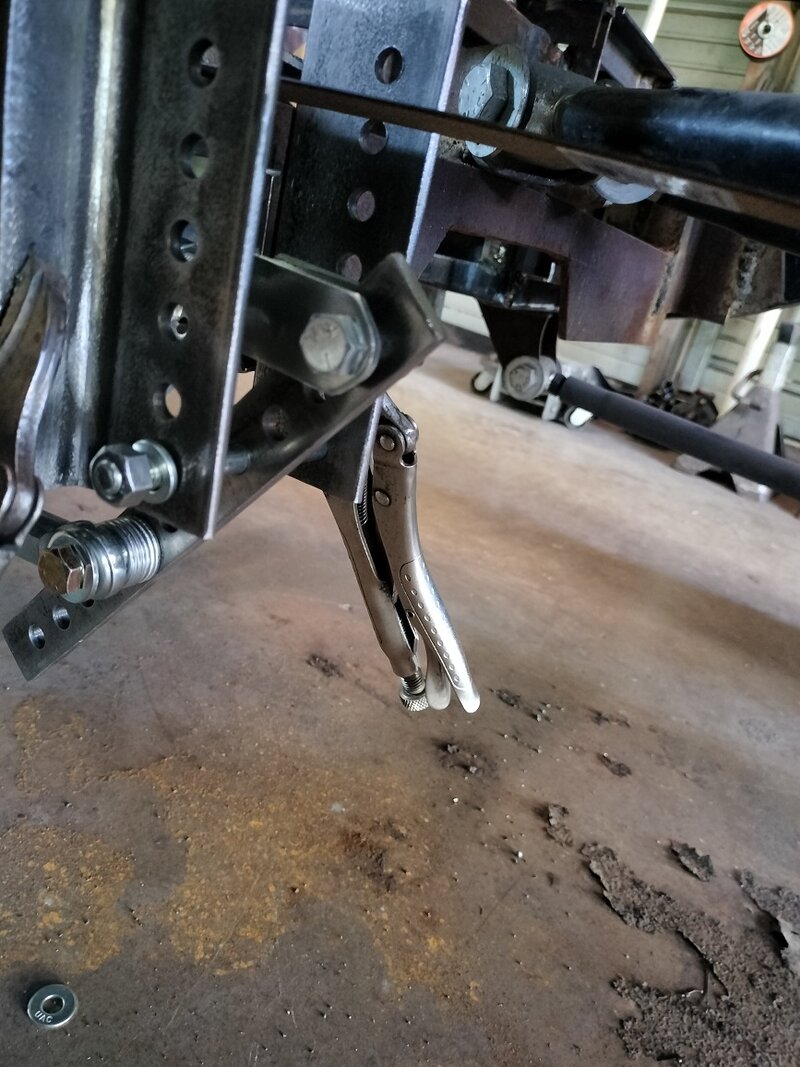

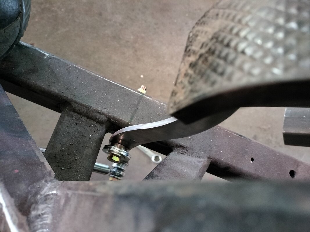

I think I have it now. Its just held together with vice-grips and I don't have the spacers or all the grade 8 bolts yet
I will tack weld it and see before I weld fully

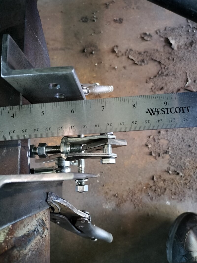

I get about 1 1/2" depression on the booster
I took the MC off and it depresses about 1 1/2"

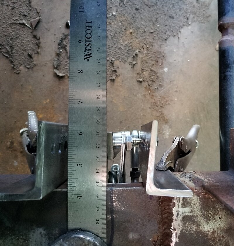

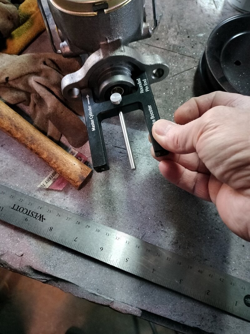

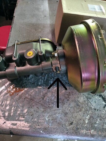

I pulled the MC off the booster and took the measurement. with the new tool.
The 2 rods were touching. I screwed the booster rod in some. I have a gap but I don't have a way to measure it. I don't have anything that is .02
I tried adding some feeler gauges together to get the right thickness but them I cant get t in past the tool to measure it
I had to bend a wrench in order to get to the lock nut
At this point I have eyeballed it.

I get a good pedal movement and the booster rod comes out plenty far enough.
I made the linkage adjustable in a number of ways just in case

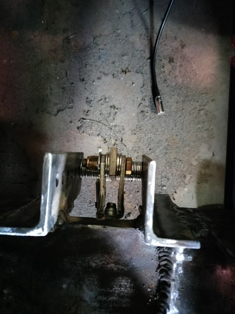

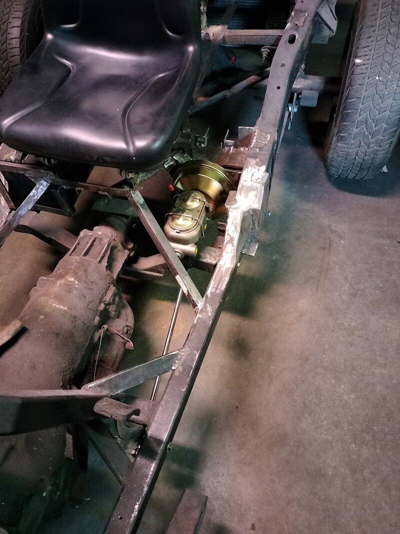

linkage at booster not depressed and depressed. I need to move the rod in the first pic to the right side of the linkage. I did not notice that until I looked at the PIC

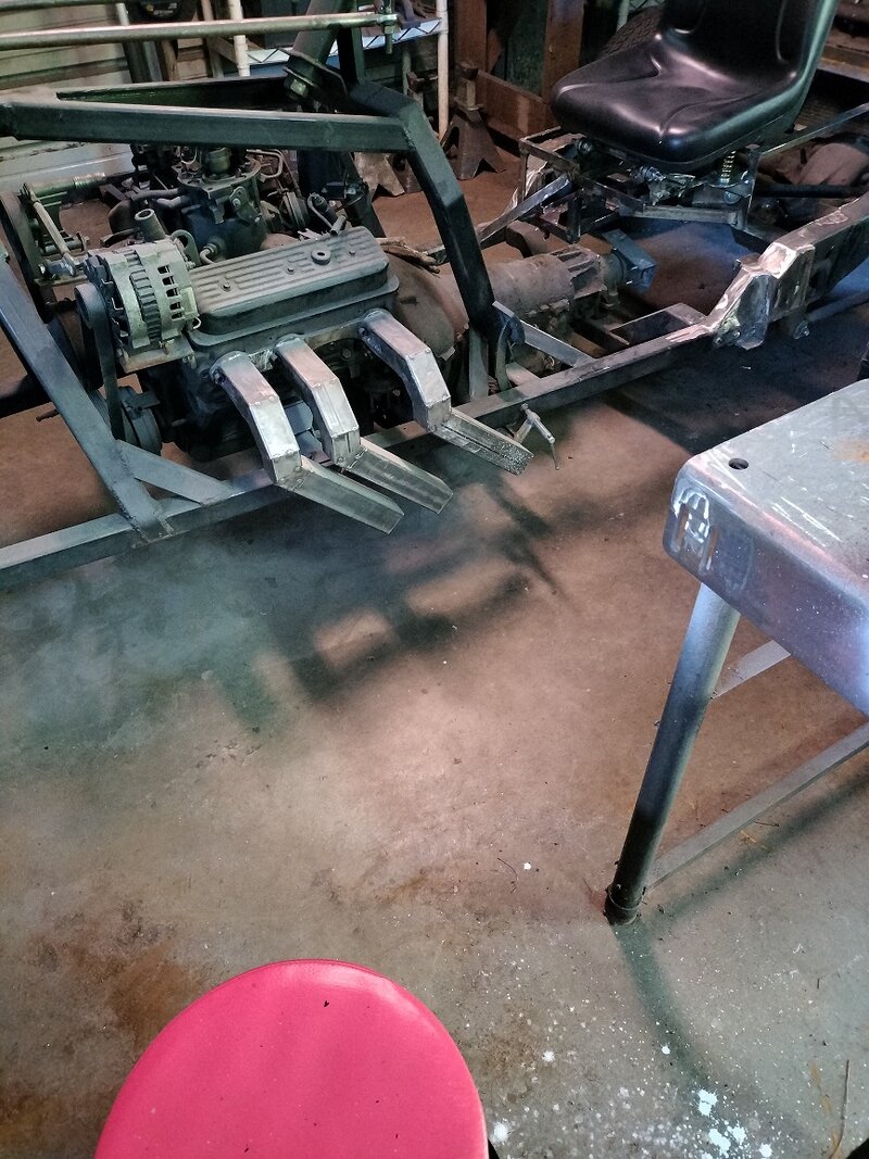

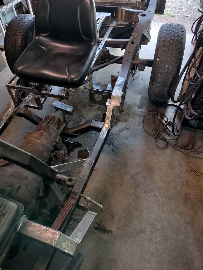

Added a support for my seat bracket. Not finished yet. I can remove the master cyl still with this brace. The problem is now I have to redo the brace on the other side sine its not at the same angle.
