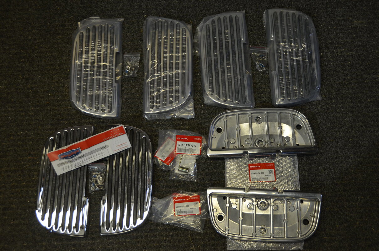

Got good news on the footboards. I LOVE the ones on there, and they are in pretty good shape. BUT... evidently no longer made. Thanks to Ebay, I found some. In Sweden. They are on their way. He has 7 more sets, $50 plus $50 handling for 1 pair, $10 more in handling for any more. All 3 sets were $220 total.
I need 3 more covers for my project, so I got 3 more sets. 1 set for the passenger, 1 set for the single I need for the assist step, and one set to replace the ones I have on there. They look good now, but I know next to new ones they will show age. So everybody gets new! :clapping:( I feel like Oprah!! ) and one spare I will hide away with the two used ones in the 'trike stash'.
In case anyone else has these floorboard covers:
(7021 - Küryakyn Floorboard Covers For Honda VTX 1300 & 1800 '03-07)
There are 7 pair left. https://www.ebay.com/itm/293278533912 Guy is a great communicator, and ships quick. Expected here next monday! FROM SWEDEN!! :xzqxz:
(other 2 listings were $140 for 2, and $150 + shipping for 2... I got a helluva deal at $220 for 6 IMO!)
The bases are still available from Honda, got 2 left and one right coming with the pins and springs. I will have to make the mounts, no biggie. Gonna look great! About $300 for the 3 bases, pins and springs. So ~$525 total for all. Little more in total than if I went and got 3 sets of aftermarket matching floorboard kits, but not much more! Plus, I really like the ones on there.

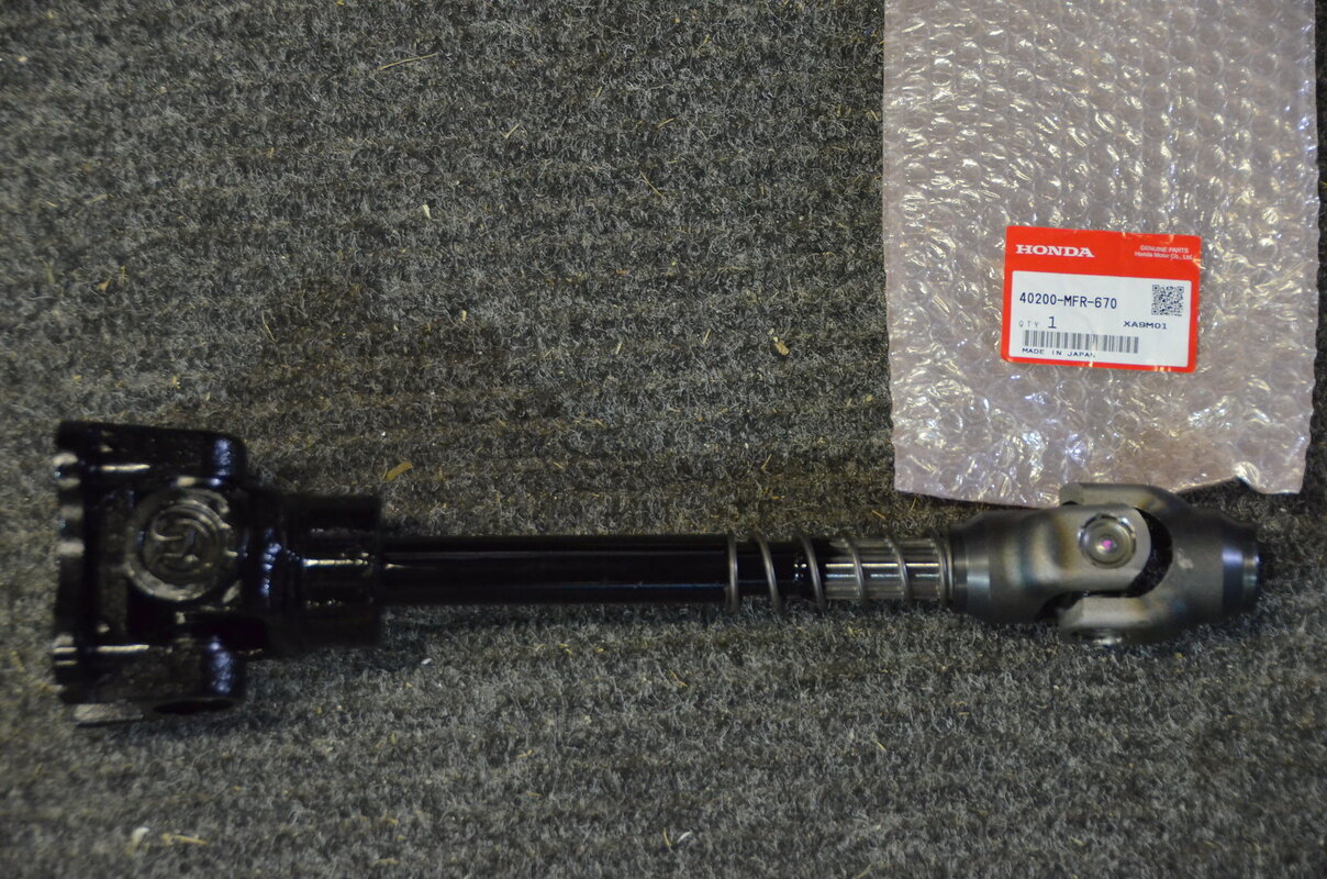

I talked with Motortrike and had a question about my trike and asked about the VTX up date drive shaft. They do not make one for the VTX. So you would use the shaft from Motor Trike and OEM u joint. Just make sure you line them up correct. Not hard to line up as long as you know what to look at.
David

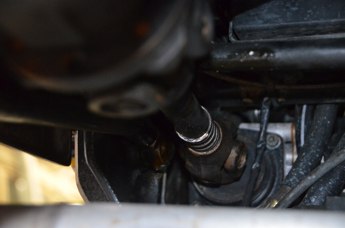

Putting the driveshaft in phase turned it from
eyeball shaking vibration
to
Smoooooth to 85.

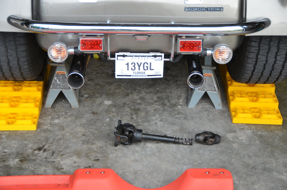

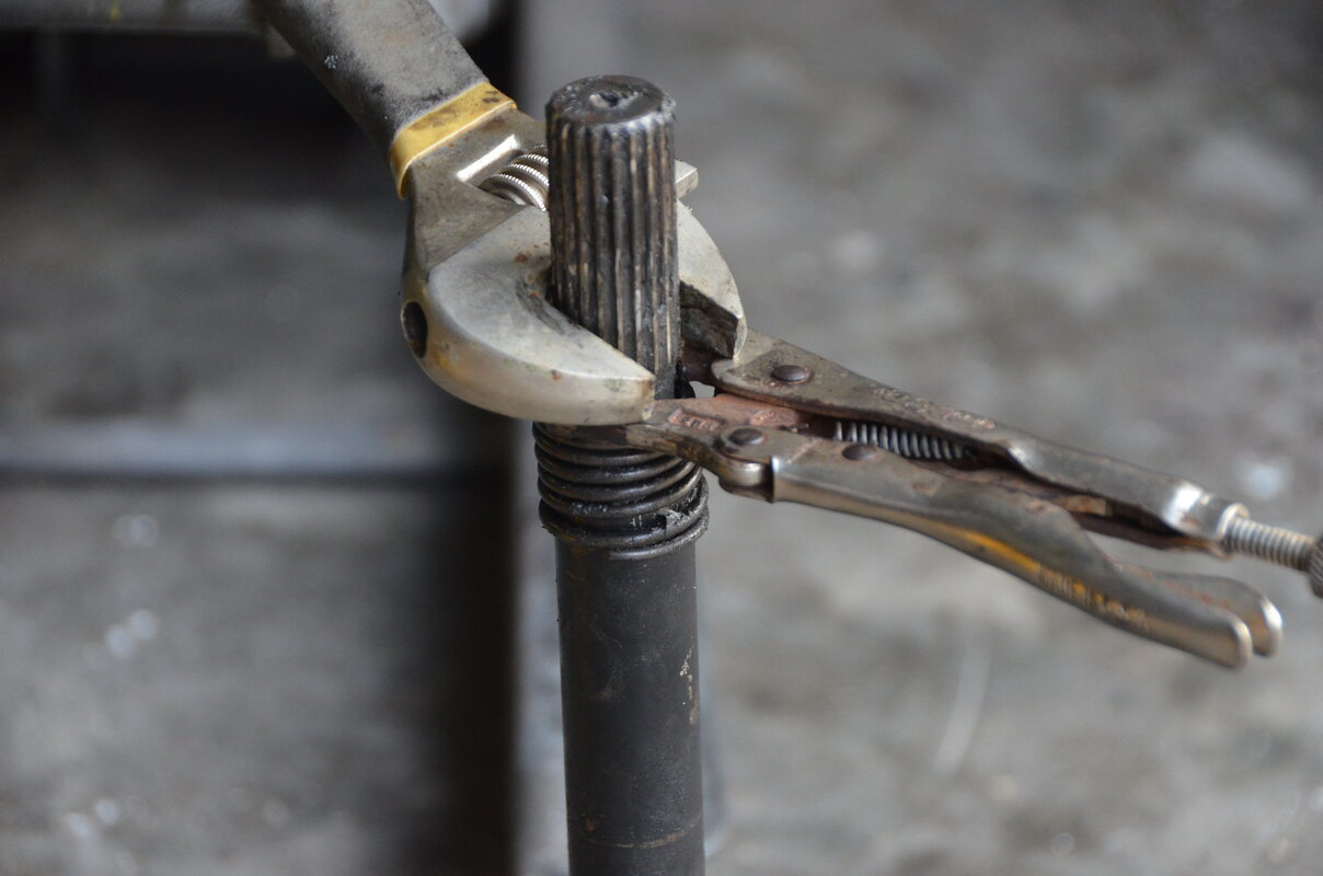

Bit of a task getting it out, The spring loads it up quite a bit. I used a small visegrip to hold it compressed, and installed in phase. We just came back from the ride.
Also installed the 51mm exhaust baffles. Still has a really nice sound, but no 'snap crackle' on deceleration, and the low end performance is noticeably smoother.
What a day.
And found there is a smiley limit. LOL. ""You have included a total of 39 images in your message. The maximum number that you may include is 16. Please correct the problem and then continue again."" Fixed that too.
Ok, pictures.
In the blurry foreground, the bottom U joint cap is part of the shaft. On the other end, you can see its 'mate' is off by a few teeth.
Shaft out, and everything is covered in moly grease. Underneath also, I got pretty dirty. But everything is tight and feels great.
EDIT - you can see the 51mm inserts in the pipes. VERY happy with the sound and performance. Have to get header wrap to tighten the fit a bit.
I locked the spring down after compressing it with the adjustable on top. Worked great!
Little bit of play in the rear end, and might drop that next summer during the hot and rainy. But for now we are on the road in style. Could not be happier.
Gonna keep the new parts as spares. We had wanted to keep this ride for years. Its a LOT brighter possibility now. :clapping:

Some play in the rear end is normal. Also check your hemi joints and lube them. There is a free download on the Goldwing kit and it is the same as ours. There are 2 joints that you should be able to move with your fingers. If not those will need adjusting. Good job on finding the joint miss aligned.

Rather than clamping vice grips onto the machined splines, might I suggest you slide the front U-joint onto the drive shaft in proper phase of course, then loop a long piece of wire through the saddle portions of the front and rear U-joint yokes, compress the spring by pushing the front U-joint on as far as you can …. then a few twists of the wire to secure it. Return the drive shaft to the trike, then after it's in place, just snip the wire. A heavy duty zip tie works too, as does strong poly chord like used for cloths lines, etc. Good cotton chord will work too, just don't forget to cut & remove whatever you use. No chance then of damaging the splines.

The picture angle doesn't show it well, but the vice grips are below the splines. Loose enough to rotate on the shaft, but tight enough not to slip over the splines.I carefully adjusted them to fit there before putting the spring on.
Then slip the spring on,then LOOSELY holding the grips on the shaft, I used the adjustable wrench for a large area to push down on. Then when the vice grips were at the proper place, squeeze and lock. The vice grips were loose enough on the shaft that I was able to install the front U joint on the tranny, then rotate the shaft to the proper orientation and slide it into the front joint. Vice grips stayed in the open area to the right of the output shaft. Release the grips, and done.

Not sure if the new shaft is going to come with U joint or not. The rear U joint is an 'off the shelf' item, unlike the Motortrike made part, so i am anticipating it will not come with as to reduce the cost to the manufacturer.

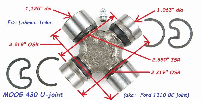

Might be a good idea to make sure it fits before storage. That rear U-joint on mine is standard Moog 430 also known as a "big cap Ford" series 1310 U-joint (two bearing caps are larger OD to better withstand deforming by overtightened rear U-joint caps).
Not sure what yours will take. When you get it, be a good time to find out what yours is & maybe pick one up if not included, they are cheap enough.
Good luck, take care, enjoy the "Glee on Three". :D
WOW! Thats some good advice there. Will do. You may have saved 'future me' a load of trouble.

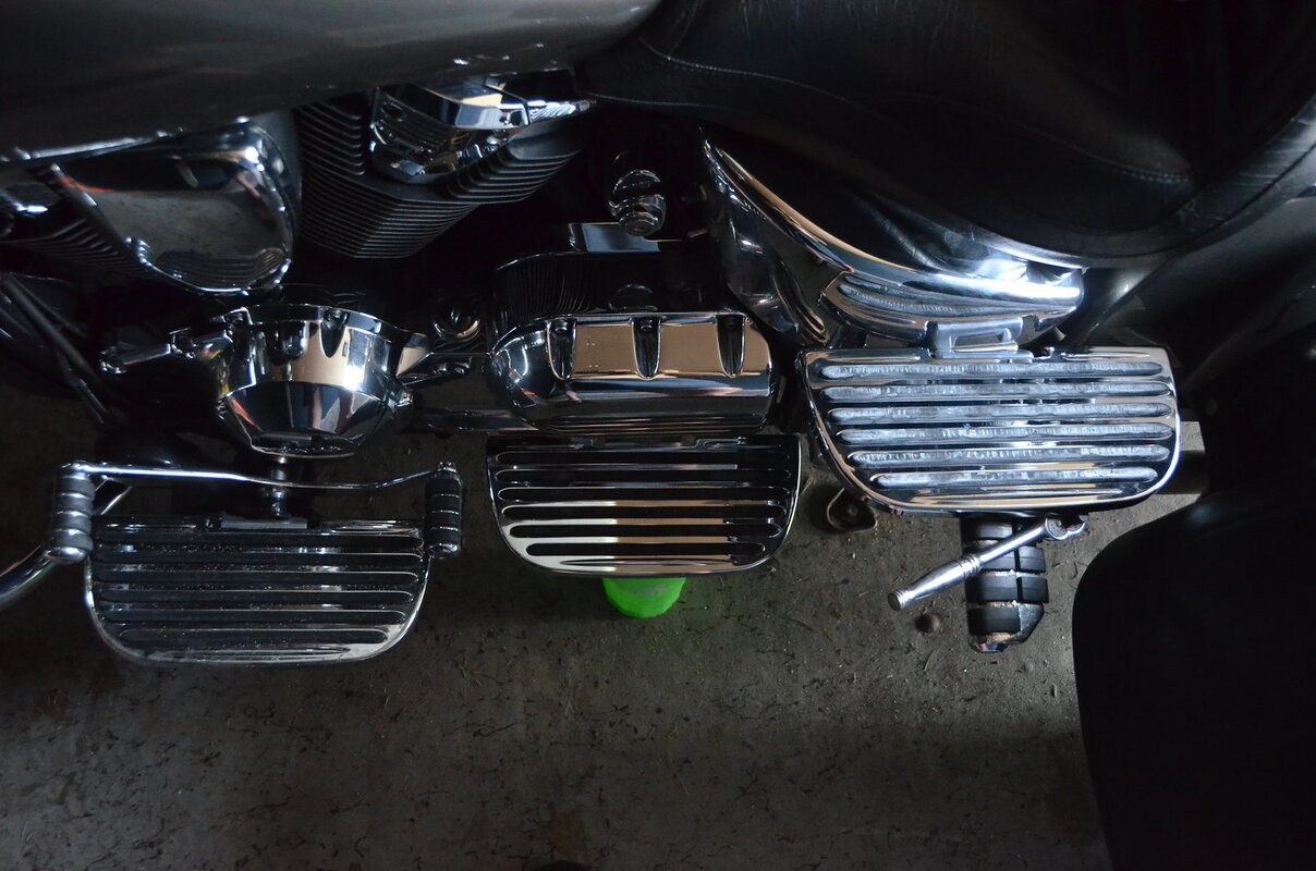

Beautiful Sunny Florida Winter Sunday, 50's to start. :clapping: Going for a ride later, polishing the aluminum wheels now.
LOTS of black rags. But they do shine underneath. I used to have a buffing wheel on an arm back in the day for doing VW rims... missing it now!
Using Mother's polish, thank you WalMart. Forgot to get some at the parts store.
The footboard covers came FRIDAY. Four days from Sweden to Florida. :xzqxz: Amazing. UPS shows us how it is done.
They are NOS in excellent shape.
Back to polishing!

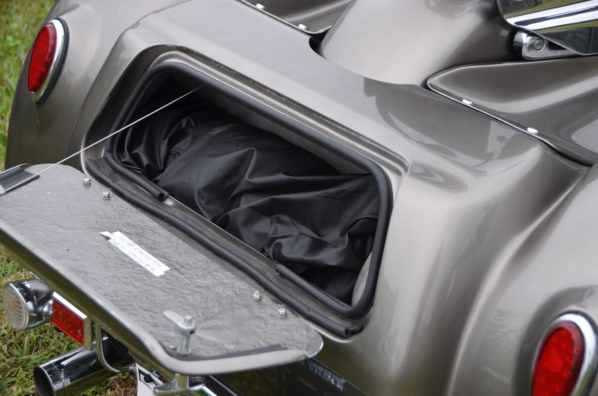

Put it on in the trailer. The zipper in the back allows for trunk access without taking the cover off.
Now even if the roof vent or AC lets water in, I am covered. :good:

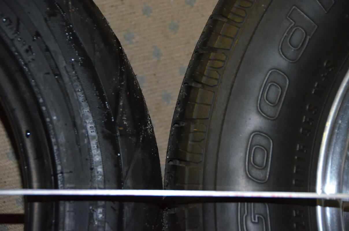

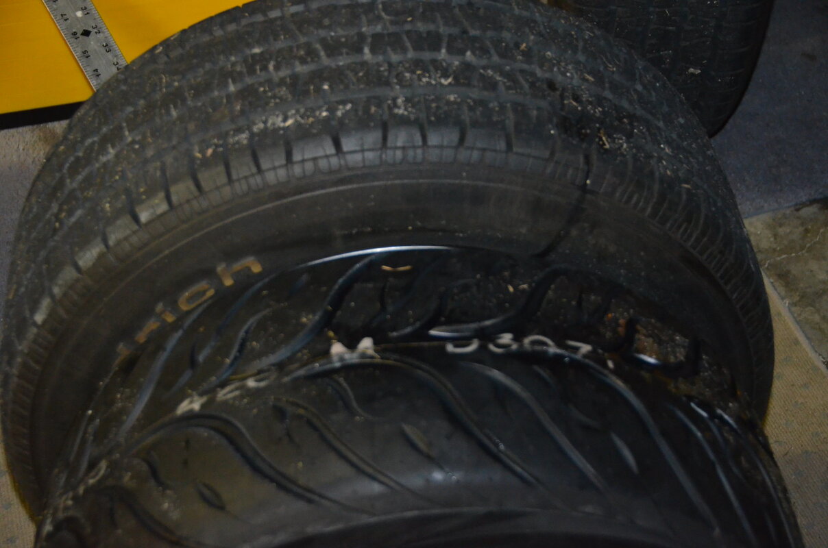

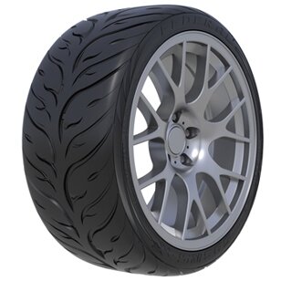

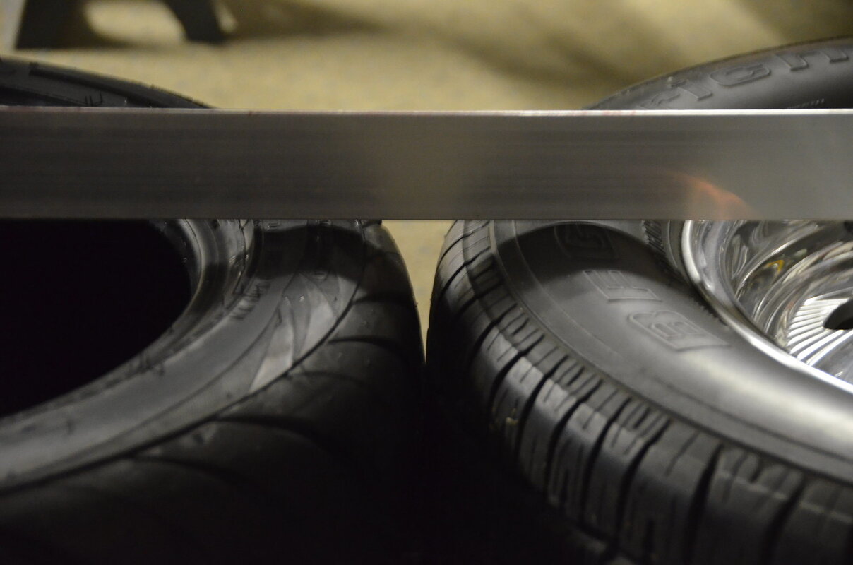

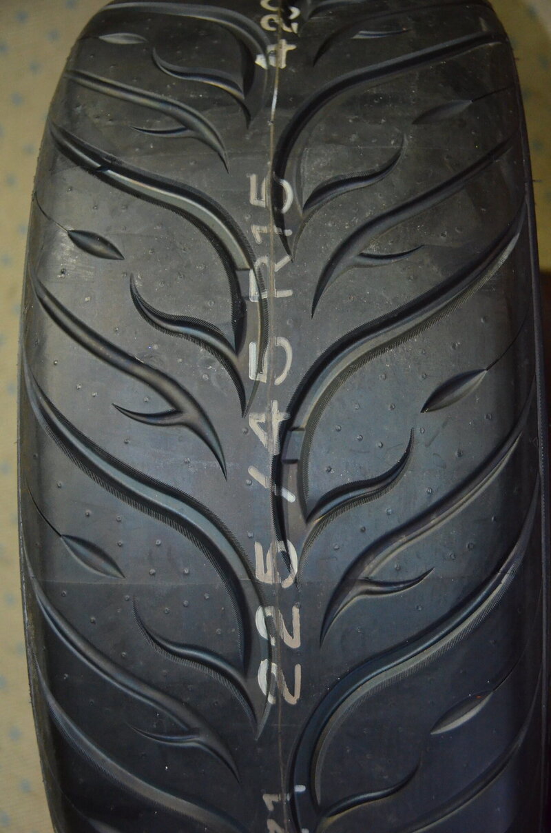

Getting different back tires. Estimated delivery by new years. The way Amazon has been, prolly here by friday. Been getting packages 4-7 days early!
Look like they are brothers to the Avon up front.
225/45r15. 23inches tall, and run on the wider side.
Original 225/60R15 BF G's will be saved. They were 25.6 inches tall.
The engine will turn 12% faster with these tires.
I am liking a 'lower' gear, I dont like the feel in 5th. I use 4th for top gear. Sometimes wanting 5th, but usually not for long. The engine turns 25% faster in 4th than 5th.
Hope the tire size 'splits the difference' effectively and I can use 5th more.
Shouldnt look too small in the fender, they are 1.5 inches shorter on the sidewall, and that would put the tread height even with the vertical edge of the fender.
They are pretty cheap to experiment with. :clapping: Tires less than $200/pair delivered, estimating $50 for R/R and balance.
https://www.amazon.com/225-45ZR15-8...ral+595+rs-rr+225/45r15&qid=1577058870&sr=8-1
Be REALLY cool to see a braking increase... certainly should with sticky race tires. They are DOT legal.
There is a the complaint they are NOISY. Like ALL CAPS NOISY. On cars... I would be somewhat tickled if the tread noise was louder than my exhaust on the trike. We will see!
Got more parts in! The Motortrike driveshaft came with EVERYTHING needed. :good: Great service.
One thing bothers me... The front u joint has four possible ways to go on. Using the 'eye gauge' it looks like none of them line up correctly. :xzqxz: One is close, I am going to set things up on a flat surface to check correctly.

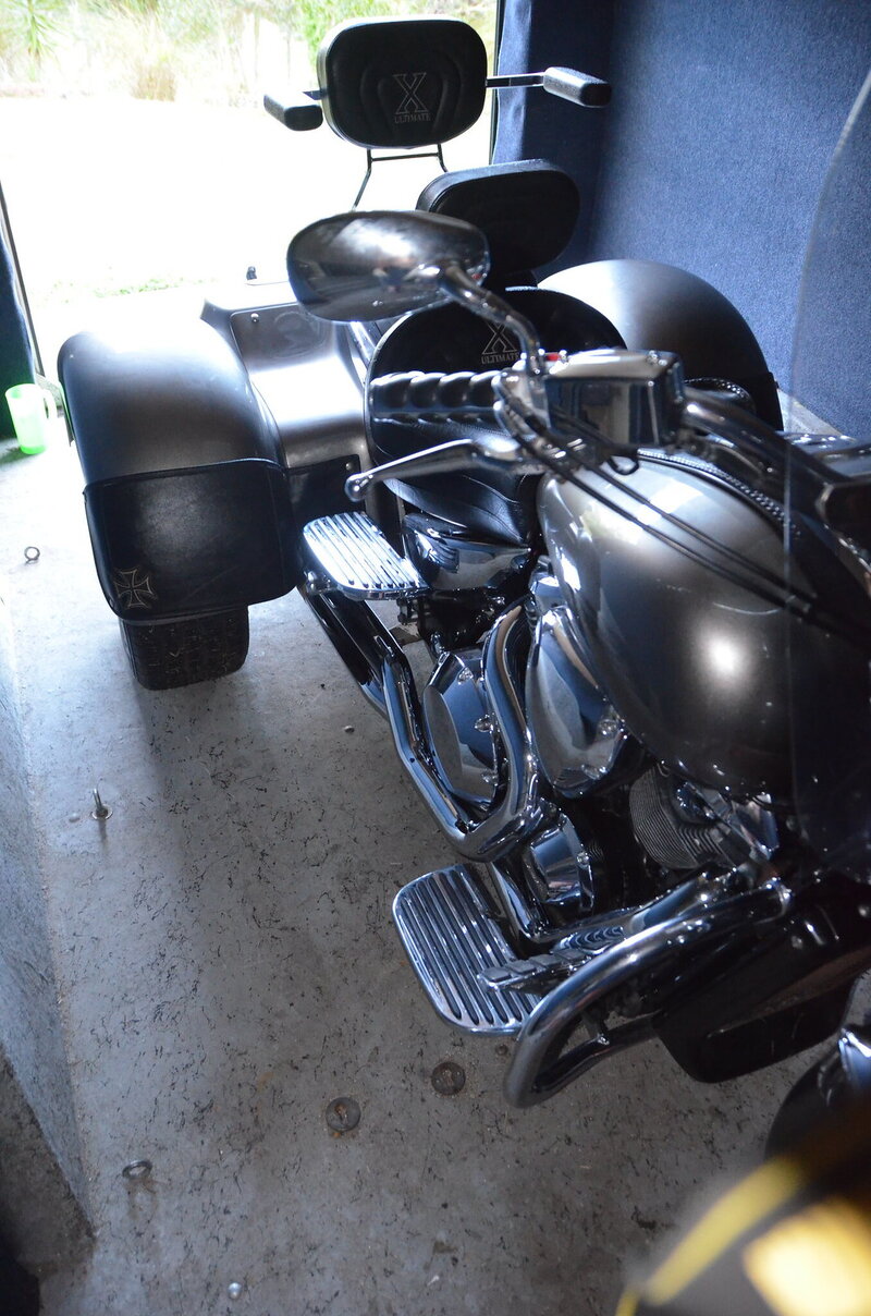

Got the two left side steps, the right is coming...someday. Should see if my Swede buddies have one. :laugh: The chrome footboard covers are from them, and look great. Pins and springs from Honda. Tried to get all part numbers visible for those that follow. :cool:
_______________________________________________

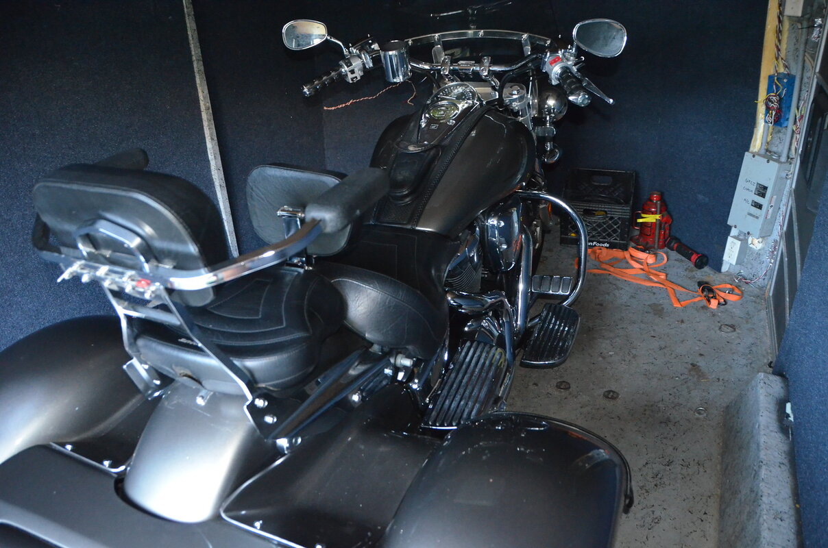

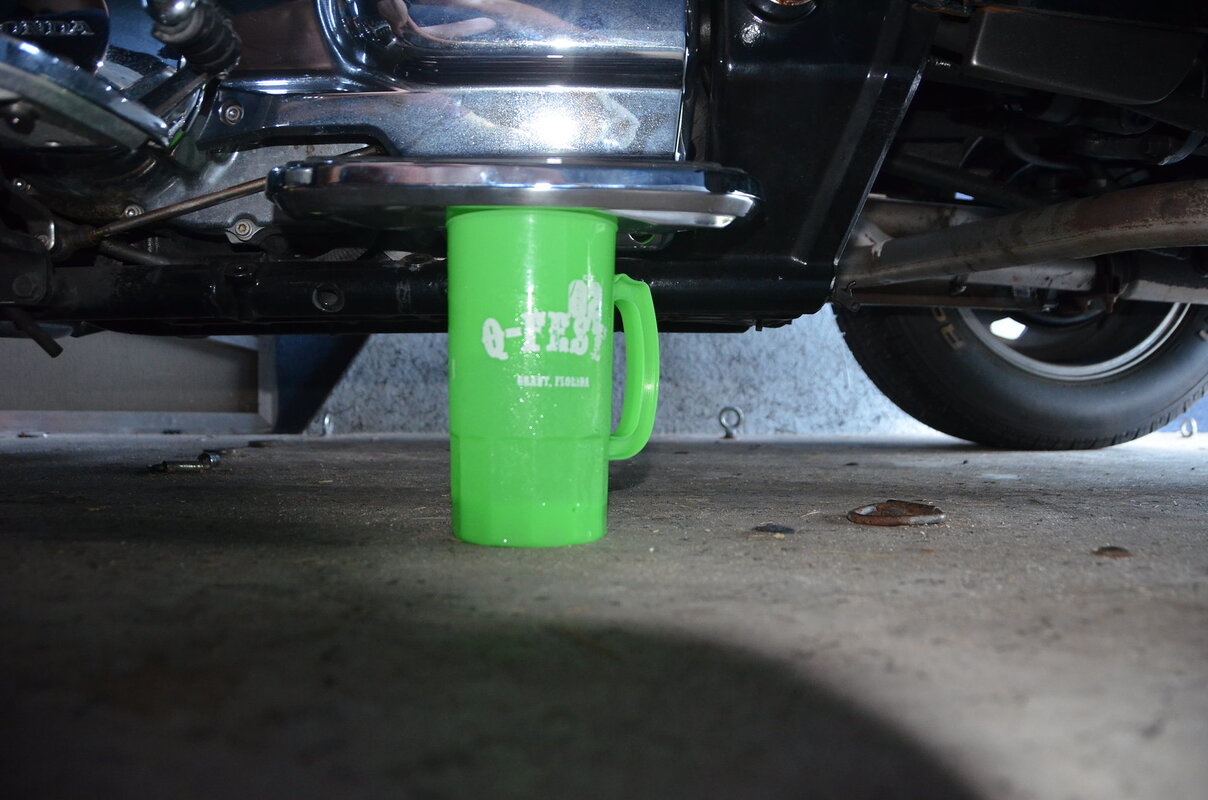

It was raining, so I was working in the trailer. The rear footboard is just balanced there for the photo. Making proper brackets soon. Mrs V LOVES the look.
____________________________________________________
Left Side. Once again, just propped up for the pic. The ratchet, and bright green glass were close at hand. Glass was perfect height.
Going to make sure the lowest step is 'inboard' of the others, and allows me to reverse by foot. It is still about the same distance out as the exhaust on the right side. But it will be a WELCOME addition for me and Mrs V when mounting the trike.
Higher than the frame rails, I am gonna use the original side stand bosses to mount it.

The tires came! I was betting friday... Amazon is kicking a**. They were 'expected' the 31st.
They look great. The rain grooves are the width of my index finger.
Deflated they are the same width as the originals inflated..... :good:
_____________________________________________________
Definitely shorter. 23" vs 25.5".
Trying to show the height difference better. The new tire height is between the ledge/transition at the edge of the block tread and the next 'inner' ledge/transition. It will look different, for sure. The wheelwells were overstuffed before, so i am hoping for a decent look and a final drive reduction.
Put the new driveshaft on the bench, and one fitment of the front u-joint/driveshaft does have a 'perfect' alignment. I could see someone replacing the part and having the shaft out of phase if they didn't know to check. I will have pics up when I replace it. Tires first, they are going to be mounted and balanced tomorrow.
Tires are on, unfortunately we have had DAYS of rain... I am a little reluctant to run down our muddy dirt road to get to pavement. Country life... love it.
At first, I panicked. HUGE gap between the top of the tire and fender. Then when I figured out I had left the airbags at 80psi from when I jacked it up...:xzqxz:
I put them down to 20psi and it settled a couple inches. WHEW. Looks more modern now, for lack of a better term. Less of the 'stuffed wheelwells' look. Try to get pics if we get a break in the *&%*&%^ rain. Dec 28....rainy and 75*. :gah:

Have to wait for dry weather. For today, gonna pull it in and replace the driveshaft.

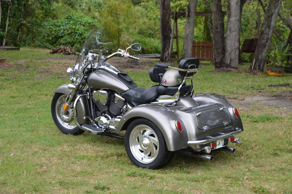

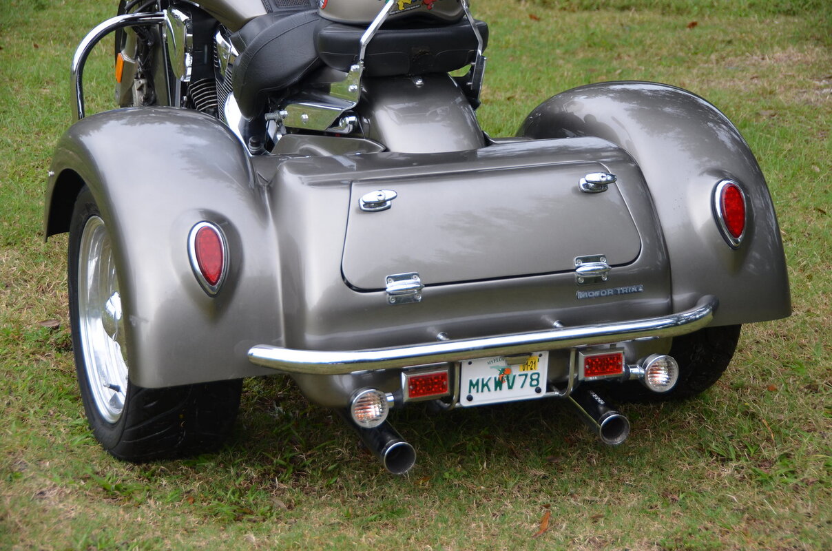

Went for a first look today. Pretty good for the age, minor paint issues, shiny bits shiny. When I put the rear brake on, via the foot pedal, it stuck on. Pedal travel normal, like the master was good, but was not wanting to move. Had to help push it back in. After fixing it, Seller told me it was a mis adjusted shoe and 'drum brakes are tricky' :xzqxz: Yeah... as an air cooled VW restorer, I know drum brakes WELL!
I had a bit of 'Parking Brake?!?' hope in the first moments... :D Nope. But being that Mrs V was with, cut the visit short and let the seller 'fix' things. 1:30 PM
He called back at 3pm. Told him i was still in, and see him tomorrow.
So, going to do a 'due diligence' inspection tomorrow. Have gloves, light and back wheels off. Give her the complete underbelly look.
Todays peek under it looked like the rear end cover had been pulled. Might have been oily, or fresh black paint. Is this a narrowed car rear end? Solid axle.
The VTX1800 has 18K miles, don't know when the conversion happened. Will get DOT date off tires tomorrow FWIW.
The original VTX owners manual is with it :pepper: and a bible. Do the rear drums use the stock VTX master cylinder? Going to consult the OM for all fluid check points.
