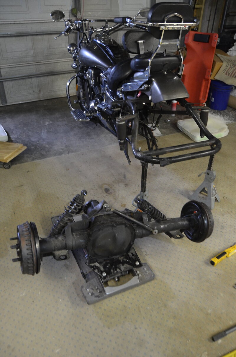

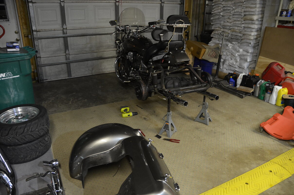

I am working out the install of the rear axle, and I am concerned that it may not be properly aligned. Triketech did say improperly installed ladder bars WILL damage things.
I have the document from Triketech earlier, and the MT manual for the Goldwing trike conversion.
Both cover final adjustments, but lack the 'basic' alignment to the front wheel. Most is probably basic geometry and measuring, but I dont want to find out the hard way there is more. Never set up a three wheeler.
Any info?
THANKS!

i went through this a while back when my rear was running stagnant.
I measured from the bolt that holds the front heim in to the front of the axle tube and made sure they were the same. If I remember correctly, that measurement was 23 and 1/2 inches.
As far as side to side, I measured from the frame to the inside of the tire.

I found a few papers on setting cars up, learning a tip or two as I read. Being that everything else on this poor trike has been monkeyed around, i am not assuming anything is correct. Found some 'custom' wiring in back, so soldering away on that too.
I have a good level concrete area indoors, so thats good. Suppose first step is to see if the add on frame is square/level to the front axle/bike. Maybe a 'traumatic event' will be revealed that explains the rear axle tear. :confused:
Then get the axle squared and centered to the front axle. Should get me a good start.
Going to try a minimal pinion angle, fortunately I have a good test area around me. If any 'pros' out there have a hint, feel free to chime in. PLEASE. :D
I have a magnetic level, about 8" long, has a fixed vial and an adjustable vial in a round window with a degree scale. I think maybe Black & Decker. I know U-joints like a little rotation of needle bearings in use for longevity.
If mine, I'd probably try to nearly match the pinion angle to the angle of a engine part like underneath cooling ribs which likely nearly match the angle of the output shaft and let any slight offset between the output shaft and pinion shaft do the rolling of the needle bearings. You might be able to access the output shaft itself on a VTX? Or maybe I'd just aim the pinion 5 degrees bellow driveshaft center line. With ladder bars, once set, that angle at the rear U-joint is gonna stay the same anyway.

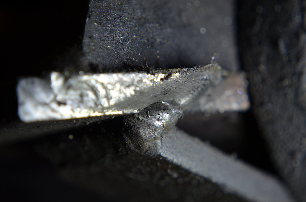

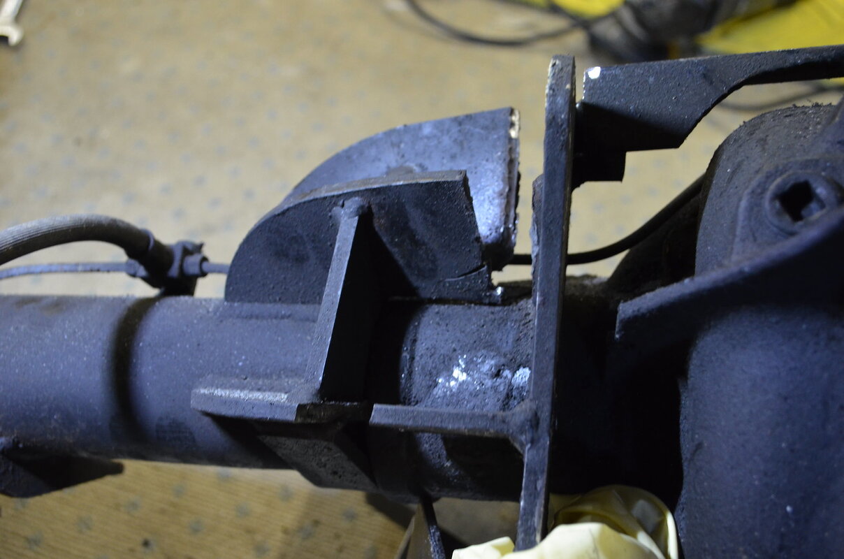

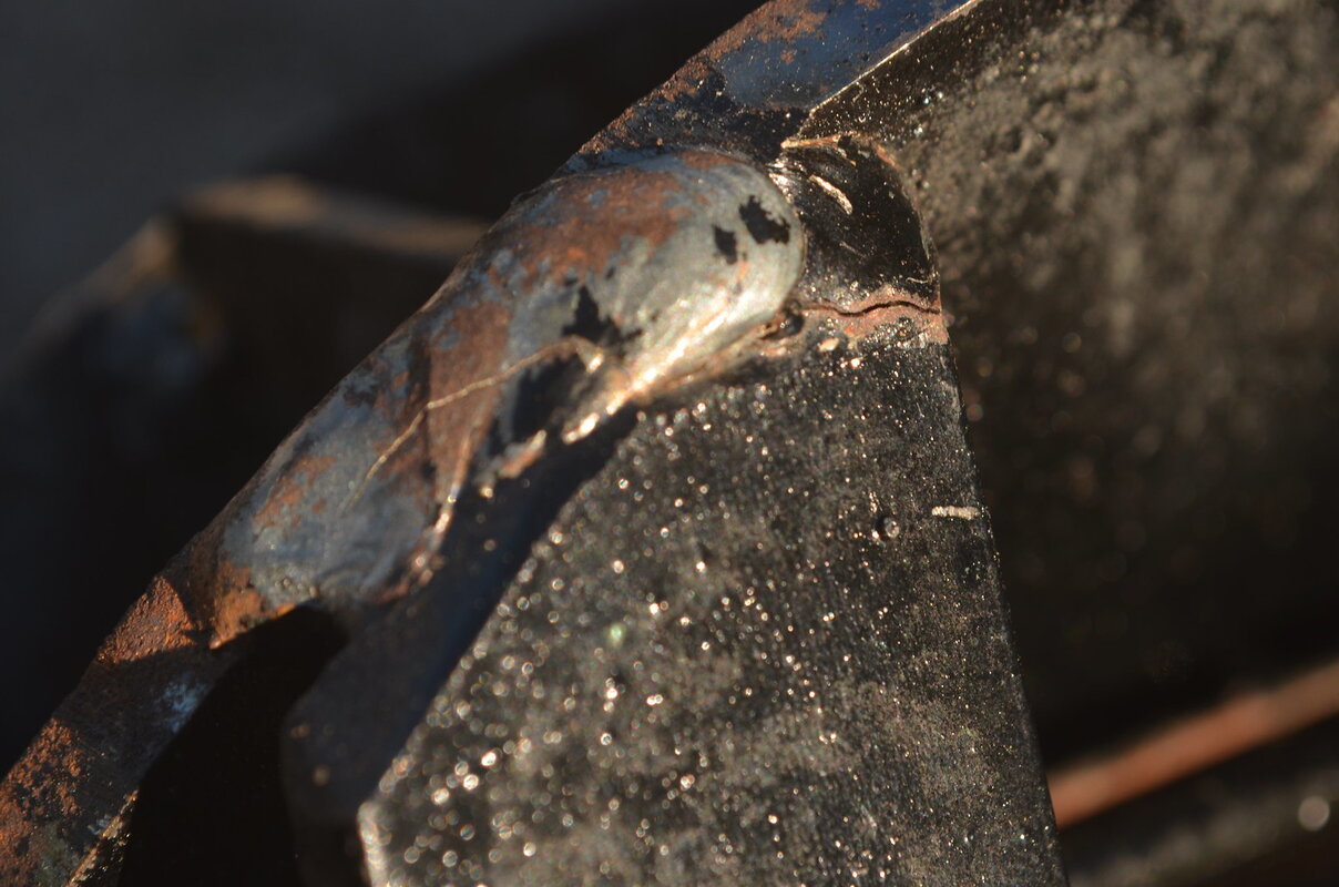

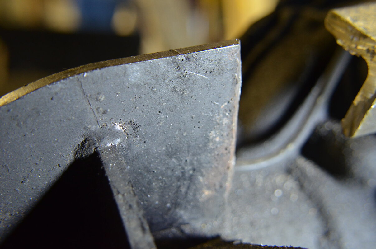

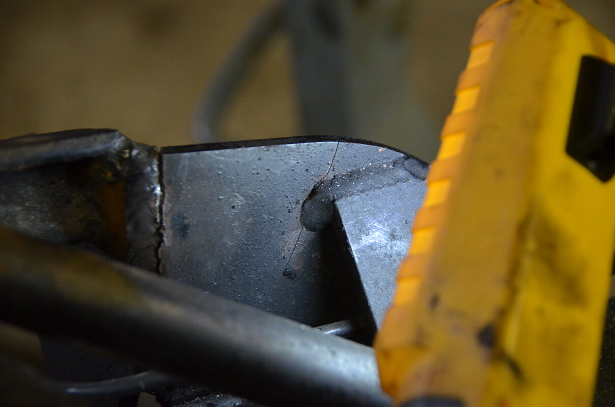

Well, I guess i can pinpoint the problem as poor welding at Motor Trike in 2006. Got the axle up on the bench, under bright lights.
As some may remember, I was a little pissed that Motor Trike missed the weld at the top of the left side strap. Even with HD pics. Hard to tell if it was a weld-over-a-crack, or a weak weld failing under a stronger one? I cut it apart, and the pieces looked like it was poor penetration, but hard to tell with the 'scab weld' on top. You could still see the square edge of the strap where it SHOULD have been fused to the other plate...

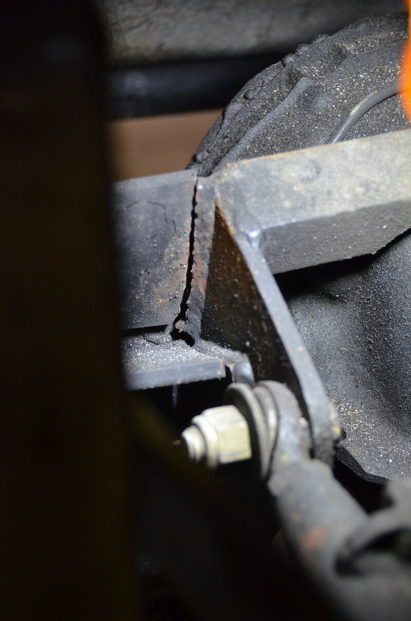

Well..... found the bottom cracked also, and the culprit is VERY clear. Now, as you see, the crack is pretty damn obvious.
OK, this wasnt hard to find on the bench... just never had it upside down under lights.
And it wasn't far from where Motortrike's crack team did the inspection and repairs... :confused: Like 4 inches or so.. nice attention to detail guys.

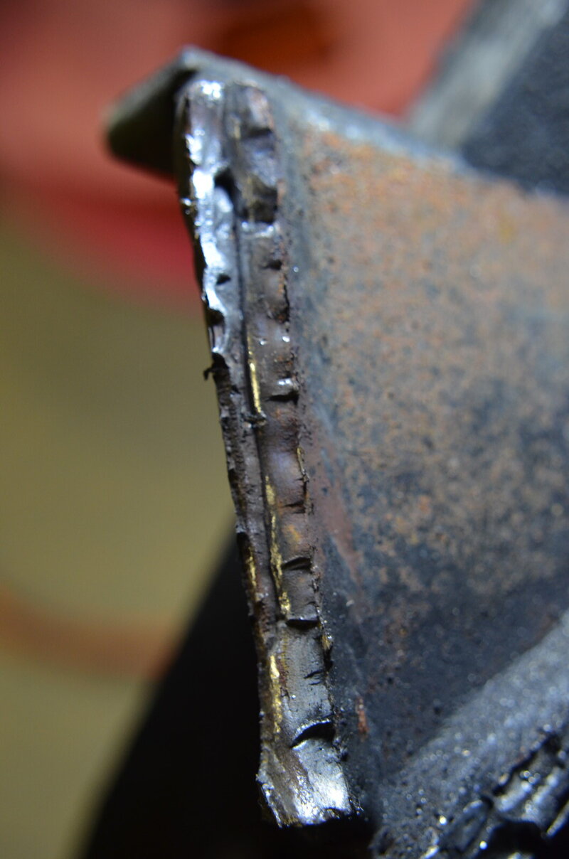

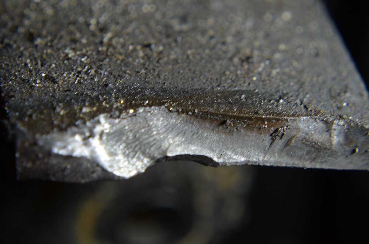

Cutting off the strap end to get a good weld area, look at the LACK of penetration. Those two little divots in the base metal are the ONLY spots the weld had penetrated. Popped off with a small screwdriver, easily, after cutting the strap. You can see the two bumps on the piece i am holding. ALL the other surface area was just pigeon shit on top.
Well, thats a 'smoking gun' to me. This whole calamity was caused by piss poor welding in 2006. On top of that, when i send it back the current group of monkeys doesnt fix it right. This was SUPPOSED to be cleaned, inspected, and new pieces welded on while in a jig. Instead, they replaced the minimum necessary to make it work, and never inspected the rest of the assembly for the PROBLEMS IT WAS SENT THERE FOR. Idiots.
