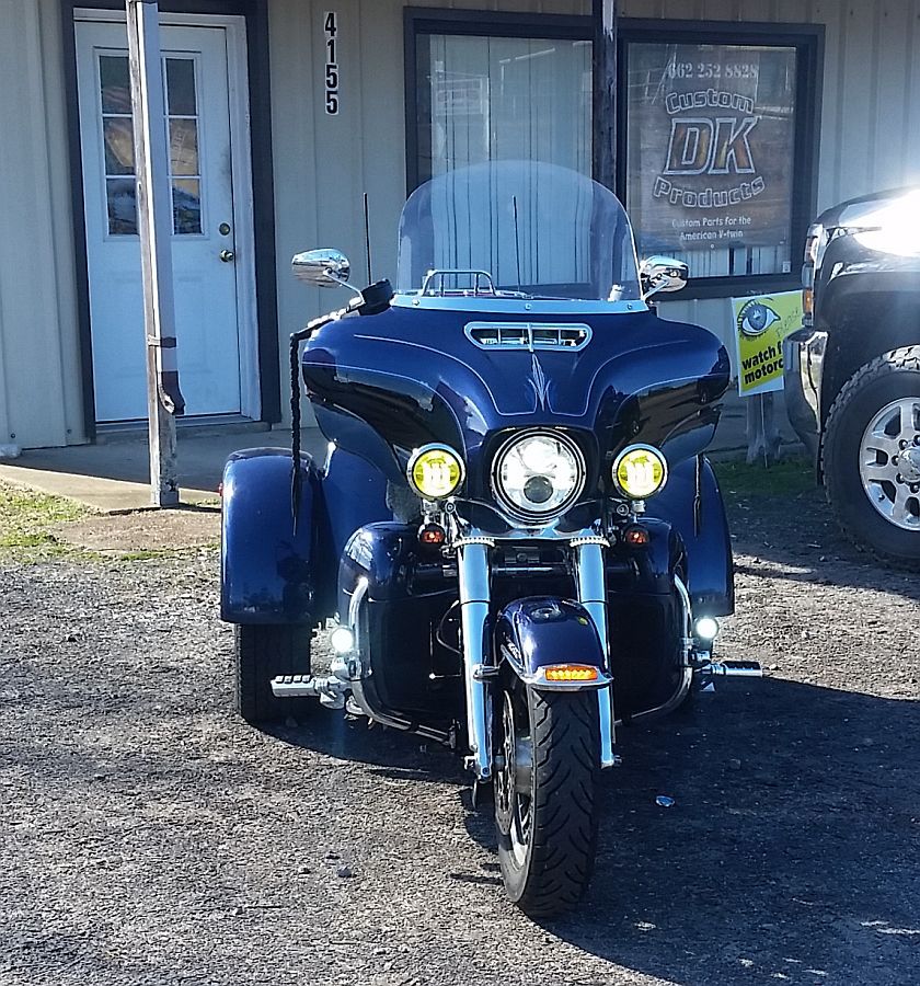

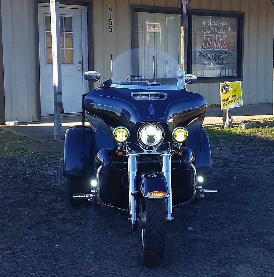

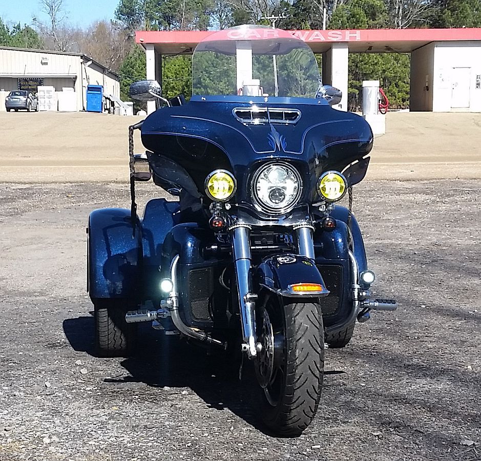

Kevin, I have been told, while riding in a group, that it appears I don't have my lights on. 14 tri glide with no front light mods, I did adjust the lights when I installed the DK Comfort lift. Do the yellow running lights make a difference in the daylight? Jim
Last night and today I took a bunch of pics...posted below.
Specifically on the yellow film I have covering the running lights-yes, I think it makes them more visible during the day, helping me Be Seen better. The Stealth Driving Lights also are a big asset during the day (and night) helping me Be Seen better.
In the shade, sun behind the bike-
Sun behind the bike-
Bike pointed into the sun..the headlight is not much brighter (if any) than the chrome. But the yellow passing lights are still visible, and the Stealth Driving Lights very noticeable. Even the Turn Signals/Running Lights encircling the forks are visible.

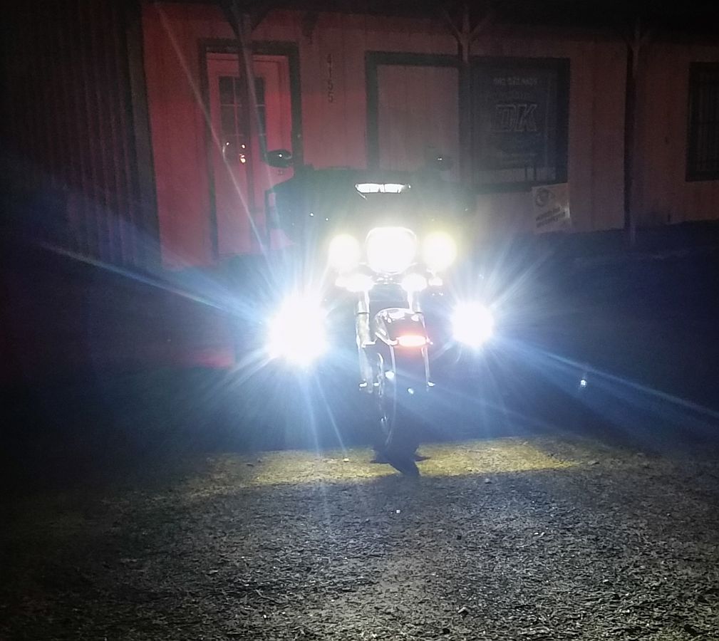

Same set-up at night time. Not only am I very likely to Be Seen, but it really lights up the road to help me See. btw, all of these lights, and I never get high beam flashes, because none of these are blinding the oncoming traffic.
Here's a view from behind at night. Pretty sure anyone behind me is going to see me. :)
Plus, you can look in front of the Trike to see the nice spread of the headlight, passing lights, running lights and Stealth Driving Lights.
