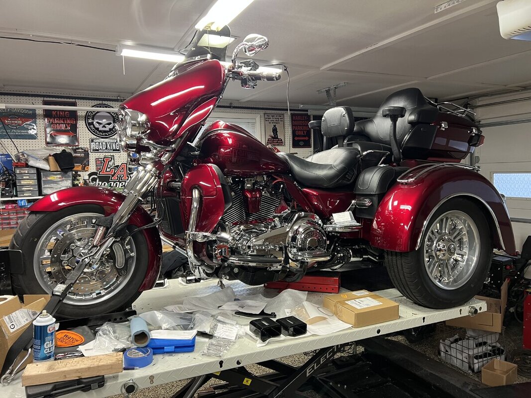

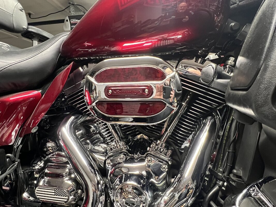

Today, I installed the parts I got back from my painter… (the paint is HOK “House Of Kolor” Kandy Brandywine over SilverMax Orion Silver).
- Klock Werks wrap style (“Slicer”) front fender, PTM lower fairing “skirt”, fairing side wind deflectors, painted air cleaner inserts, and a complete Alloy Boltz ARP stainless 12 point bolt kit. (The previous owner installed those plastic chrome bolt caps that required silicone to hold in place… kinda looked tacky with my set up & finally decided to remove them with quality bolts).
I’m always doing something, lol!… but today was a quite productive day with all these now installed
‘Cmon spring time!!!

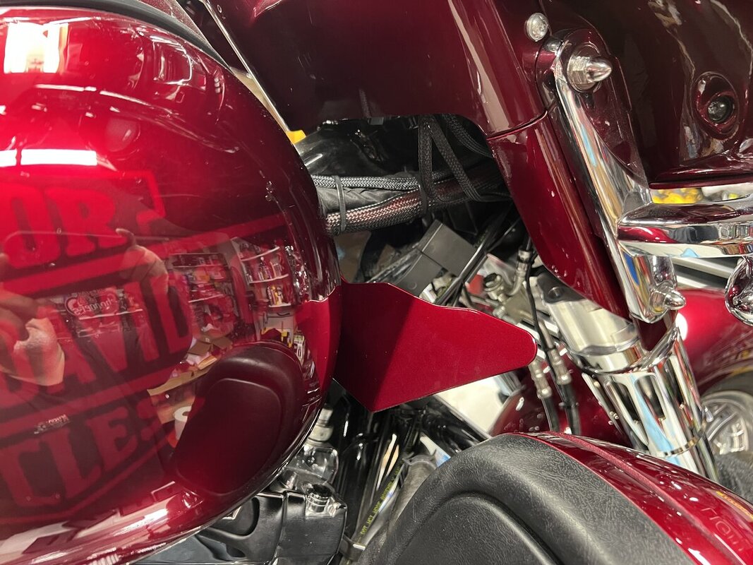

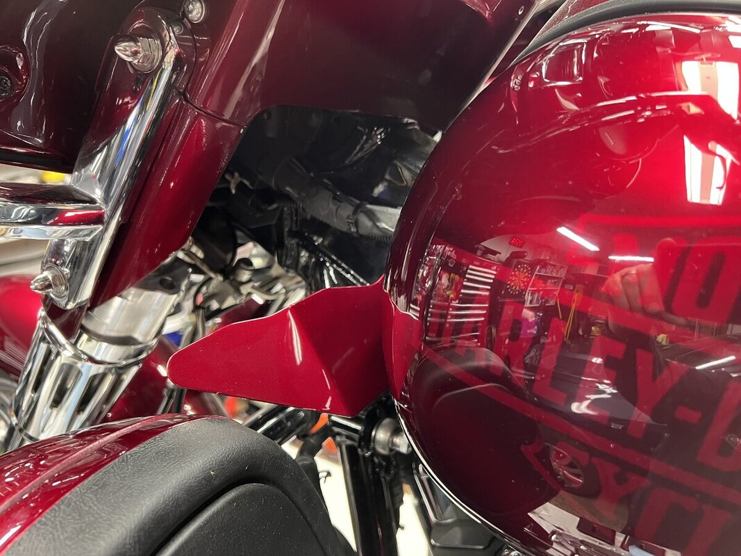

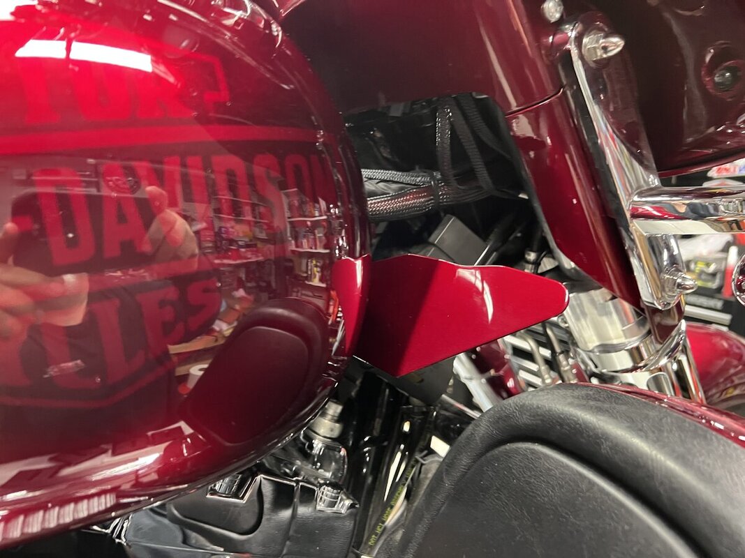

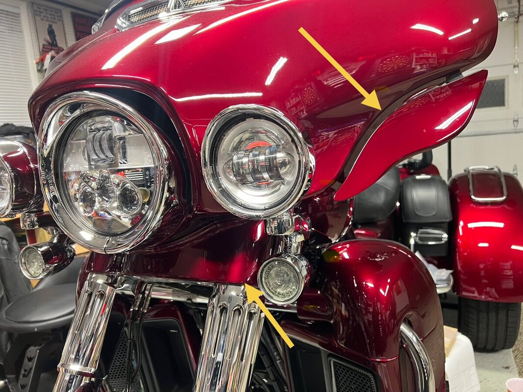

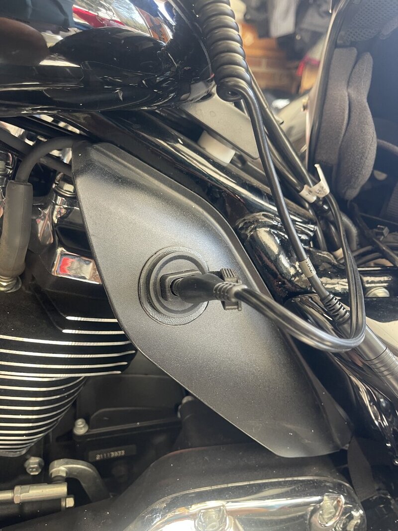

….Today I also just installed the PTM (HOK Kandy Brandywine) on the @DK Custom Products cooling Deflector wings!
(The color is a 100% match, but will take on different shades depending on how the light is reflecting on/off any painted parts).
I also had to double check to make sure I had the correct sides installed correctly, lol!
I think I’m good. 👍🏻
Here’s pics of those installed!

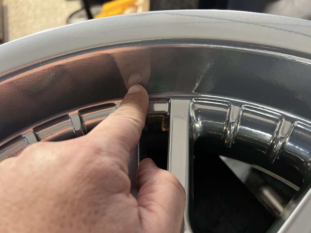

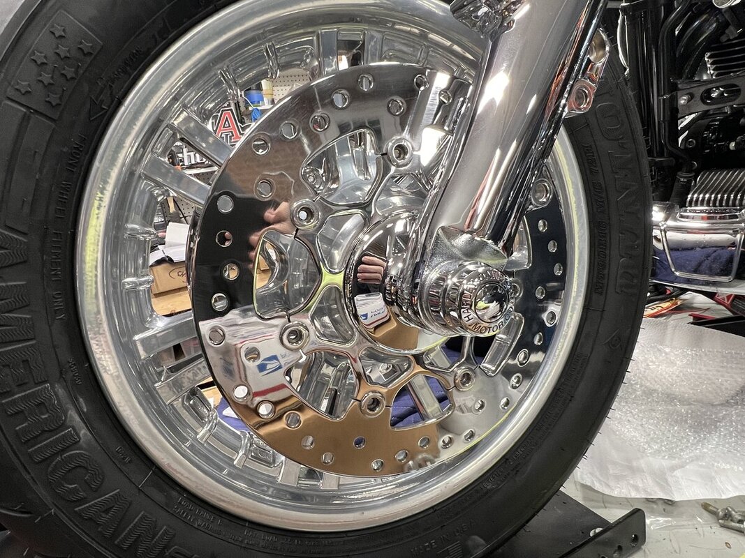

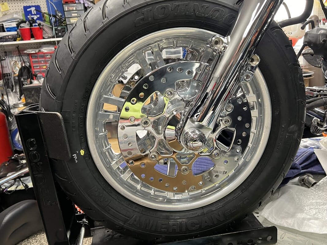

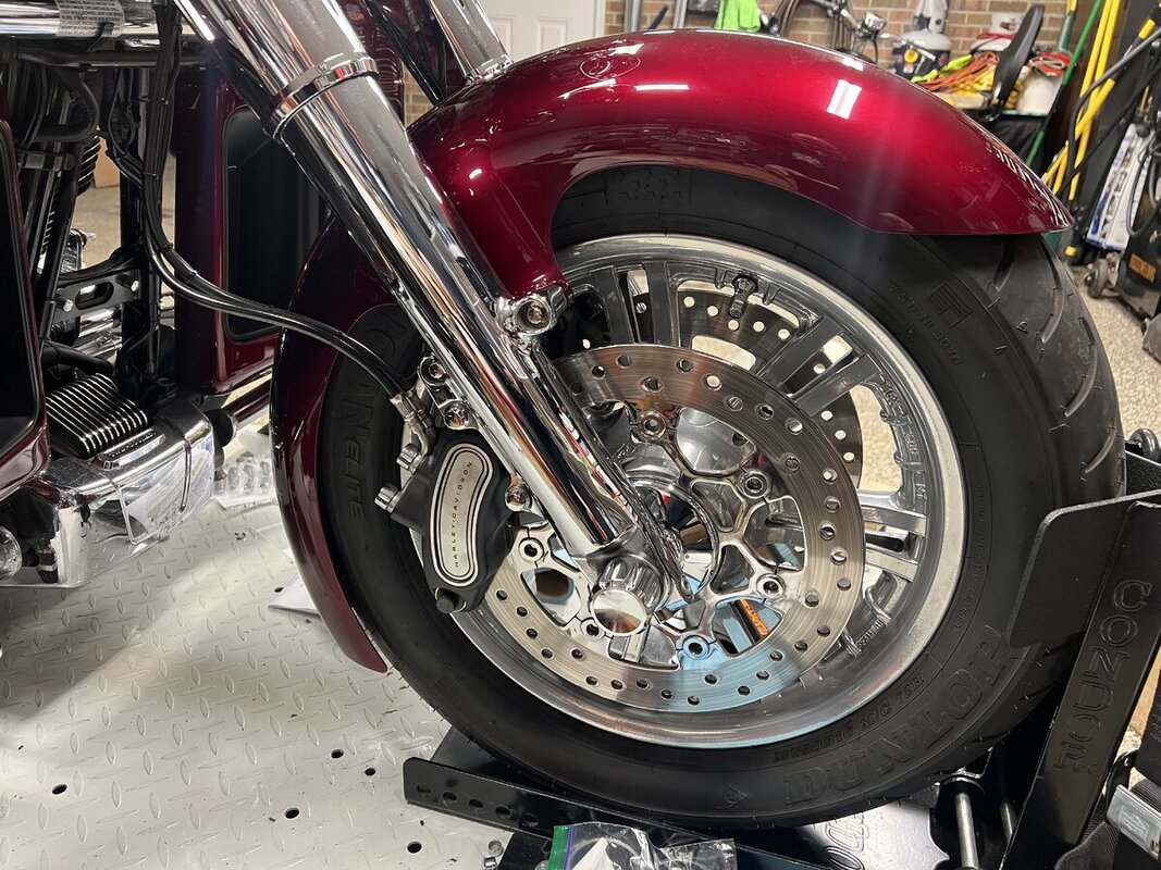

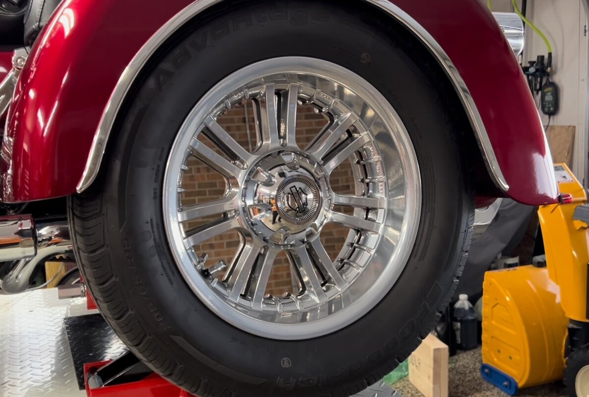

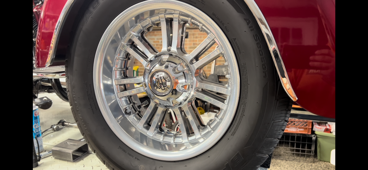

Did you get your wheels plated? They look chrome.
Mine are not really chrome “plated”….. but are in fact: “Powder Coated - Chrome”.
They do not shine as much as chrome plating….but they are still very, very shiny.
(Maybe… just maybe next year, I may send a set out to either Willy Shiny or Excalibur to get chrome plated).
When I bought this trike in September of 2023, I debated and choose the powder coating. It only cost $300 and they do look great, but still not as “brilliant” or “shiny” as actual chrome plated wheels.
In fact, when they powder coat chrome it is a two step process. When they pull them out of the oven with the chrome powder coating, they do look like they were plated, but that coating is not UV stable and would start to yellow very quickly. So they have to powder coat a UV stable clear coat to retain that shine.
That second step does indeed cut down some of the shine, but I can still tell you, they are still extremely nice!

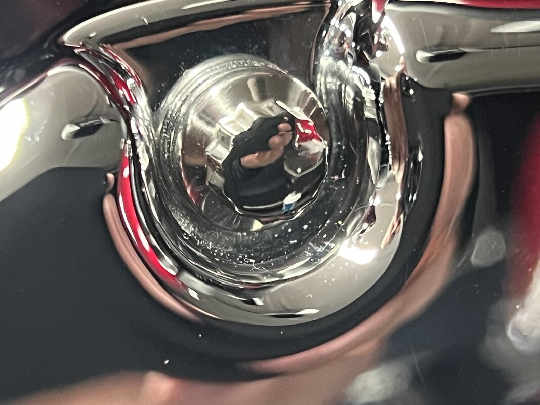

Attached are a few closer up pics that includes the reflection of my finger, the front is easy to compare with the chrome plated front forks & polished rotors, …. and the rear I now have a set or RJS Originals polished stainless steel wheel disks:
