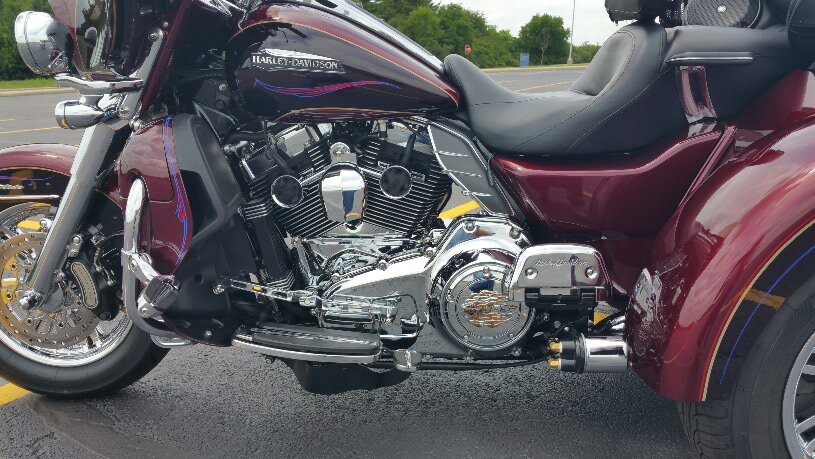

Last week we rode two up in 90+ heat for about and hourat around 50-60 mph.<o:p></o:p>
When we stopped the fans ran for about 5-10 secondsand shut off. So far the longest run time has been maybe a minute or two. Is itpossible that with my 1-1/2" tank lift and the wind deflector under thetriple tree that I am getting good air flow and they only run intermittently?<o:p></o:p>
I do run cams a good decatted exhaust and tuner, sothat may also help as it's not as lean as stock so runs cooler. Just curious asI saw some people see run times of<o:p></o:p>
5-10 minutes after shutting the trike off.
Wondering if anyone else has had similar results?
NH bagger I doubt that would lesson the time on the cool down. I put about 1/16 inch bead on the switch very little oozed from around the switch. im guessing you put too much rtv on the switch causing it not to make good contact with the head or you have a bad thermal switch. once again mine is right at 20 min. or so on a 95 degree day

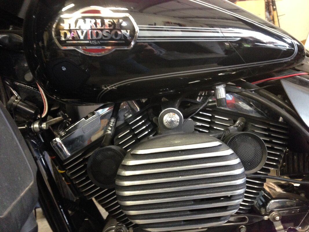

Have had my Wards fans installed for a little over a couple years now and love 'em. Run the fans in conjunction with a Jagg oil cooling system and hardly see the north side of 180*. Also installed the DK Products 2" lift so getting a lot more air flow over the heads. The pic was taken before the tank lift was installed.
Just for kicks I looked at the Love Juggs display at Sturgis this year and they do look like sauce pans handing from the bottom on the tank. The fellow manning the booth didn't to talk about the pro and cons of their fans vs the Wards setup.
The Wards fans from a cosmetic standpoint blend in more with the motor and the biggest plus for the Wards fans is Customer Service....Jason is at the top of my list along with the guys at DK Custom Products.
