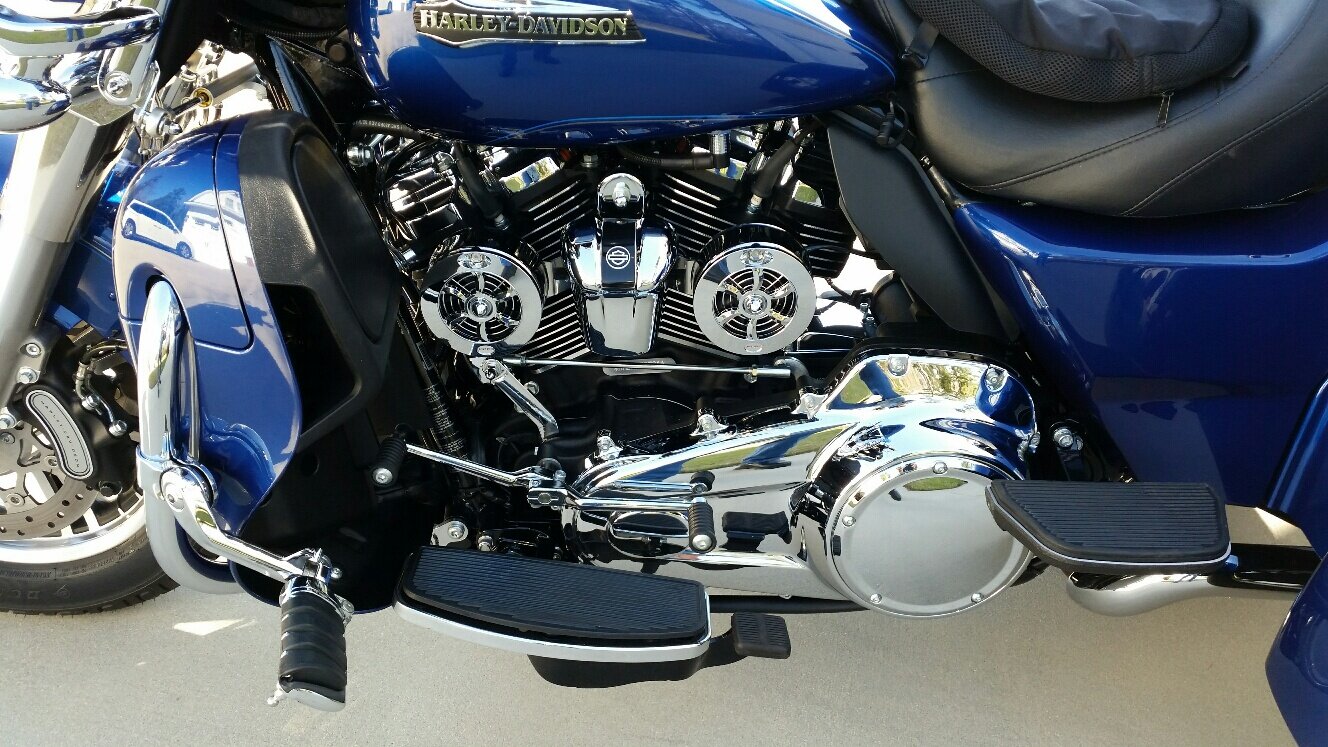

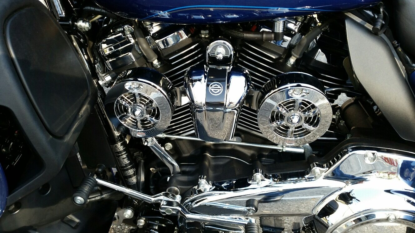

Well, today I completed the installation of Love Jug's new Cool-Master fans in the stainless steel housings. It took me several hours to carefully study the instructions, successfully remove the HD vibration damper and replace it with the Love Jugs supplied damper and secure the wiring. My first impressions are that these fans are made to exceptionally high standards for fit and finish. As you will note in the above couple of pics, the left side of my 2017 M8 engine now looks much nicer!
On installation, the trick to removing the HD red loctited damper was to direct a hair dryer to the backside of the fan horn mounting brace in order to degrade the Loctite's hold on the threaded rod that goes into the very robust brace that is secured to one point each on both jugs. I found that taking a pair of channel locks and securing them such that I would not bang into the underside of my Tri Glide tank was crucial.
After removing the original HD damper and rod that holds the horn and subsequently the horn and Love Jugs, I left a new threaded rod/damper that I used red Loctite with in the brace overnight to harden. This morning, I began to install the horn and Love Jugs onto the threaded rod and had to study how to route the Love Jugs power cable through the left underside of the engine without getting close to the fins and then over to the HD plug that I had purchased to connect to the existing free plug and play circuit over on the right side of the trike under the right access panel.
After figuring out where the wires should go and how I was going to secure them with the supplied tie wraps, I reassemble the horn and fans and mounted them with 100 inch-pounds of torque on the acorn nut/washer to affix them to the former horn only vibration rod.
The end result is a BEAUTIFUL enhancement to the left side of my TGU M8 engine that shakes very little at idle and cannot be heard while moving. However, at idle, with ear plugs in and wearing a 3/4 helmet, I could hear the din of the fans running at approximately 8,500 rpm. The sound was pleasant and not overly loud but it was easily heard through my riding setup. I would imagine that the new Mighty Mites running at 13,000 may be significantly more apparent at idle?
Anyway, I am absolutely delighted that I bought these to help cool my $6k M8 engine (that is the warranty replacement cost of the engine only from Harley) and suspect that it will add many years and miles to this new lump of mine that only has 1540 miles on the clock.

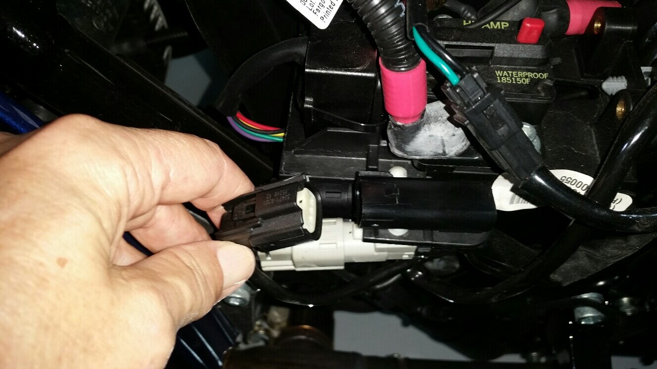

The three pictures show the auxiliary power plug that connects to the optional HD power cord and subsequently to the Cool-Master fan plug. The other two pics are of how the Cool-Master fans look on my 2017 TGU and how it dresses up the left side of the engine. Bob
