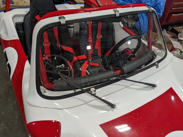

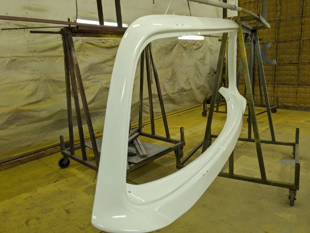

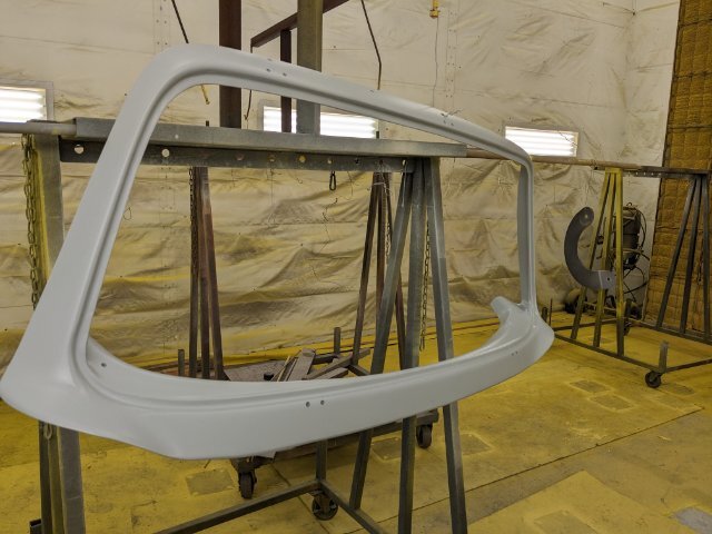

Trying to finish the windshield frame.
I had to cut it up into 4 pieces to reshape to fit the glass better. Probably should have cut into 5, but I did not want to cut and put back together right in the middle.
So it is all fiberglassed back together and smoothed out and put primer on it this evening. Hopefully the filler primer takes up some of the blemishes. My body work was not quite up to par, did not really have the energy to put in it.
It will get there, sand in the primer and see what I hafta do if it ain't right.

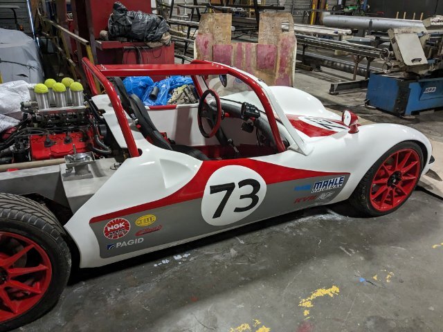

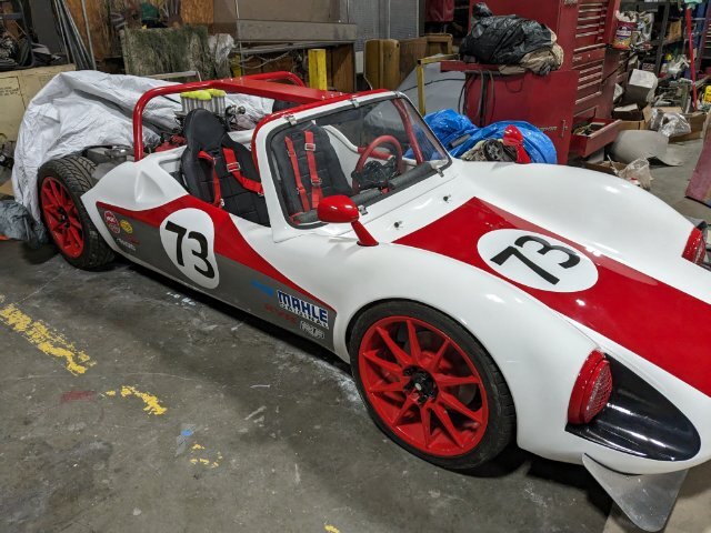

Hang in there Rex and get better. Only you will know the flaws. All of us are just going to sit there and drool.
I would not call it "nice".
It is all business with no creature comforts at all.
No heat
No AC
No vents
No roof
No windows
No sound dead pads
No padded seats
No dashboard
No mufflers
No place to put anything, glove box/pocket places.
It is barely road legal and only because it is pre 1968.
But whatever is going on outside is also going on your head. More like a motorcycle.
I do plan on driving it at least a few hundred miles away from home. Like to cruising the coast.
I gotta come up with a way to cover the fuel injection stacks if I get caught in the rain (and still be driveable).

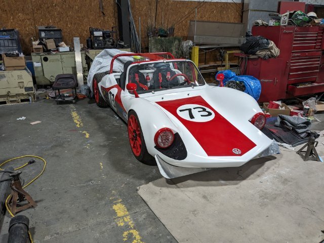

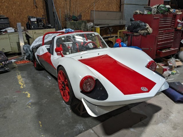

The windshield frame sanded in fairly well, but I cut through several places. So it is primed up again. Waiting for it to be ready to sand again, and then some white paint
Aaaand it is white.
Nevermind the dirty paint booth. A lot of safety yellow has been painted lately.

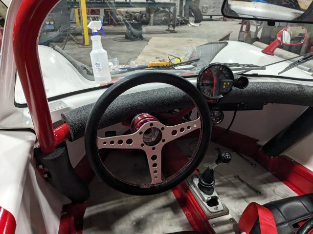

Got a smaller steering wheel to make some room.
Got the wipers done. A big mix of parts, late model spindles and motor, had to make an early model style chassis to fit the car. Rabbit arms and some lever ratio figuring and I have wipers.

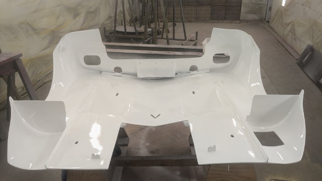

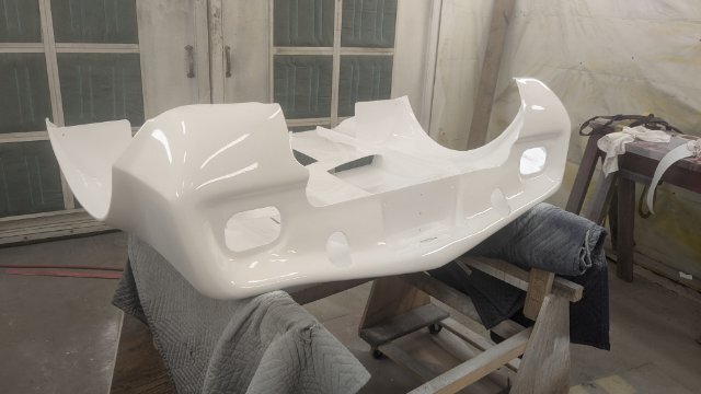

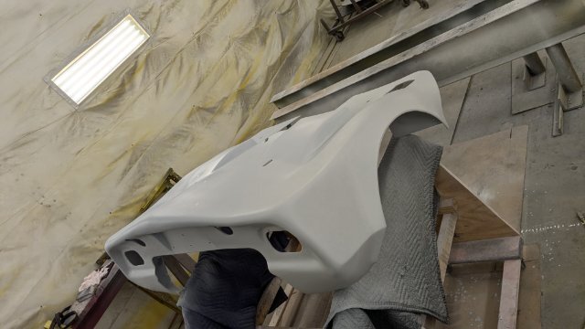

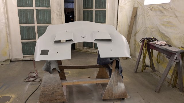

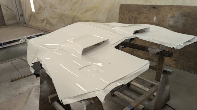

I did get a little more fiberglass done on the underside of hood.

The hood is painted the base white.
Going to put red and black on it like the rest of car.
This has had a couple days, should be set up enough to start prepping for the other colors.
